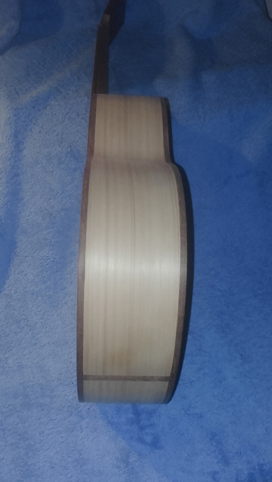

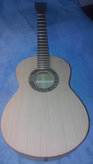

Hi Andos
some progress pics of a baritone uke using Georgia Luthier Supply plans.
Macro top back and sides with jarrah bindings. Pity about the knots in
the macro over there, over here ours is straight grained and knot free.
Got mine from Pete at Curly Timbers.
