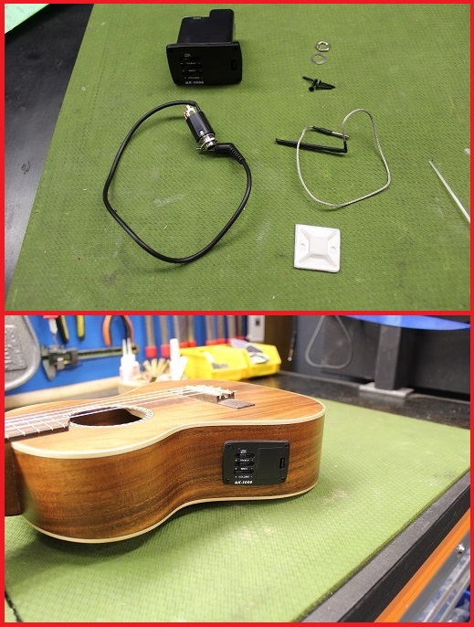

How to install pre-amp to Ukelele
- HTS Install Preamp Ukelele.JPG (160.6 KiB) Viewed 9102 times

Once again a great effort, Steve. However I offer the following critique of this one...
I try to avoid sticking the string holder to either the soundboard or the back, I prefer to hold the loose cables via the sides as they don't vibrate as much and that often avoids rattles.
The saddle slot in this case was obviously deep enough, but the rule is to make sure that there is an ample amount of saddle itself in the slot. Ideally about one half of the saddle height above the saddle slot and the other half within the slot.
Often with an older instrument which is just short of a neck reset the bridge has been shaved down to lower the action, and there is a pretty tight margin for error. That is why the thin piezos like the B-Band UST is a good choice in that case. I have also seen saddle slots routed so deep that there is only a thin half a soundboard thickness left for the string load!
Many piezo pickups that I have has issues with have been the result of poor contact between the saddle and the piezo or the piezo and the bottom of the saddle slot-either the bottom of the saddle slot isn't flat, the saddle slot is a different width to the saddle, eg too wide and the saddle rolls, or the bottom edges of the saddle are grabbing. A fine bevel on each side of the bottom of the saddle usually cures this, if it is an issue. This is particularly true with the B-Band UST piezos which are ultra thin. So I always check the saddle slot for width, depth and flatness, and match the width of the piezo to the width of the saddle. On one guitar I fixed recently, someone had placed matches either end of the saddle slot to raise the action, resulting in poor contact between the piezo and the bottom of the slot, along with rolling of the saddle as it was sitting too high out of the slot. The result of all these issues is uneven volume from string to string. I actually like finding this kind of shoddy workmanship, because it is an easy fix and the customer sees me as a miracle worker having complained that their piezo needs replacing!
One other problem I have repaired is that the hole where the piezo goes through the soundboard is directly under either the bottom or top string, resulting in poor contact and loss of volume for that string only.
I note that throughout all your tutes, your hands are getting good at taking "selfies" of each other!
Kind regard, Ross

Re: How to install pre-amp to Ukelele
All good, and I agree with your points, many times I have to route saddle slots deeper to achieve desired bridge to saddle ratio.
If you click the end pin link, you see I normally clip cables to the sides as well, this one was top clipped as that's what happens with the factory fitted Córdoba units.
