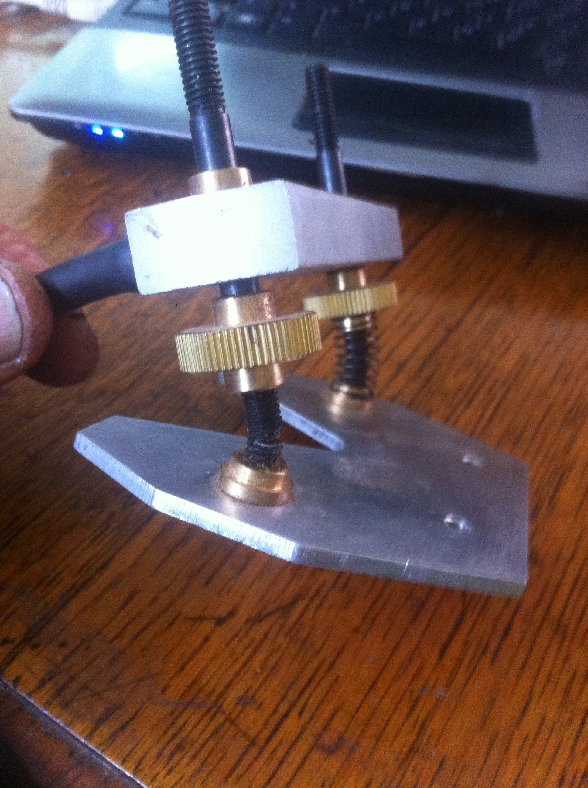

Does anybody know where to source the screws for one of these? They don't like being dropped, the screws aren't high tensile...Ross

Talk to Stewmac...they may be able to supply parts. That said by the time you've paid for the parts and postage it might work out more cost effective just buying a whole new jig. Ive done much the same to two of their thicknessing calipers...

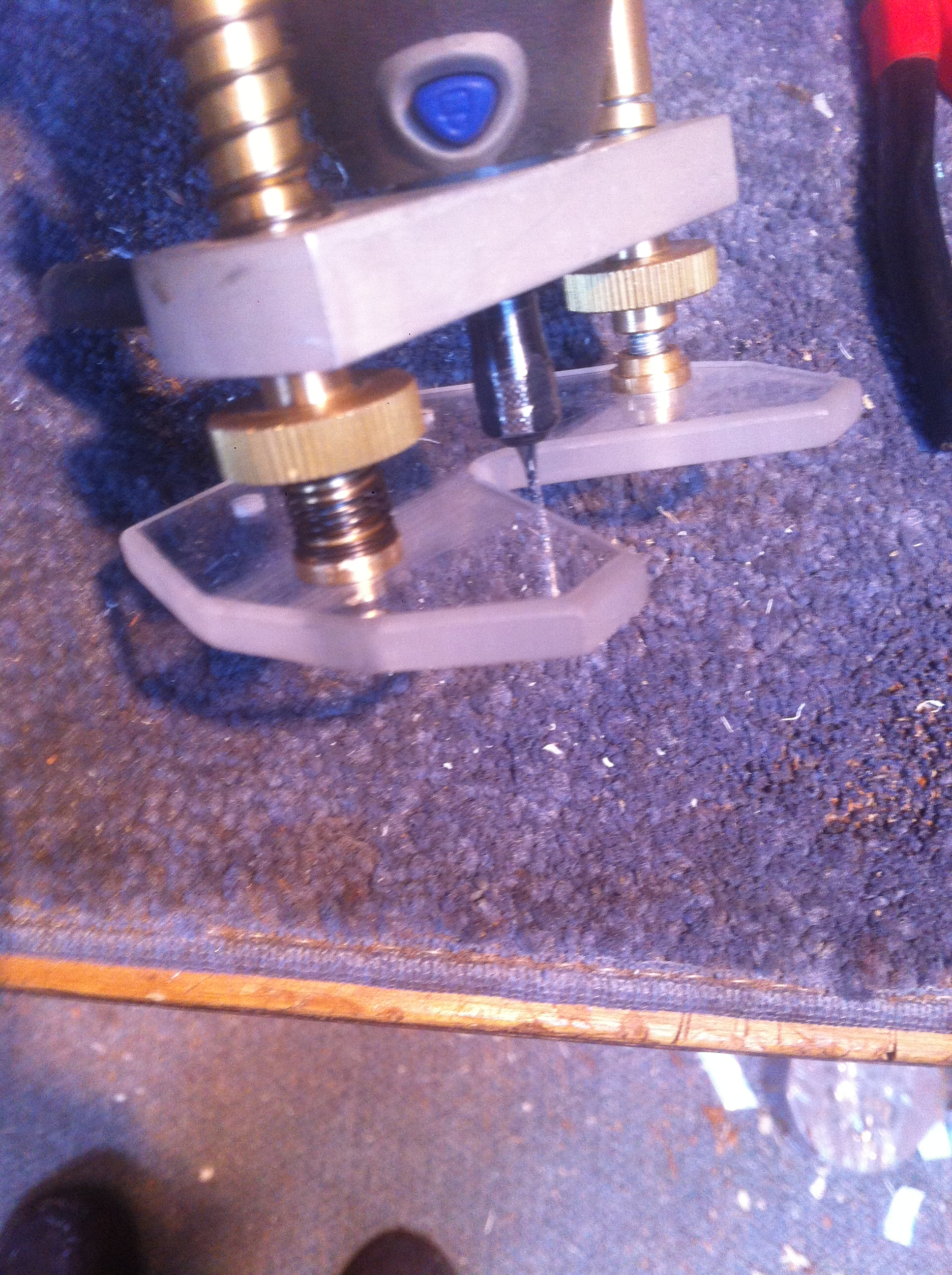

30 degree cutting mod :cl
err...its actually 32.5 degrees...useless!
I have written to Stewmac. The problem with these bases is that the screws which bent/broke are hollow and threaded to accommodate the screws which hold it to the base- which is the weak point. It would be better to have them made with high tensile steel.
I Just drilled and tapped a new one on my drill press, but when tapping into it the wall thickness is not strong enough for the torque when I tap the thread and the whole thing collapses and bends out of shape....if only I owned a lathe and a balcksmiths forge...ha ha- R

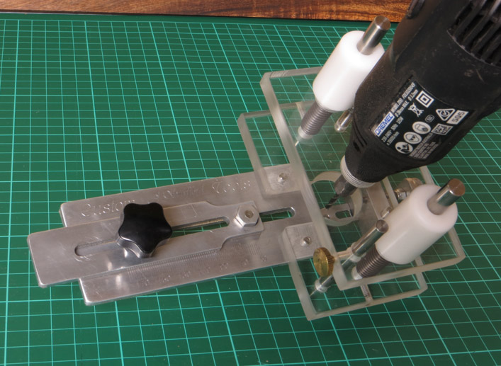

looks to me 6mm you could try all thread ,I made these for the Dremil works the same I guess those US guys use some pretty weird imperial threads you know 64 thousand 64 ths :lol
Re: Accident!!!Don't drop one of these!
Post by simso » Mon Oct 30, 2017 7:58 pm
That’s a good looking adaptor

See it as a sign that it's time to build yourself a decent one using a laminate trimmer!

Post by blackalex1952 » Tue Oct 31, 2017 1:21 pm
FIXED AND IMPROVED!!!
