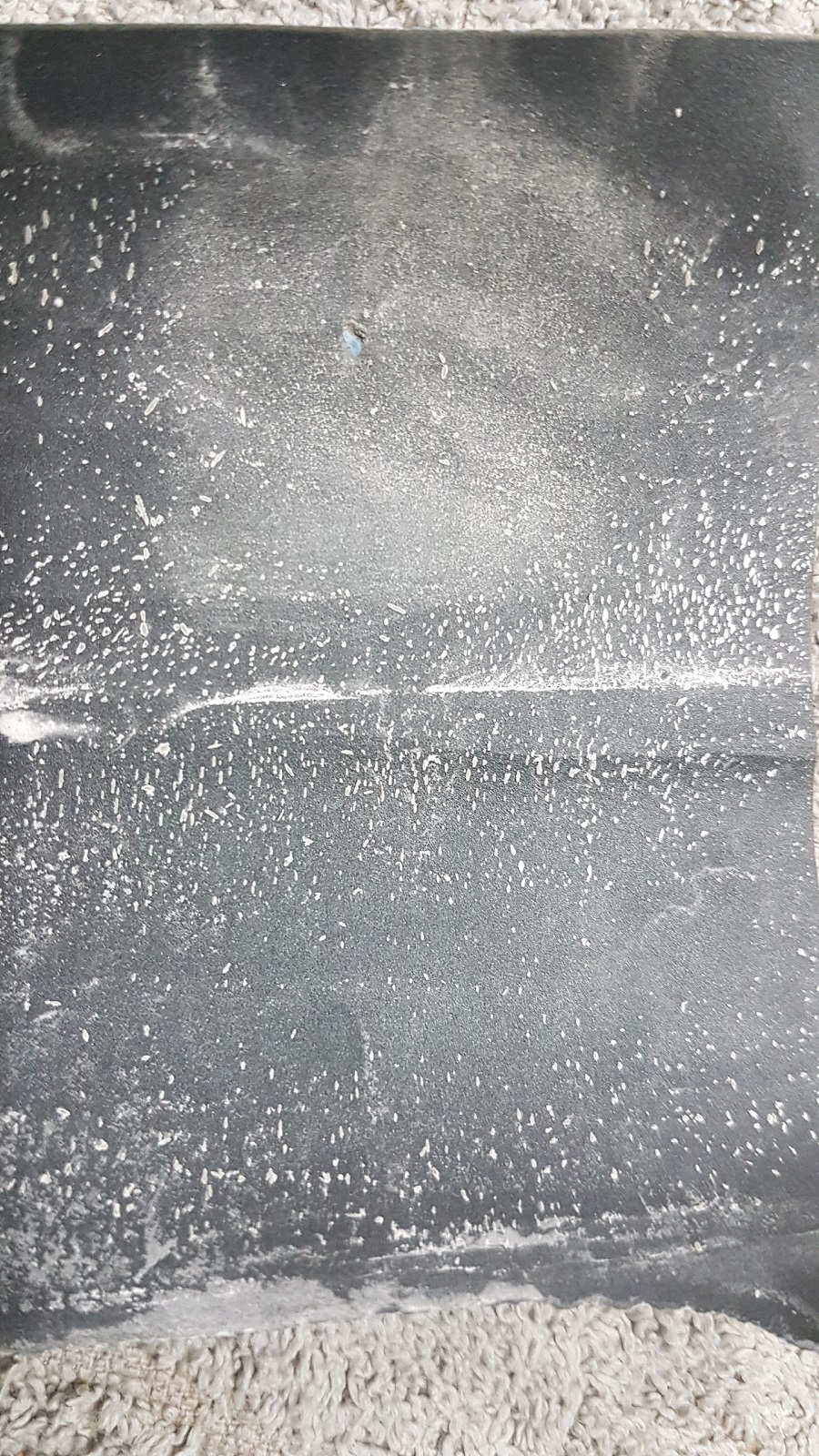

Strange thing happening in final sanding/levelling of a Mirocat finish today.
Sanding wet with P600 wet/dry. The paper clogs up pretty quickly and doesn't readily wash off when I dip back in water. Like lots of small pellets of finish. Preparation to this point if it helps....
- new tin of Mirocat 60/40, 1:1 mix with 5% retarder added
- 5 coats, 1 week to dry, level with dry P320
- 5 coats, 2 weeks to dry
It is levelling but I'm going through a ton of sandpaper. Using small sanding block with rubber base.
Any thoughts?
thnx. Frank.

Finish is still too soft, why its soft cannot answer that one, also are you adding some detergent into your water for sanding, to help break the tension

Thnx steve. Yep - drop of detergent added. Also soaked sandpaper overnight.
I assumed thinner & retarder doesn't have shelf life - over 3 yr old.

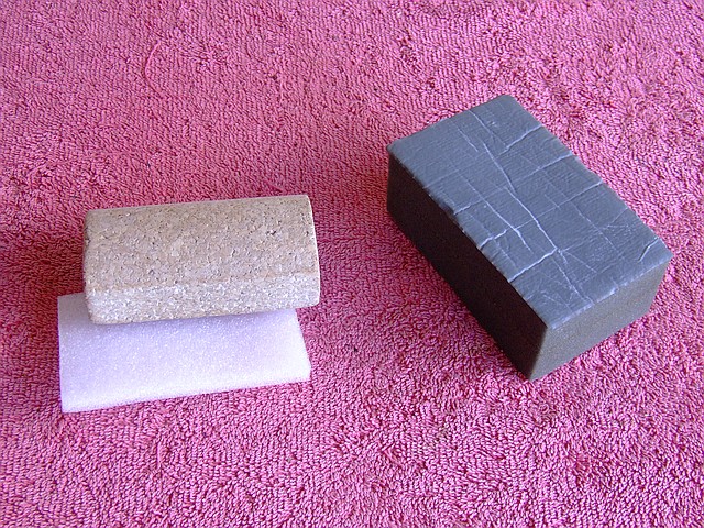

Frank, when I was building boats, I used rubber blocks most of the time when sanding, usually wet. For some reason, they never seemed to work particularly well for me on guitars. Probably too hard. I have a variety of cork blocks that I use mostly and when sanding through the grades finishing, especially on softer finishes, I use some plastic foam packaging material between the cork and the paper. That's the set up on the left of the pic below. This sort of arrangement rides more smoothly over the finish without causing the blobs on the paper that you have been suffering. Of course, a soft block like this won't flatten lumps, but those should have been got rid of way before, using a hard block. By changing the thickness of the foam packaging material, you can change the hardness to whatever suits the circumstances best. I can't remember what the packaging came with, but it's pretty common stuff, just an expanded plastic foam. Can be used wet (with water or other lubricants) or dry.
That cork block is flat on the bottom side and curved on the top, though that's hard to see. It's curved to fit guitar waists just by shaping it on a drum sander (pics in Chapter 4 of the Build book). The foam will wrap around the curved side, too, of course.
For very delicate surfaces I use the foam block on the right. It is very soft and about 45mm thick with a very flexible film abrasive stuck to it. Again, can be used wet or dry.
I've been sanding stuff for 50-odd years and I'm still learning!

Today I changed the technique - much wetter, lighter touch and more frequent dipping of paper in water. No clogging and was able to do a single grit on guitar and neck with 2-3 bits of sandpaper.
Thanks again for your help.
