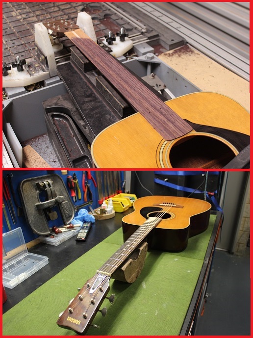

- HTS Sacrificail neck reset.JPG (170.82 KiB) Viewed 9640 times

Steve- firstly thnx for making yr experience available to mugs like myself. I learn so much.
I wanted to question your use of Irwin quick action clamps when gluing fingerboard to neck. I have a set of those clamps also but never feel they provide the pressure needed for jobs like that so always use heavier steel clamps. Clearly u don't see this as an issue. I recall reading something once distiguishing between clamps designed to hold two surfaces together without much pressure (Irwin?) and those that apply considerable force.
Frank
Frank
Re: Non conventional neck reset how to..
Hi frank,
Good question, for me, I have some super heavy duty clamps which I used in my early days of furniture building (my own house furniture, not commercial) things always failed, I personally believe in retrospect that too much pressure was being used and this was the cause of my failures.
I find firm but not tight clamping will join surfaces together perfectly and allow enough glue to penetrate into the wood and still allow a bond, by clamping too tight, I think we actually squeeze that glue out of the areawe really need it.
Irwin clamps apply a nice amount of tension, I have glued tops, backs, assembled and made necks, fitted fretboards, crack repairs, cracked headstock and so forth and used them on every job,good all round clamp IMO.
Thanks for that Steve.
More clamps with less pressure - makes a lot of sense. And the 1mm pins. Much easier than trying to hold things to a pencil line.
I've also been considering copying the tile layers and using a serated scrapper to get a more even spread of glue under the fret board.
- Posts: 1169
Great pictorial Steve. I have never seen that approach to resetting the neck angle - but it makes a lot of sense when you can't unglue the joint. I can see you developing a specialty business in doing Ovation resets - wouldn't that be fun!
FWIW I find a great clamping system for gluing fingerboards is to wrap the whole thing end-to-end with a bicycle inner tube (with the 1mm pins that you have mentioned stopping everything from sliding around). It is like bandaging up a sprained ankle. Super fast and very effective. Titebond doesn't stick to the rubber tubing.
The forum needs a like button, I think the bicycle tube is an excellent idea for attaching a fretboard.
I do way to many ovations as it is
That's a couple of great suggestions with the 1mm drill bits and the bike inner tube. Will definitely give them a crack.
