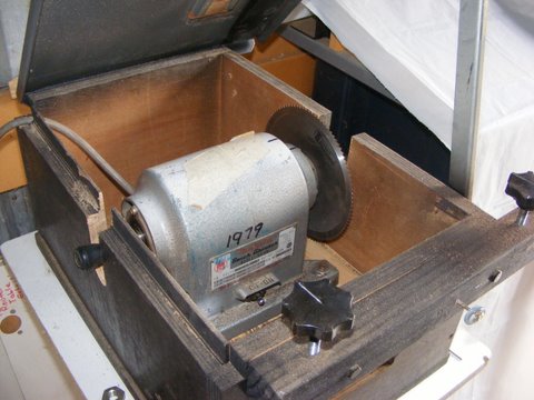

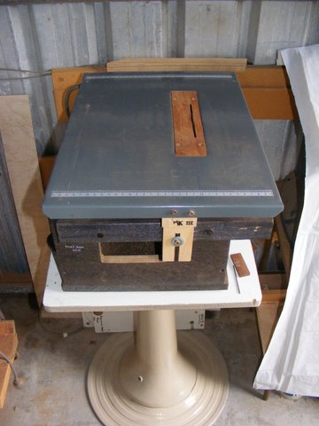

Any chance of posting a photo, Rod? A picture tells a thousand words! The photos I have posted were lifted off the net, how one guy made one.You would need a sliding drop saw for that but I made myself a sliding table saw specifically for this job. Used an Ozito table tile cutter saw , replaced the blade with a Stumc fret slotting blade made a sliding table wilts some drawer slides.
Goes under the bench when not in use.
I use the mitre box system but self made and the cutting templates for the scale lengths I made myself on a mates milling machine. If you have an iphone, there is a free app called 'fret calc'. I just dialed in each scale length and set the distances on the milling machine. I used a 6mm drill to mill accurate holes in perspex templates. Then I use a 6mm drill to locate the template on the mitre box for each fret slot. The fretboard blank is double sided taped to the perspex. When I get around to making a machine, I would think along the lines of making one which would follow the neck radius. That way the fretboard would be crowned first before slotting, and the slots would then follow the curvature of the neck. My method at the moment is to mark the fret slots with the saw, then radius it, then final depth cut the frets with the saw and depth stop. It might even be possible to design a slotting machine which could do both jobs somehow-radius the fingerboard then cut the slots after that, ie no sliding table, but a swing arm which mounts above the saw. It could be detachable and also mount above a belt sander. . I also saw a machine that Ian Noyce made years ago which had multiple saw blades and spacers on a shaft for different scale lengths. That machine cut all the slots in one pass-but back then he was making quite a few guitars in production runs. I never saw it in use, but quite possible with a machine like that to cut a number of fretboards in one pass if they were mounted together side by side. -Ross
- DSCF5183.JPG (45.11 KiB) Viewed 17448 times

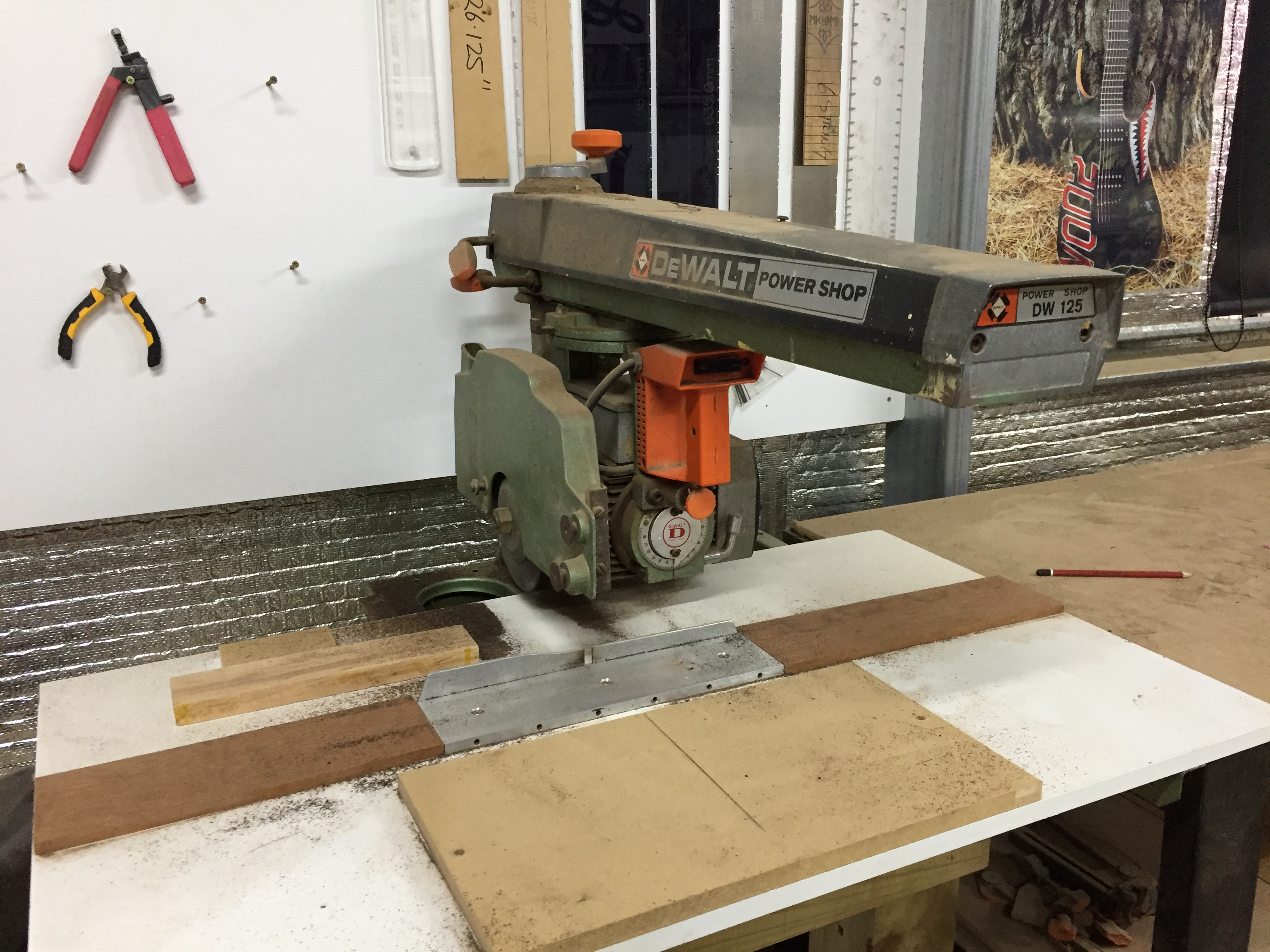

My first version I bought a sliding mitre saw. My advice is DON'T. They are not suited to the task.
When I did make the mitre saw version I shopped around testing several trying to find one with minimal flex, however even if you spend over a grand on one, a mitre saw has too much movement/flex to accurately fret slot and have the same depth over and over.
My current version which I am happy with is made using a Dewalt Radial Arm saw, safety guards removed to accommodate the small stewmac blade and stewmac mitre box which is modified.
Again, I would not ever go the mitre saw route again. Waste of time and money.

Re: Cutting fret slots
Another addition which may help:
If I was to build my setup again, I wouldn't bother with modifying and fitting the stewmac jig. Mine has cut so many slots that I'd actually worn the pin down so much it was unusable.
In repairing this I discovered it is just a pin pressed into a drilled hole, I knocked it out and replaced it with a nail which works very well.
I was to rebuild, I'd mount some angle with a nail in it as the locator and I'd definitely use the radial arm saw again. M
I just remembered to take a photo:
Filmed this today on my mobile, however you can still see how solid the setup is.
Being that I attempted a sliding mitre saw setup first, I knew what would and wouldn't work, I gave the mitre saw to my brother and moved all the jig over to the radial arm saw which slides in a different manner and doesn't flex and move like the mitre saws do.kiwigeo wrote: ↑Wed Jan 03, 2018 6:22 pmDefinitely a solid looking saw....more solid than most of the saws Ive looked at.demonx wrote: ↑Wed Jan 03, 2018 3:02 pmFilmed this today on my mobile, however you can still see how solid the setup is.
