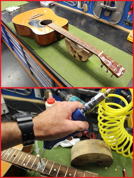

Couple of quick easy ones to start the working year going again.
http://www.mirwa.com.au/HTS_Repair_Trus ... attle.html
HTS Truss Rod Rattle.JPG (180.21 KiB) Viewed 17647 times

Wow, ok so when gluing the fretboard on, I have been fussing over not getting glue on the trussrod or in the channel. So there isn't a problem with glue and the trussrod?
Re: How to Repair Truss Rod Rattle
Post by simso » Thu Jan 18, 2018 11:09 am
Yes and No,
I always avoid getting glue into any truss rod cavity I make as well, but this guitar had a rattle, so the option was repair it properly - remove the fretboard fix the slot and truss rod or inject glue at locations to suppress the rattle.
Sometimes we have to do the cheap fix for the customer otherwise the guitar being a cheapie would have been put into the bin.

Absolutely, one issue to consider, is that anything used that is flexible or soft will eventually wear away or split, I say this from the following situation which is the way I use to do it.
Using wax as a fill, you need to get the neck hot to allow it to flow into place, I found the truss rod rattle on one of my earlier wax pots came back a couple of years later, ii suspect repeated vibration at a point squeezed the wax out
Since doing it with titebond, i have had none come back, I suspect the glue, solidifying at singular locations is enough to lock that section of the truss rod within the channel.

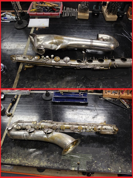

A before and after, the owner drove his car over the top of this one.
Crushed 4.JPG (161.32 KiB) Viewed 17517 times
