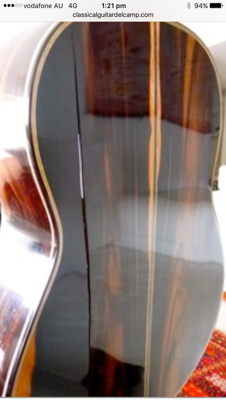

Re: Future build
Make sure your humidity control is good and the wood is well seasoned...
I bought a guitar from a luthier in the Philippines a while back... a couple of months after it arrived this happened:
It is now sitting in the corner of the workshop for fixing "someday"... I'll probably end up running it through the bandsaw for rosettes, headstocks and decorations
Re: Future build
I can imagine that crack would have been a disapointment but I would think repairable, before turning it into parts, surely.
