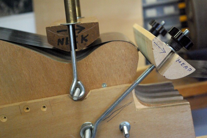

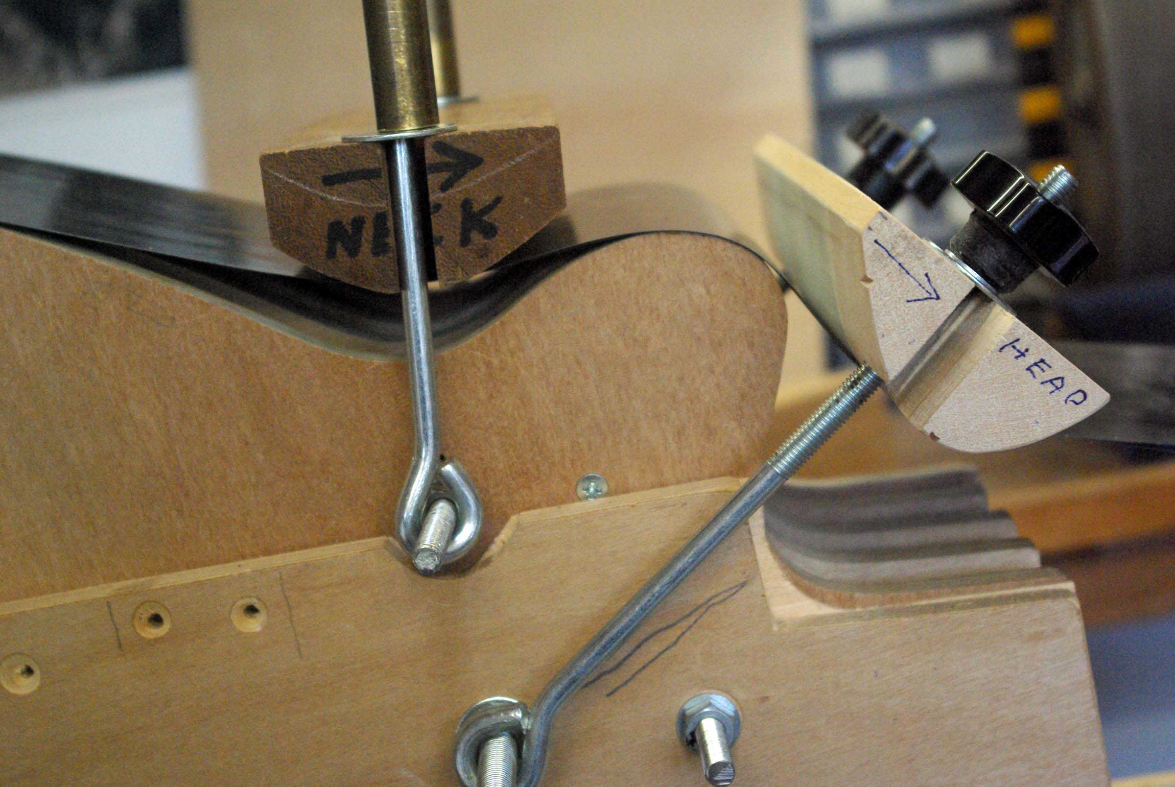

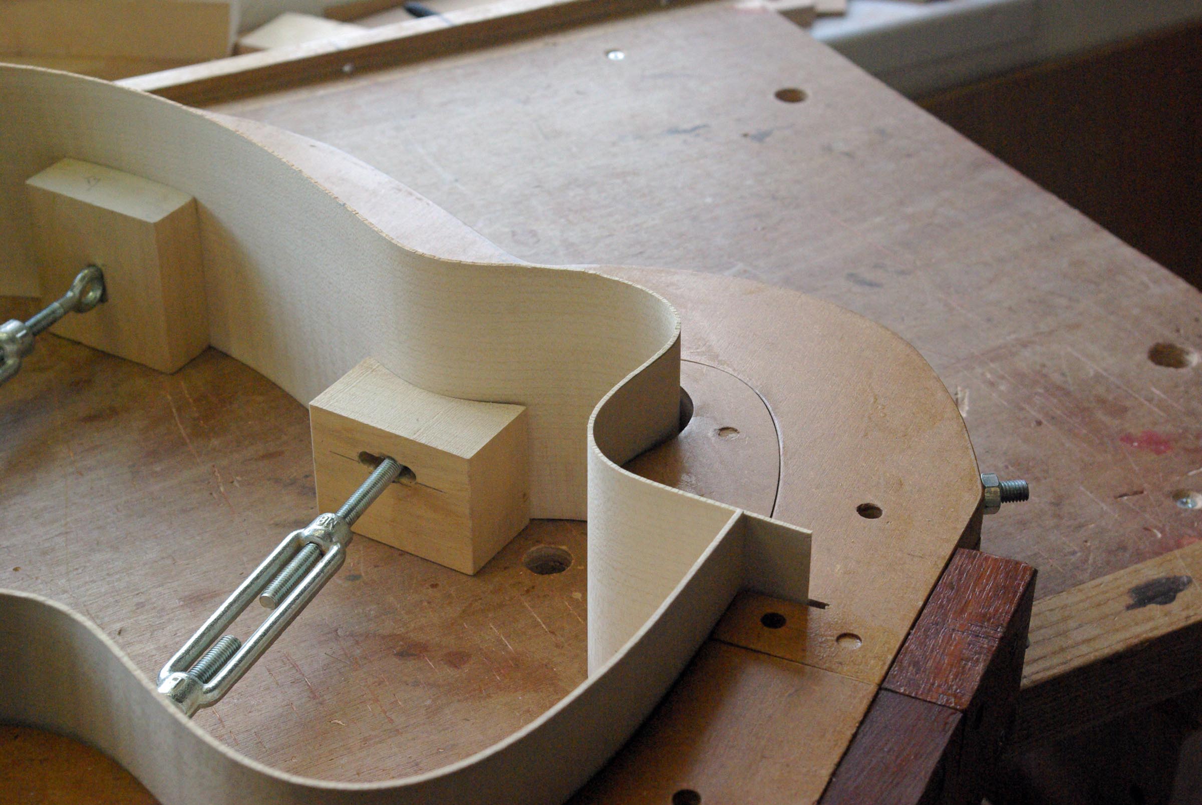

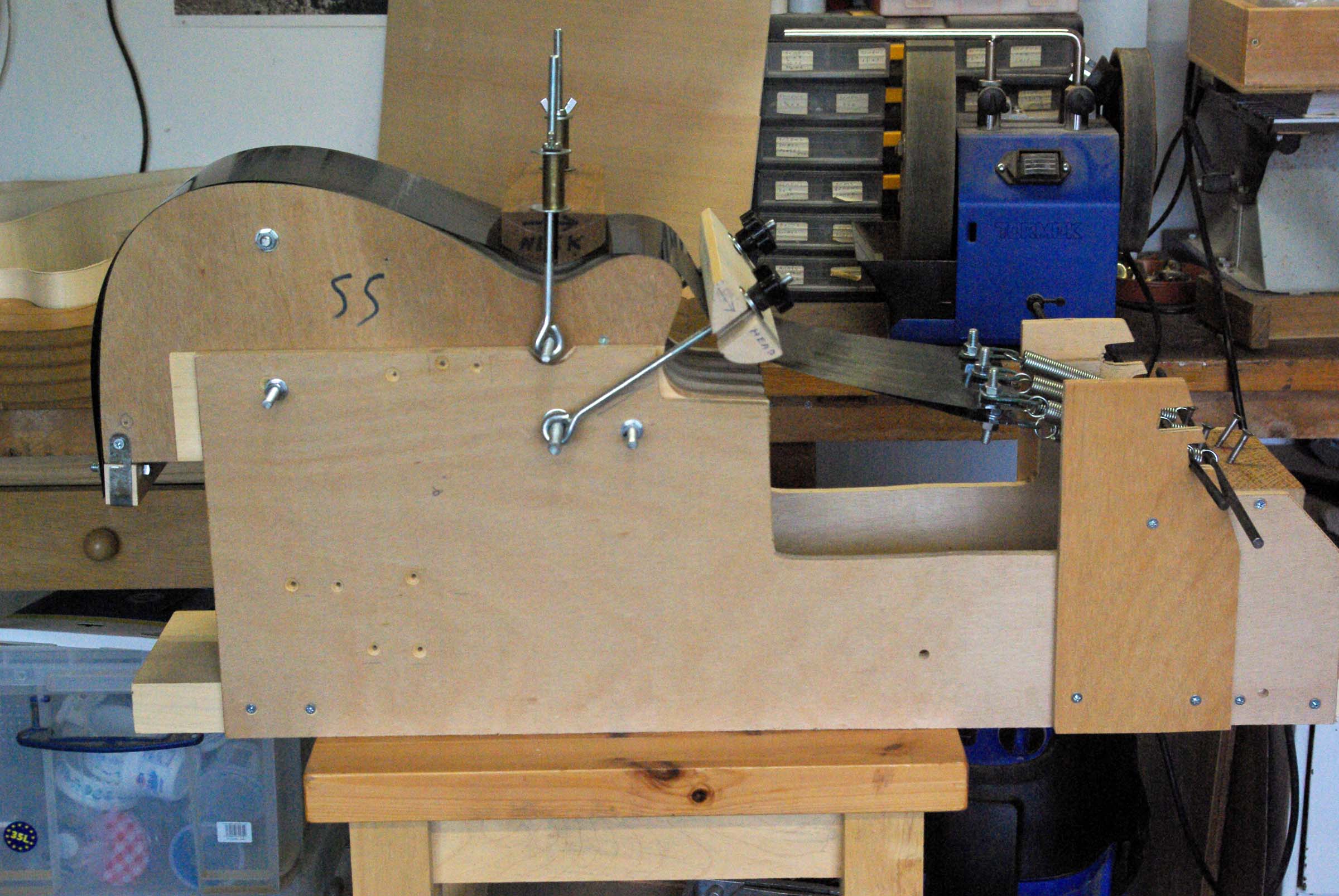

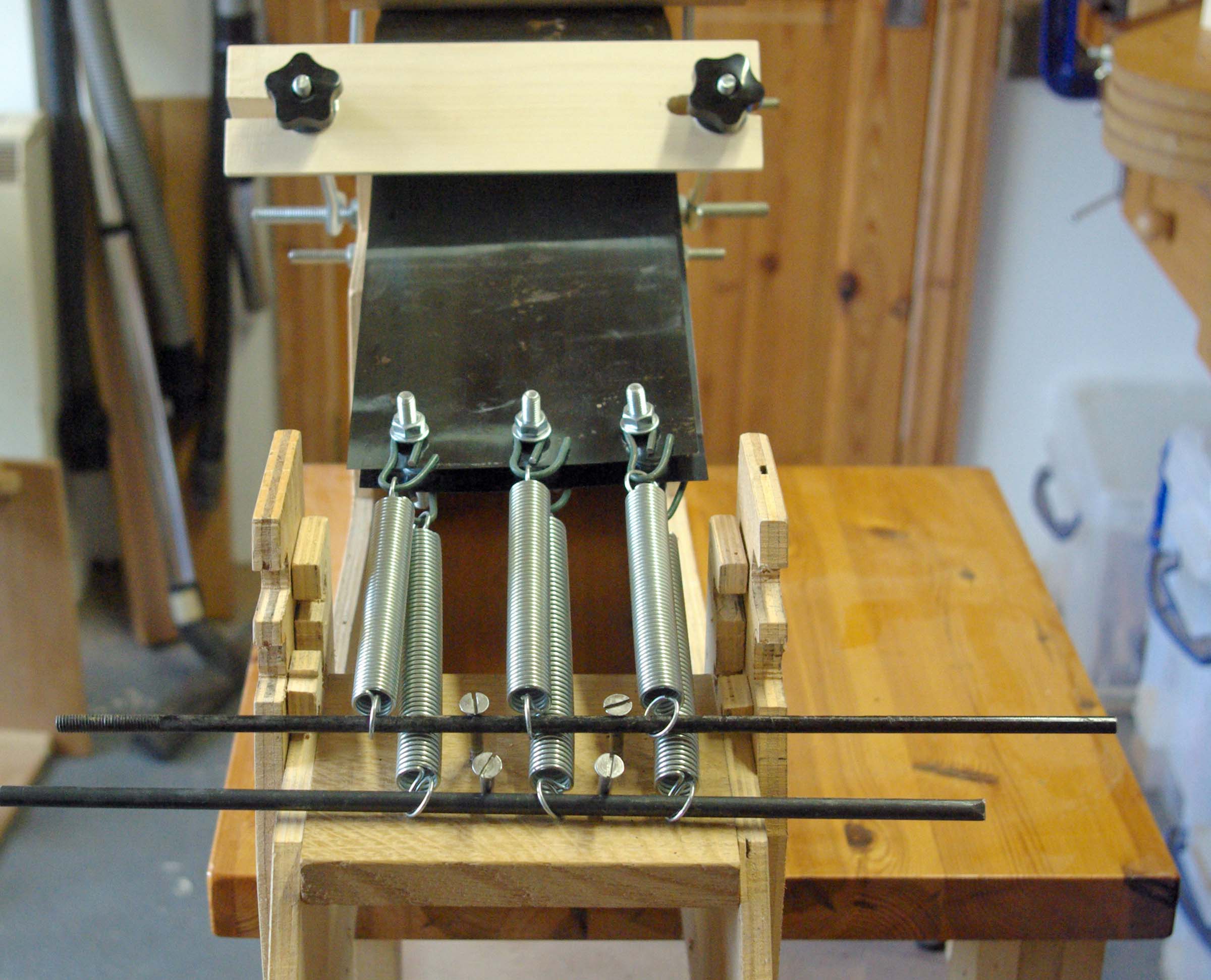

As it happens I got nearly to success the next day. I am using this contraption: This is nothing new, I think Mike Doolin was one of the first to discus it.
As usual I changed several things:
Increased the tension by adding the third spring.
Took the temperature from 120 to 130 C though this just beginning to scorch the Maple so I'll have to pull it back a little.
I made a much closer shaped caul for the cutaway. You really need to allow for the width of the sandwich.
This was successful in that I got no breaking up of the Maple - I thin to 1.8 mm but it did not quite take the full sharp nose. I think I'll have to exaggerate the shape a little. It'll do for this build though.
Sorry the pics are all over the place but you should get the drift.
- 56nortondomy
- Posts: 708
Re: Laminating Cutaway Sides
1.8mm might still be a bit thick Dave, I thin to about 1.5 to 1.6mm for my cutaways and I soak for 30min in hot water with fabric softener.
