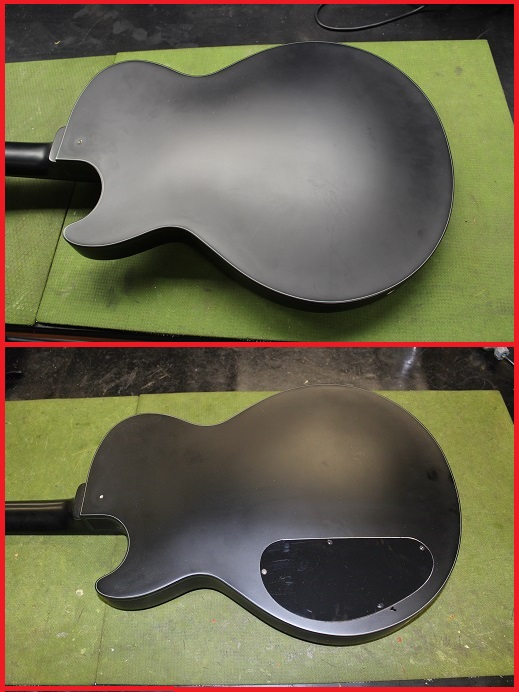

Post by simso » Sat Feb 24, 2018 2:58 pm
HTS Artcore Access Panel.JPG (141.18 KiB) Viewed 4388 times

Post by Mark McLean » Sun Feb 25, 2018 2:05 pm
That is really nicely executed. Anyone can cut a hole - but the inner frame to allow a flush fitting cover is a very nifty piece of work.

Post by simso » Sun Feb 25, 2018 2:56 pm
Thanks mark,
In the early days of my career, I struggled to get a neat fit up, since then I have learnt a little bit of planning ahead makes a huge difference.
