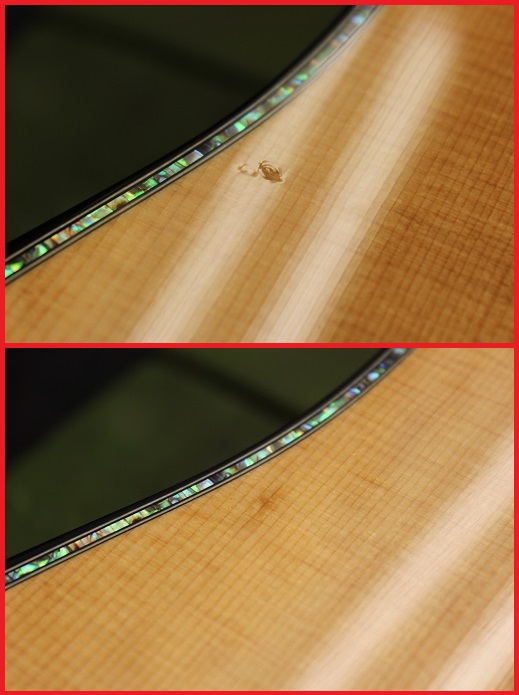

I fly out to Sydney Tuesday night, so rushing last jobs through on the weekend.
This Taylor we repaired the top using the superglue method.
http://www.mirwa.com.au/HTS_Superglue_Drip_Fill.html
HTS Superglue drip fill.JPG (100.63 KiB) Viewed 5070 times

Nice one, Steve. I assume u have to be pretty careful to not sand through the finish, with the risk of superglue staining the spruce?
For repairing a ding in a french polished soundboard what would you recommend? I recently had to do some minor repairs to a FP top so steamed a ding first and then repolished - it ended up reasonably successful but not perfect. Is there a better way?
Re: Superglue drip filling
Post by simso » Mon Mar 26, 2018 2:15 pm
Yes you are correct, its so hard to remove the bulk of the damage without cracking into the sealer coat.
Mmm french polish, it sounds like you did exactly as I would have done, steamed the wood, lightly scuffed and then polished again, you have no ability to fill on those jobs as the french polishing is so thin. By the sounds of it, I do not think I could have done it any better myself.
