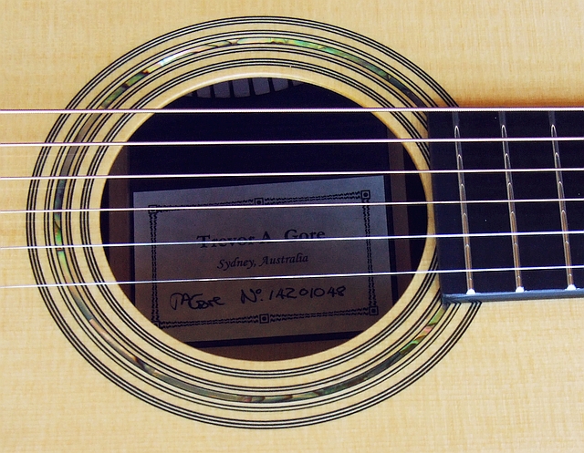

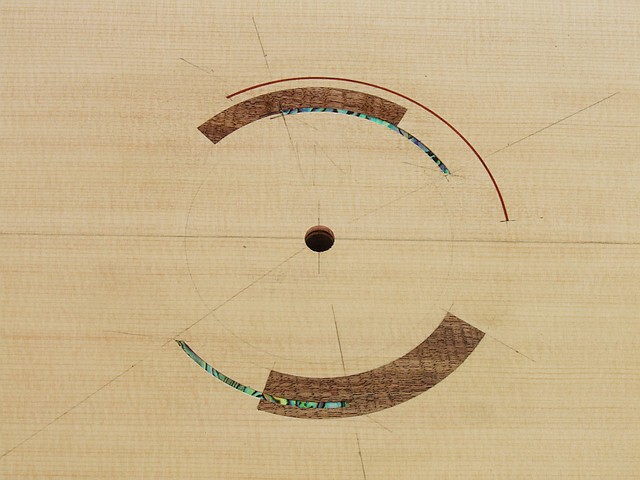

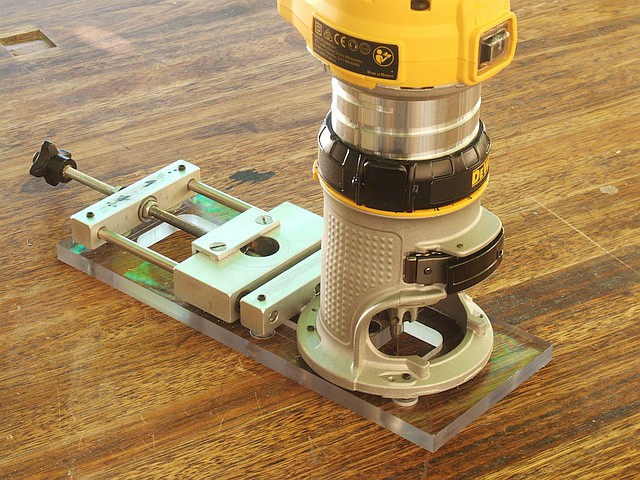

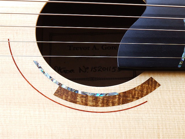

For precision results, it helps a lot to have precision tooling.
Over the years, as I been asked to do more interesting rosettes, I've had to develop the tooling accordingly.

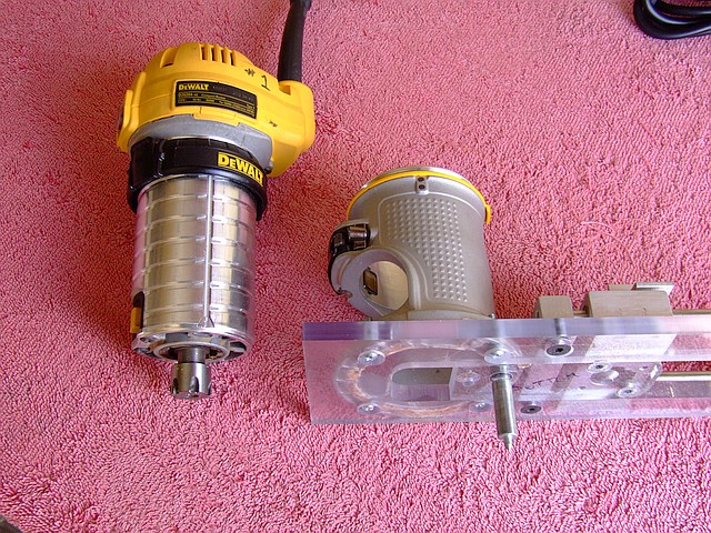

I use De Walt routers with precision aftermarket collets and bits. I use a much larger diameter pivot than is typical. Mine is 10mm diameter. I need to be able to drop into discontinuous cuts and finish them with precision. An anti-backlash radius adjuster is pretty much essential. Mine has a screw pitch of 1mm, so a 0.1mm adjustment either way can be made reliably and repeatably. I even had a digital readout (0.01mm) on this at one time, but found just using the screw was accurate enough. I have both 1/4" and 1/8" collets so that I don't need to use adapters.
The process is important, too. You usually don't get a second chance going around when cutting very fine slots.
Here's a couple of shots of the hardware:
Here's an in-process shot...
...and a couple of outcomes.
