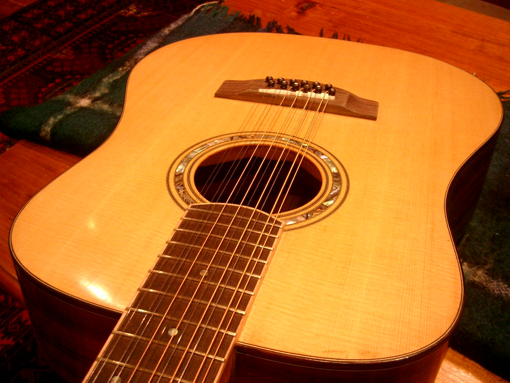

I used abalone on two of my early builds. I inlaid the pieces so they were 1-2mm proud of the top and then just sanded back. Abalone isn't that hard...it's basically calcium carbonate. On the Mohs Hardness Scale it's about 3-4 which isn't that hard. It'll work easily with moderate grit sandpaper.
