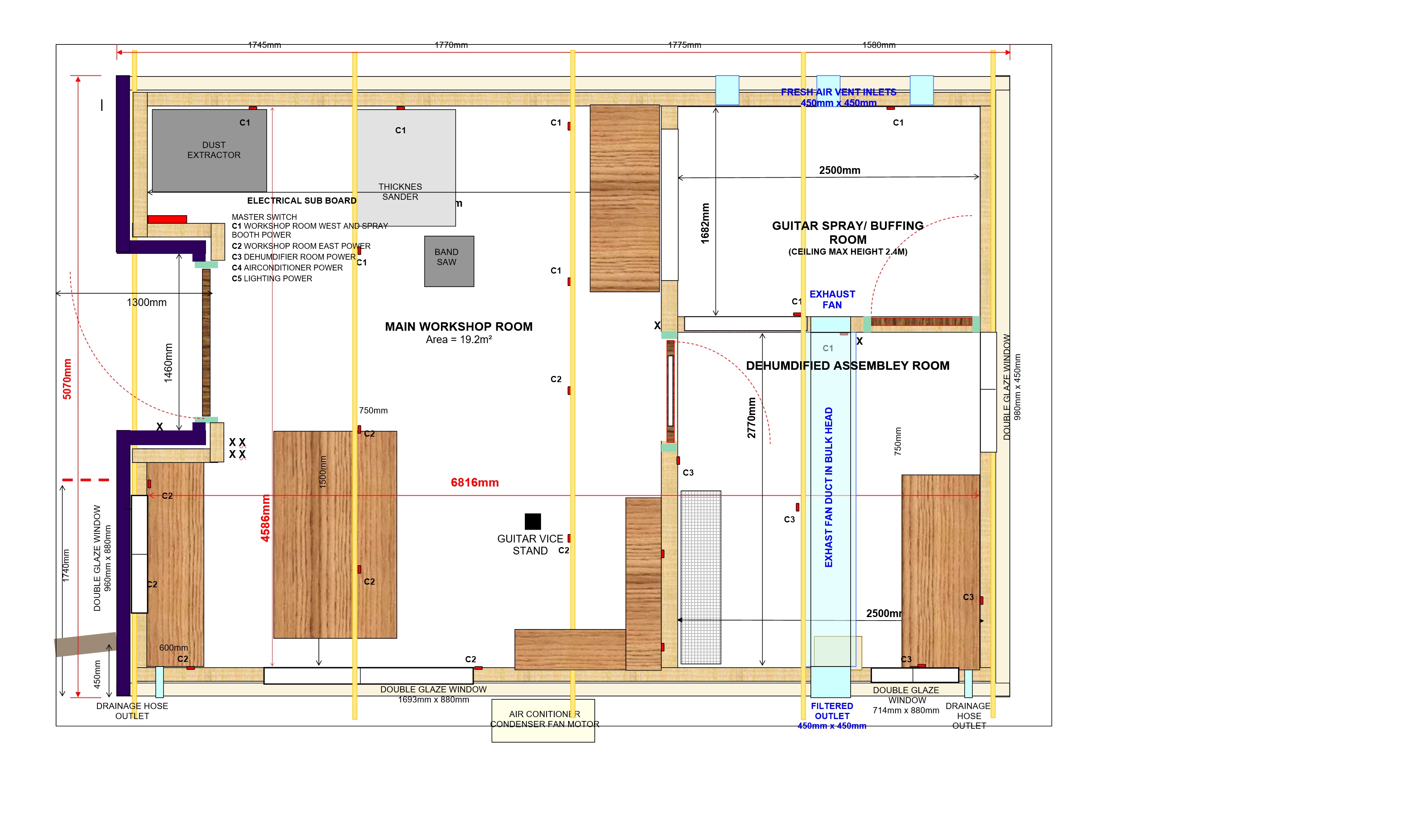

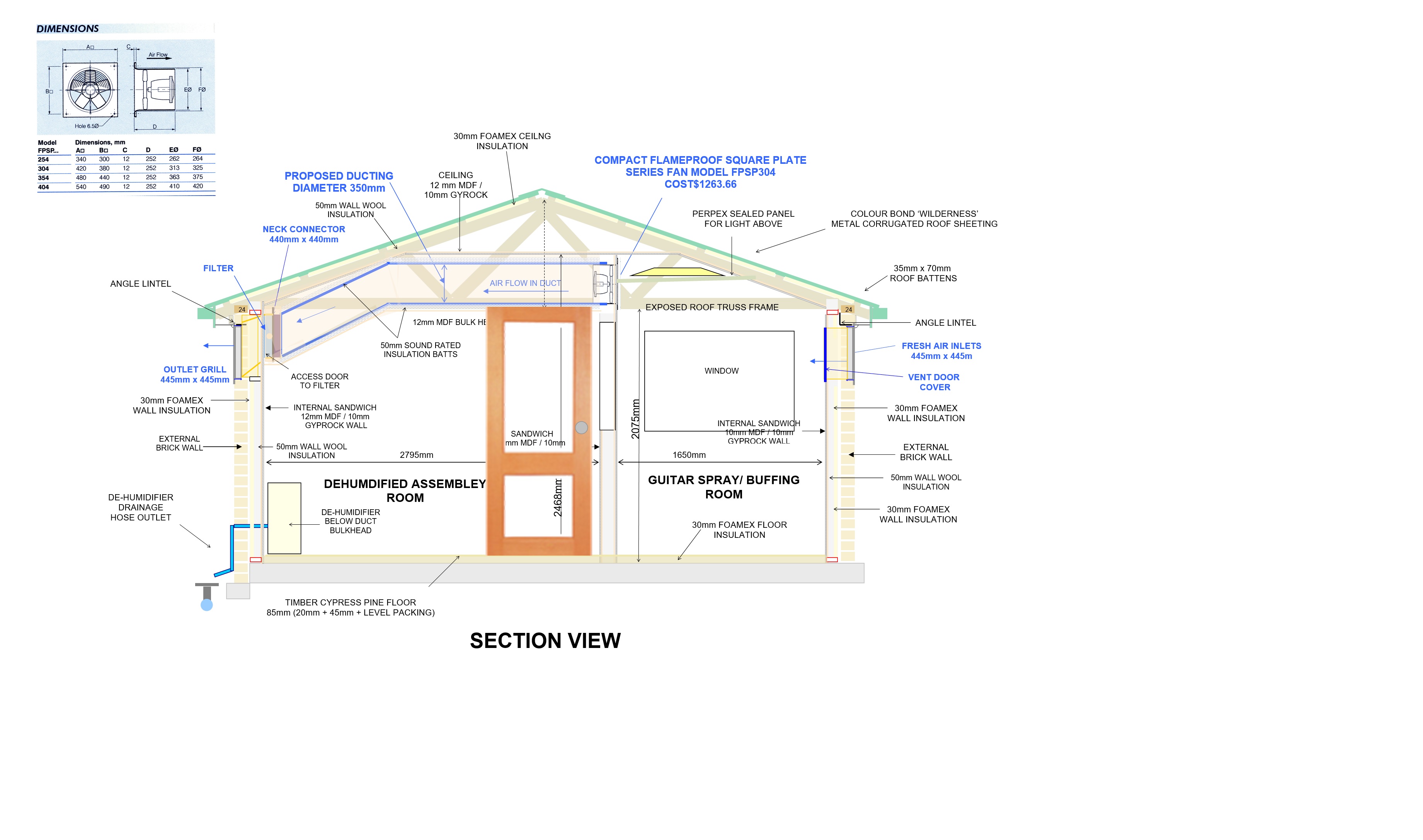

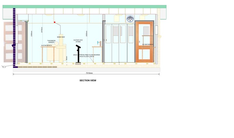

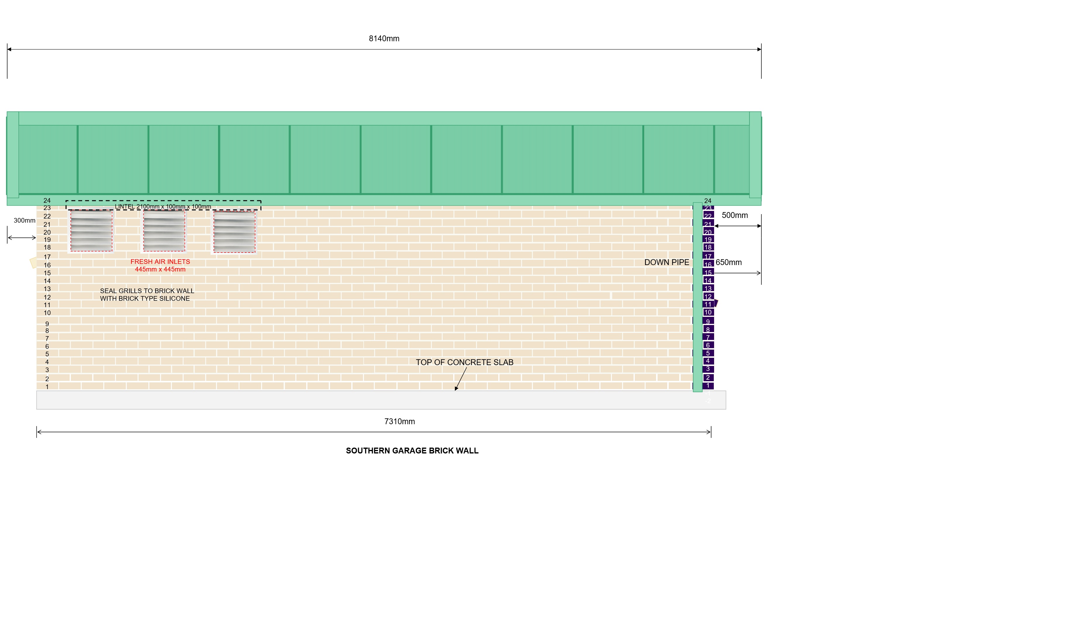

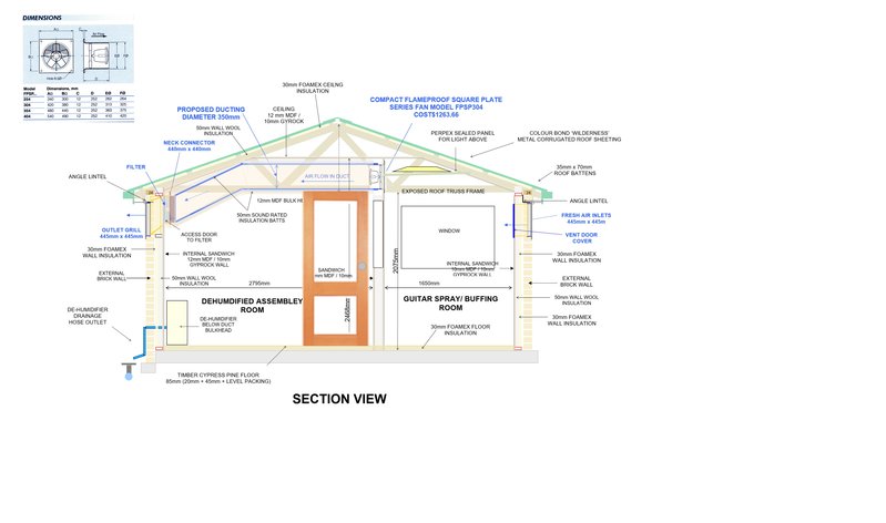

When I built my spray room and installed an explosion proof fan for as nitro lacquer spraying of my acoustic guitars, the spray room included 3 fresh air inlet vent with dust filters that I made. An enclosed duct was constructed from the exhaust fan to an external vent with some fiber type filters spray booth filters that was directed away from my adjoining neighbor. However, fumes are noticeable when I spray. Fortunately, it dissipates in about 5 to 10 minutes after spraying a coat on the guitar body and neck. I have had no complaints from any neighbors yet. Its a bit like when an aerosol lacquer spray can is used out side for a small home project that is not continuing all day. This is generally acceptable. As a precaution I do try to pick my spray times during the day when my neighbors are out.
I did look into installing carbon filters at the outlet that are very effective in minimising fume issues, however, my exhaust fan (cost $1300) was not powerful enough to work with a carbon filter installed. I should have check this out before building the spray room and purchased a more powerful explosion proof exhaust fan.
Note: I did send plans of my spray room to an exhaust fan manufacturer who sized the fan unit to suit my room. Unfortunately, at that stage I did not specify that Carbon filters were to be installed.

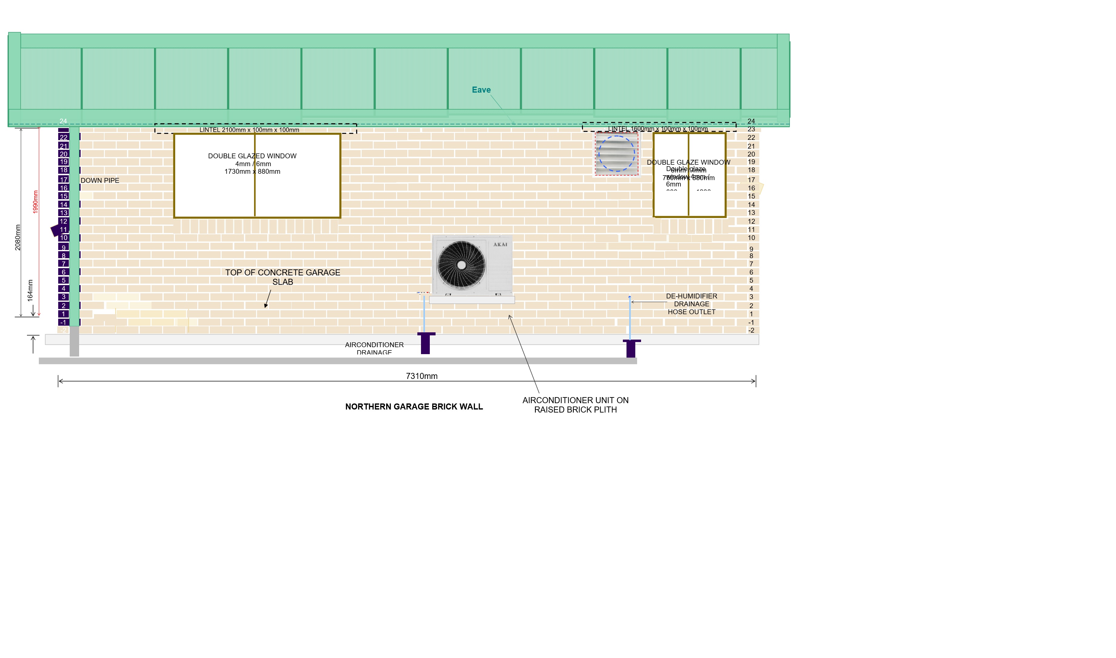

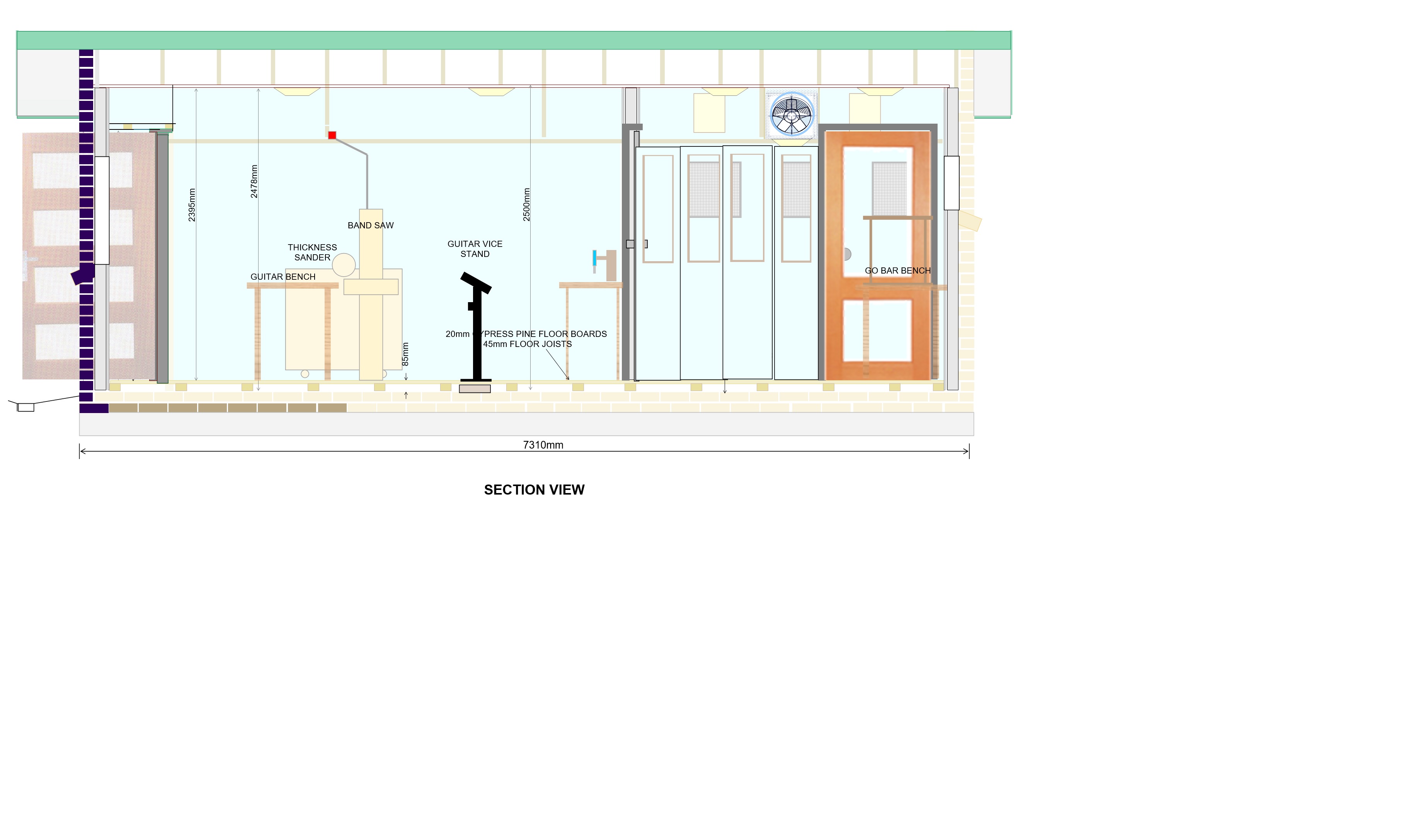

I have provided some design drawing attachments, You tube link that show the construction of my guitar workshop that includes plans/photo slides of the spray room and my website.
Hope this information may be of some help to your spray room design and potential adjoining residents issues.

Thanks Wayne exactly what I was looking for. My version will be more low tech using 2nd hand bits etc. My stepson is building the machine shed and he is very handy with all things motor and metal. He is building the shed from used panels of 75mm steel sheet / foam sandwich as used in refrigeration plants. Has a factory near here filled with scrounged metal, motors ducts et al. very clever and resourceful young bloke to have on the job.
