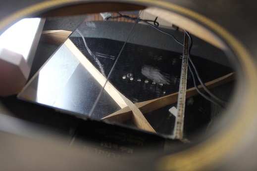

This is a question I’m putting out there, I know quite a few builders on this forum use carbon fibre braces and so forth and I have seen Trev comment on a fe ideas.
Got a Martin guitar in at the momment with high pressure laminate top, the top is 1.2mm thick and it has no bridgeplate no tone bars or anything inside, it does have a super thin layer of fabric glued between the x brace aft , this is quite large .
No surprise the bridge has come loose a few times and the top deformed.
My only thought process for repair is to fabricate a maple bridgeplate and fit it inside, now the million dollar question, what glue, typically I repair any HPL guitar with epoxy, wondering if something stronger exists
I do Martins warranty repair work, thisis not warranty, Martin have since changed this design and the new design has a bridge plate and a tone bar

Have with no luck, the issue is the hpl is lined with some type of fabric which I cannot get off, the newer ones don’t have the fabric and the wood is epoxied directly to the high pressure laminate, so I need a glue for wood to impregnated fabric, I’m thinking epoxy.....but

So you are wanting to glue a bridge plate ontop of the fabric?
What's your reasons for not wantng to use epoxy?
My first guess would be one of the thicker epoxy's that also gap fill eg techniglue.
As opposed to west systems which when applying enough to take into account the fabric soaking it up would run all over the place and make a mess.
Otherwise if wanting to be safe for easy future repairs maybe hot hide or fish glue. I've used both for sticking fabric to wood, so should be fine for wood to fabric.

A photo of some kind might help perhaps here, Steve. There are some creative thinkers on this forum...
Identify the fabric? Test to see if it sands with sandpaper. Test a small patch to see if epoxy sticks to it. Remember that the function of the bridge plate is primarily to prevent the bridge pins splitting the top, a hard timber that will take ball end strings, and the siffness of the bridge plate acts as a brace and a mass which lowers the top resonance a little. If an ebony bridge is used, it could be replaced with a stained Rosewood one, which would reduce mass to compensate, or a laminated CF bridge aka the Gore/ Gilet method. Epoxy glues which flow into gaps are usually of the thixotropic style, I believe, if the fabric is still porous, thixotropic glues form a kind of meniscus.

Way too much rotation.
The top is 1.23mm thick and the cloth patch takes it up to 1.45mm thick total

Has the cloth patch delaminated?-Ross
Re: ??? Glues and high pressure laminate
Its something between a cloth of patch and weaved fabric, at a glance to me it looked like a strip of carbon fibre laid up, super thin.
Nope not coming loose, have tried sanding and scuffing and barely a mark, the few things I have glued with so far have just come straight of with little force

That’s what I am thinking, now just got to bond to it

It looks rather like a CF fabric, and so I would be hoping that epoxy would work well with it.

Steve-maybe there are traces of some kind of mold release left which is preventing the bonding to the CF if that's what it is...
Mark, a friend of mine who is a pretty well known and respected luthier uses thixotropic epoxy on his CF tow brace reinforcement. It has a few other good properties as well, I believe, which make it suitable for the purpose.
