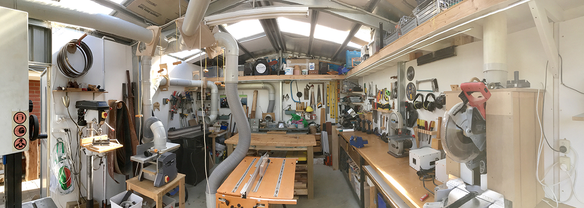

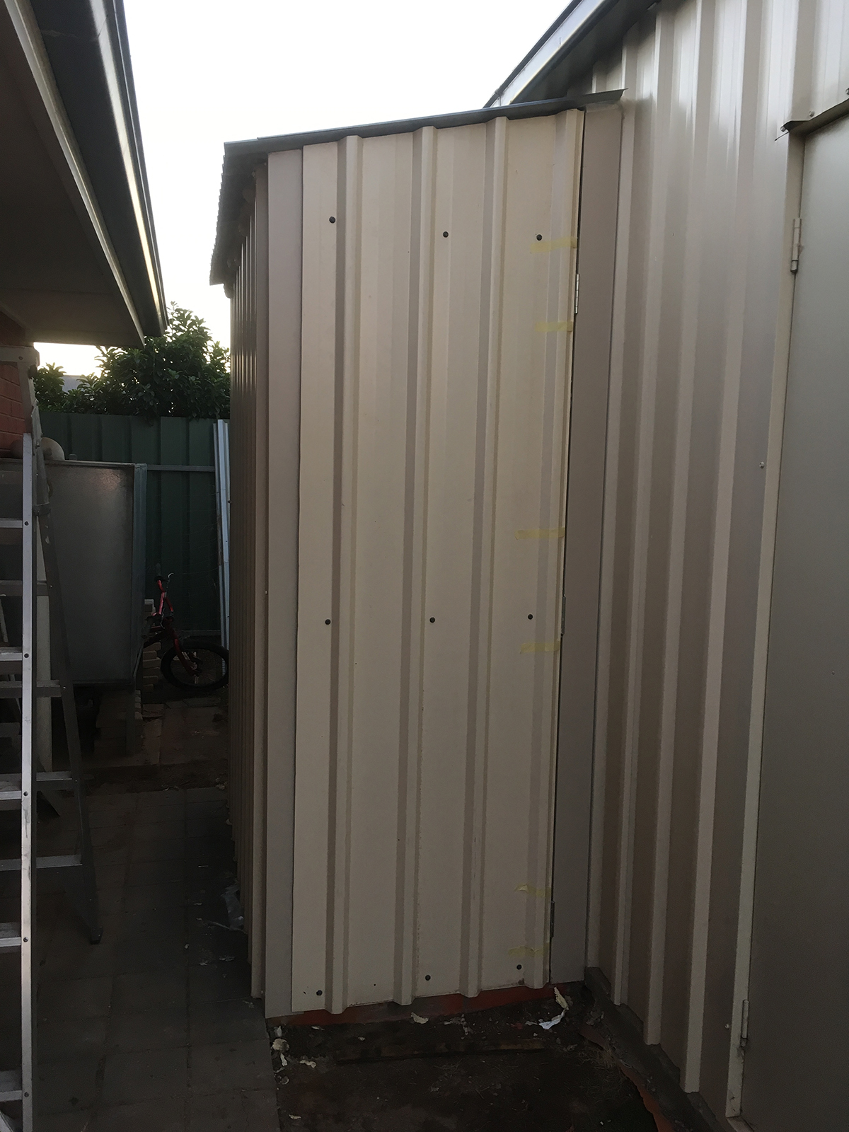

Probably the first thing to consider in installing a dust extractor is where it will be located, inside a shed is not an ideal location as you will be breathing in all the dust that the extractor is unable to contain. I have mine located outside the shed in its own shed and the duct runs through the wall into the shed and to the various machines. We need to start with the actual ability of the extractor to remove the fine dust at the source, to do this we need to look at the real statistics of the dust extractor not what the manufacturers put in their specs or what the salesperson says because they are both wrong (through real world testing). The minimum cfm (cubic feet per minute) draw that is required to keep us safe and healthy is 1200cfm, most manufacturers claim that a 2hp dusty draws this and it is based on the speed of the impeller with nothing attached to the extractor before or after the impeller. This means no machine hooked up to it and no ducting either, nor are there dust bags or filters. A 2hp dust extractor can only draw a max of 900cfm once everything is hooked up, it is not enough. 3hp single phase with two bags and filters is the minimum that will draw 1200cfm, this also depends on the size of ducting you intend to run. 1200cfm can only be achieved with 150mm ducting, 100mm ducting will only draw 400cfm. Machine ports are a standard 100mm which also need to be addressed as they too will only allow a total of 400cfm to be drawn even if you directly attach a 150mm duct to the 100mm port. As for filters, weather they are pleated cartridge or needle felt filters, they both only allow sub 3 micron dust particles to escape, but these particles will still do damage to your lungs, that is why the dust extractor needs to be either in its own shed or fully enclosed in the shed and vented to the outside away from doors and windows in the shed. Pleated filters take longer to clog up than needle felt filters as they have more surface area, so the time between cleans is longer but they still need to be cleaned to maintain the maximum cfm of the extractor. I have needle felt filters and my extractor is in its own shed. The length of ducting needs to be kept as short as possible and the type of ducting is also important, flexible ducting should be kept as short as possible. Use long sweeping pvc bends to keep flow high and bell mouth hoods on the machines for smooth flow into the ducting. Blast gates should also have a smooth surface transitions inside them and not reduce smaller than the internal diameter of the ducting being used. This information is not just a combination of assumptions on my part, this is from others on the woodwork forum who have used partial counters and other electronic devices to test what really works and what fails. In Australia, authorities have designated all timber as being carcinogenic.
I will post some pics of my shed so you can see how it works. Or here is a link to what I have done http://www.woodworkforums.com/f200/lets ... -do-214143

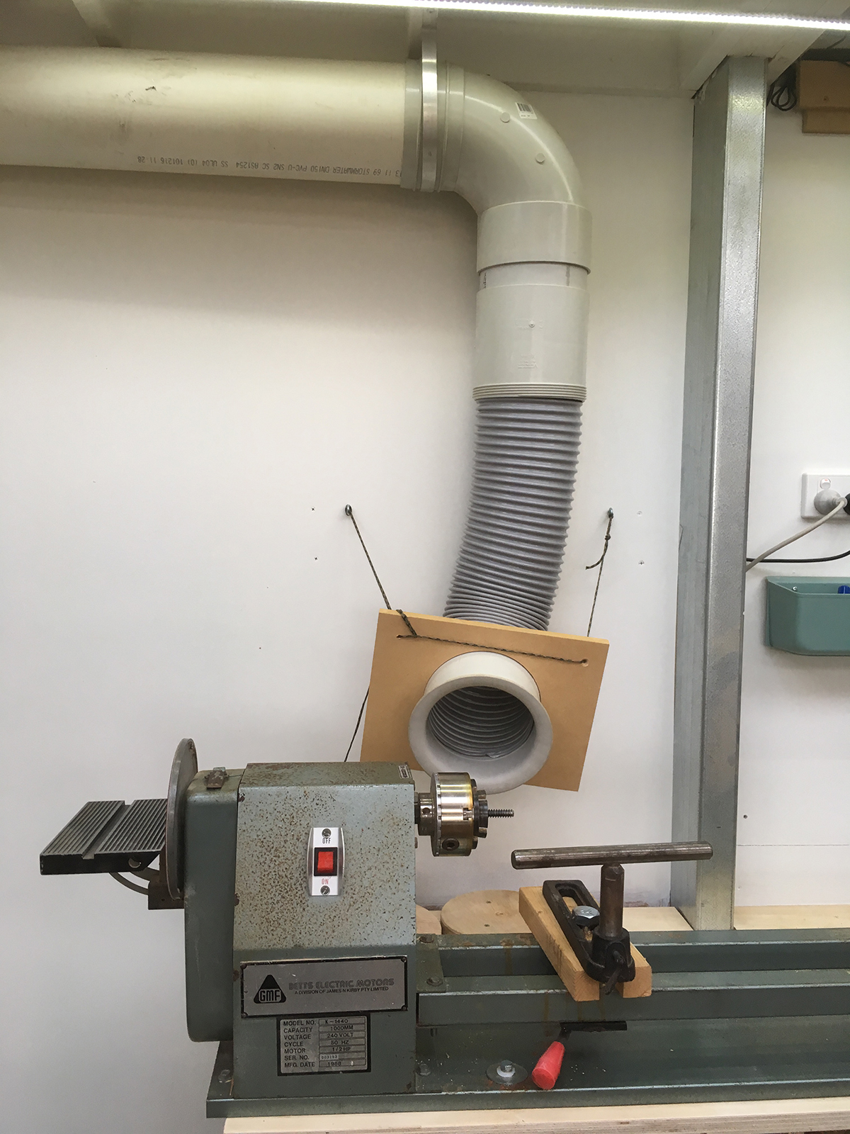

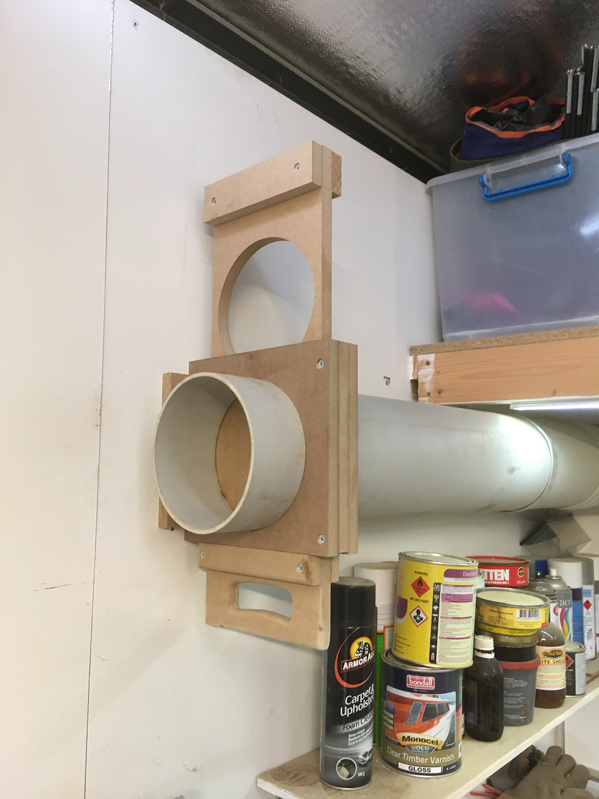

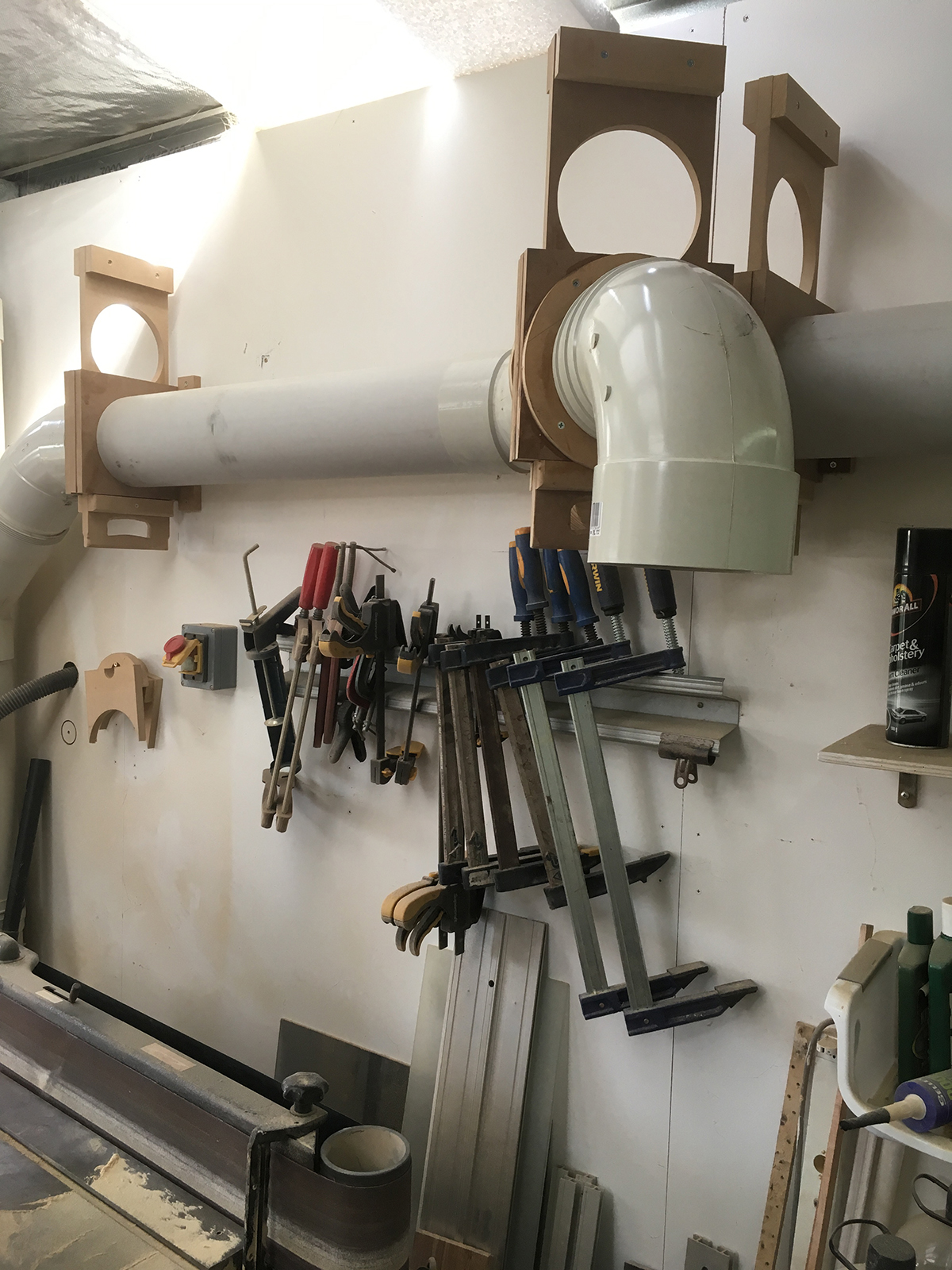

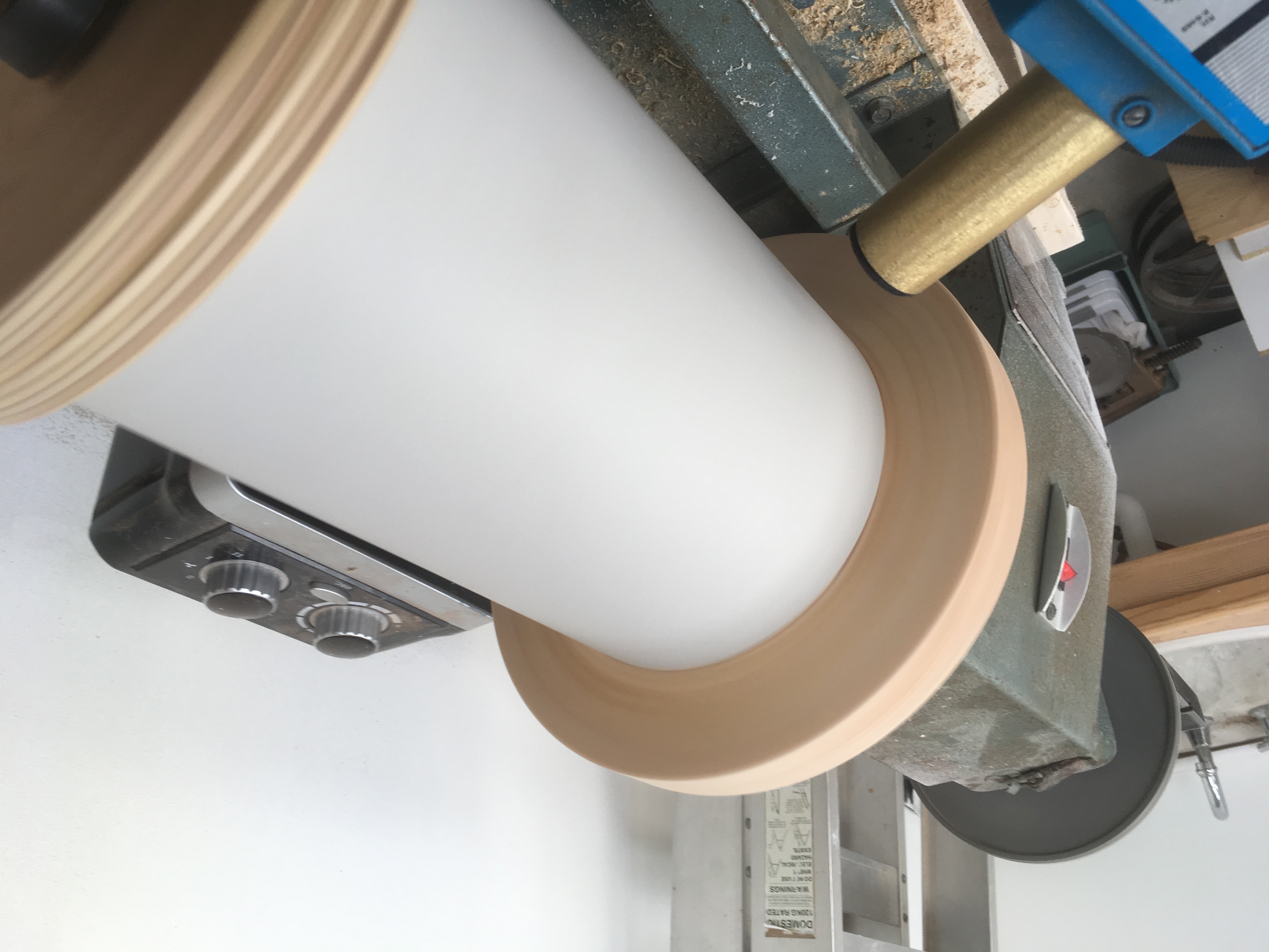

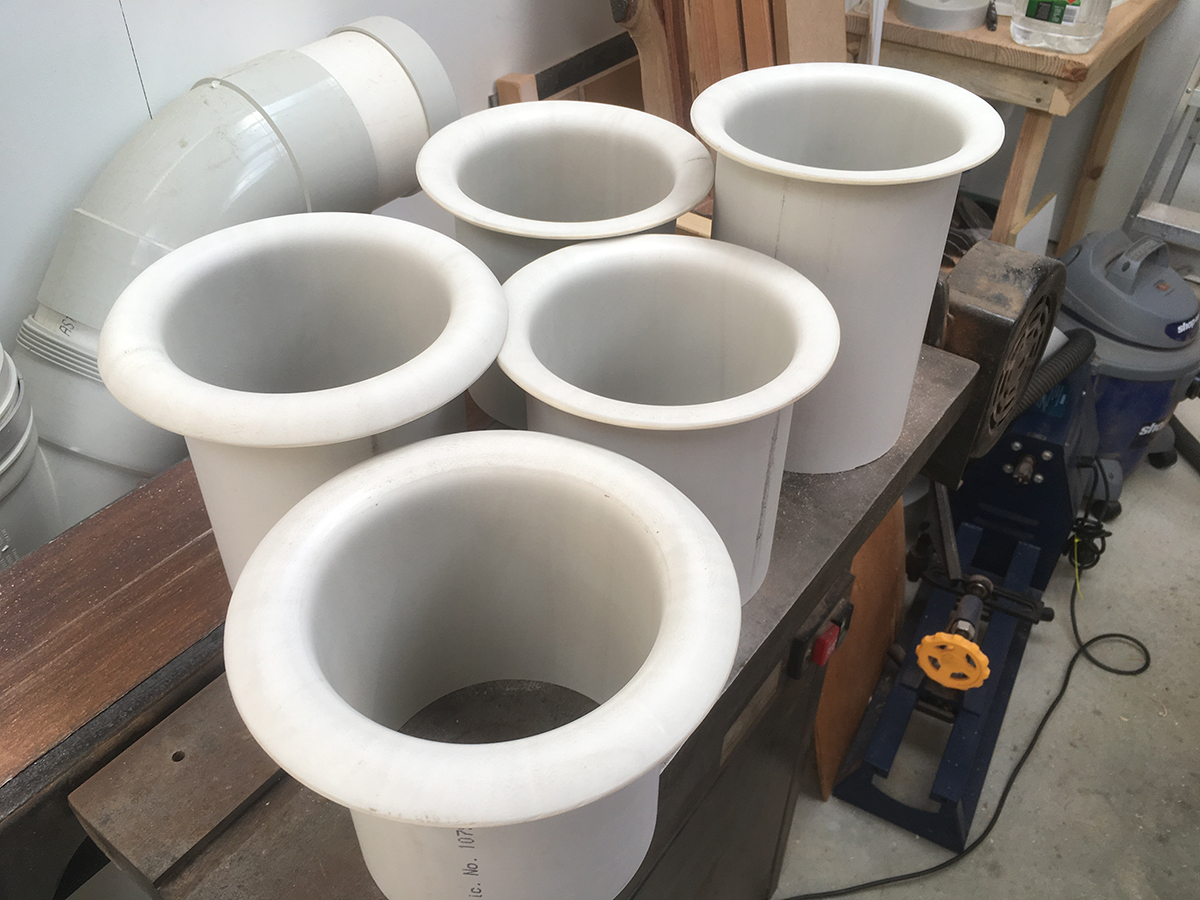

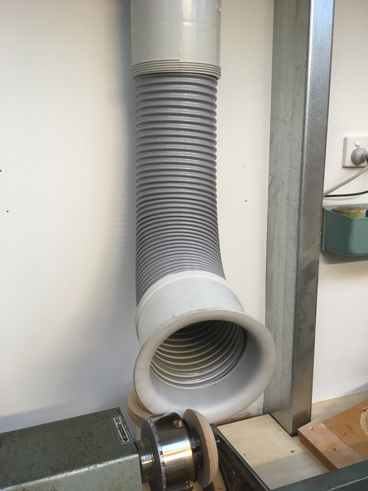

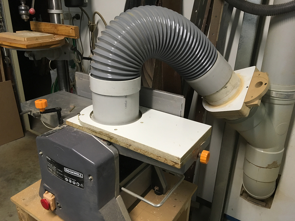

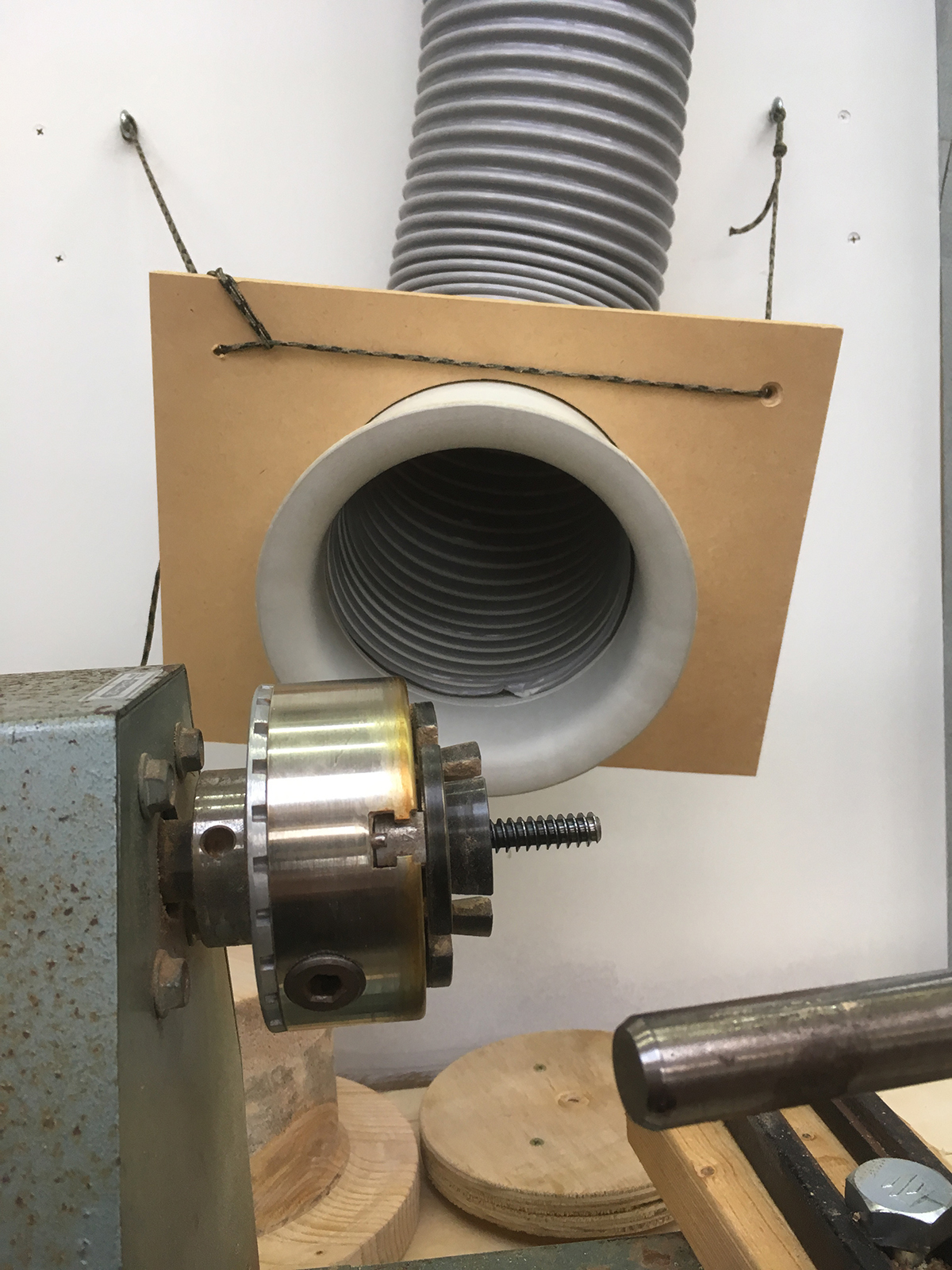

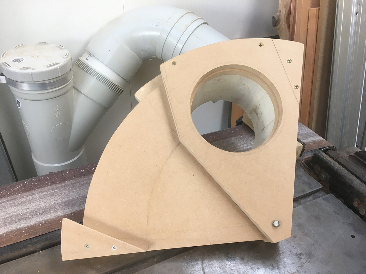

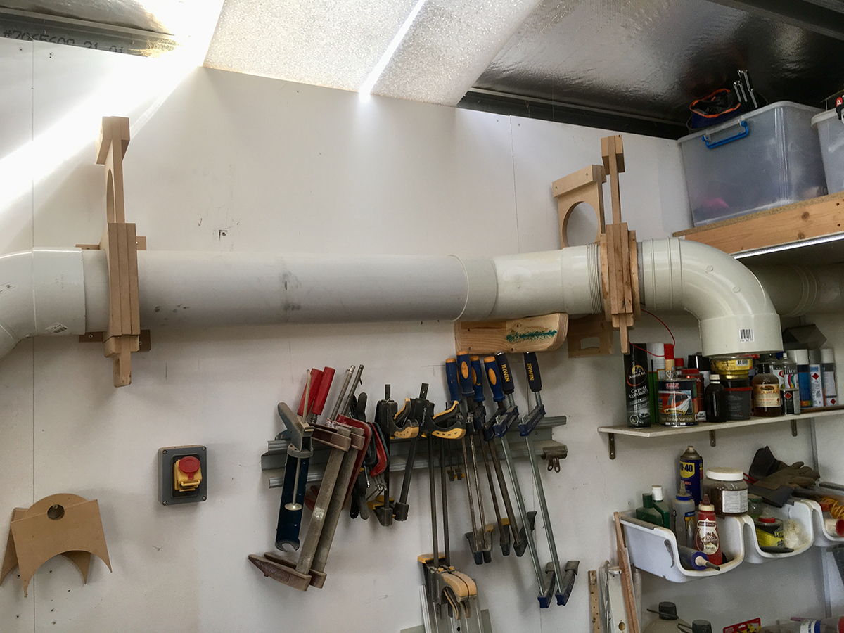

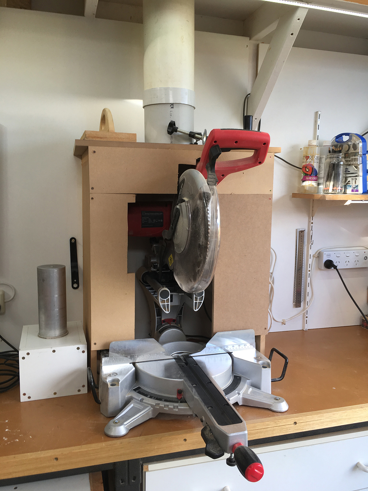

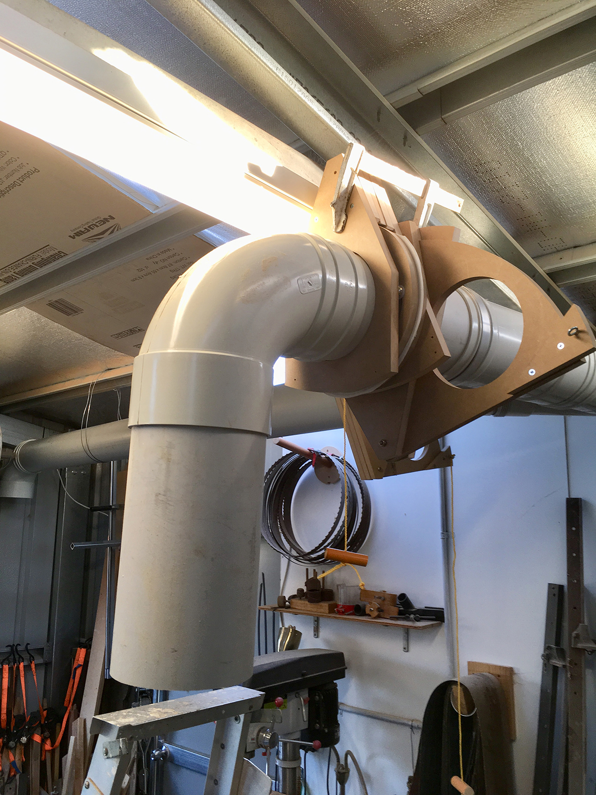

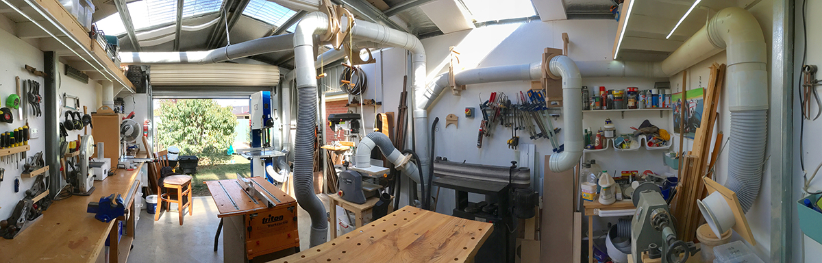

ok, here are some images of my setup, in no particular order. the only machine I don't have with 150mm ducting is the bandsaw, its not exactly mine so I am not going to cut it open to the 150mm duct size. since I took these pictures I have added a large bell mouth hood the the belt sander.

Like the blast gates.
Joseph.

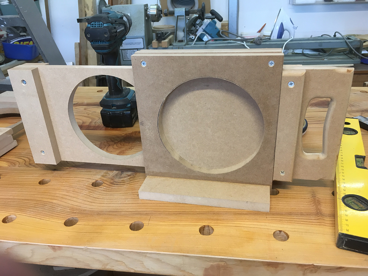

The only thing with spiral metal ducting is that it is not smooth internally like PVC, it will create turbulence especially around the bends and reduce the efficiency even with a 4hp extractor. I think the radius on the bends are tighter as well which reduces flow. It will be more expensive than PVC also. Bill Pentz is an amazing man, his clear view cyclone is the best on the market. Be aware that Bill is using larger ducting ( I think it’s 7”) than we have here in Aus and his extractor is set up accordingly.
Thanks Joseph, the straight ones are an adaptation of others I have seen and the rocker style was designed by BobL from the other forum, he has a template in one of the threads. As were the bell mouth hoods, I made a wooden former on the lathe and sat the PVC on it then used a heat gun and a blow heater to soften the PVC enough to create the shape while tightening the tailstock on the lathe.

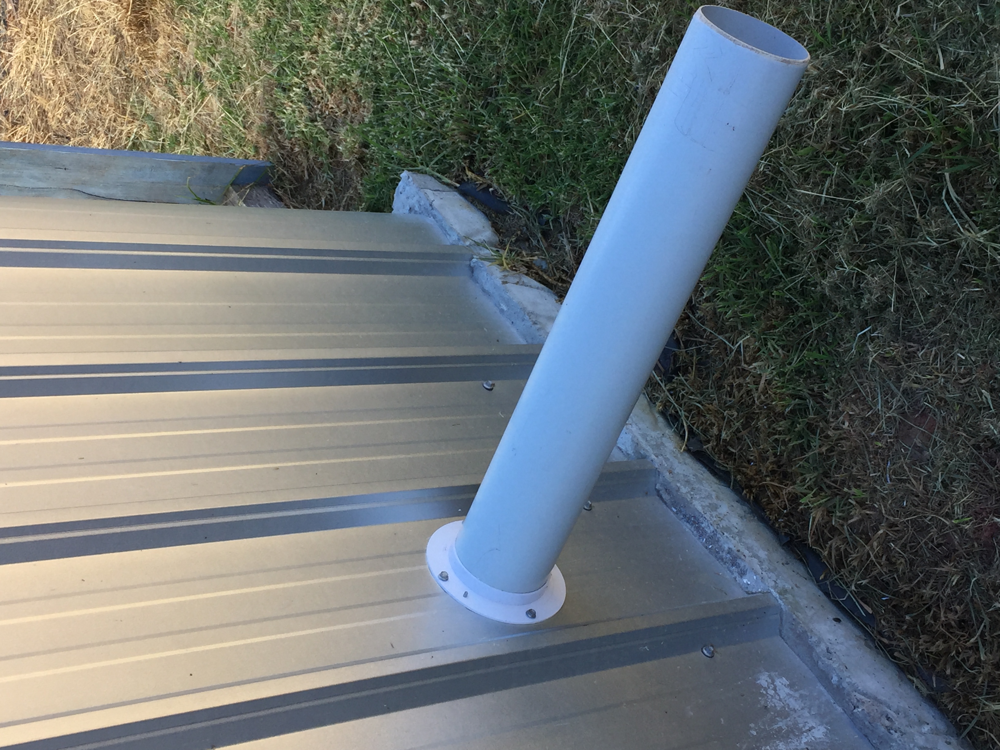

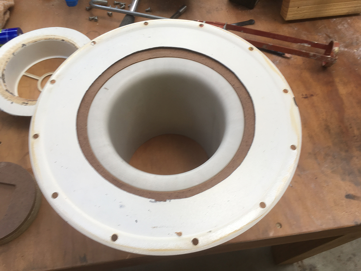

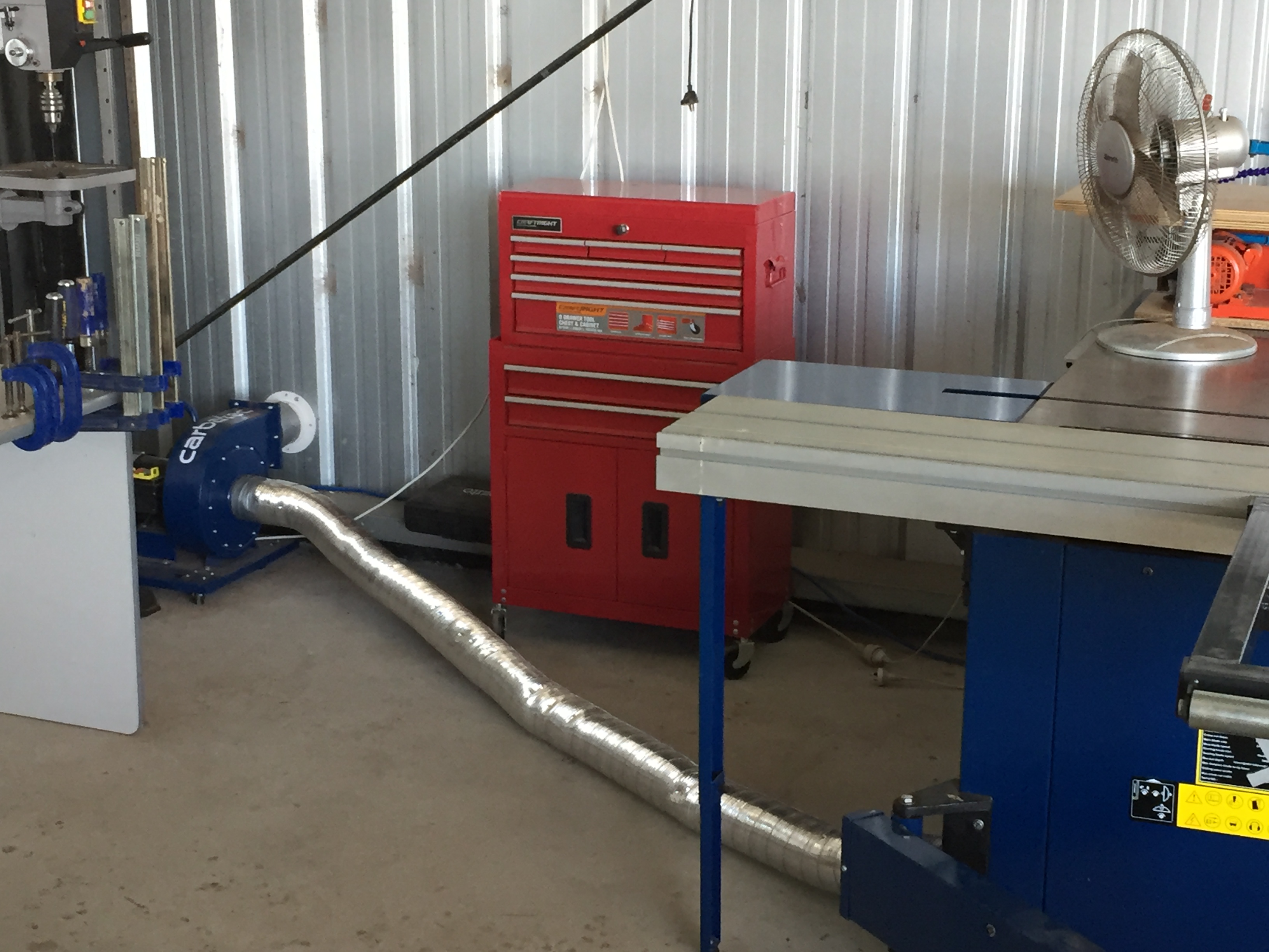

Here’s what I’ve ended up doing.
1hp Carbetec extractor shoots straight thru a hole in the shed, which I flanged with some pvc fittings.
I actually decided to buy a table saw before a drumsander but the ducting I used to go from that to the dust extractor is an aluminium semirigid thing that I wouldn’t recommend or ever get again.
Chips from the saw blow into the paddock behind the shed for now.
Joseph

Joseph Jones
Posts: 77
Joined: Wed Aug 08, 2018 11:56 am
Location: Narrikup WA
Re: More on dust extraction
Post by Joseph Jones » Sat Jan 19, 2019 11:34 am
Some photos...
