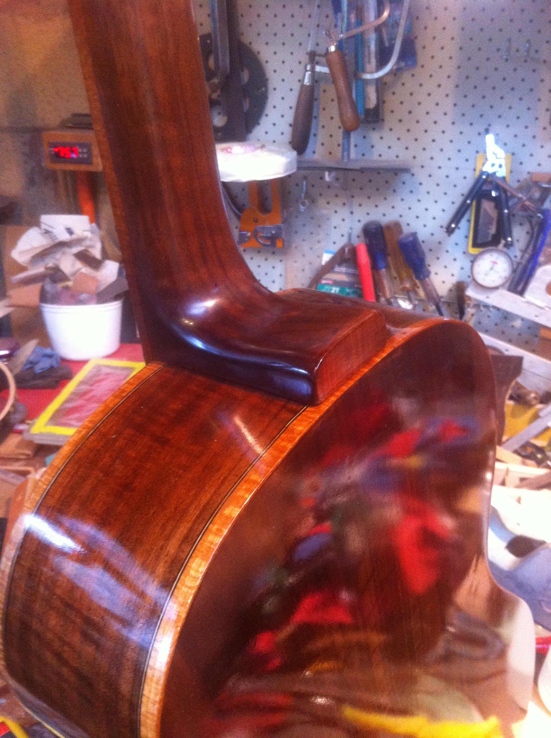

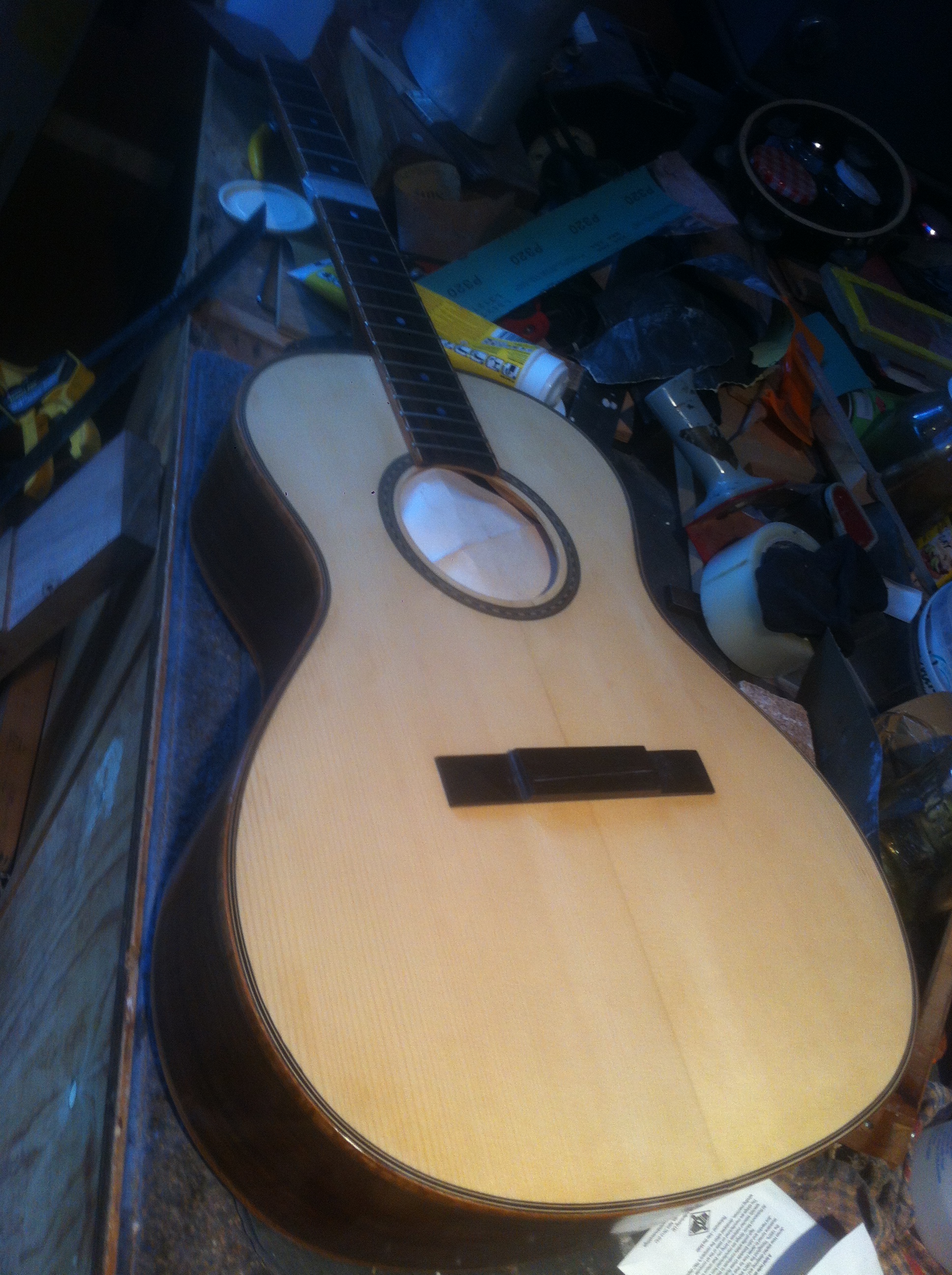

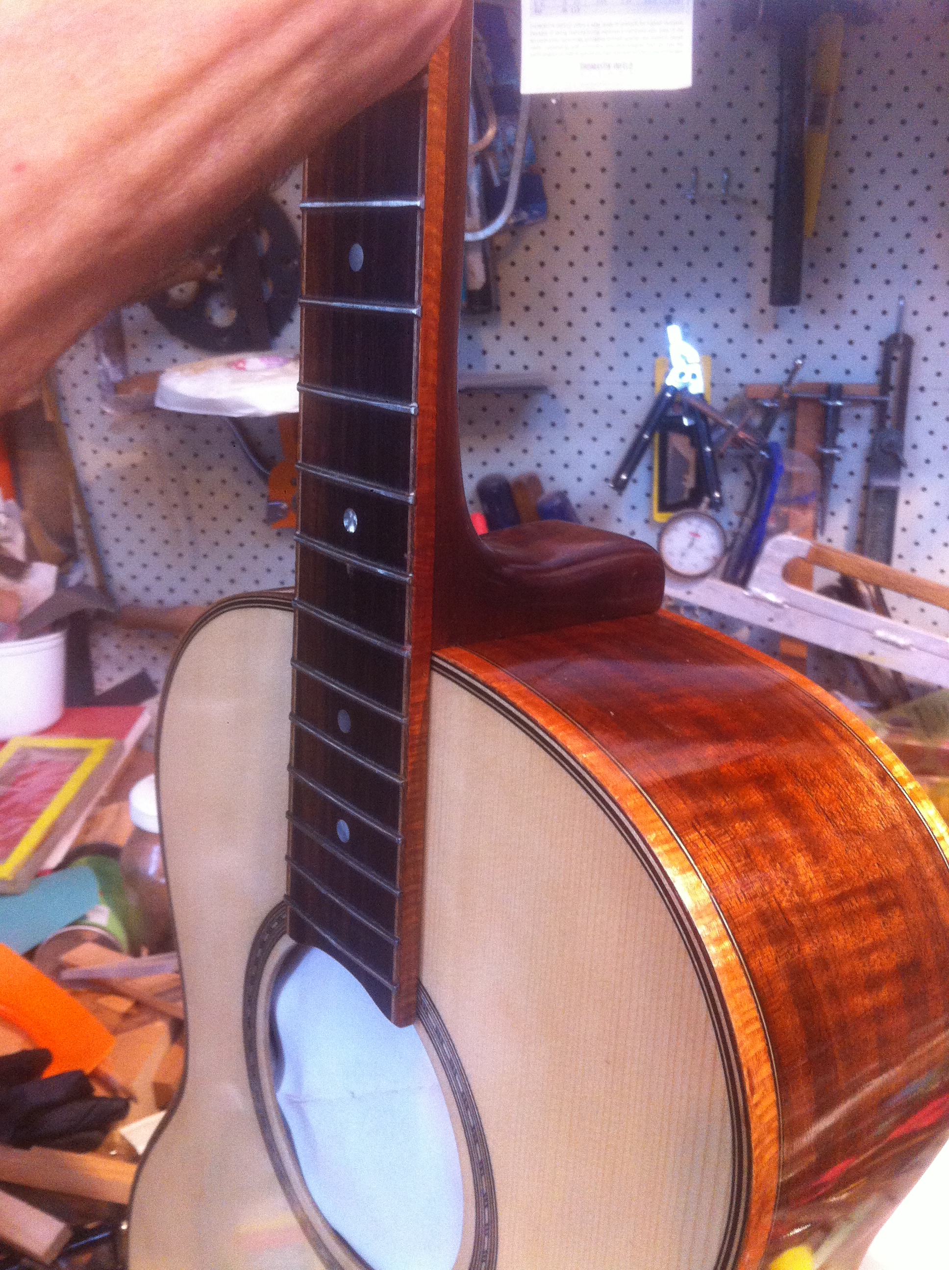

I thought I might get that question re pics...so many amazing builders on this site and some fantastic builds, makes me feel a little shy, but here goes in the interests of the aforementioned Walnut binding colour scheme...this guitar will be strung up and the bracing fine tuned soon, so looking forward to that process the most, ie hearing what I've done this time, and also a new body shape build for me, along with my own variation on the bracing...Pix taken on a rotten old iphone 4 which is on its last legs. Cheers! Ross

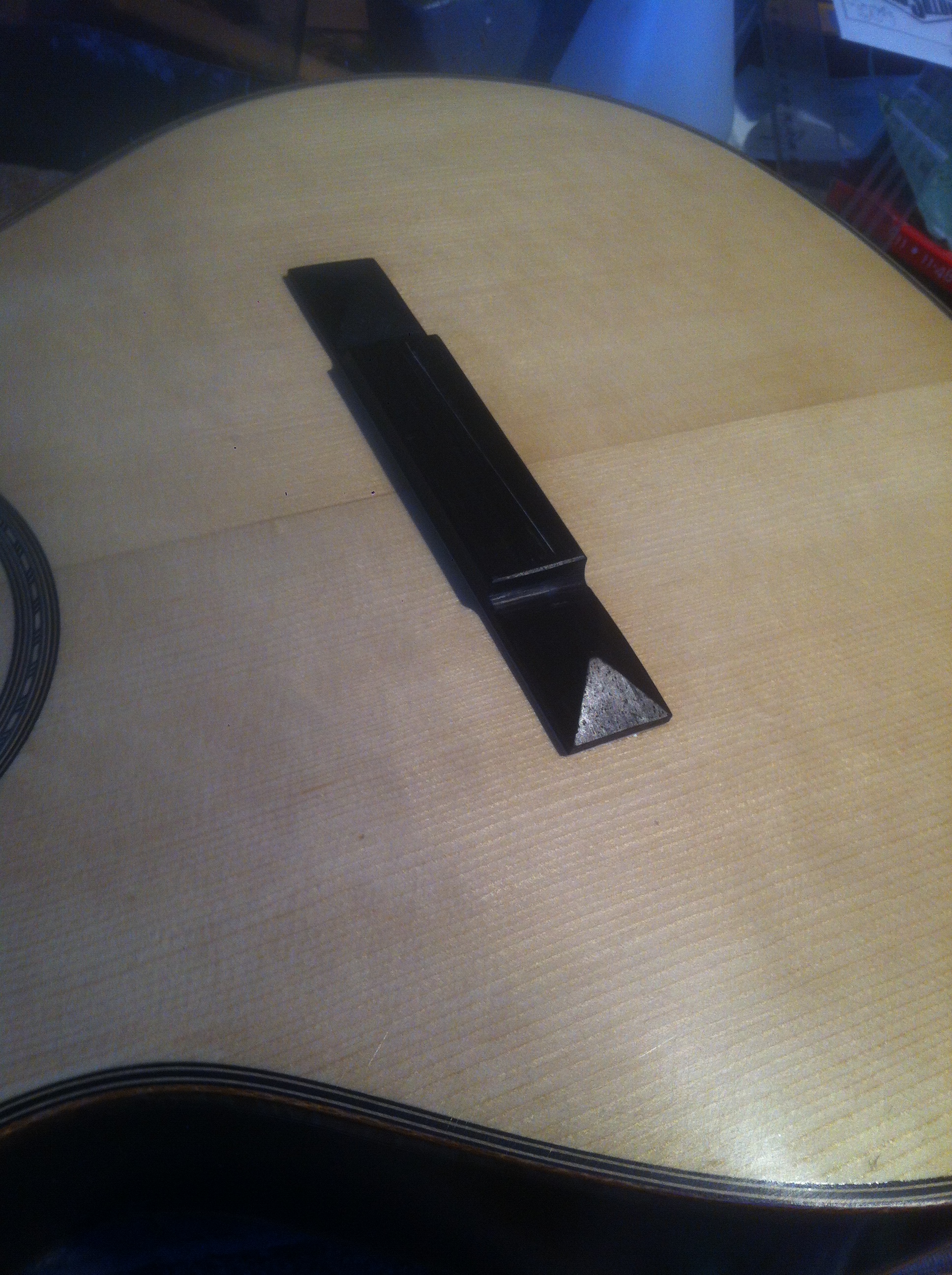

A couple more...pyramid bridge. The soundboard is lightly braced, but with the taller thinner Gibson L-OO brace profile.

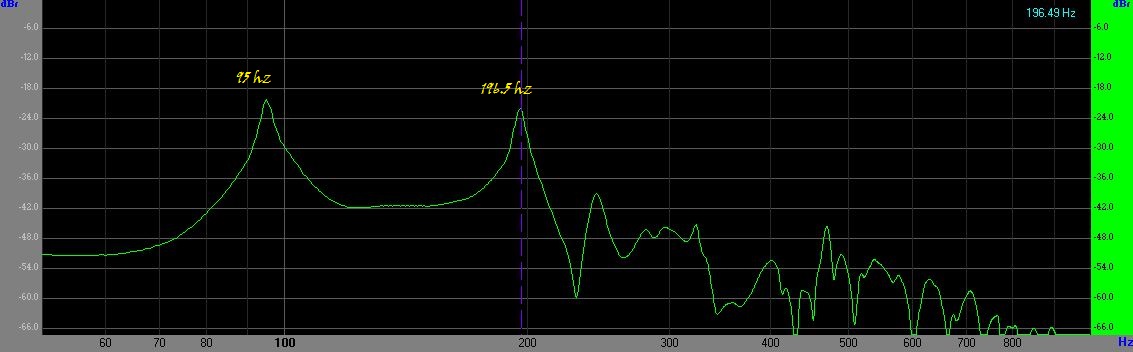

25 ft soundboard arching 15 ft back arch- I closed the X a little then forward shifted that, as well as adding extra finger braces, slightly re arranging the tone bars to stabilise the lower bout after the braces had been moved; all designed around a short scale 13 fret body join. Closed without the brace tuning and no bridge, I have also put my initial Visual Analyser shots. I expect the bridge mass to drop the top to around 185-190. A little concerned re the already low Ti 1,1 resonance dropping off the radar as dropping the soundboard resonance usually pushes that one down due to the frequencies repelling each other.
