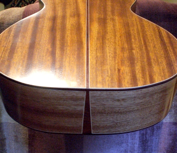

Post by Mark McLean » Wed Dec 12, 2018 6:46 am
pic 9.JPG (205.15 KiB) Viewed 22466 times
This is maple veneer as purfling with cocobolo binding strips. Very simple to cut from sheets with scissors. Glues, scrapes and sands well. I bought it in Sydney. I am sure you would find a supplier in Adelaide.
