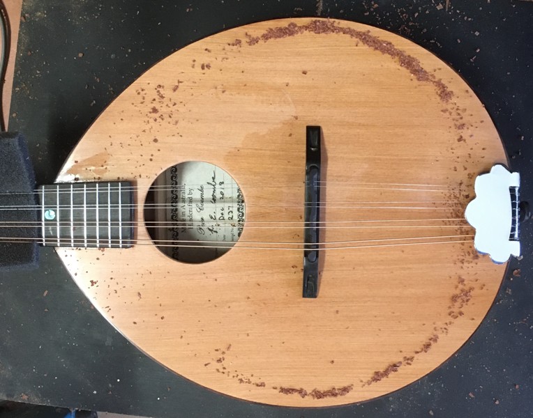

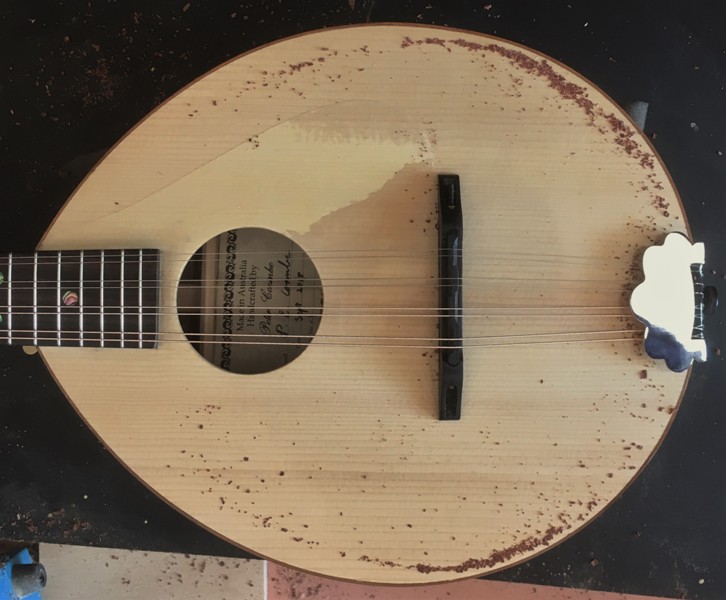

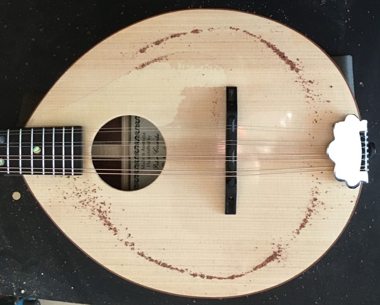

Here are pictures of the Chladni patterns of the main top mode. The Gidgee mandolin is obvious and it looks very similar to all the other flattop mandolins I made beforehand.

- Gidgee top mode 474Hz.JPG (100.47 KiB) Viewed 6300 times
- KBP main top 456Hz.JPG (116.39 KiB) Viewed 6300 times
- Walnut 465Hz Top mode.JPG (88.38 KiB) Viewed 6300 times

Peter that's very interesting. Trying to understand what is going on.
Presumably the actual frequency of the back shouldn't matter because we are not hearing it. If the node line of the main top has moved outward presumably this would suggest an effect like Trevor's extra side mass...? Perhaps the extra mass of the back is doing something similar. The extra vibrating surface should give you more volume I guess. What do you think?

Nice work, Peter. It seems that the principles in the book can be applied across a whole range of stringed instruments comprising a ported box and strings - which isn't surprising, really. All that changes is the scale (as in size).

Thanks Trevor Yep the principles in the book have now been applied in the mandolin world, but whether or not anyone in the mandolin world actually takes any notice is another question. Tradition is a powerful thing. It has been a bit of, duh why didn't I think of that before. I have read the books, so applying the same principles should have been a no brainer. The main difference in sound I have noticed is the new instruments are more even and sweeter sounding, and the difference is not small, they blow away my earlier pancake mandolins. From my point of view, a big breakthrough. However, it now makes it difficult to sell the older mandolins that don't have this technology! The latest mandolin was finished on 30th December, King Billy Pine and Blackwood (picture in the middle), and the sound is amazing for a flattop, I can't put it down, which was confirmation it definitely works. With a bit more experience, that one has the modal frequencies pretty much bang on what I was aiming for, and I think it is slightly better sounding than the Qld Walnut mandolin (last picture).
