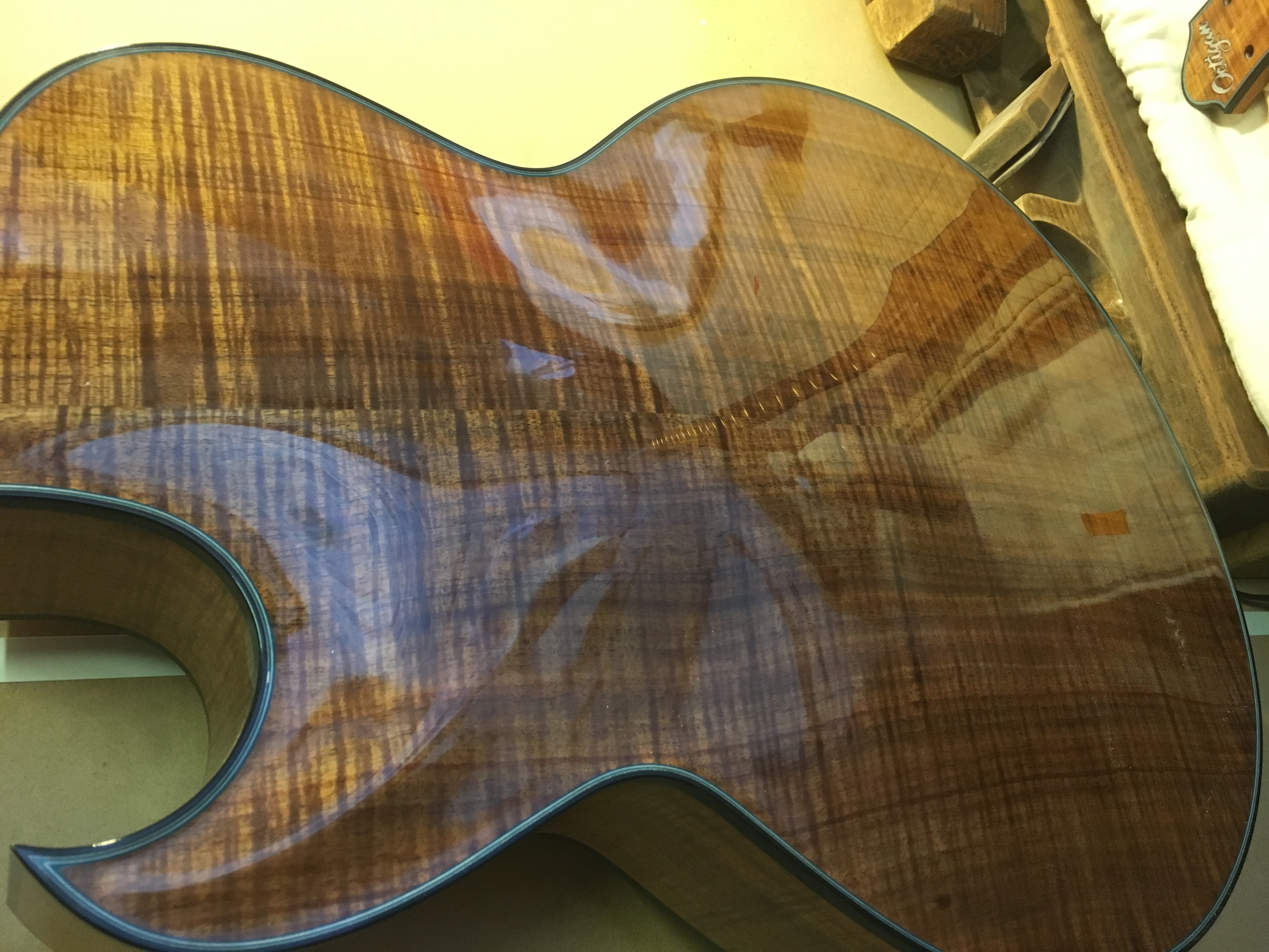

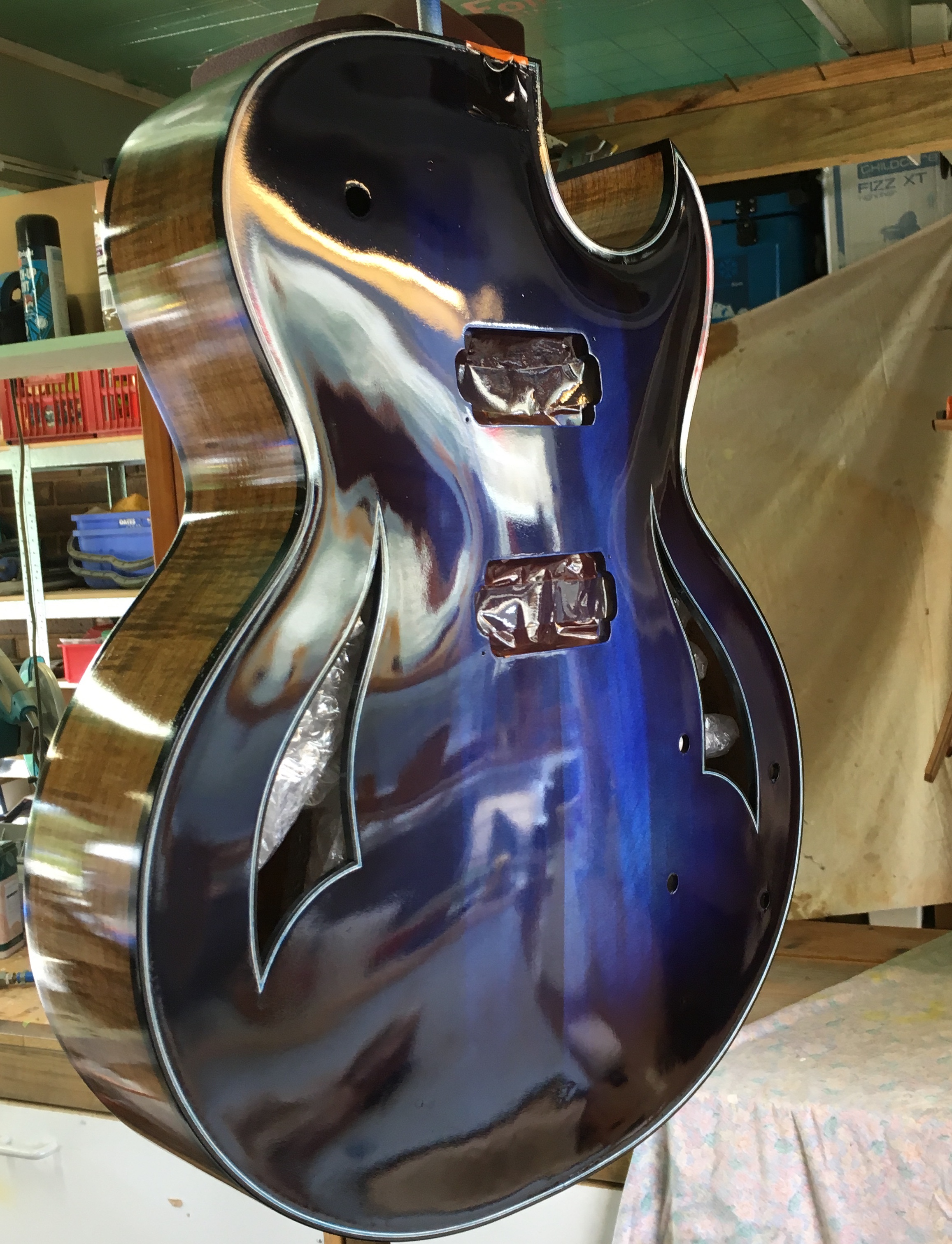

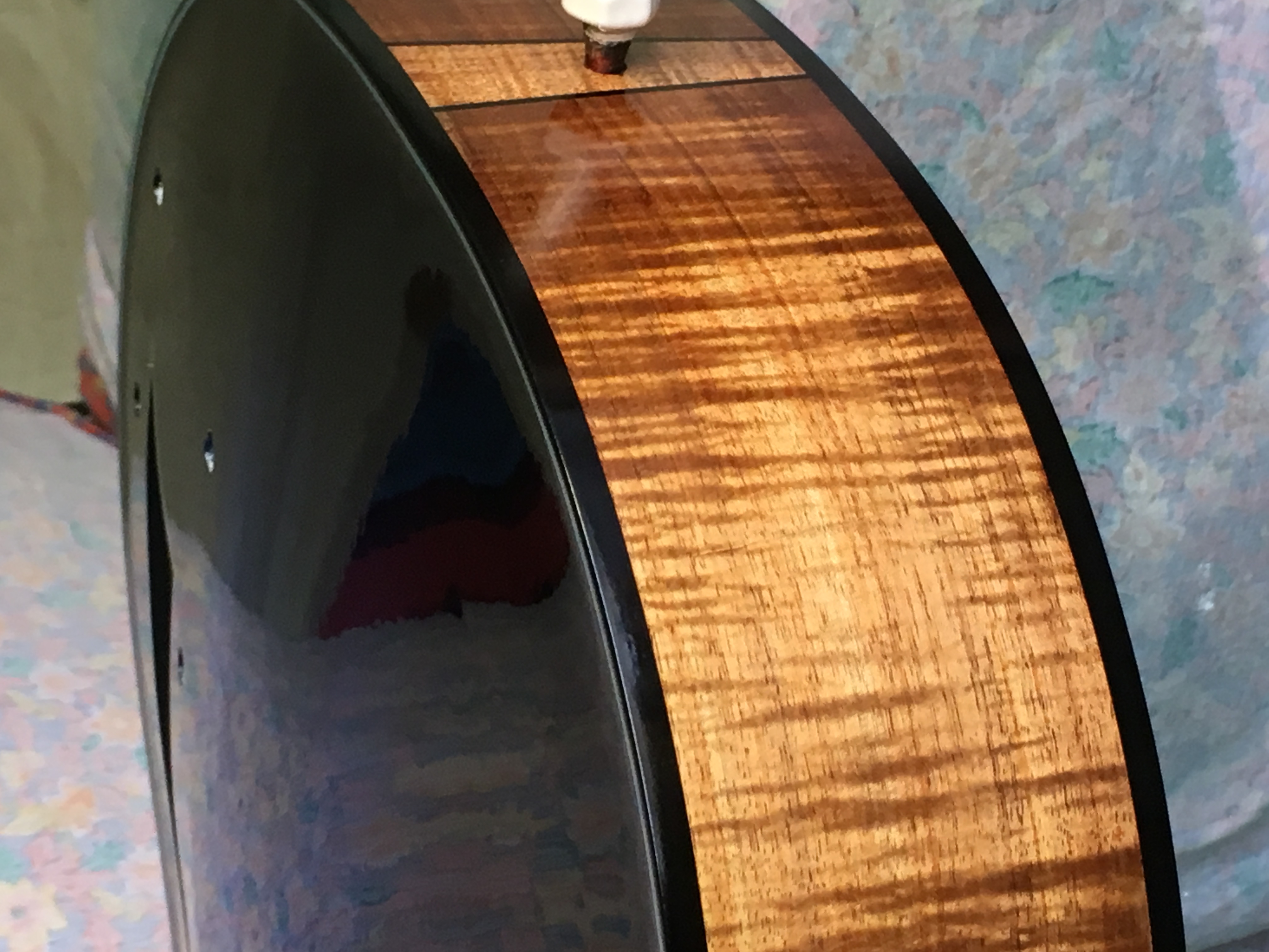

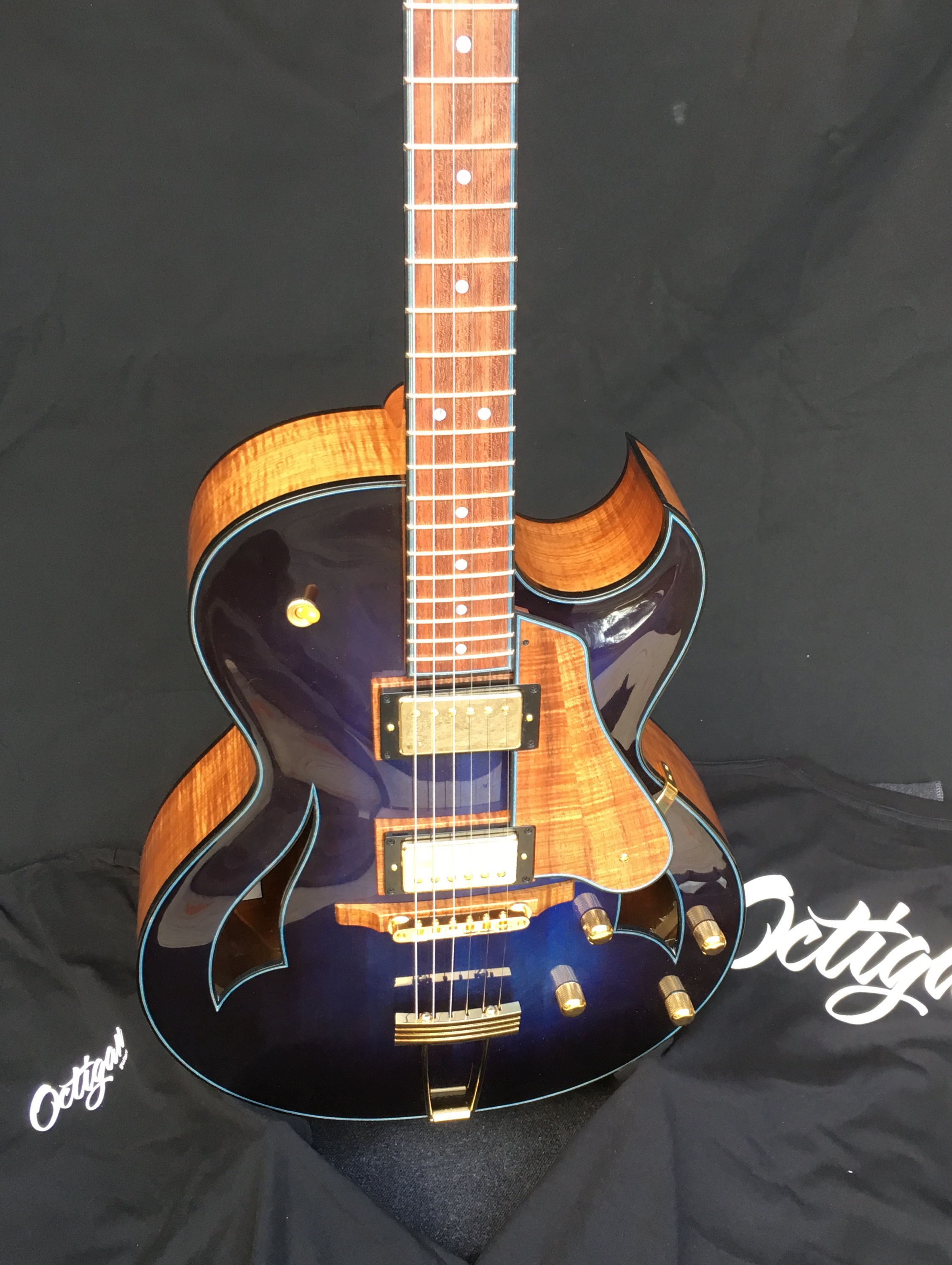

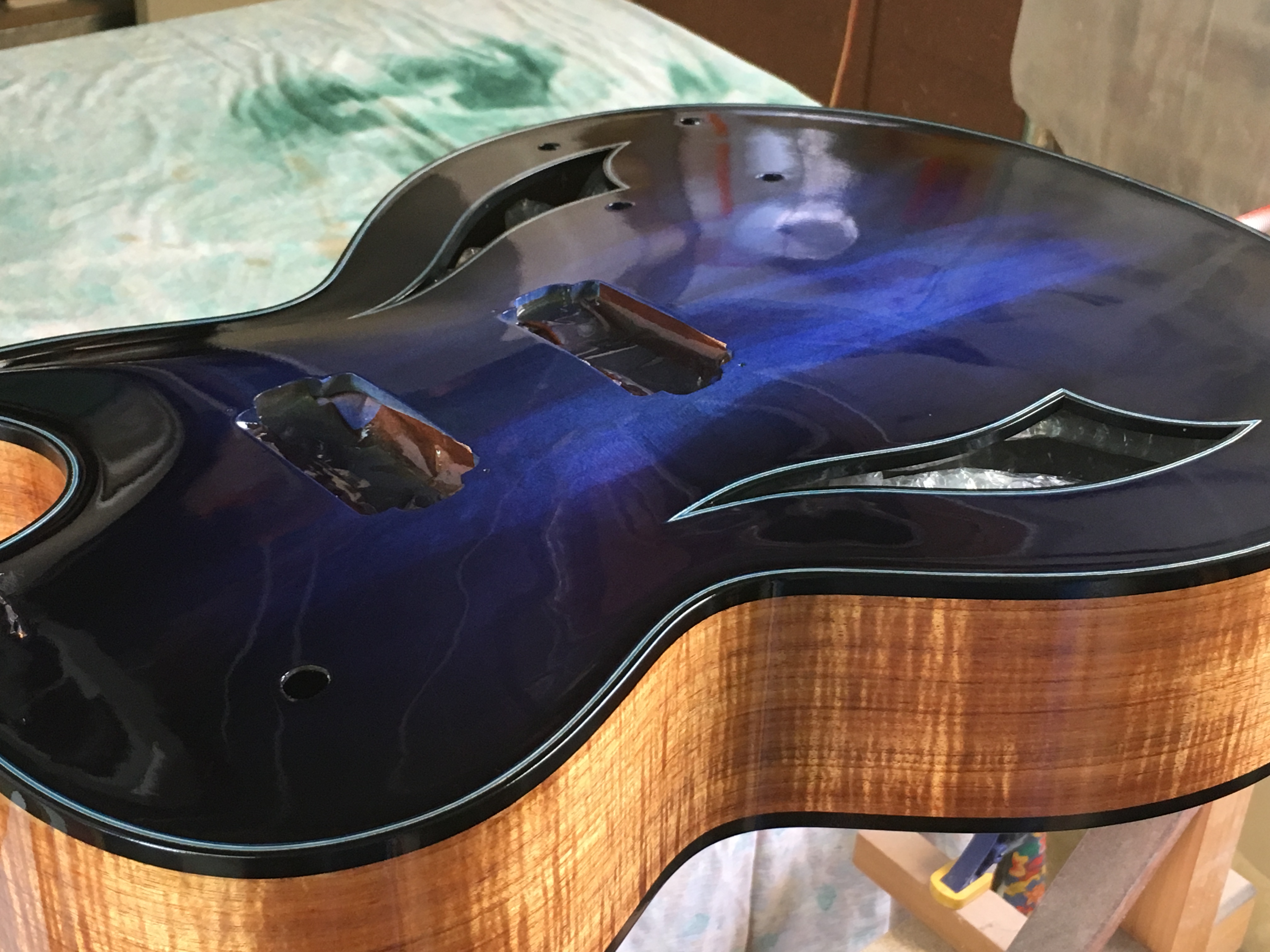

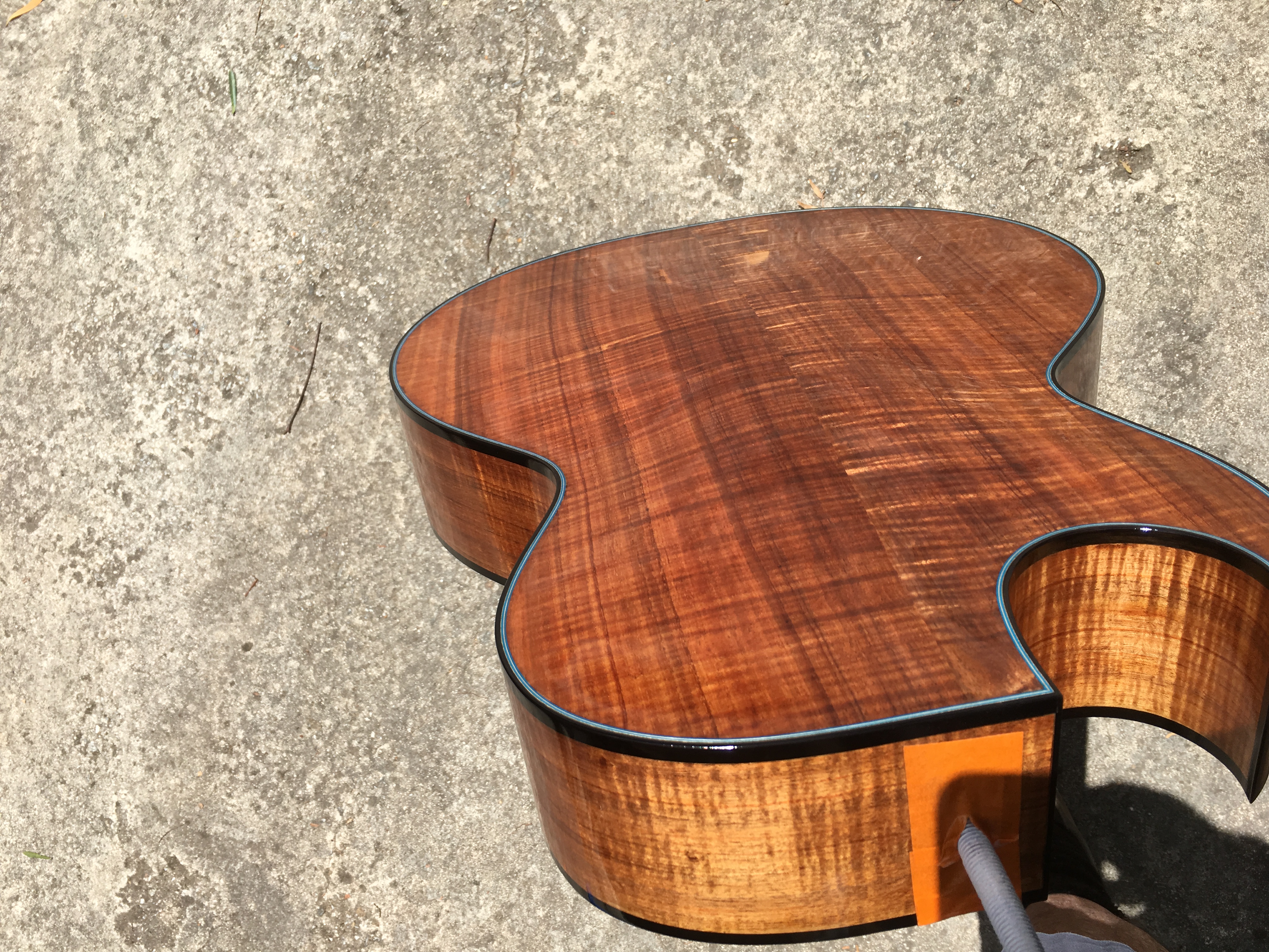

Post by rocket » Wed Jan 16, 2019 10:46 am

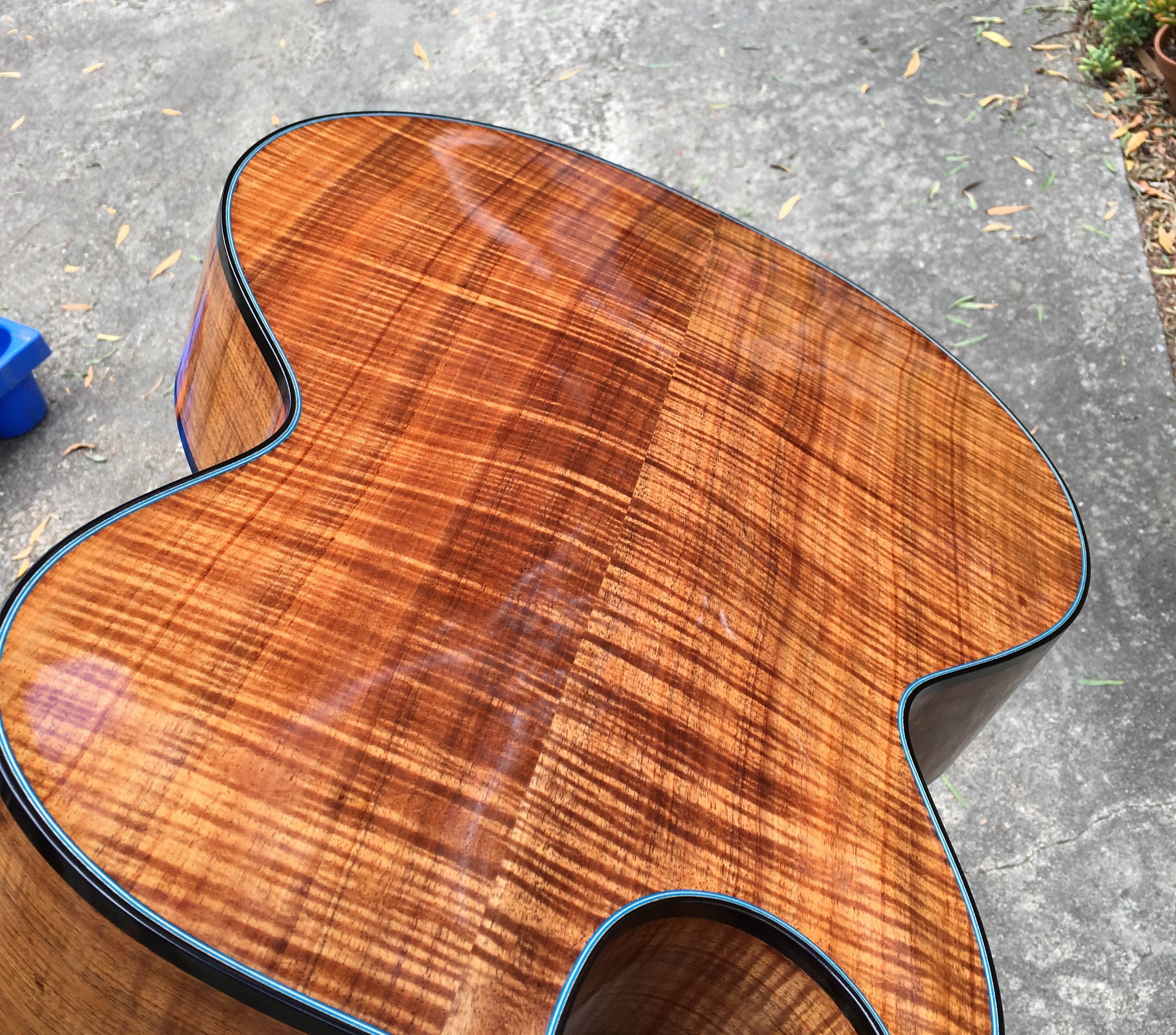

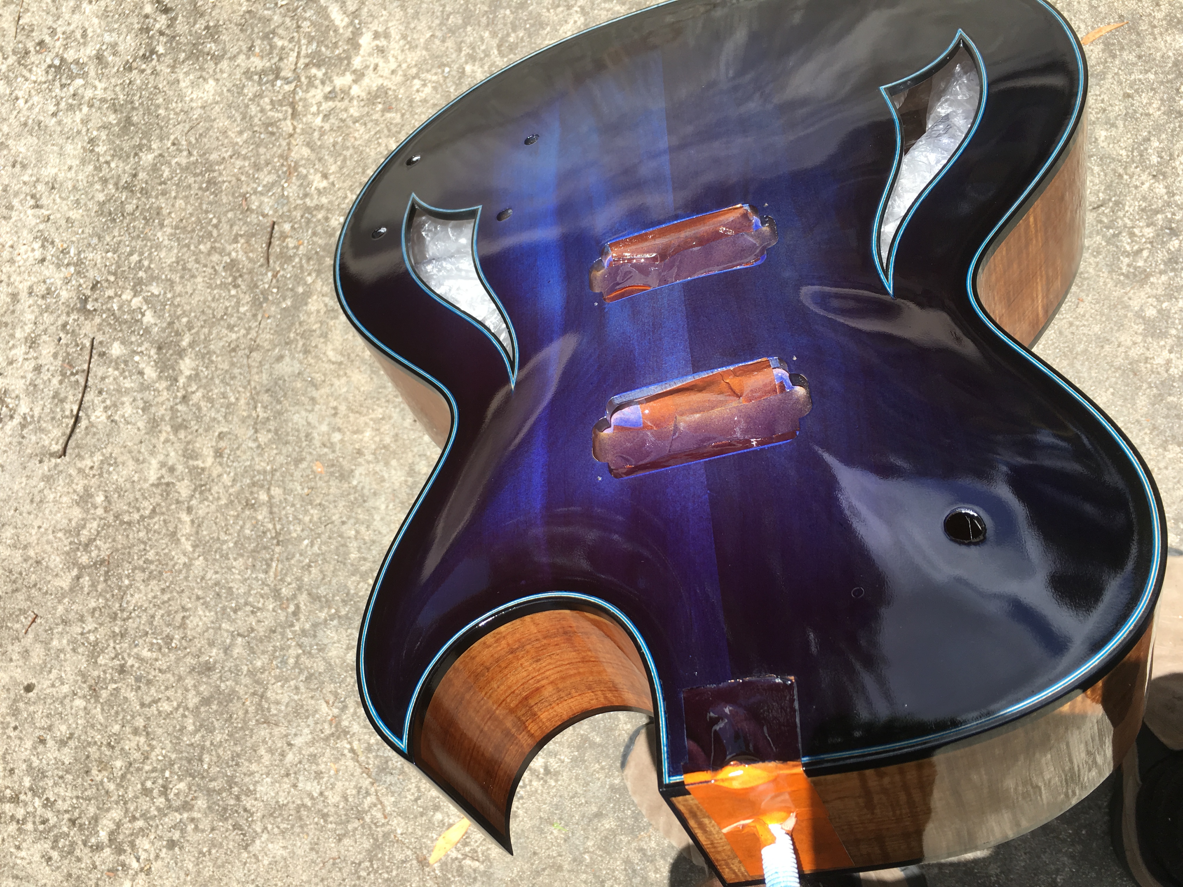

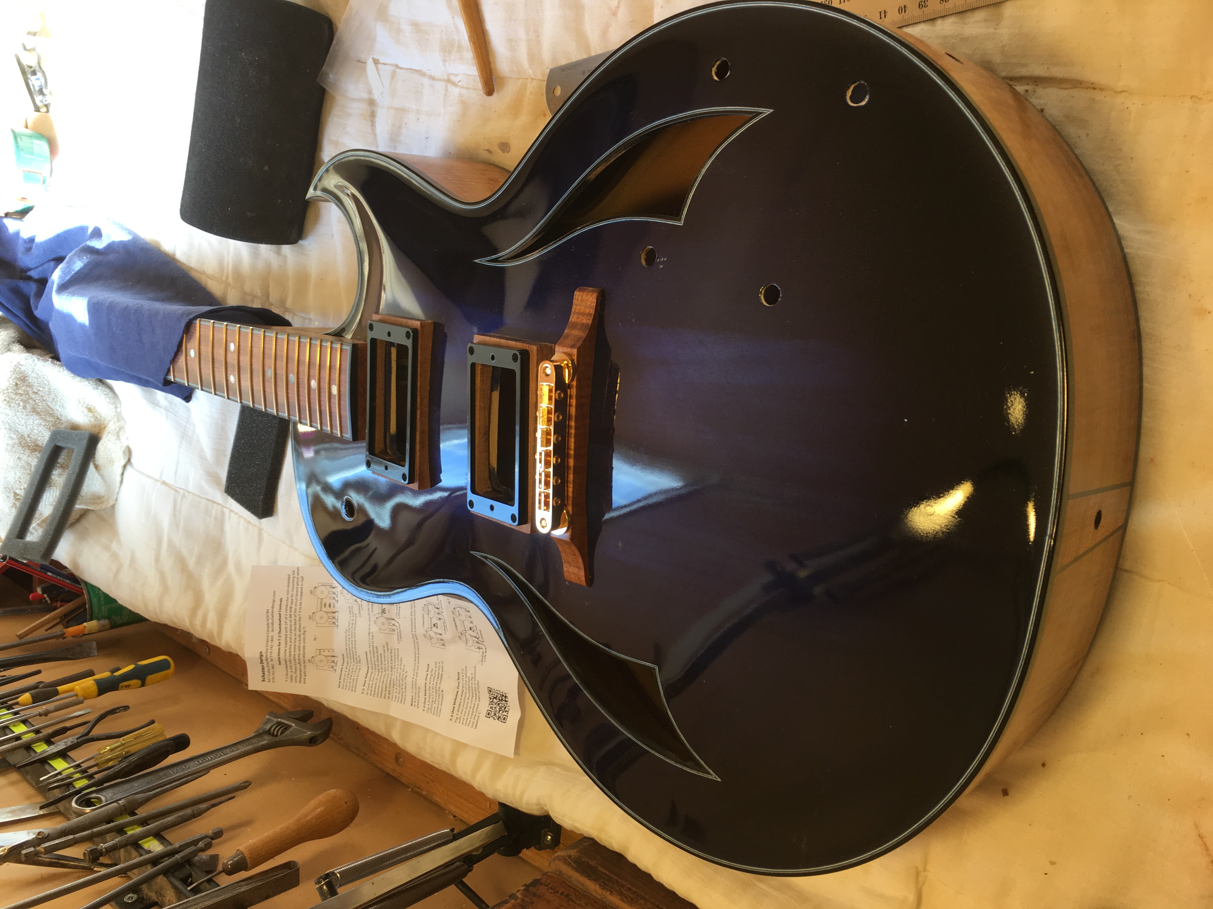

This one is nearing completion final coat of lacquer had just gone on,16 inch Florentine in Blackwood and Kauri, sides are a Blackwood/cf lamination and bracing is via Blackwood/cf laminated full depth beams integrated into the front and back plates.
Built one similar to this a few years back with P90s which sounded very nice but I’ve gone with humbuckers with this one.
25 scale, zero fret,Bubinga fretboard on Silky Oak neck blu wh blu wh purfling and ebony binding.
Apologies for the pics being out of order but I think you’ll get the idea

Post by WJ Guitars » Wed Jan 16, 2019 12:24 pm
Beautiful crafted work and the guitar looks amazing.

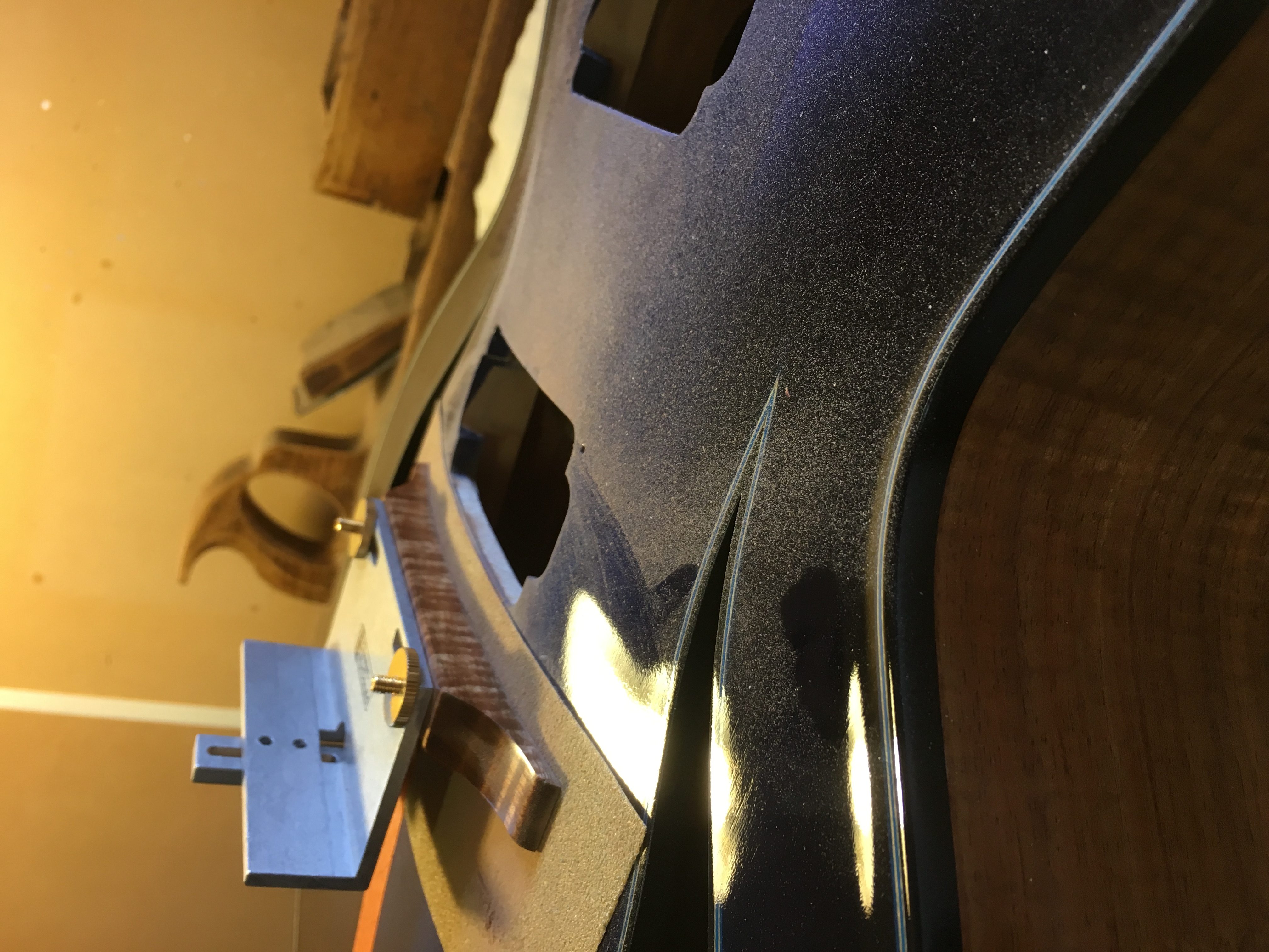

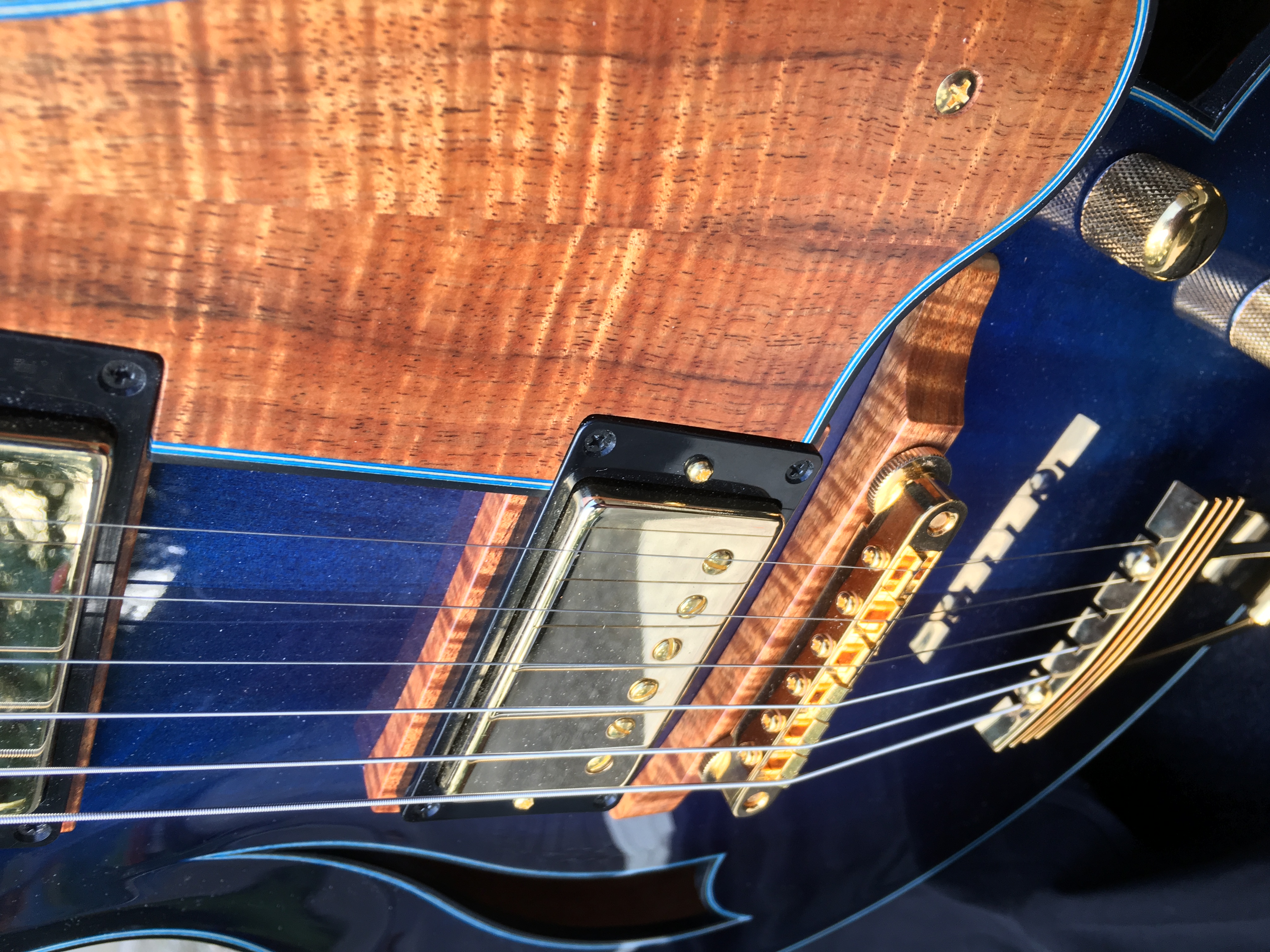

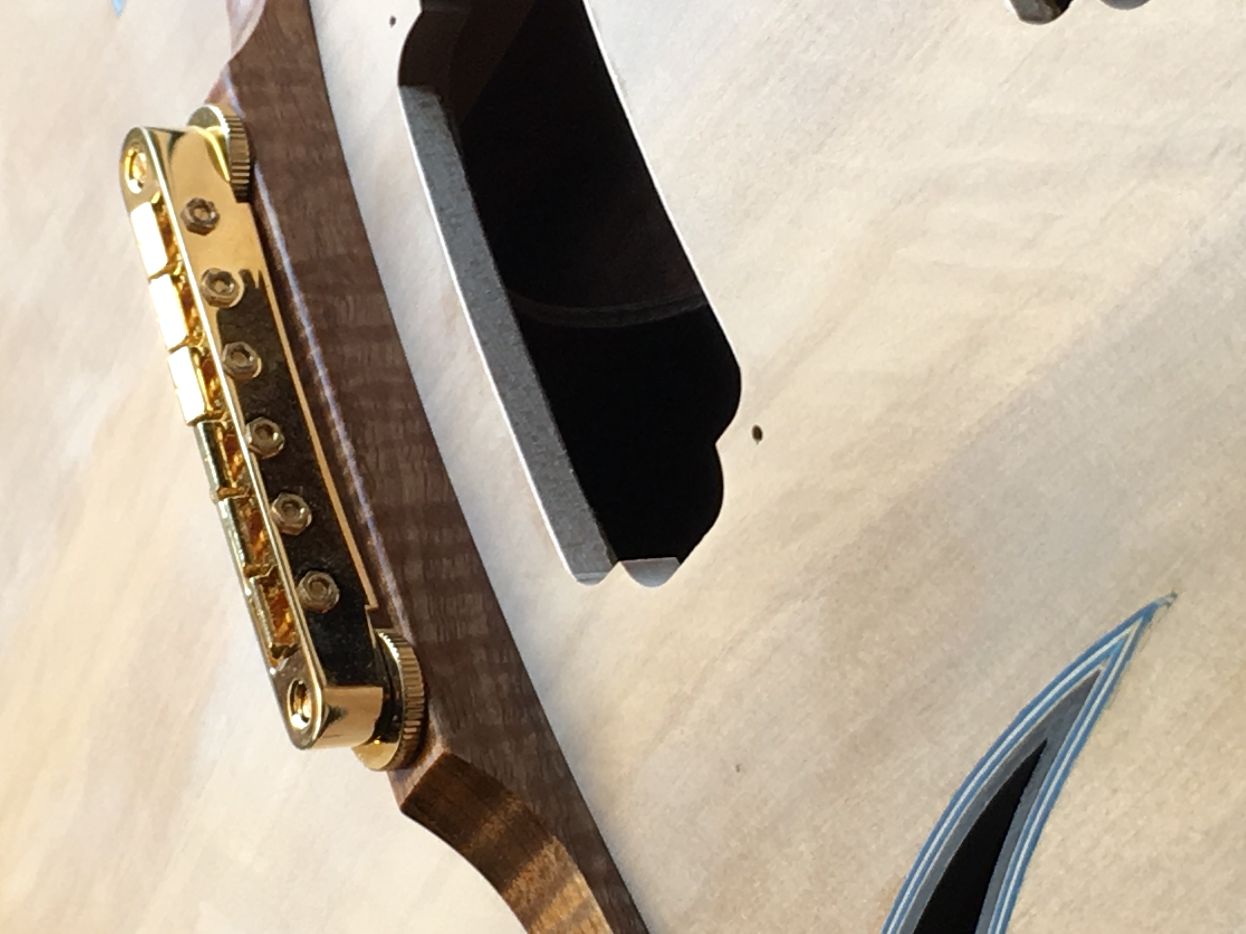

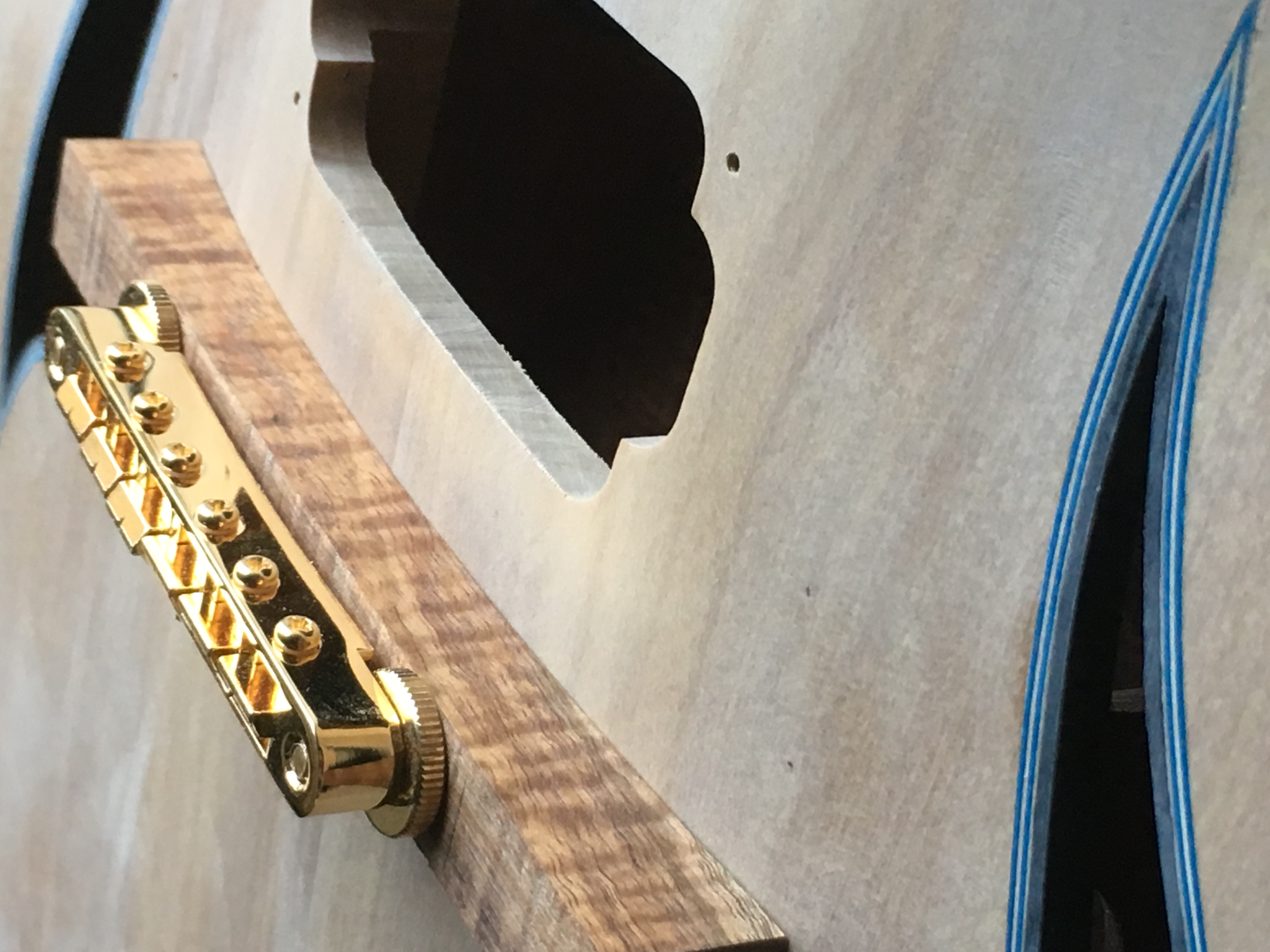

Post by rocket » Thu Jan 31, 2019 7:34 pm

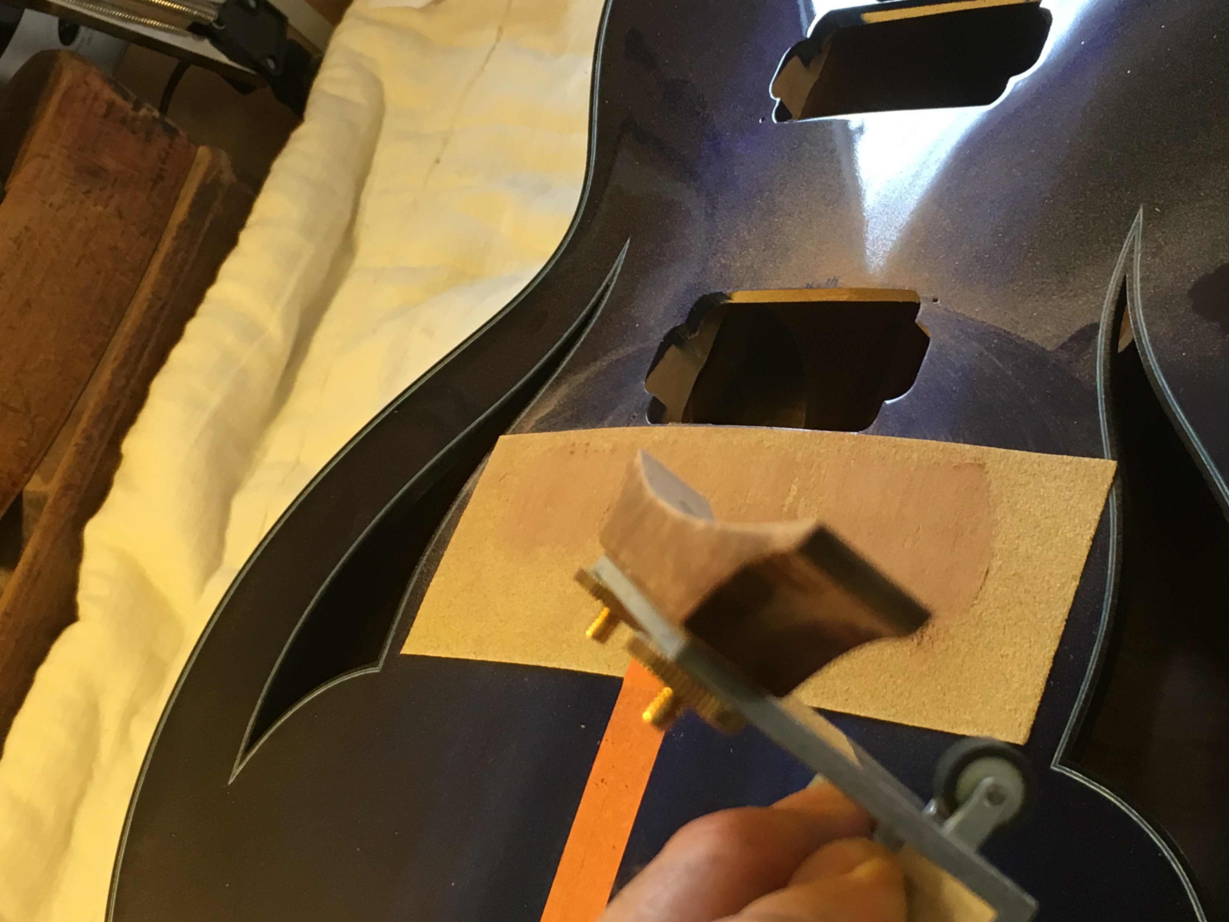

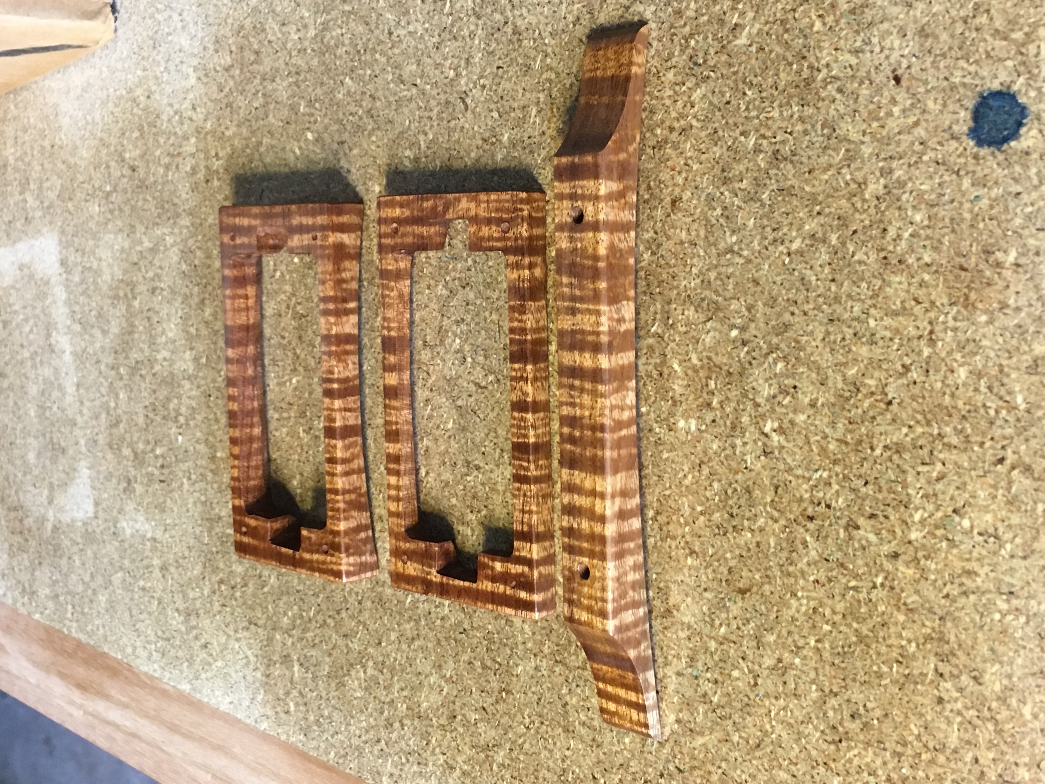

Update,just fitting the bridge and pup bases to the belly, the material used is offcuts of the Otways Blackwood back plate.
WJ Guitars
Posts: 416
Location: Sutherland NSW
Re: Hollowbody electric
Post by WJ Guitars » Fri Feb 01, 2019 2:05 pm
Using the left over Otways Blackwood timber for the bridge mount and pickup bases is a great idea that adds beauty to this guitars finish.
Post by rocket » Fri Feb 01, 2019 2:36 pm
Thanks Wayne,
Yes this timber exhibits some stunning figure so I couldn’t resist the opportunity to use it for these components!

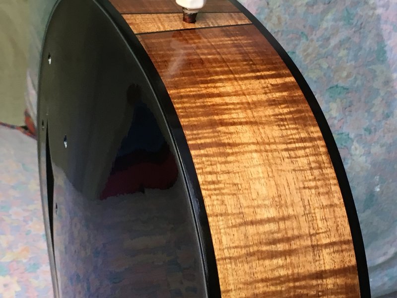

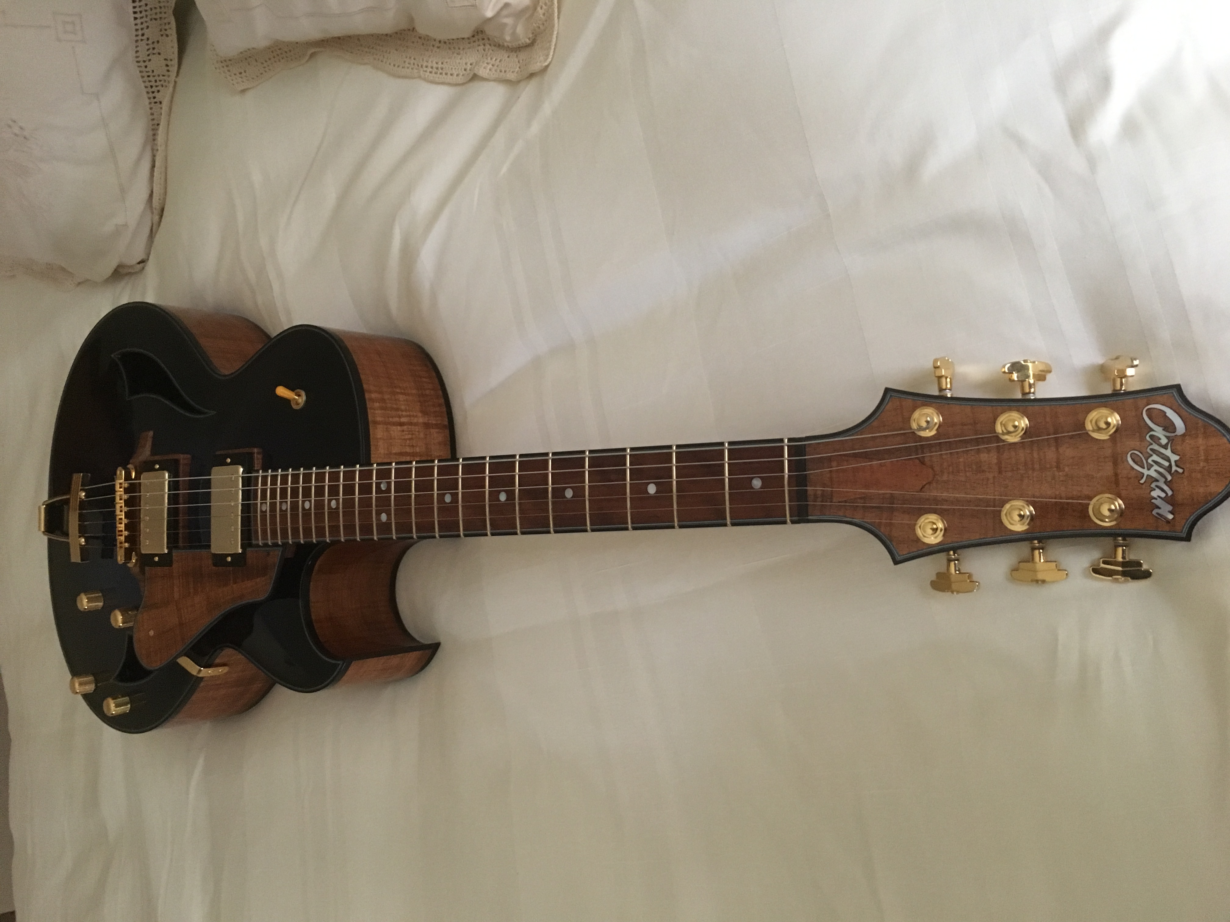

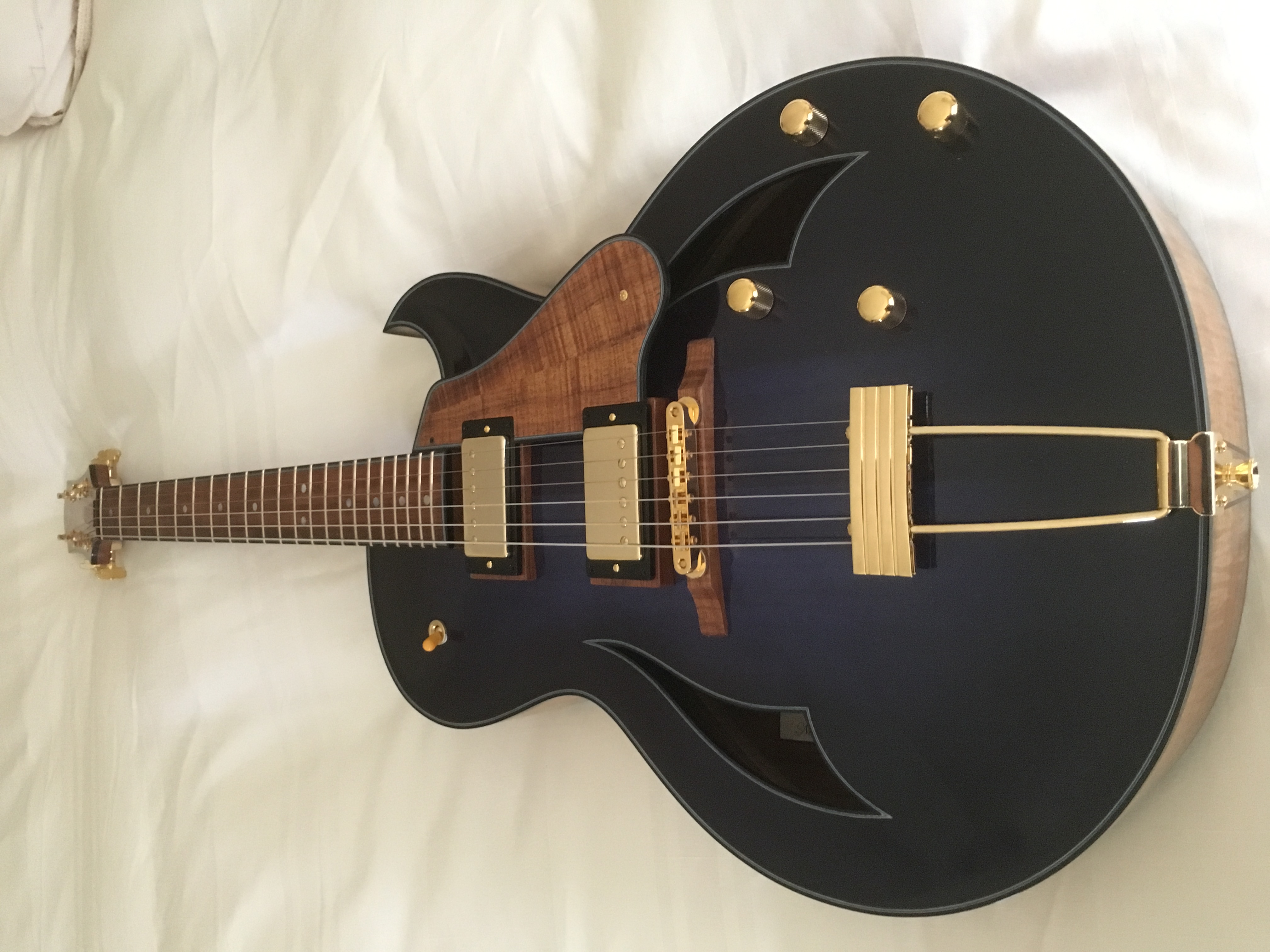

Post by rocket » Sat Mar 23, 2019 1:27 pm
Finished it
Rod
Posts: 120
Post by Jim » Sun Mar 24, 2019 9:08 pm
Absolutely stunning Rod! :cl
Post by rocket » Sun Mar 24, 2019 9:45 pm
Thanks very much Jim, like all my builds this one hasn't been without its little dramas but its done now and i'm very happy with the result, it'll be advertised for sale and if i still have it in early August will be exhibited at the Melbourne Guitar Show.
The unusual construction is designed to eliminate feedback which is a problem with carved arch top guitars,, without the problem of the added weight of a solid block in the centre of the instrument, second one of these i've built and so far no negative vibes!!
Planning on recording a promo Vid if this soon so, watch this space..
Rod..

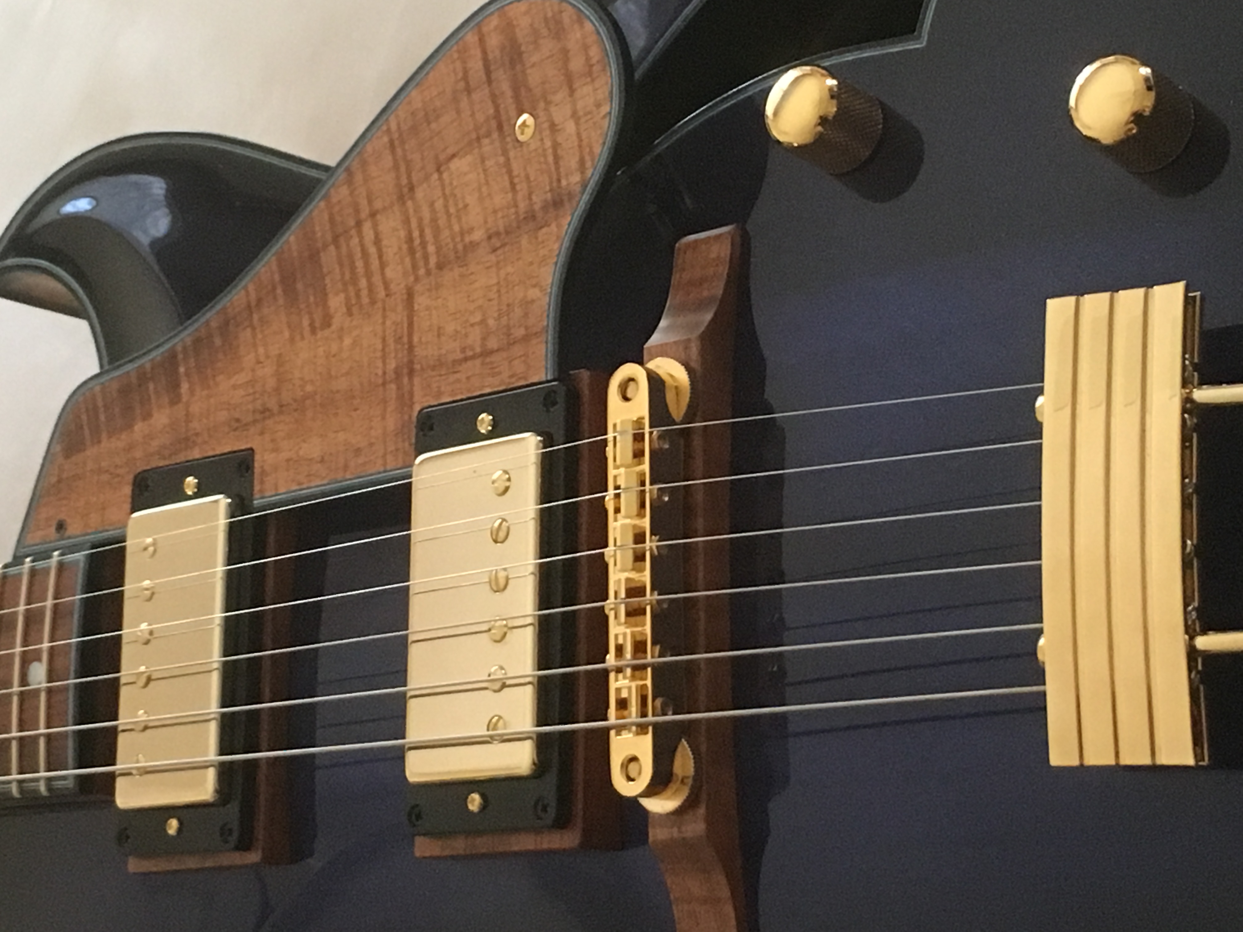

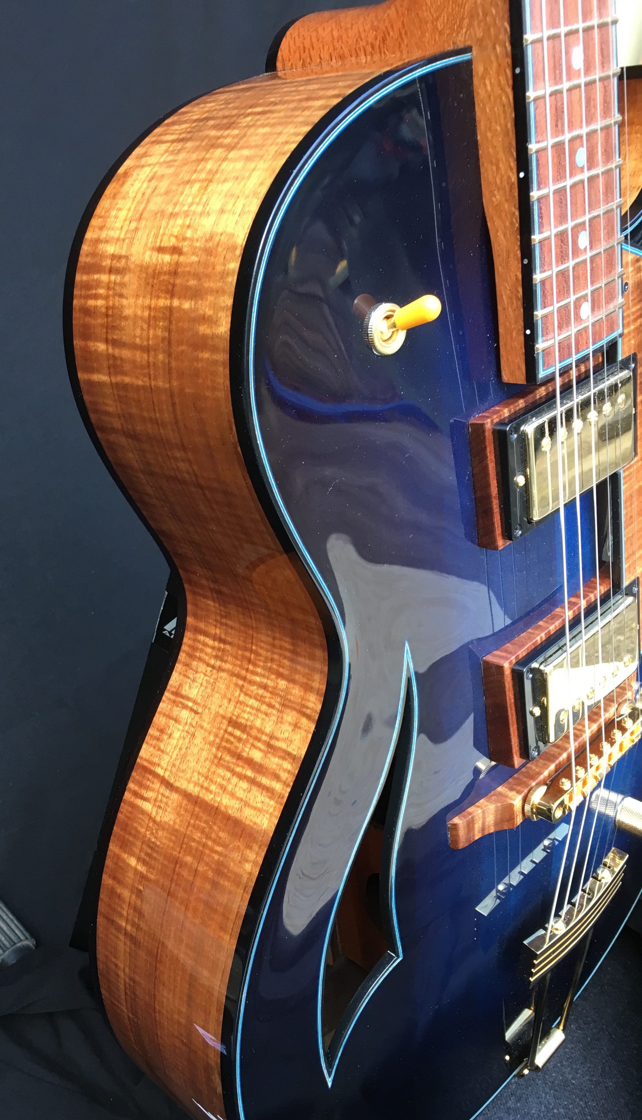

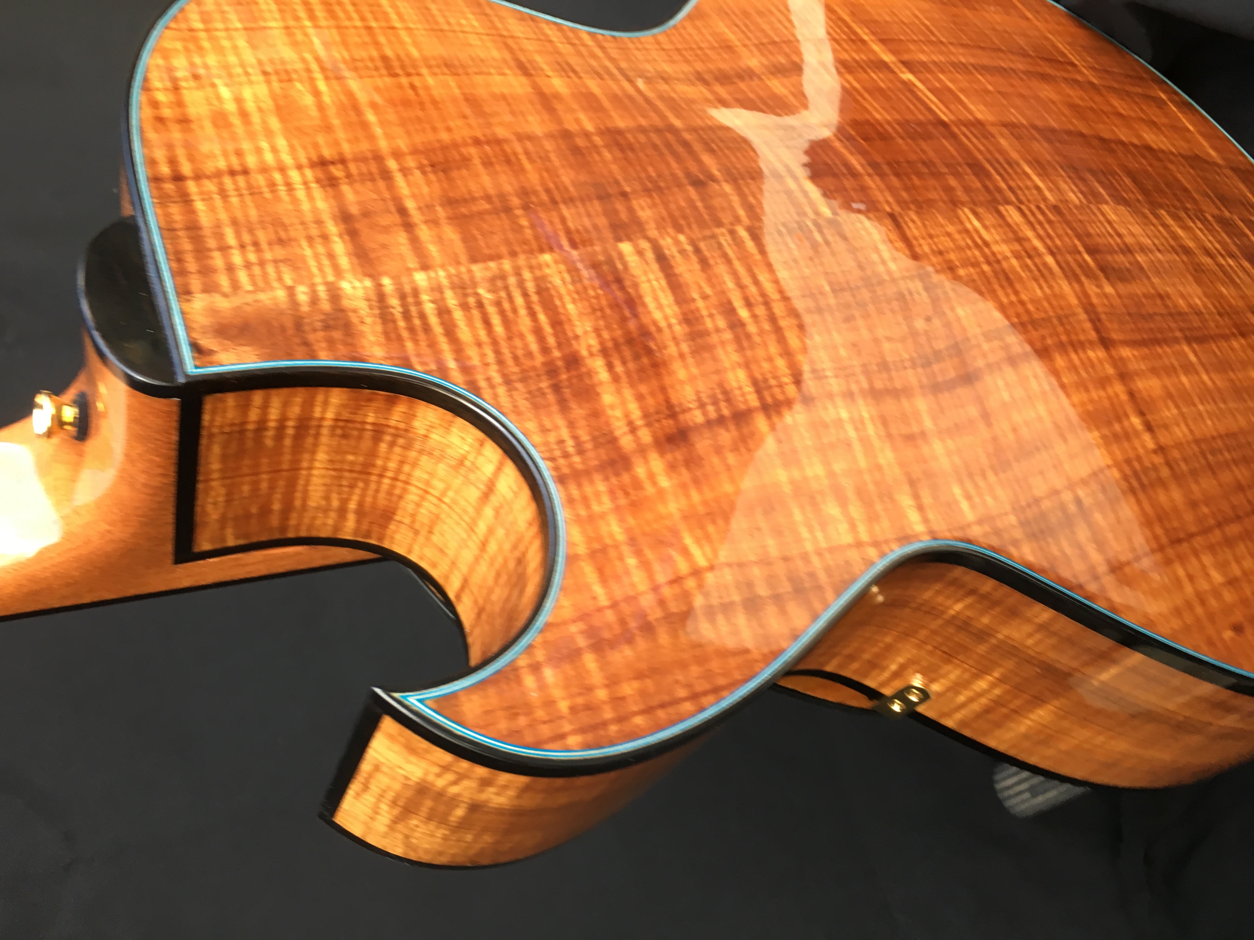

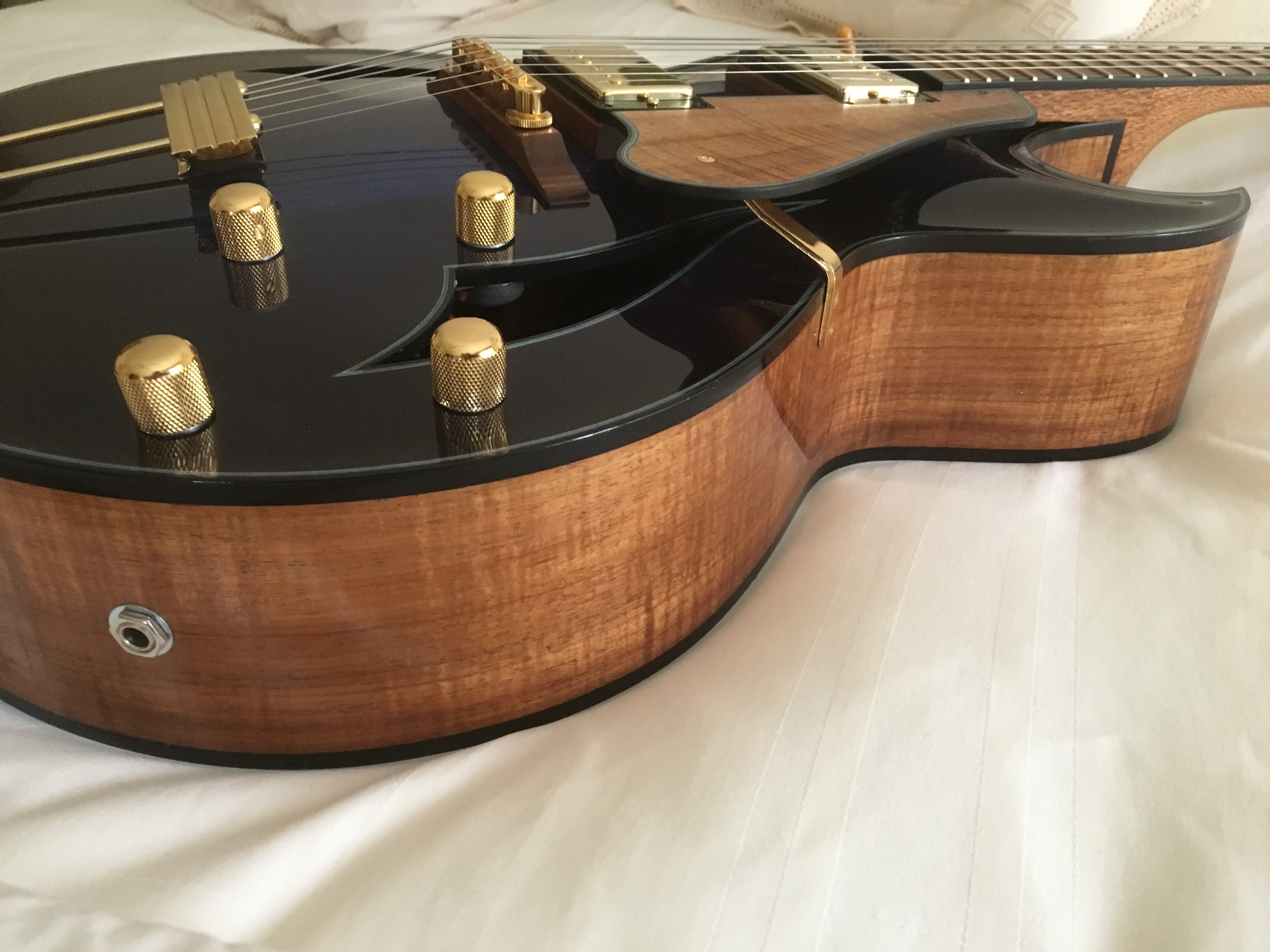

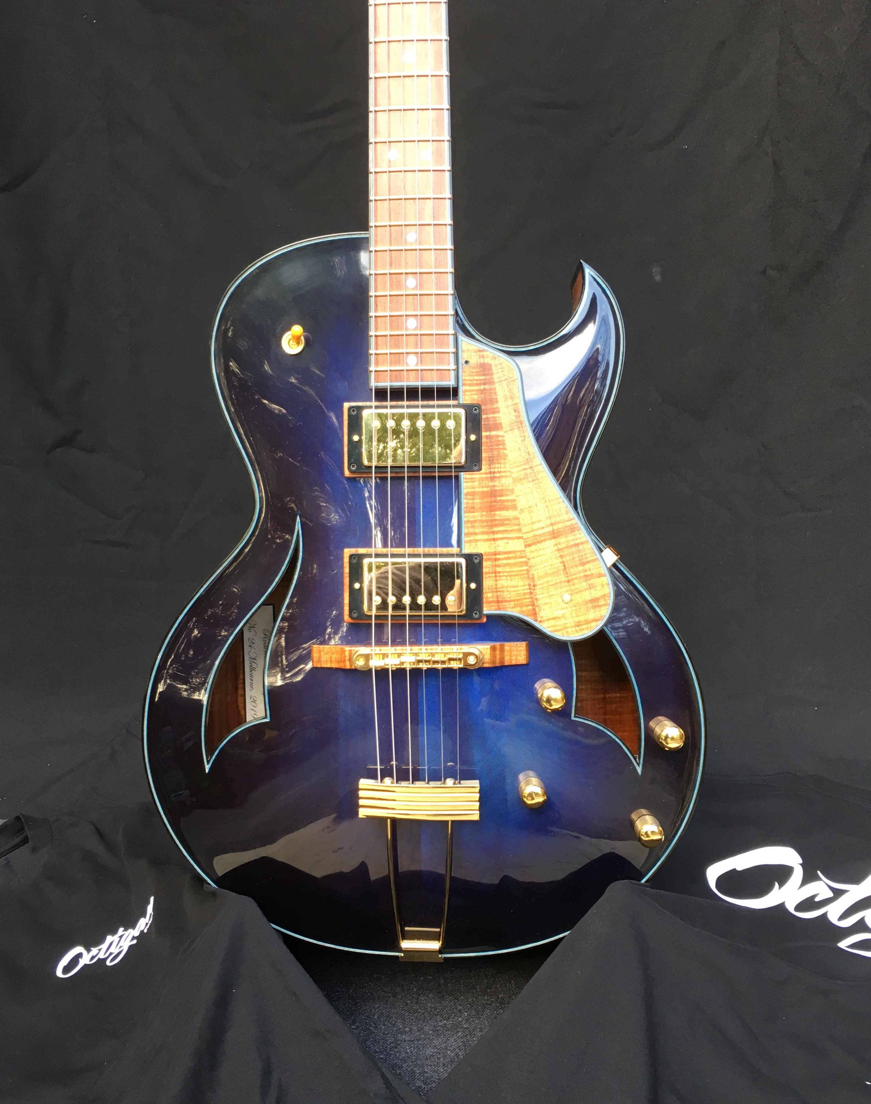

Post by rocket » Thu Jul 25, 2019 1:15 pm
Latest pics before it goes off to the show
Rod
Post by GregL » Thu Jul 25, 2019 2:46 pm
Hi Rod,
Geez that looks nice, Rod!

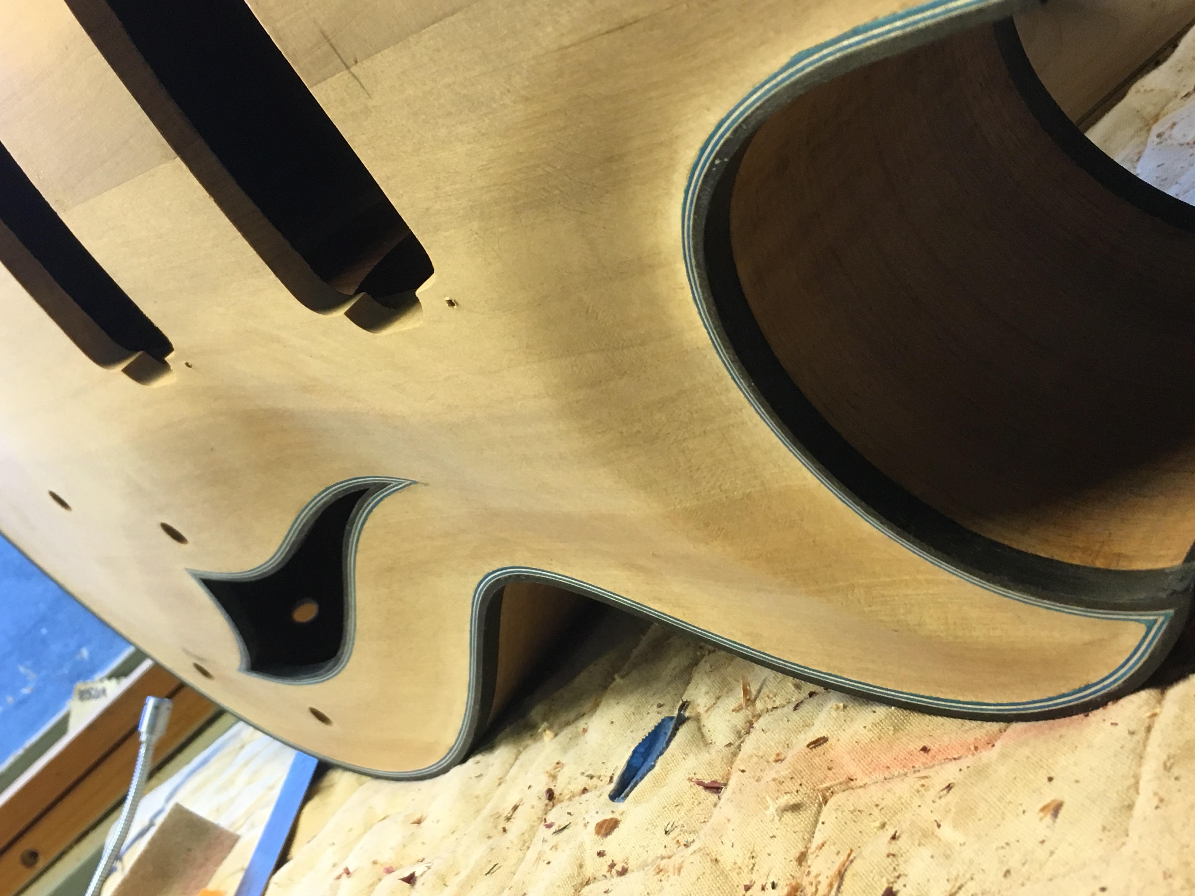

Are the blackwood pickup "surrounds" to raise the pickups to the right level?
What sort of bracing (under the top) does it have?
Thanks,
GregL.
Post by rocket » Thu Jul 25, 2019 3:44 pm
Yes Greg, and if you go back to the beginning of this thread you’ll see the beam strut/bracing I’ve used.
TallDad71
Posts: 232
Post by TallDad71 » Thu Jul 25, 2019 7:24 pm
This is stunning work, very in keeping with what we expect to see on this forum. And it sounds absolutely lush. Well done.
I have two questions if you don't mind about the design.
Why did you use plastic pickup holders, why didn't you use the Blackwood for them instead?
The necks on archtop guitars sits very proud of the body but I don't know the reason why. Having built one is there a structural reason why they must be higher than a steel-string guitar or hard bodied electric.
On my second listen of your youtube video now, amazing.
Peregrine Guitars
Post by rocket » Thu Jul 25, 2019 8:36 pm
i used the black pup mounts on top of the blackwood because i really wanted to have the black to match the ebony around the gold pickups but they weren't tall enough on their own so i added the blackwood under them and then i matched them with the bridge base..
the neck extension on an arch top is totally independent of the soundboard after it extends past the neck block so has an extension piece of timber or around 15mm thick supporting the end of the fretboard, the neck is usually set at an angle of around 4 degrees so as to create a break angle of around 14 degrees at the bridge so to apply sufficient downforce on the belly to transmit the good vibes into the soundbox, similar to a cello, violin,double bass. Having said all that this instrument isn't an acoustic like most of my arch top builds but the construction method and style still brings worthwhile attributes to the aesthetics and performance of the instrument.
TallDad71
Posts: 232
Post by TallDad71 » Fri Jul 26, 2019 5:42 pm
Thanks for that. Of course you are right, the pup matches that stunning black blue finish perfectly.
I built a Gibson 356 type guitar with flamed maple recently. As soon as I put a plastic pup on, the guitar screamed out in horror at the mismatch in both colour and material, so I had to make two from walnut instead, to get the aesthetic right.
