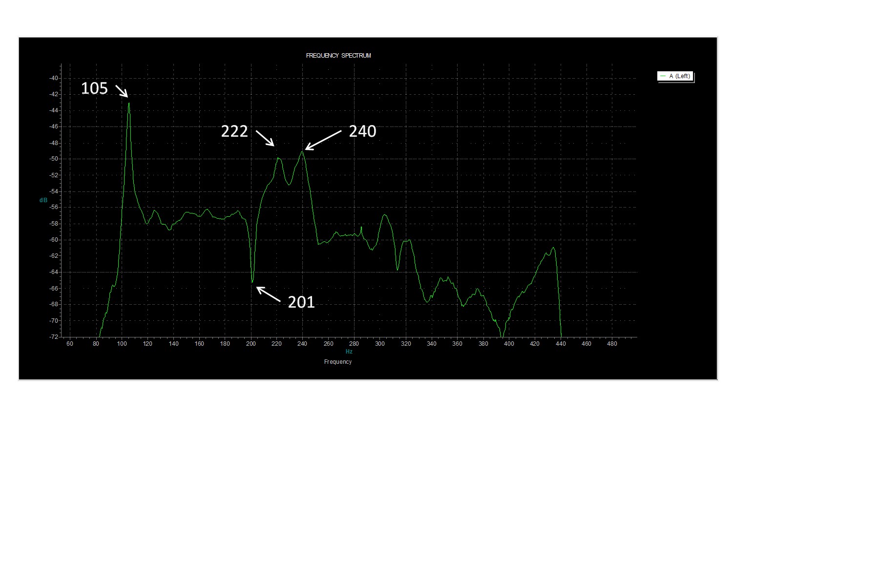

I'm currently working on a guitar and have a questions concerning the dip in the spectrum at 201Hz. I was anticipating the top to be there. The guitar is nearing completion, It's a fan braced classical, without a bridge at this point. I'd like to pull everything down a bit.
So, what is it and why does it do that?

Could you fill us in on the equipment you're using to record your spectra and the procedure you use to tap test (eg hittin device, where youre hitting the top and where the mic is located). Some info on the software and settings would be useful too.

Where is the main back resonance relative to the top? Have you established the uncoupled back resonance and uncoupled top resonances? If the back and top are too close to each other, these kind of things can appear. I am finding that the decision is often best left until the bridge has been glued on, then I look at my data and other tests, eg Chladni testing with the tea leaves or whatever, and then think about whether to adjust the back bracing alone, the soundboard bracing or both. I tend to go for a light bridge so as to keep the inertial mass of the soundboard low, but there is the option of adding mass inside the guitar at the bridge location.

Hey martin,
some addition information;
- I used a Zoom h4 recorder for the mic. It actually has a pair of mics.
- Recorded into Va, fft size of 16384 and sample rate of 11025.
- The guitar was tapped with an eraser on a stick, lightly in the bridge area.
- Averaged 10 samples.
- The mic was little less than a meter in front of the lower bout.
- I blocked the sound hole after I posted this, and re-tapped, the top is at 222 hz. I had stated earlier that I expected this top to be around 200 Hz, that was a different guitar. There's no surprises here on this one, other than the funny spectra.
I'm thinking this is related to my tapping somehow, but I'm not sure. I would like to know what causes this.

The uncoupled top is at 222 Hz. I had planed to do some top thinning on this one, but this is probably more than I wanted.

Jim...I am by no means an expert here, but I recall some of my own taps with a similar dip in the spectral data. The dip disappeared after I fitted the bridge. My feeling is that the top, air and back need to end up with a relationship which works (without hitting any scale tones, ie in between the notes frequency wise, to avoid admittance problems ) so that an impulse delivered to the soundboard from the strings causes the guitar to "throw"(my terminology) the air out from the guitar in the low frequencies. This can be felt with the hand, and has a sustained quality about it. After that, the top takes over as a sound radiator, which is where the higher soundboard resonances can be adjusted to achieve that certain "magic"!!!????!!!*** #ahem....Do you have "The GG Books?" There is a section about fan brace adjustments and also reference to the spectral data when top and back are too close together.
Looking at the picture you posted, here is my speculation: Top 222hz which is pretty close to the note A3 (220Hz). Back (240Hz) looks like it is less than a tone difference, ie too close. Adding the bridge along with its extra mass should lower the Top resonance somewhat, thus creating larger difference between it and the back resonance . If you can get your top down just shy of a G there will be four semitones difference.The dip will most likely take care of itself, not sure why either, so a good question in the first place. Then look at the back and aim for the four semitones difference.

I was of the understanding that the dip is a frequency where the top is not excited. So if you were to do clandi patterns, no tea leaves would be hopping at 201hz. I may be wrong on this but the reason it is so low is two shouldering peaks are coupling to push the dip lower. On the higher side the the harmonic of 105hz at 210hz not sure what would be before it at 195Hz.

Yes I'd certainly get some tea leaves on the job.
lamanoditrento wrote: ↑Mon Jan 21, 2019 10:11 amI was of the understanding that the dip is a frequency where the top is not excited. So if you were to do clandi patterns, no tea leaves would be hopping at 201hz. I may be wrong on this but the reason it is so low is two shouldering peaks are coupling to push the dip lower. On the higher side the the harmonic of 105hz at 210hz not sure what would be before it at 195Hz.

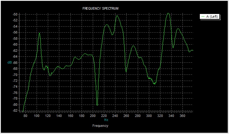

Well, I spent part of the day trying figure this out and I believe I made some progress. Looking at Trevor's references of section 2.4.2 it appears that frequencies can interact with one another depending on their phase and strength. I won't bore you with a bunch of spectra plots unless you want, but I took a the spectra with the sound hole plugged and I still had the deep trough. I was a little confused, I should note that I can be easily confused at times!
Long story short it appears to be a reflection off a back wall interacting with the top. When I originally took the spectra the mic was about 18"or so from the wall. I reoriented everything so it was about 2M from the wall behind it and I placed some pillows behind and on the sides of the mic.
After verifying this multiple time going back and forth this what I got with the new orientation. The trough to the left of the top (T1,2) is now gone, but oddly enough everything is a little higher in frequency too. I'm not sure why that is, ( see more confusion
If I appear to be off track on this, please speak up!
Moral of the story, watch your environment and look out for reflections. It changes your spectra.

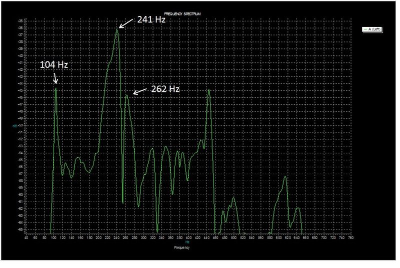

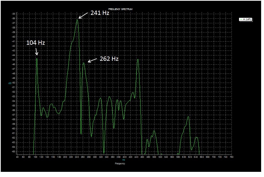

The amplitude difference between the t1,1 and t1,2 was my first thought too after rereading the section. With the set up in the original configuration, I held a book (your book BTW) 5-6" in front of the sound hole to know the amplitude of the t1,1 down. But I still had the deep trough, so I went searching some more. It's encouraging to hear my first thought was also on track.
Here's the spectra with the sound hole obstructed.
