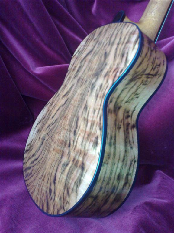

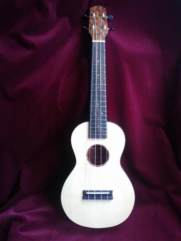

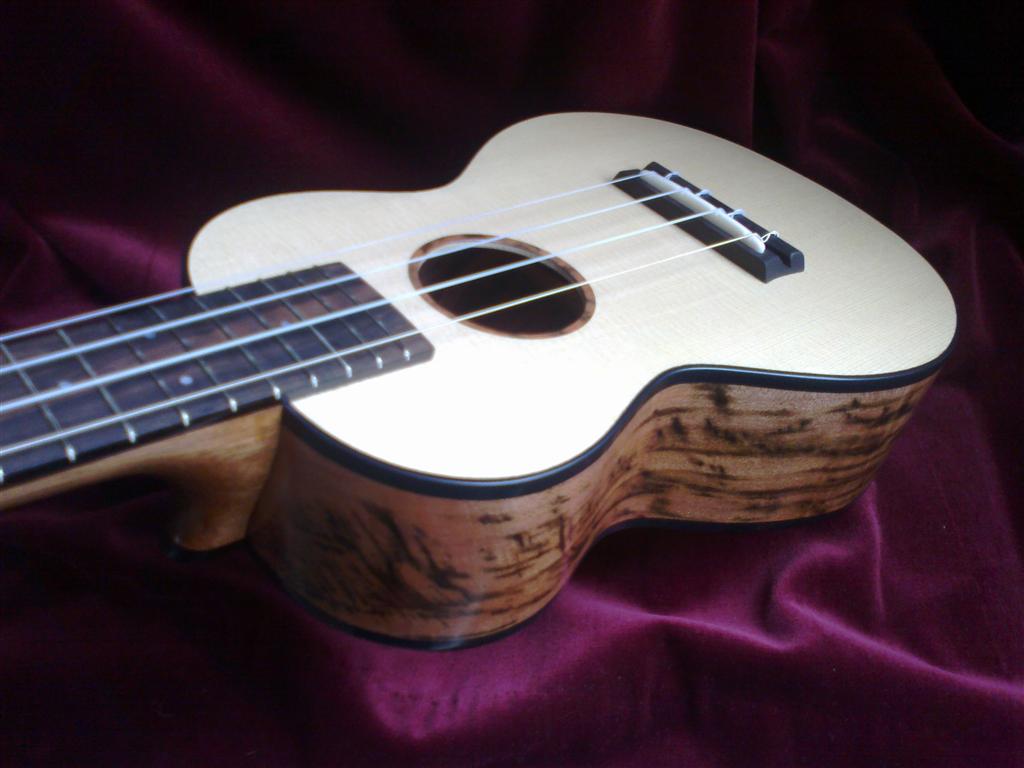

And because we all love pictures, and because we all love Tim's Tiger Myrtle, here's how I made use of one of his 'special sales' on the third falcate uke.
