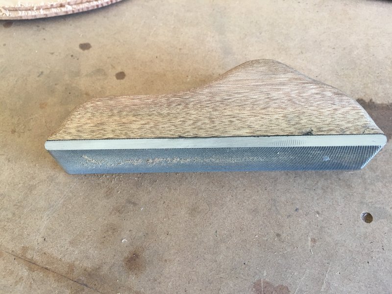

Made one from an old smoothing file and a QLD maple offcut. Very happy with its performance. Inspired by Stewmac
vandenboom
Posts: 414
Re: Homemade fret/fingerboard leveller
Post by vandenboom » Tue Feb 12, 2019 1:12 pm
Thnx Geoff. What is its length?
I looked at getting a longer (12") fine mill file once for fret levelling but struggled to get one that was truly flat. I went to a reputable engineering tool supplier in melb , checked 8 of his stock sgainst my precision straight edge but couldn't find a good one.
