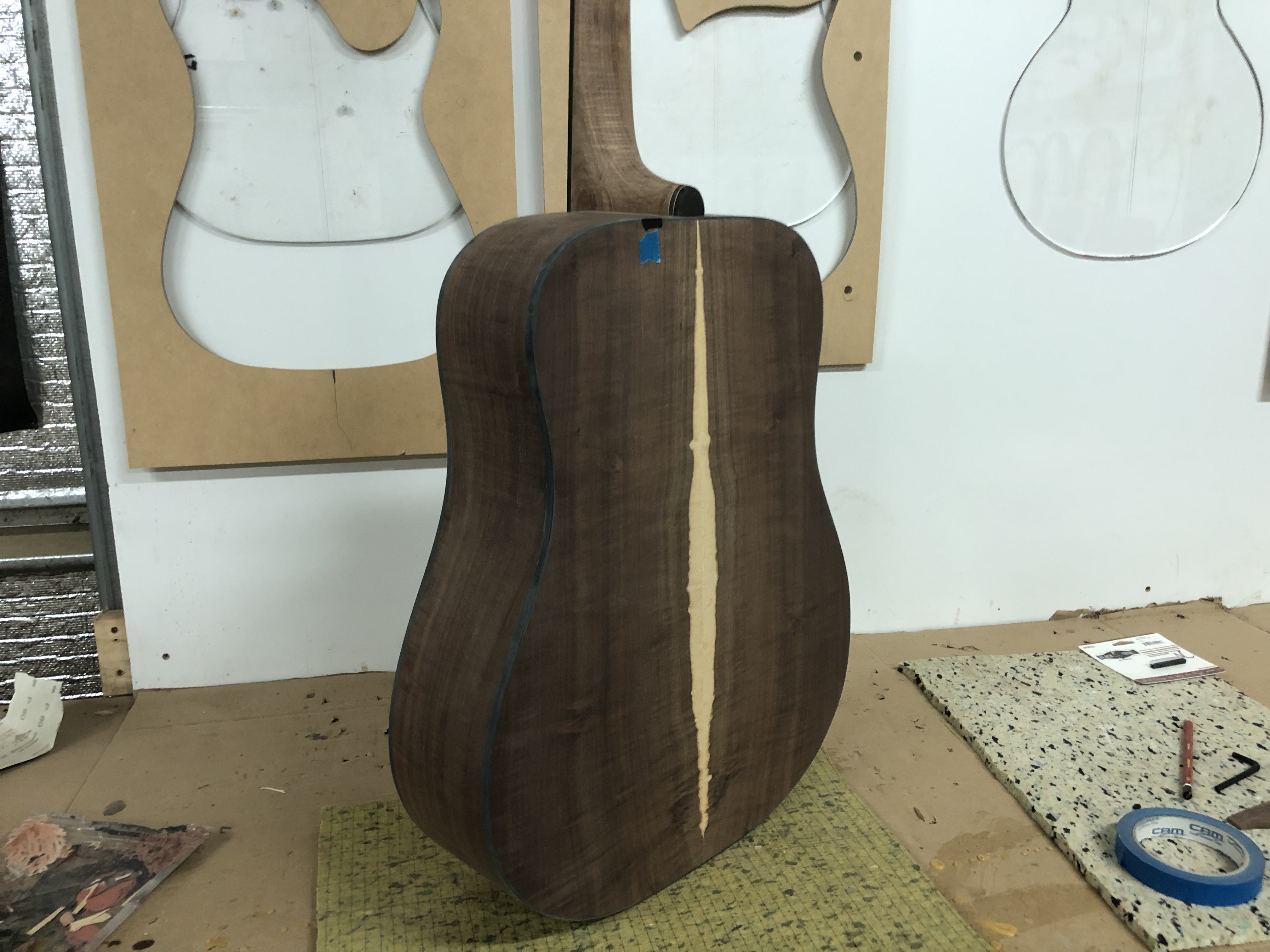

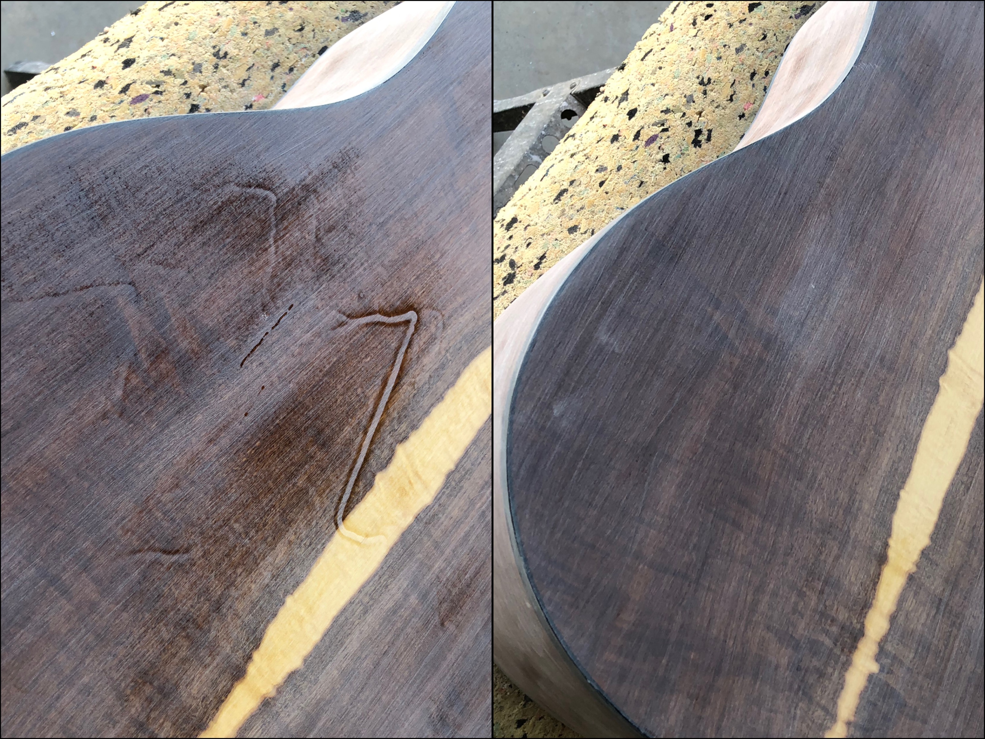

This morning is a day off, so I spent a bit of time 320 sanding the entire guitar, running the 320 around all the shard edges to create a minor fillet and just paying attention to anything I may have missed.
Problem areas I place a bit of tape to find them easily (less sanding work later involved than if I used pencil) and then I come back and do some touch up fill or whatever is needed.
In today’s case, there was a spot on the rear binding which needed a tiny bit of fill, as seen in this pic.
There was a pinhole in the Gidgee headstock cap which I filled and a couple of spots around the edge binding. Once these are dry and sanded, the guitar is then ready (I hope, unless I missed something) for spraying the sealer.

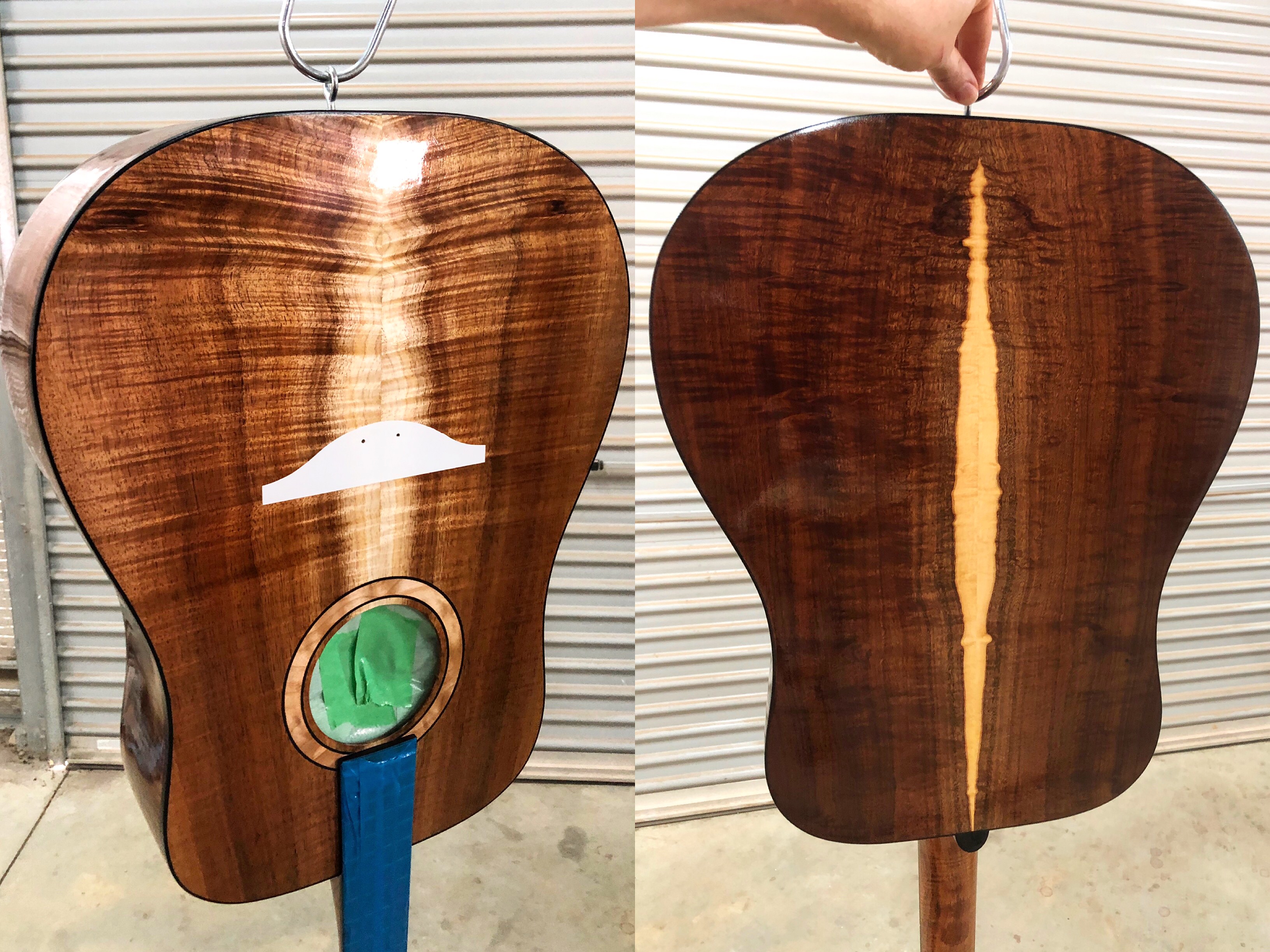

This one has been put aside for quite a while, however with today being the perfect temperature for spraying I thought I’d take the chance to lay down some more sealer coats.
It had three coats last time and then I’d sanding it back to the timber, not planned that way, it’s just that I got some rub throughs and decided to do a full sand back. Today I’ve sprayed four more coats.

Re: Acacia dread build thread
The timber grain is looking great. How many more coats will be applied for the final finish?
It depends if it sands smooth this time or not, if not then it’ll get a few more coats of sealer, if it stands flat then it’ll move to clear coats where I usually do three.WJ Guitars wrote: ↑Sat Jan 19, 2019 4:36 pmThe timber grain is looking great. How many more coats will be applied for the final finish?

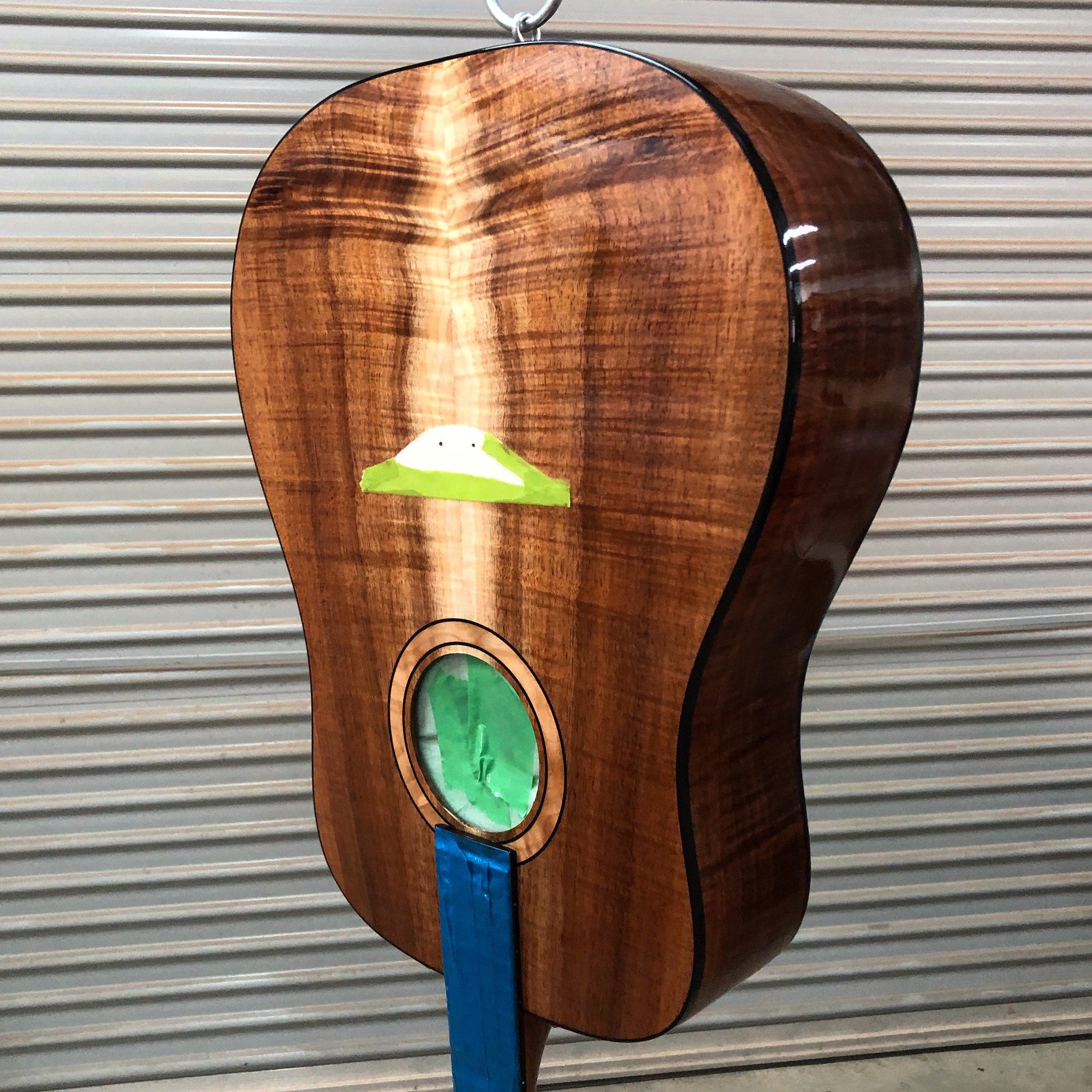

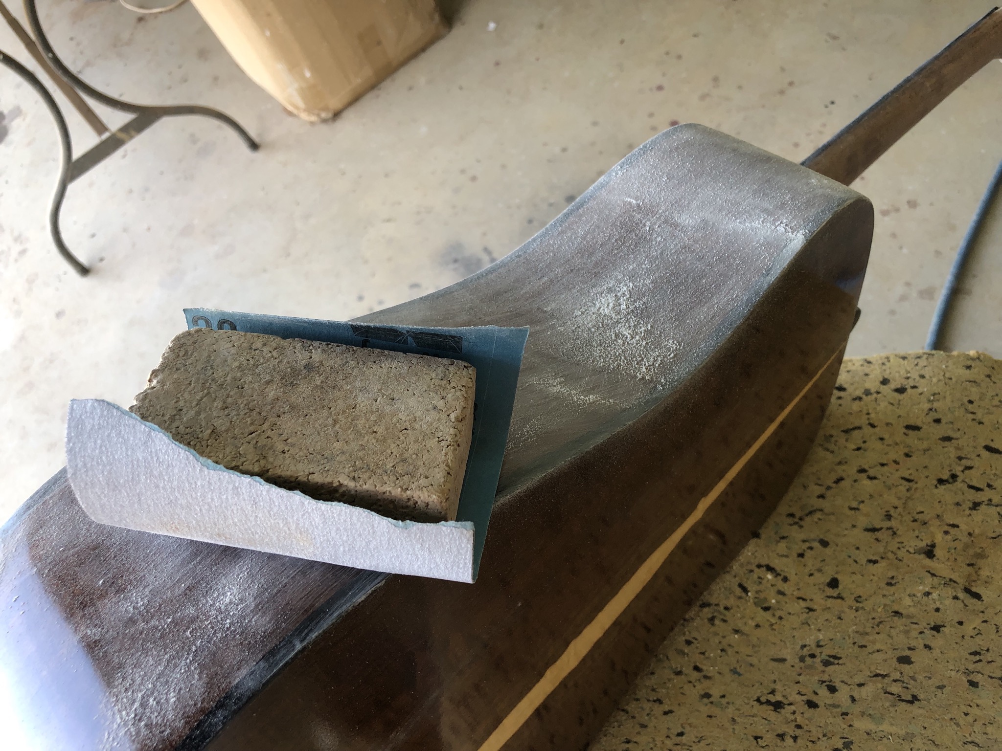

Block sanding the sealer wit 320 grit followed by a buzz over using 600 grit on a random orbital to remove the scratches.
Had a few killer hangs/runs in the sealer as I laid in on thick last time, good thing it stands out so easy! I’m not stressed about getting runs when a spray primer/sealer. If it happens it happens, but it’s not like I aim to get them either. It’s not like the top coats or colour coats where it’s more of a problem if you have runs.
This one is now ready for clear top coats, once the weather is a bit more suitable. 40+ degrees in the workshop today is not spraying conditions!
Now that I’m spraying clear and not just sealer, I’m more particular on my spraying as I have the build already in the sealer, now I’m looking for nice smooth glossy coats, not so much thick coats.
I’m moving faster now that I’m spraying top coats as I don’t want it thick, I want it smooth, so I want it only just thick enough to flow nicely but not run or hang, I’m more particular on my crossover for the same reason as I don’t want too much built and I’m careful on my flash time as I don’t want to be too fast that I get solvent pops and I don’t want to be too slow and have it too dry between layers, so my flash times were 10 mins, 20 min and 30 minutes. The temperature in the workshop today is low 20’s.
Hopefully these three are the only clear coats I have to spray and the next step will be cut and polish. But you never know with this type of work.

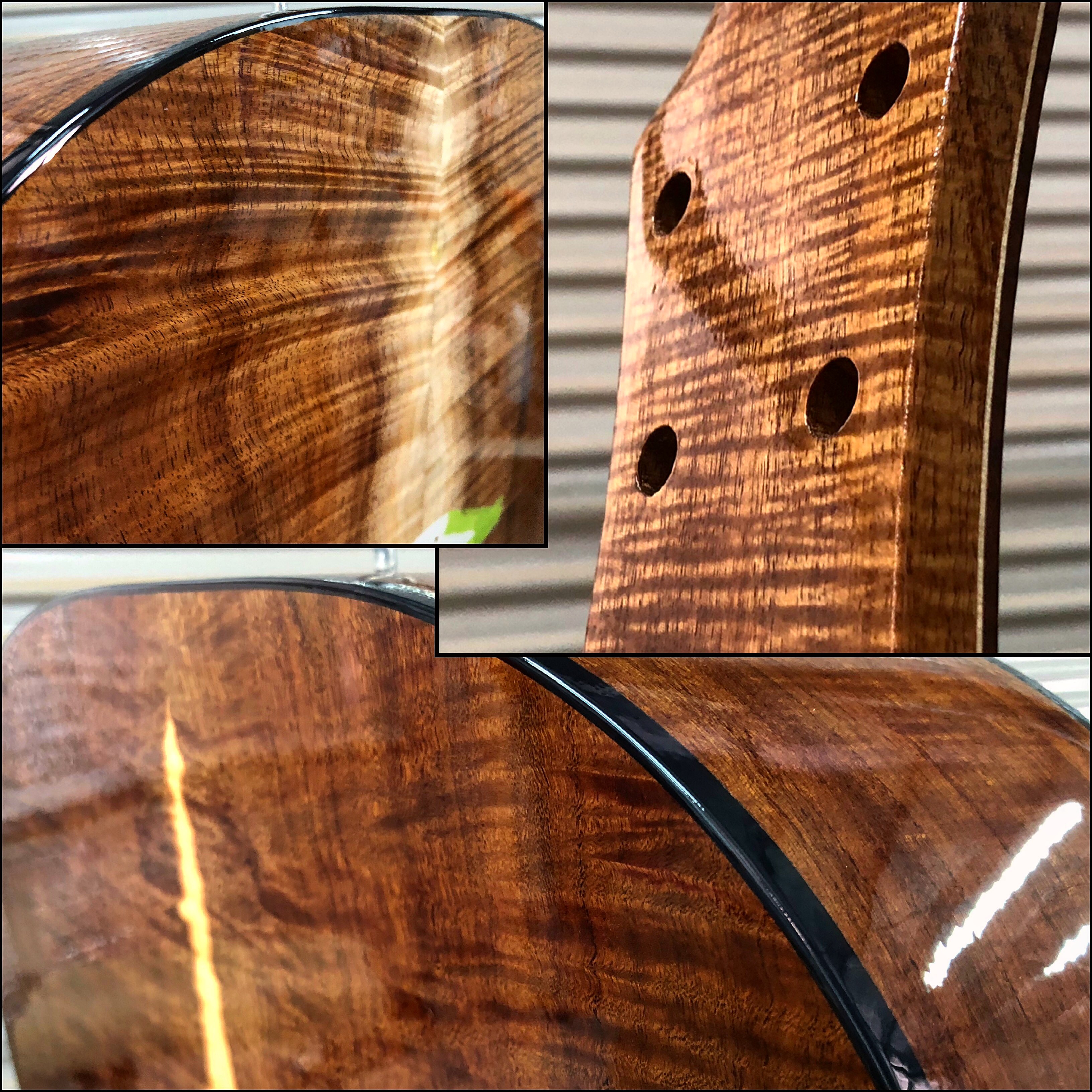

Polishing:
This link shows the speed that I polish at. Any faster is too fast. The guy I learned to polish from goes even slower than this, but his paint jobs are also better than anyone else I know.
The clear was cut first with 1000, then 2000, then 3000.
I’m using 3M Perfect it polish on a 3M blue waffle.
https://www.instagram.com/p/BtUb9vnHjuf ... fwb9ybqmt8
I only polished the top today as I didn’t have much time. The rest I’ll work on in stages next week in between other jobs.

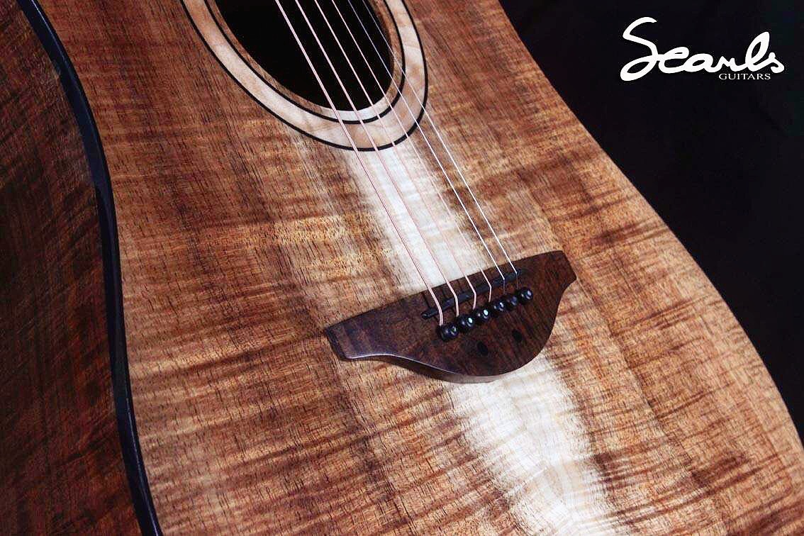

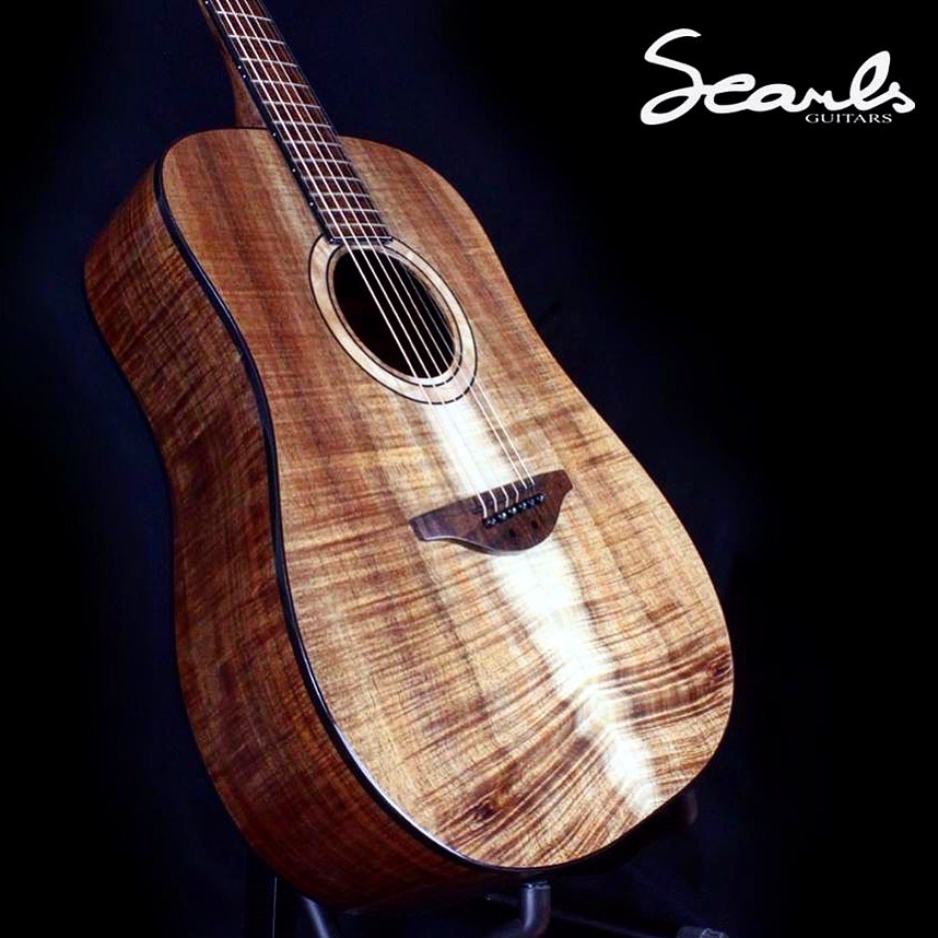

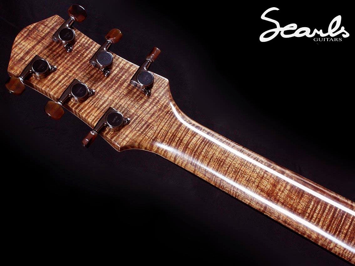

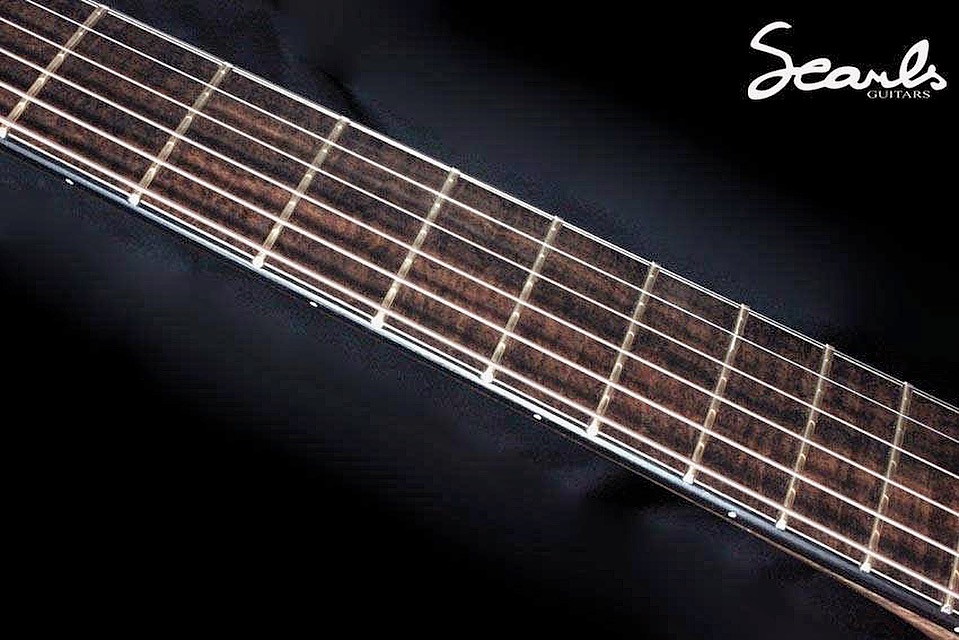

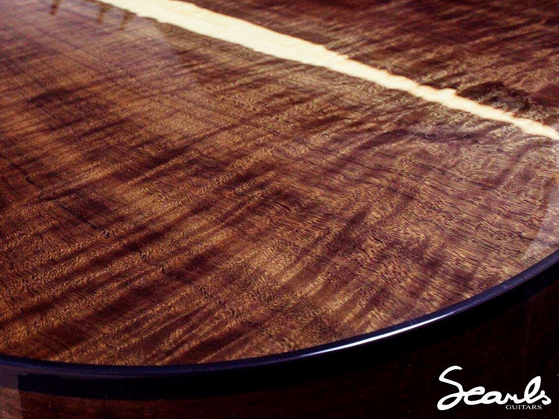

I finally got around to taking finished photos:
- WJ Guitars
- Posts: 404
- Location: Sutherland NSW
The guitar looks amazing Allen! Beautiful timber combination styling and wonderful character. Now that the guitar is more settled in with the new strings do you have any more recent sound samples available. It be great to hear a sample of this guitar.
Thanks WayneWJ Guitars wrote: ↑Sat Feb 23, 2019 12:29 pmThe guitar looks amazing Allen! Beautiful timber combination styling and wonderful character. Now that the guitar is more settled in with the new strings do you have any more recent sound samples available. It be great to hear a sample of this guitar.
I’ll be honest, it sounds better than I expected, I took a risk using the Blackwood and I’m glad to say it didn’t bite me in the butt!
As far as sound samples, I only have a mobile phone to record with, so I may as well be playing a banjo
- 56nortondomy
- Posts: 708
Looks great Allan, they're two of the nicest looking timbers we're lucky enough to be able to use and you've done them justice. Is it a keeper?
