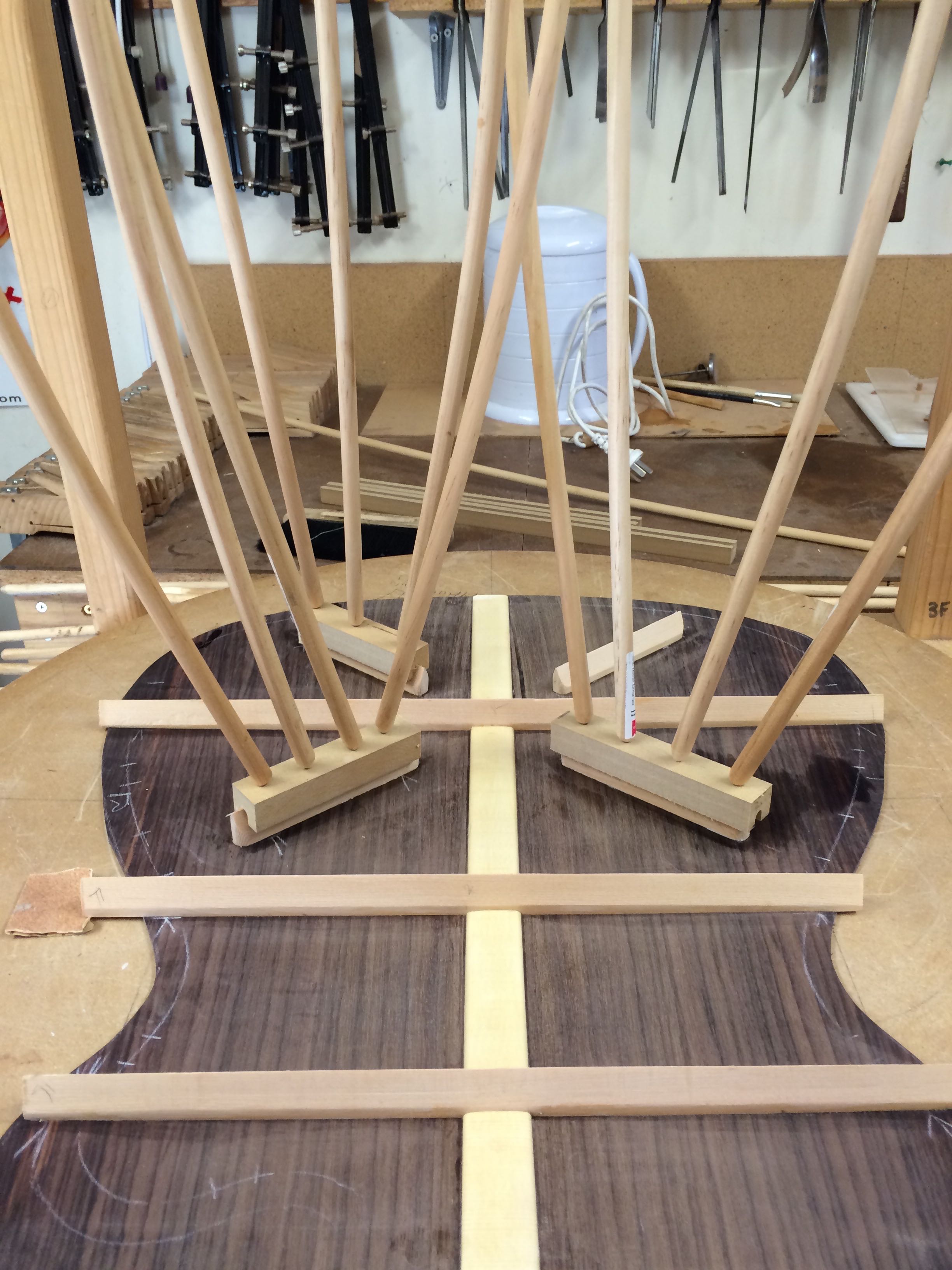

I use hoop pine for my go bars. I sand the ends round and don't worry about rubber tips. When gluing up pre-shaped braces I use a caul with a v routered along it. If the braces are being shaped after gluing in then dents on the top of the brace aren't an issue. The V channel in the caul fits over the top of the brace and the go bars exert pressure on the caul. For other applications where I don't want to dent the component being clamped I just shove a scrap of cork between the end of the go bar and the work surface.

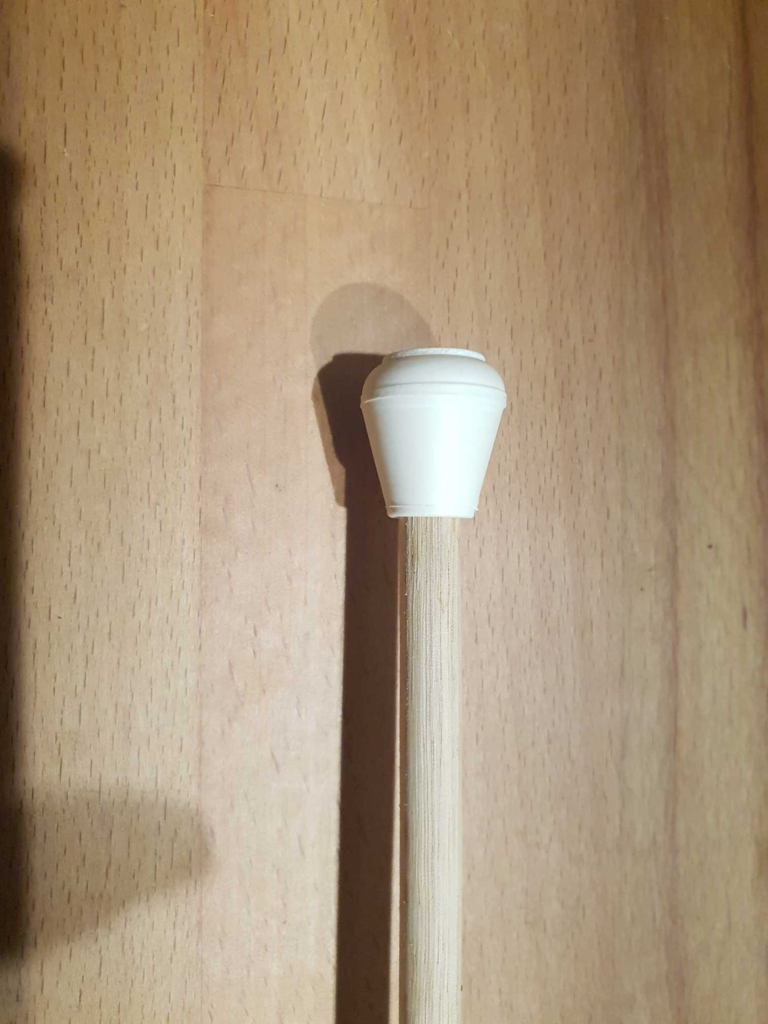

You mean......?????......
Like this?
Good old Bunnings.
Didn't know they were also a Luthier supplier!..

Yep, those are the caps I was referring to.

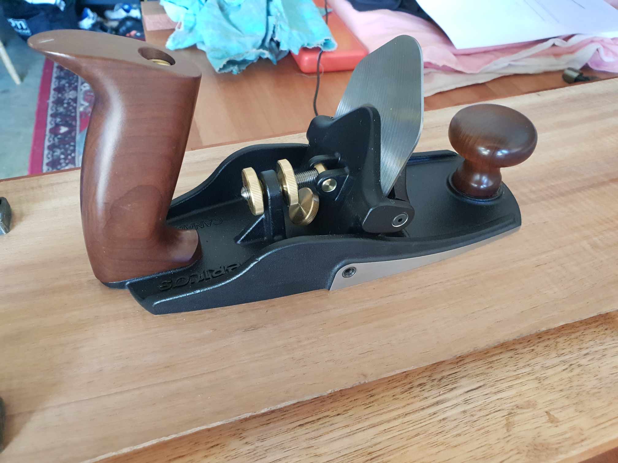

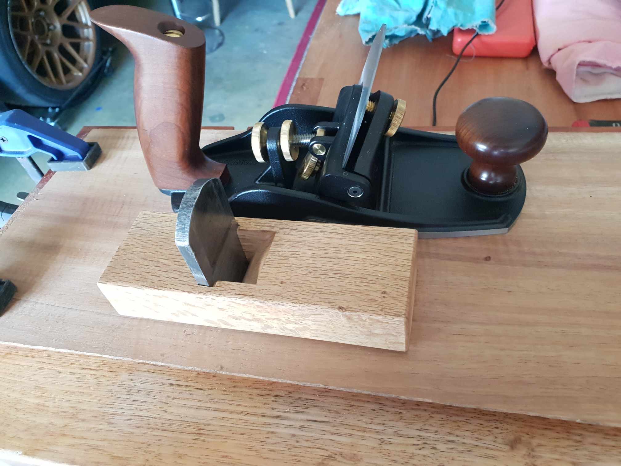

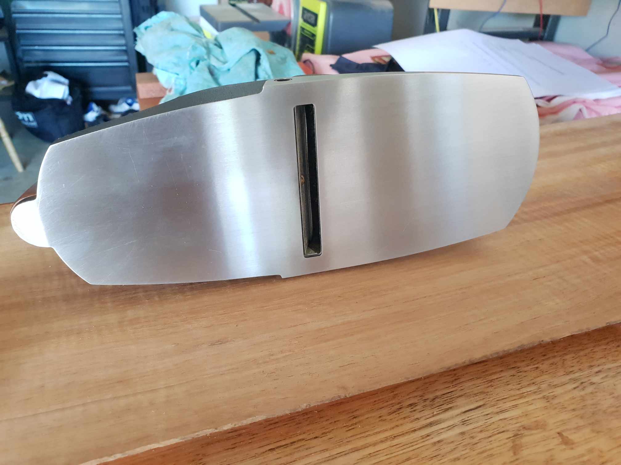

This just arrived an hour ago.
I think the Canadians took a good look at the Stanley #112 and improved it beyond compare.
Holy Mackerel...this thing shifts the wood leaving it perfectly flat.
It is just beautifully made, weighs 4lbs and is a joy to use.
My other little Japanese one pictured also works very well but it takes me a day to scrape a plate with it.
I do not have a high angle plane so basically I scrape the crap out of it from raw!.
No doubt you all have a Veritas scraper plane but I am just in awe with it.
Rolls Royce of scrapers I would definitely say.

Bunnings have 9.5mm hard wood rods and also the 9.5mm white rubber feet to match.
Why 9.5 instead of 10?...I cannot answer.
Anyway they work fine
