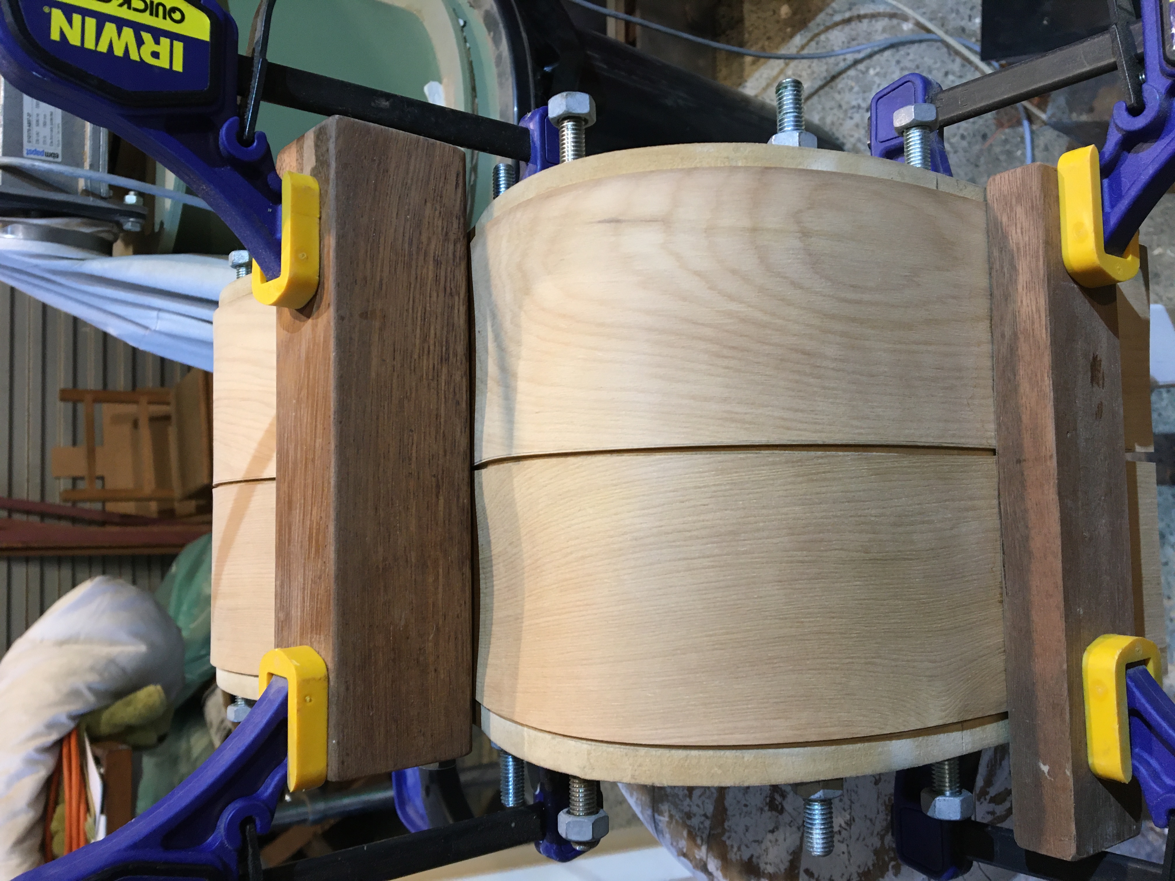

Hi Guys, first time trying to bend Sides using a Mold.
I've bent Sides on a Pipe before, but this is the first try at this method.
These are for a Baritone Ukulele and are 75mm wide X 1.8mm thick, and are of New Zealand Tawa, (a native Hardwood).
I soaked them in very hot Water for about 3 minutes then bent them up using a heat Gun.
They bent OK, but I have experienced some 'Cupping' at the Waist.
Has anyone else had this issue? Moreover, what can I do to fix it?
I'm thinking that; if the cupping is still present after the Sides are in the Outside Mold with the Lining fitted, I could fit Side Braces each side of the Waist to control it, but .... I will await your enlightenment ...

"I soaked them in very hot Water for about 3 minutes then bent them up using a heat Gun."
This may be part of the problem. If you soak them in water and then apply heat to one side with a heat gun I reckon theres a good chance you're going to get cupping. One side is drying out from the heat gun while the other is still soaking wet.
If you're bending around an internal mod then you need to apply heat over the entire side using a heat blanket on the outside or heat from bulbs on the inside (ie fox style bender).

I don't think a heat gun is really the way to go, if you're going to the trouble of building molds you may as well get a blanket like Martin mentioned and use that. I just give my sides a quick spray with water I don't soak unless it's a cutaway.

I used the Heat Gun from both sides. As the Fox Bender only heats from one side I would expect the same issue?
I'm wondering if this is why the Steel Plate are used? To stop deformation like this perhaps?

I think the problem relates to the soaking you gave the wood before applying the heat. When I bend using a blanket or iron I spritz the side with water...just enough to get a bend. The side is also wrapped in paper so the moisture can't escape quickly as the heat is applied.
The steel slats would help keep the sides flat as would a larger waist caul.
The sides look like theyre flat sawn (correction)..is this the case?

The wood does not look very much like it is quartersawn, more back sawn with the grain is going across the thin piece of wood. As back sawn wood dries (and heating it with a hot air gun is drying it very quickly) it is going to cup in that way. With some timbers it does not matter very much. I suspect with your piece of wood it does :o And as others have said, a heat gun in not the best way to bend timber. You need at least 150C to bend timber and either a length of metal tubing with a propane torch heating it or a silicon heating blanket and a mould is by far a preferable way of applying the significant amount of heat to effectively bend a strip of wood for the side of any stringed instrument. It is much about a quick and efficient application of the heat as the temperature.

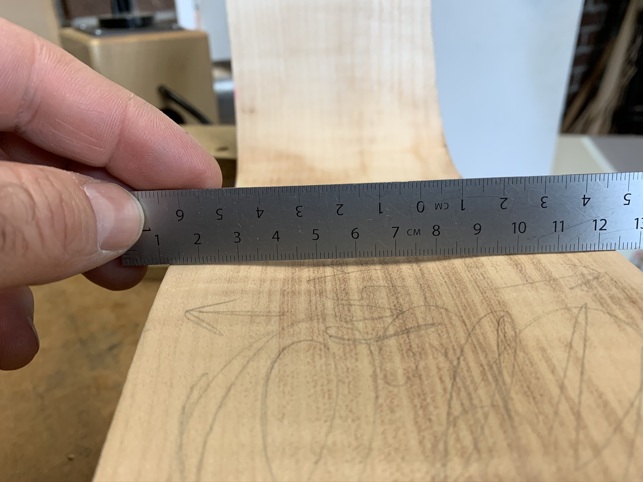

It must be an epidemic. I hope you don't mind me posting in your thread Murray, but I had the same issue with some flame maple on a bending iron. I didn't soak, just spritzed it but I didn't use a steel slat on top as it was bending easily. Now I know to use the slat.
So is there a way to flatten them?

I've decided to make a solid MDF inside mould and attach a slat with springs, like a cheap fox bender. I'll put the side on mould and steam with an iron and slowly move the slat down and hope I don't hear a crack.

This has probably happened to all of us at some time. Unless you are particularly good with the bending iron the most consistent method is with some kind of variation on the Fox bender, using those metal slats to fully support the outside of the bend.
As has been said elsewhere you can do some sanding if you have a decent thickness of side. If necessary adding a lamination to the inside to maintain strength. If the guitar is for yourself of course you can just live with it. It shouldn't matter too much structurally - if you are worried then reinforce with some internal struts.
