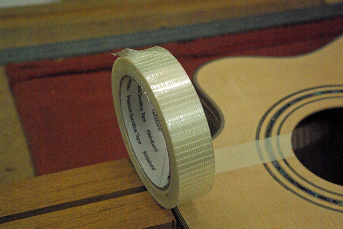

I use the pretty standard tape from 3 M. I am in the UK but I'm sure it will be available in Oz. Having recently bound the guitar in the pic it is probably the best I have done so far because the bindings were bent accurately. This I think is key.
Unlike Martin I have had issues with some Engelmann spruce losing fibres but I think that was me being impatient. This one is Sitka and the tape came away cleanly.

3M 8981 Filament tape works a treat, tacky enough and strong to pull binding into the work on both faces.

The two-way tape is easier to get off as the cross filaments hold the long filaments together. Use a good, heavy tape dispenser with a serrated cutting edge (or pre-cut prior to use). There is no need for anything other than the tape. Shellac first.
