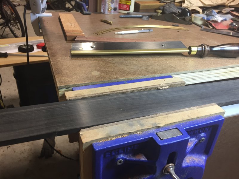

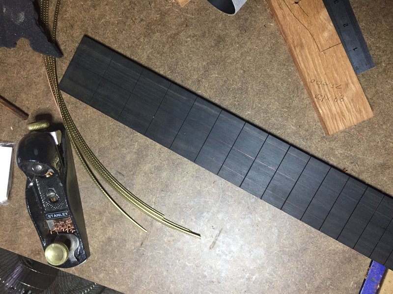

Fretboard is slotted and tapered.
20 frets, 14 to body, and 633mm scale.
I scribed the spacings to nearest 0.1mm.
No issues save fret 10 being a whisker out of square.

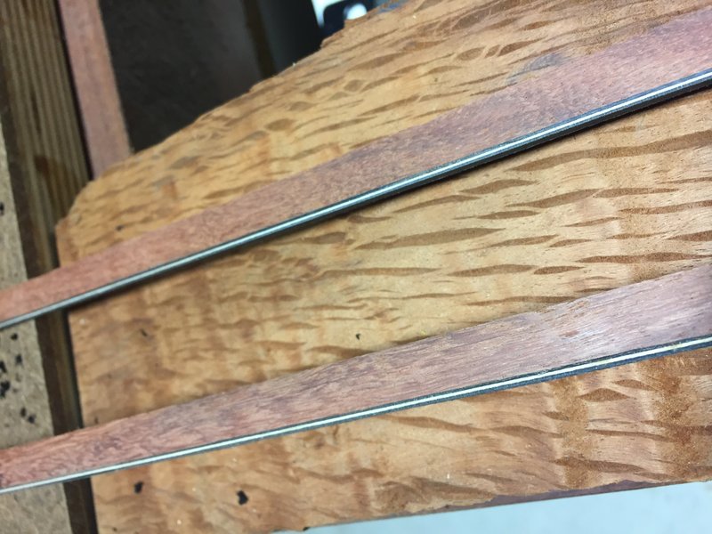

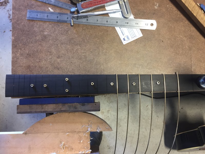

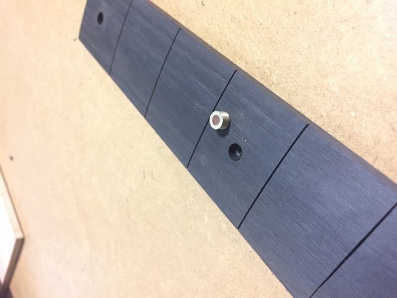

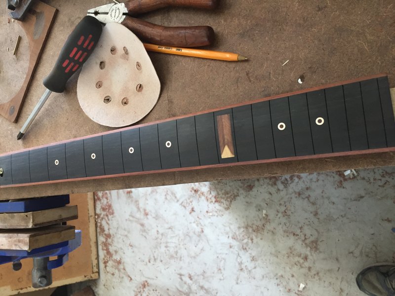

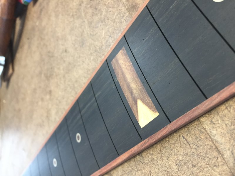

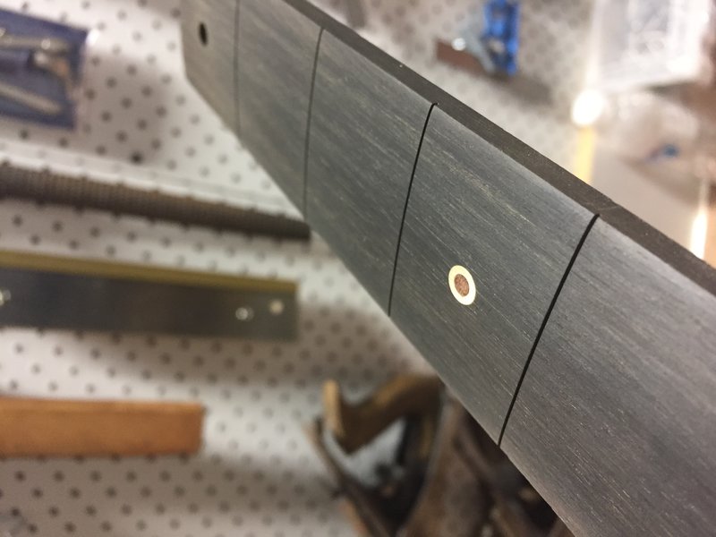

More progress on the fretboard.
Jarrah bindings and Mulga inlay at the 12th fret.
Was planning on doing just two dots but I messed up a hole... I like it better with the inlay anyhow.

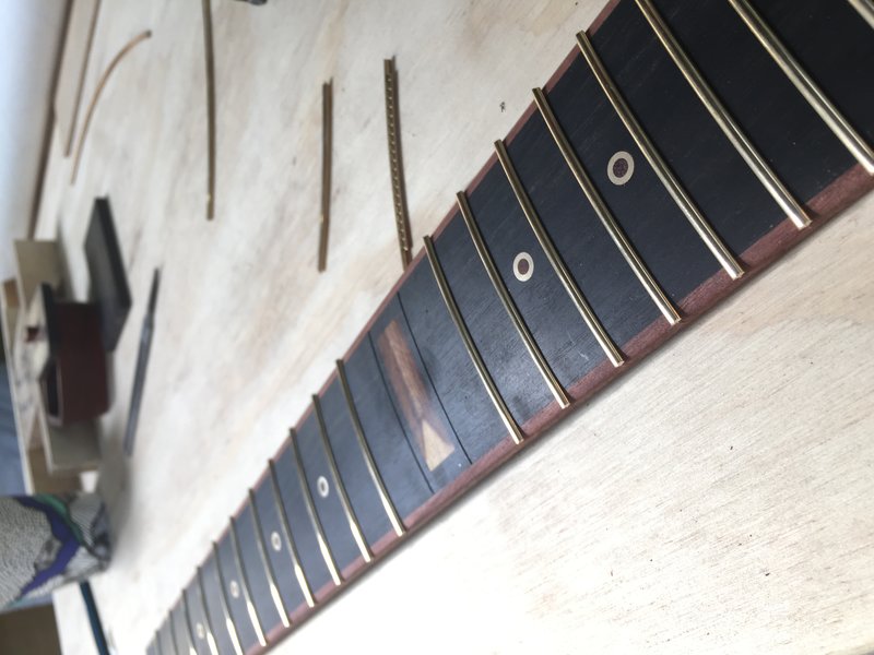

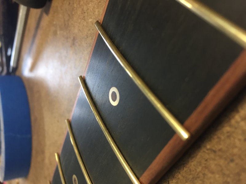

Met up with some Albany luthiers today to put the frets in, Evo Gold.

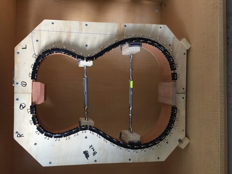

Back bracing.
Just waiting on the humidity before I can go any further on it.
Rim assembly coming together slowly also.
Joseph
