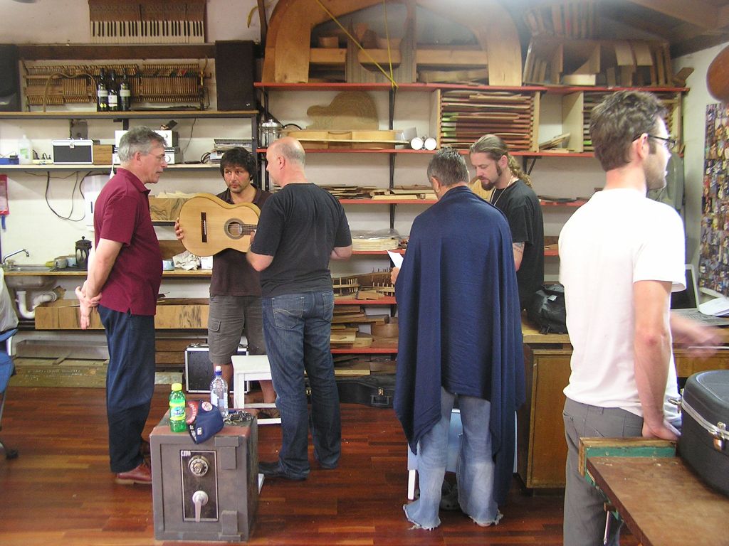

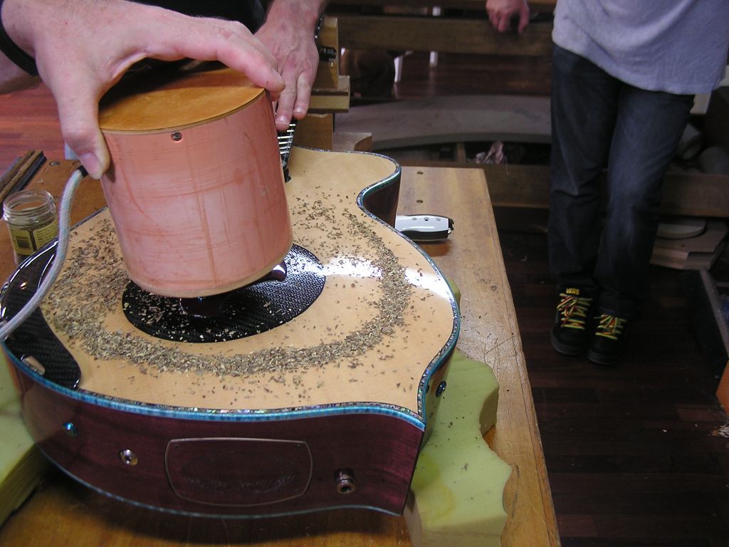

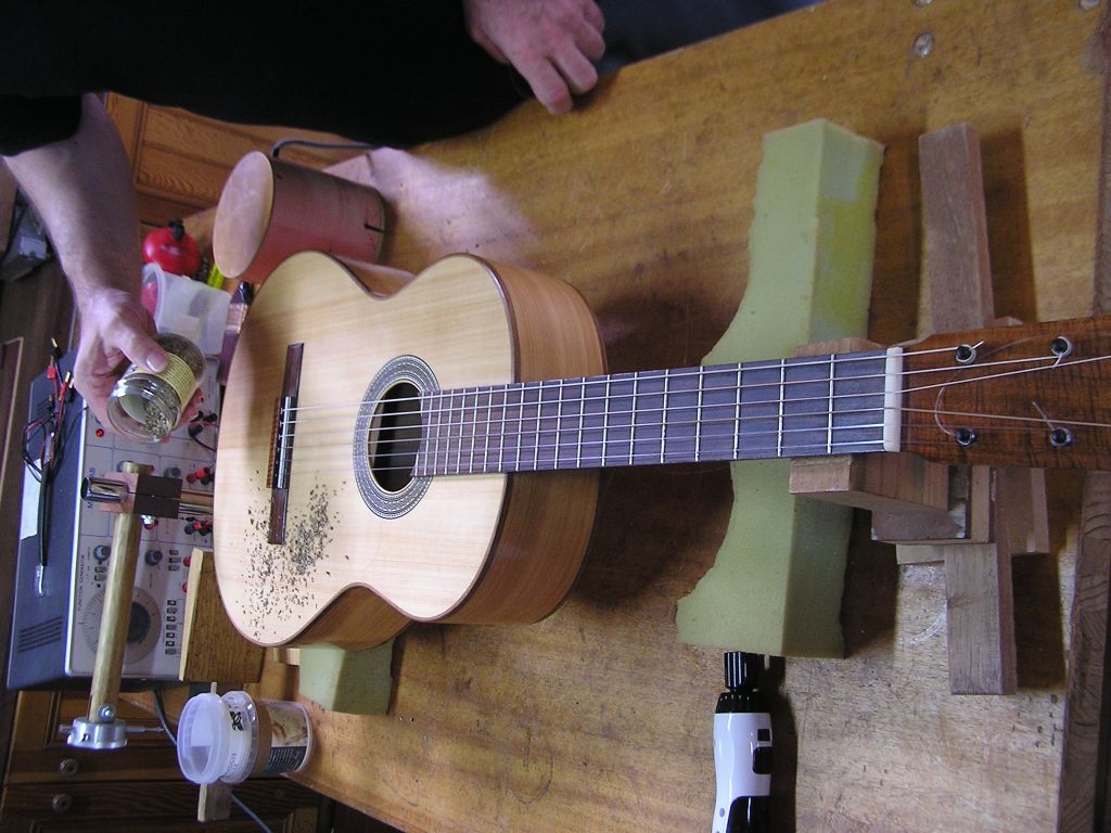

Great thread John and Jeff,
I hope to one day understand just what it is you guys are doing in those pictures, more , a lot more than I do now.

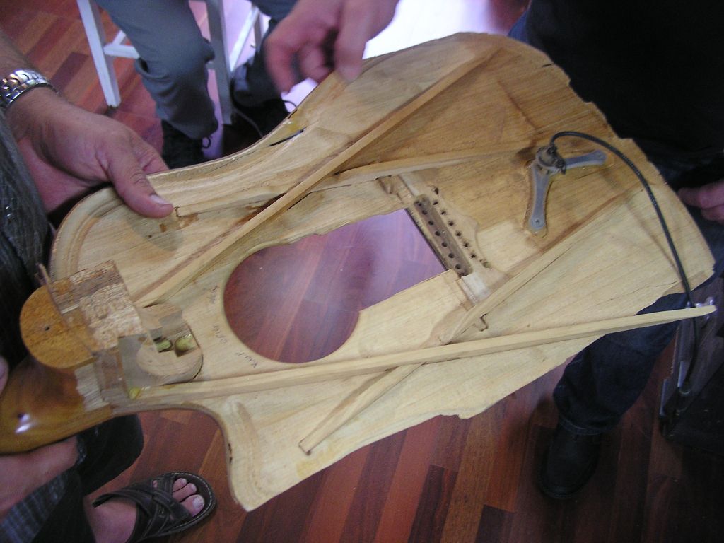

Any chance that one of the attendee's could explain that design Failure with the C C ( I won't mention the Brand name, Brad may not like that

I Did a Guitar making Course with Strato , so I know the Story well , It's a tale of Alchohol , loud music a lounge and a wayward arse , thats what destroyed it at least , the Design failure happened long before that , the Arse just put it out of it Misery !Any chance that one of the attendee's could explain that design Failure with the C C ( I won't mention the Brand name, Brad may not like that)

Well I personally took a guitar that I was a little disappointed with the volume on so I was ready for it to be criticised. The test methods and tuning principles gave me a diagnosis and a plan for remedial action.
There is a lot of emphasis on not accepting "As Built" but moving it towards "As designed" or "As it should have been designed" in terms of sonic performance.

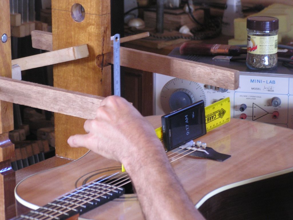

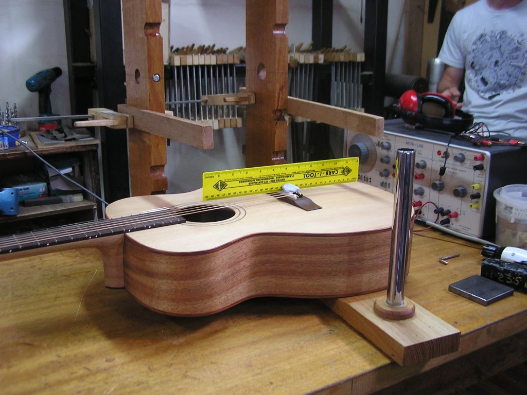

Hi Tod, what I meant by that caption was this....if you want to improve the Monopole Mobility of a guitar you would not stick a great lump of Ali right there. Just one of the things that were made clear to us on the weekend:)Tod Gilding wrote:Yeah with you, SteveKamusur wrote:Whoah jealous now, talk about us mere mortals missing out.![]()

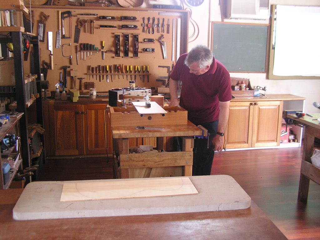

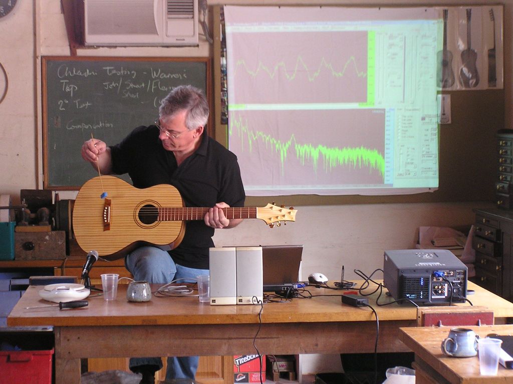

Looking at the first pic' it seems from the sketches on the blackboard that Trevor also re designed the Sydney Harbour Bridge! With his skills, I wouldn't put it past him! LOL!
There is a pic there with three bottles of wine on the shelf in the background. Wondering if that was enough given the number of attendees?
But seriously, though folks, I have never had accurate results with the iphone bridge rotation method, I prefer the formula in the books and the way I set things up is to use double sided tape to stick two upright scraps of wood to the tail of the guitar and next to the neck. A beam is then sat on these uprights (double sided tape again) for measuring the string load deflection using the DS tape to locate the block of wood with the piece of wire in it on to the bridge. I think it's quick and because the beam is mounted onto the guitar itself it eliminates a potential variable rather than measuring using a beam as shown in one of the photos. Then I can measure down from the beam to arrive at the rotation. But one question I always have in mind when I adjust the rotation of the bridge, is where to remove wood from the braces? I usually work the height of the X along with the height of the bracing in the upper bout. Comments please?
