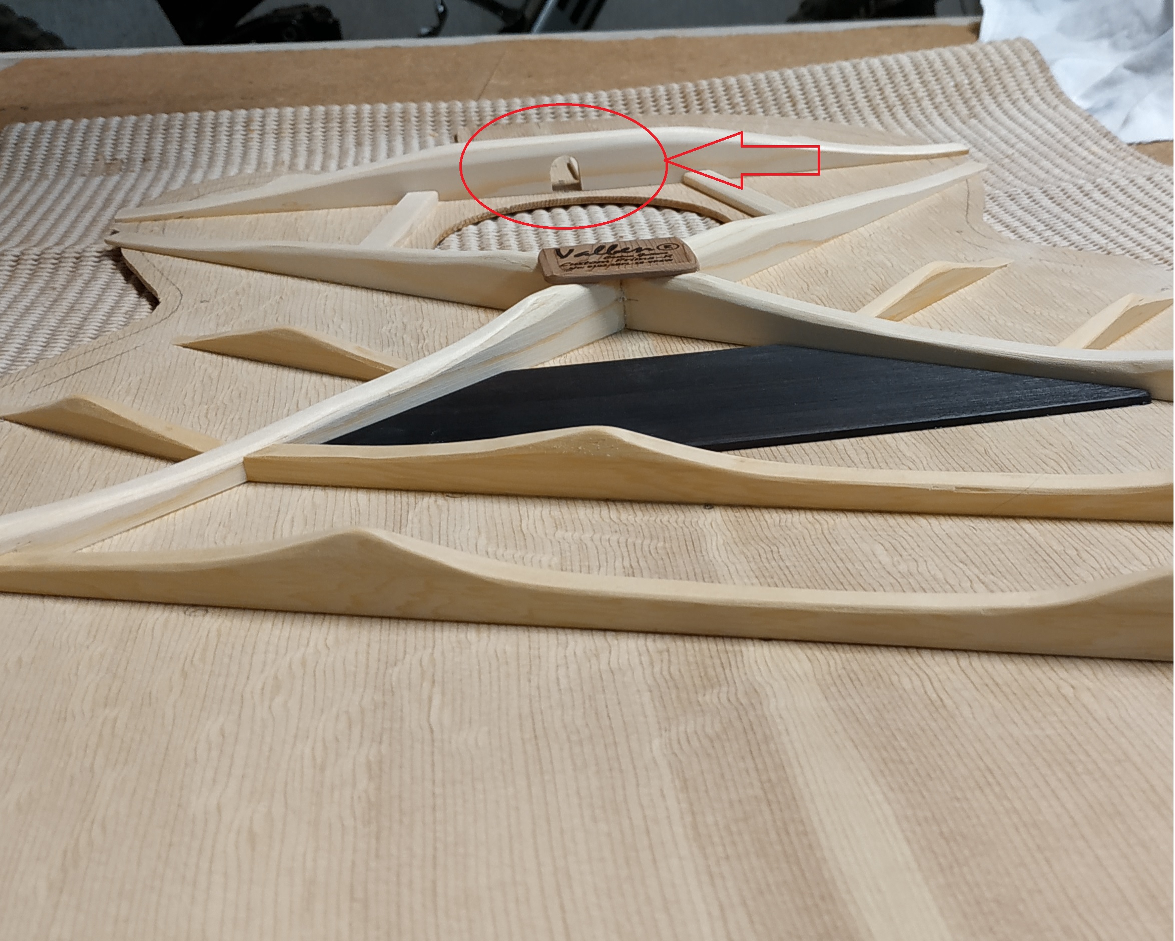

Following pics may help. I keep the opening size in the upper brace about 1 mm more than the size of the truss road end.

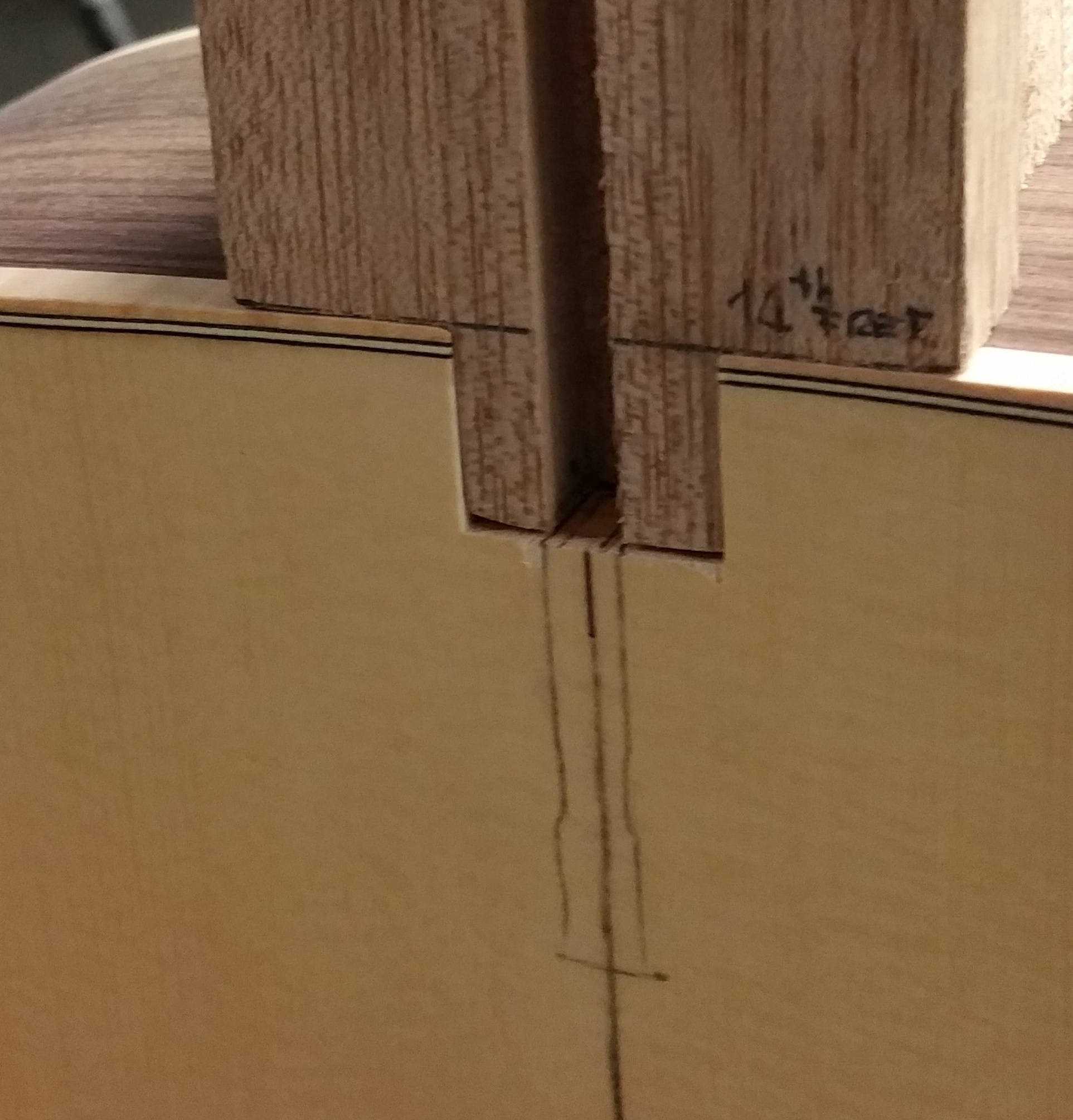

I cut the slot on the neck block and guitar top ( after the neck is installed) with a small laminate trimmer using a clamped fence.

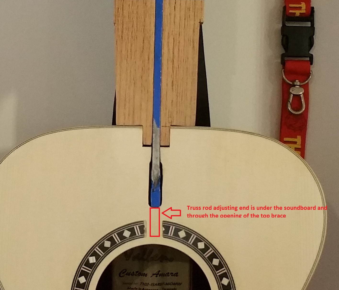

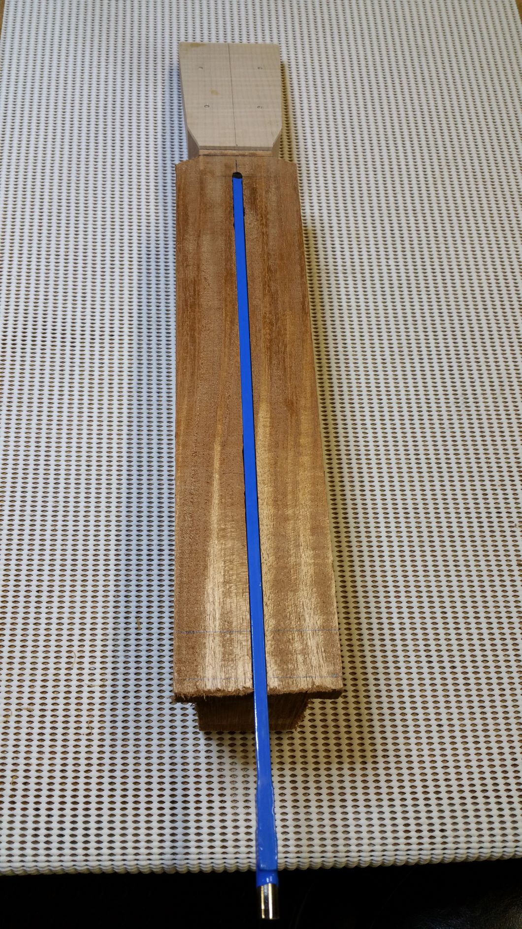

For a soundhole adjust solution you will need a longer truss rod than the the neck adjust solution.
Some pics below may help to understand.
