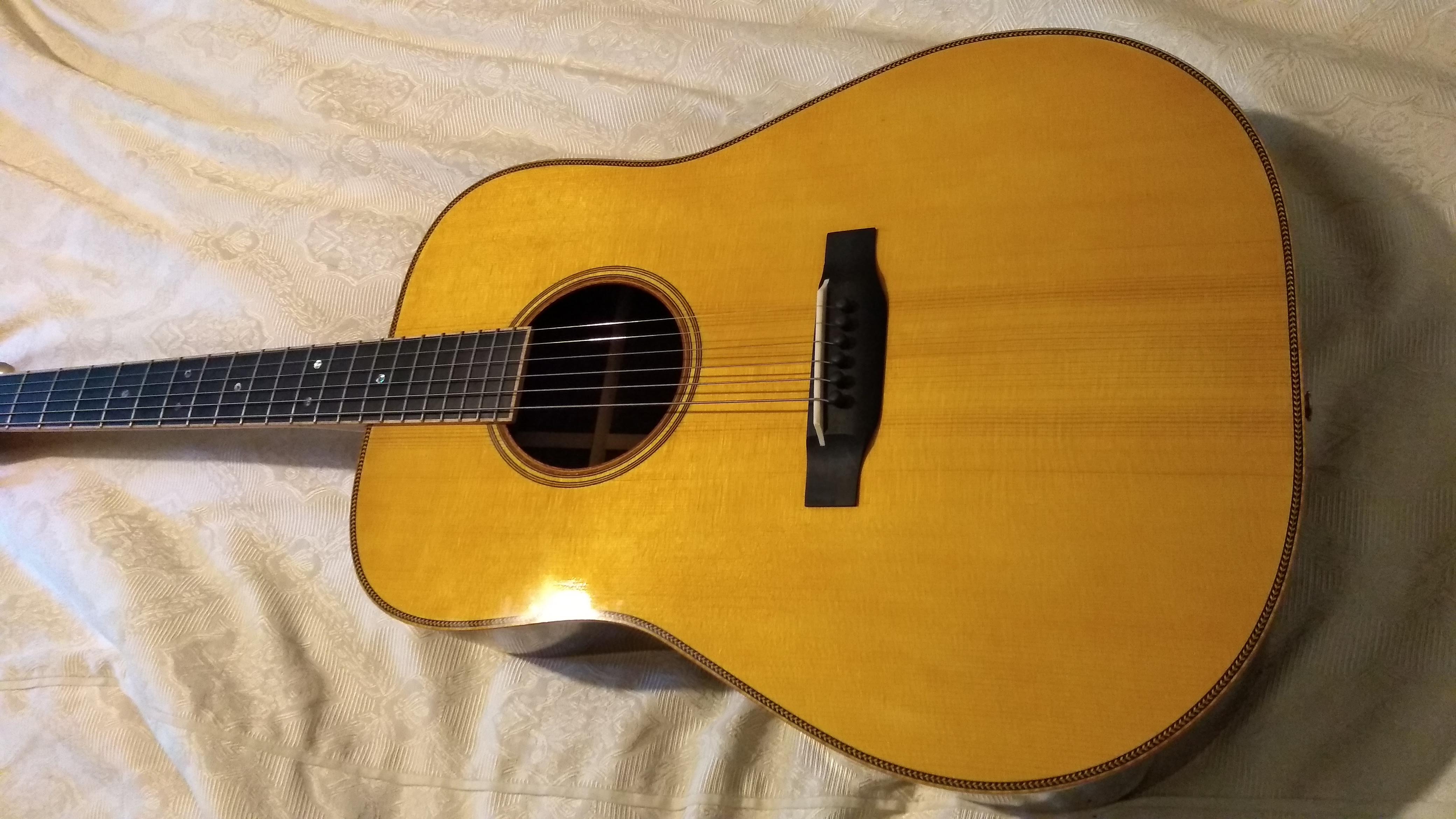

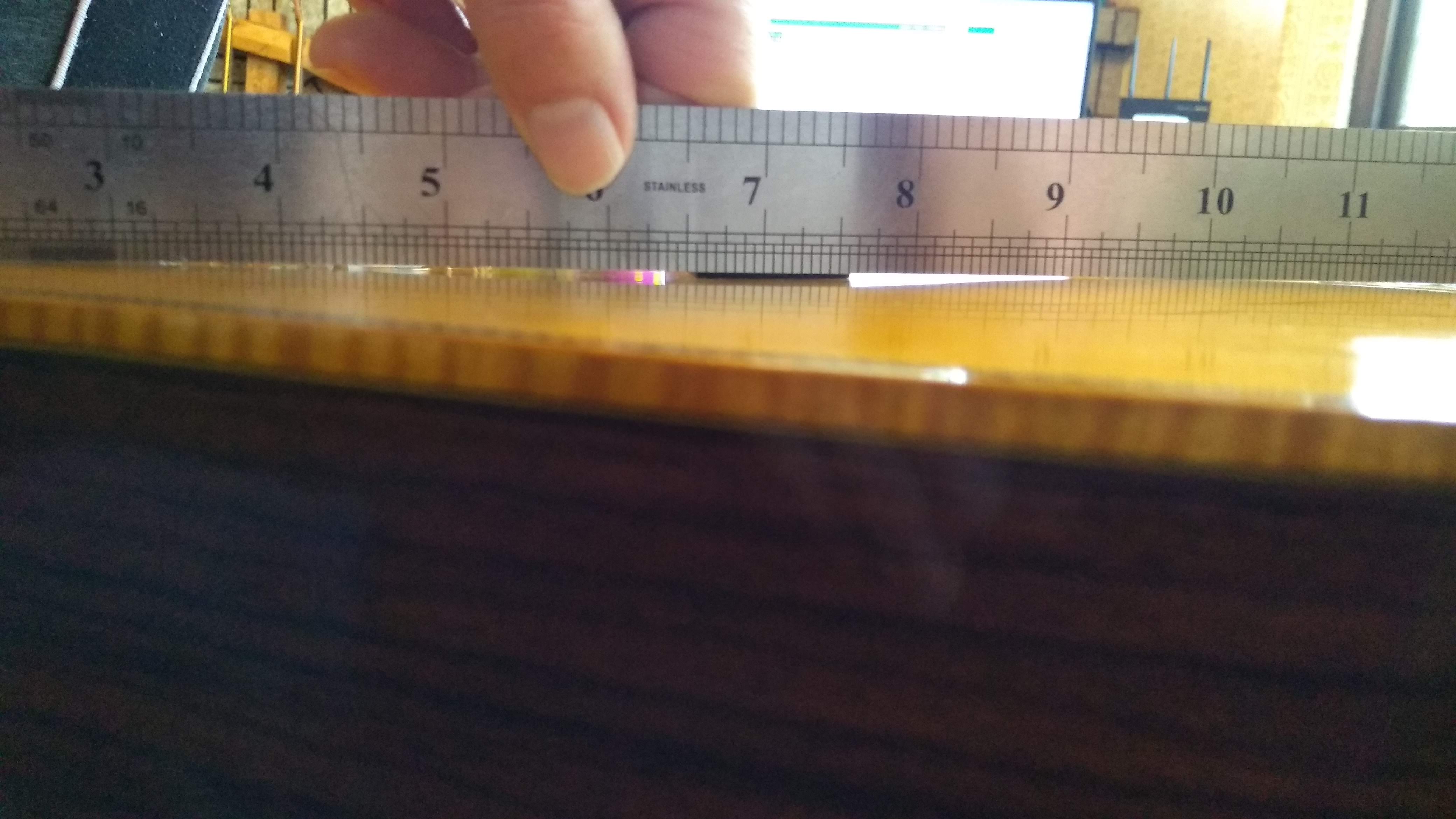

So I just put strings on this beast, and it sounds excellent. But unfortunately it has bellied up, I am thinking it's either under braced or my top is too thin. It's not too bad at the moment but I think it will worsen. Any thoughts/Advice will be appreciated!
P.S. It has forward shifted Scalloped Adi bracing and an Adi top.
Laurence.

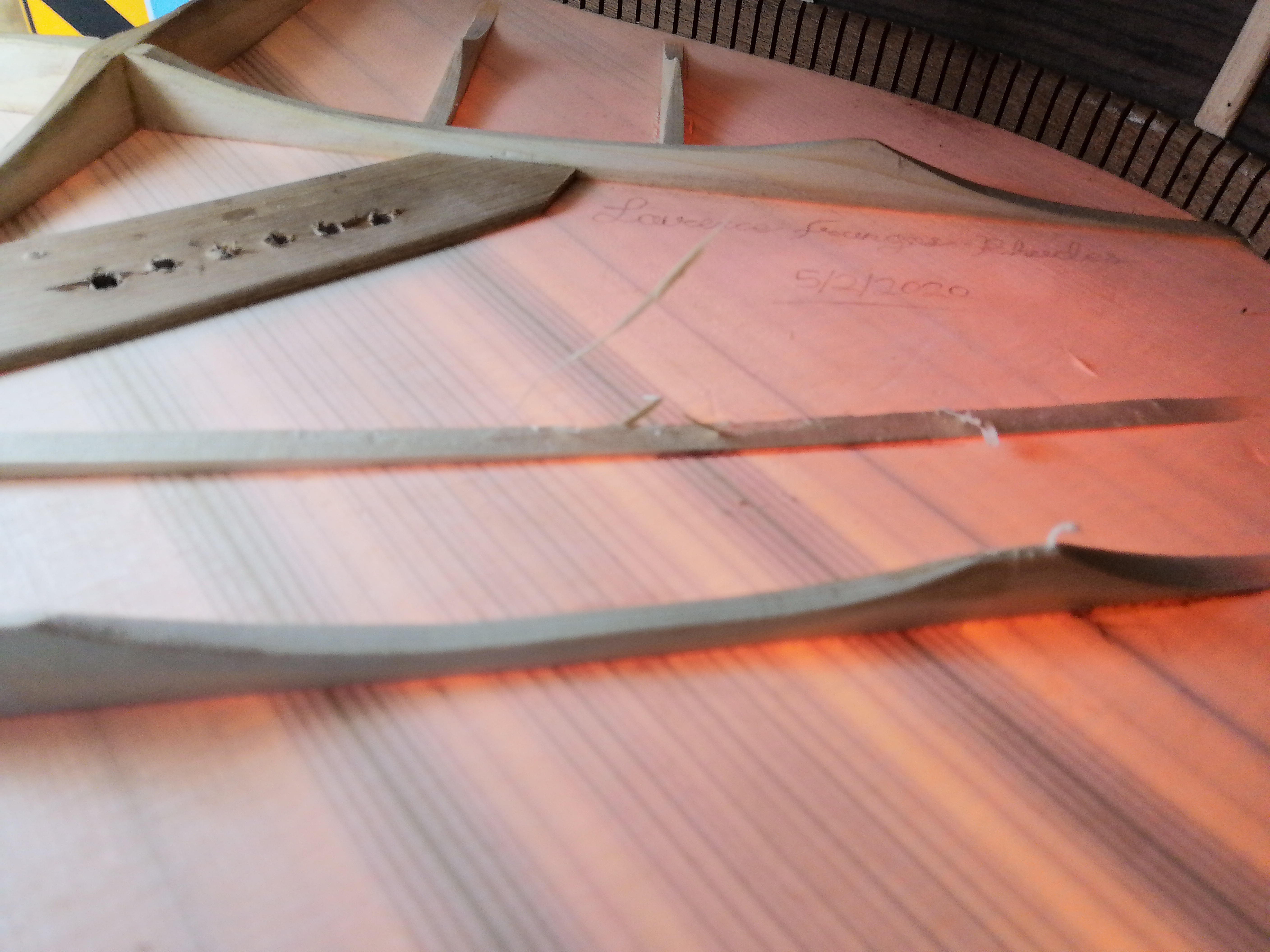

Any pics of the underside of the top showing bracing?

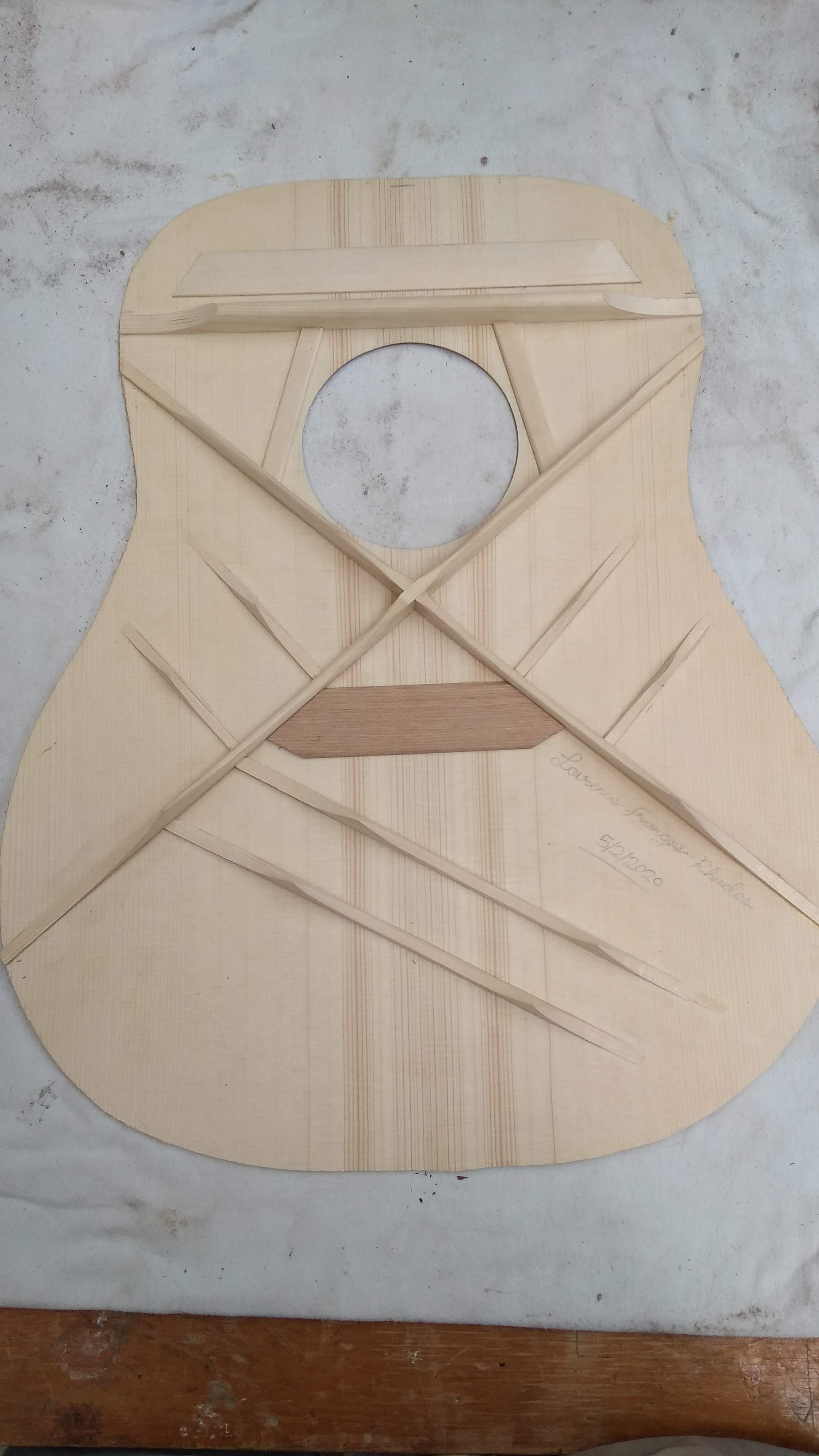

Here is some bracing:
Laurence.

When you say the bracing is forward shifted...you mean you've moved everything closer to the sound hole? It might just be the photo but gap between end of X brace/tone bares and sides looks a bit on the large side....but maybe that's just me. Does the start of the of bellying correlate with the scalloping on your main braces and tone bars?
How thick is bridge plate. What sort of wood and which way is grain going?

What's the top doing in front of the bridge?

Yes I moved everything towards the sound hole 13mm, Except the popsicle brace etc.

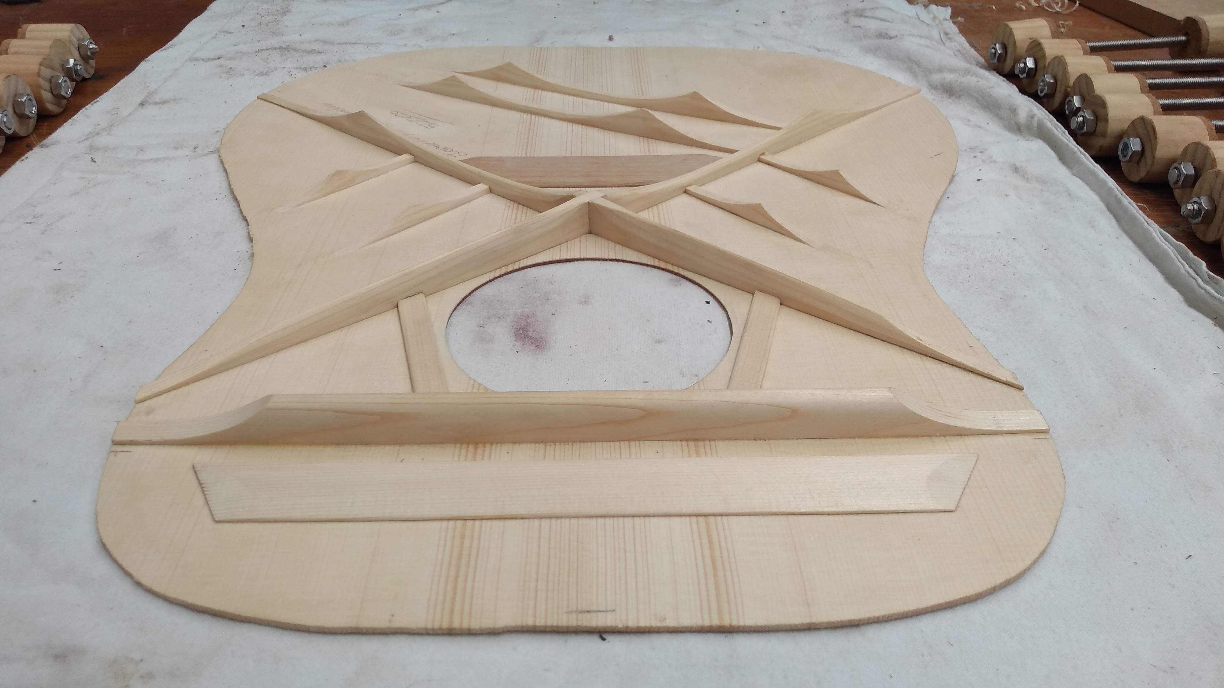

Here is a photo when the top was off:
there is about 10/15mm of extra material around the edges of course that got cut off after the top was glued.

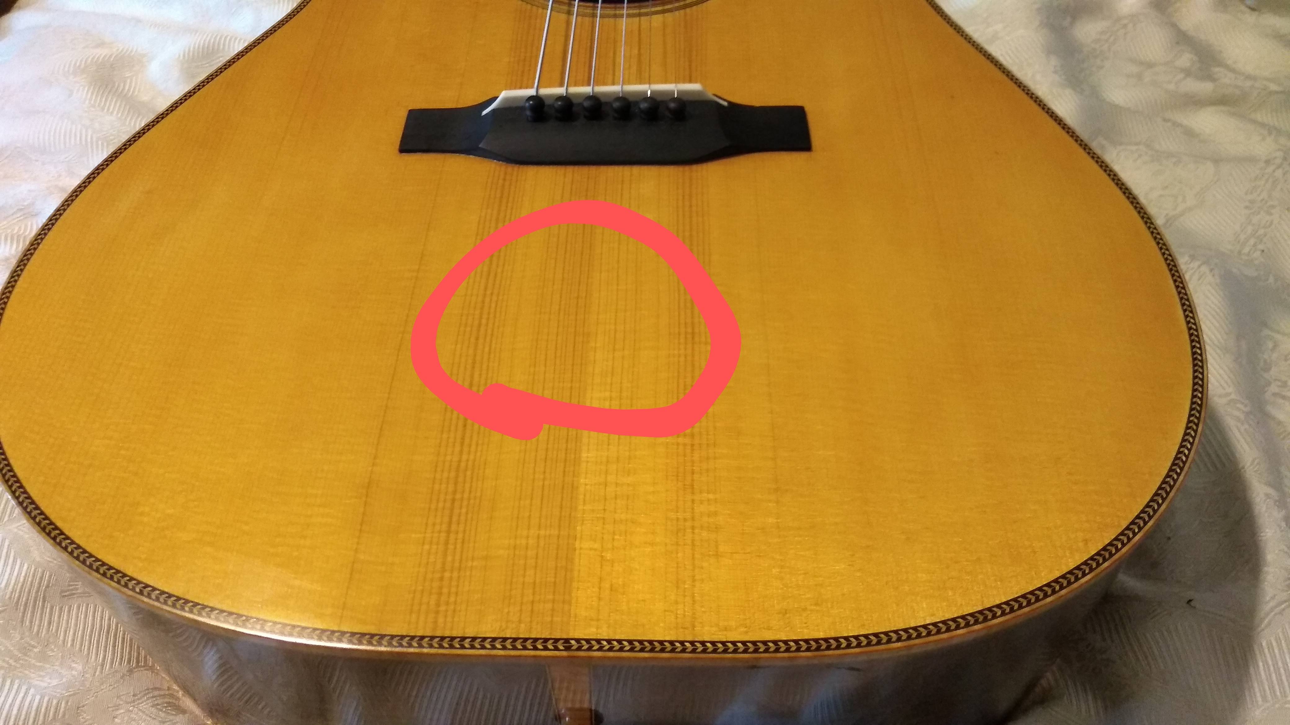

And here is where it is bellying:
so between the X braces only.
The bridgeplate is about 2.5mm And made out of flatsawn heart Rimu.
The top in front of the bridge is mostly ok, it has hardly moved at all, the radius has flattened out but only slightly.

My initial thoughts......the scalloped section in the middle of those tone bars might be a tad to long. I tend to make the scalloped and peaked segments more equidistant when I do scalloped braces.
Any thoughts from other members?
Re: Bellied up top
Post by simso » Thu Mar 26, 2020 5:10 pm
Looks to me like a over scalloped x brace, I have never taken any even close to those shown

I was taught not to start the scallop before the bridge plate for structural reasons. When I shift the braces toward the sound hole I am thinking about just the X not the entire scallop pattern. The low part of the braces are right where you need structural support.

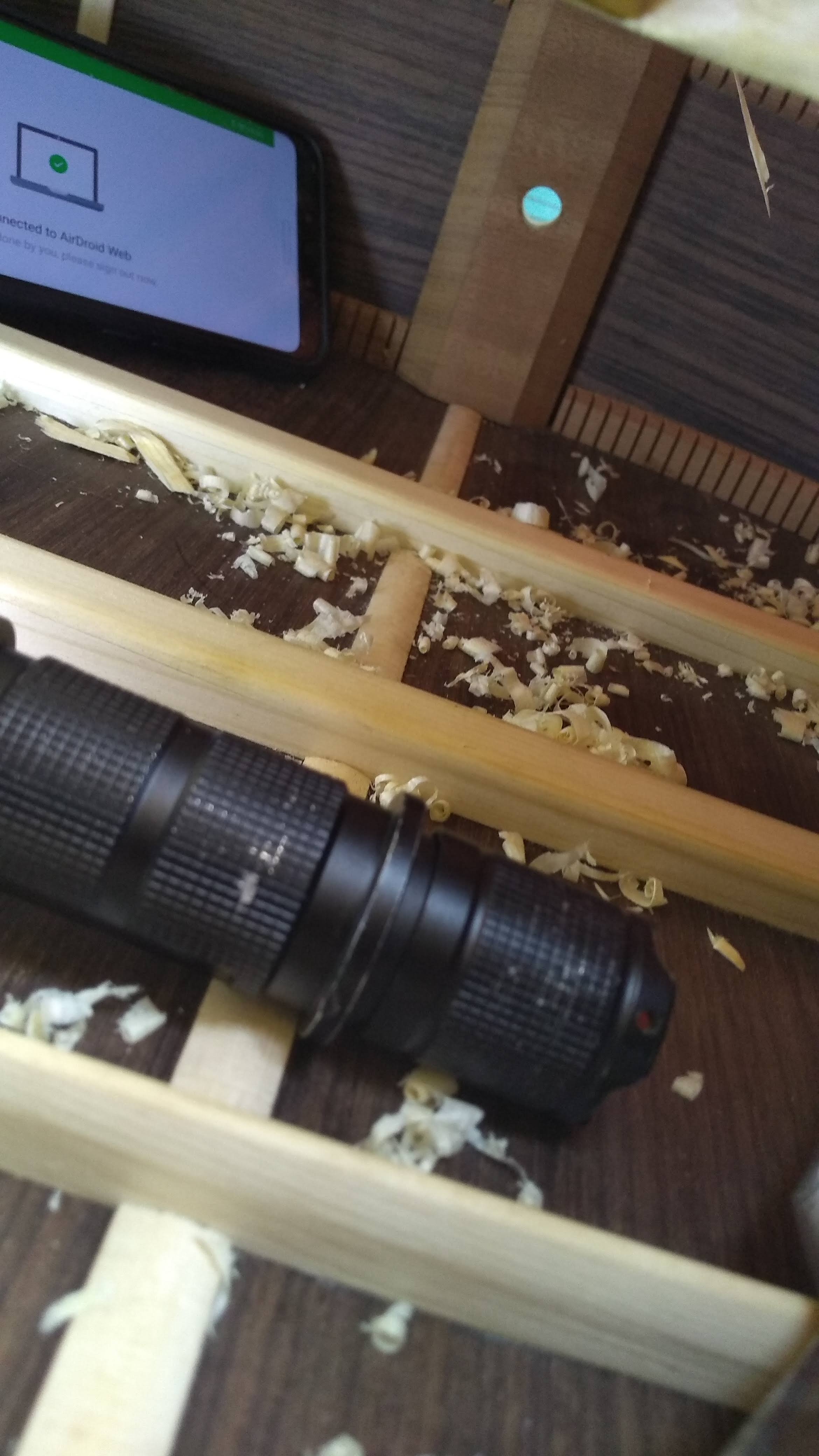

Post by limehills » Sun Mar 29, 2020 10:45 am

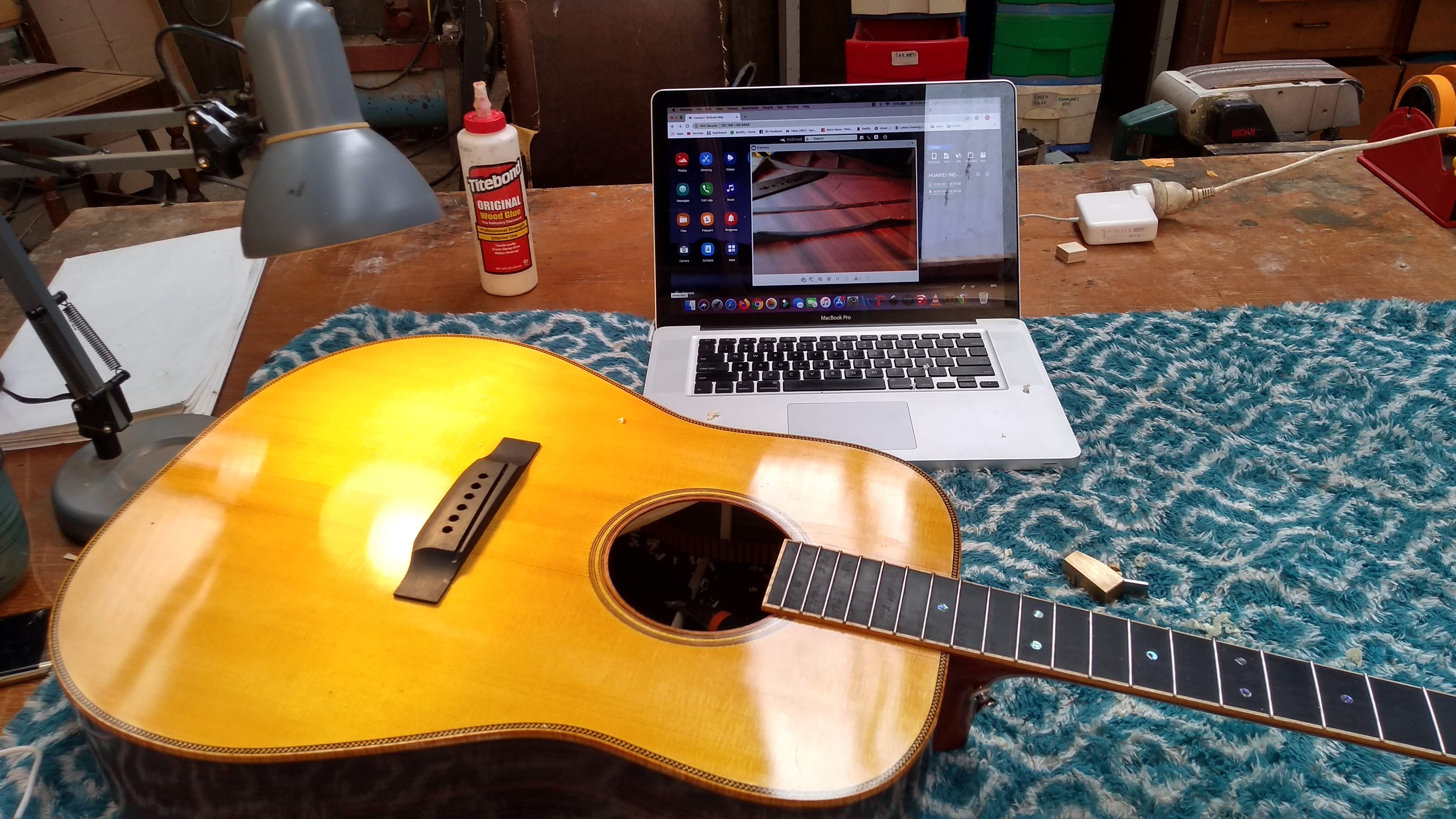

Nope I decided not to take the top off, I spent many hours french polishing this one so I wanted to try preserve the finish.
I used a finger plane and Carved the bracing off from the inside.
I did this by putting an old phone inside the guitar and live streaming it to my laptop!

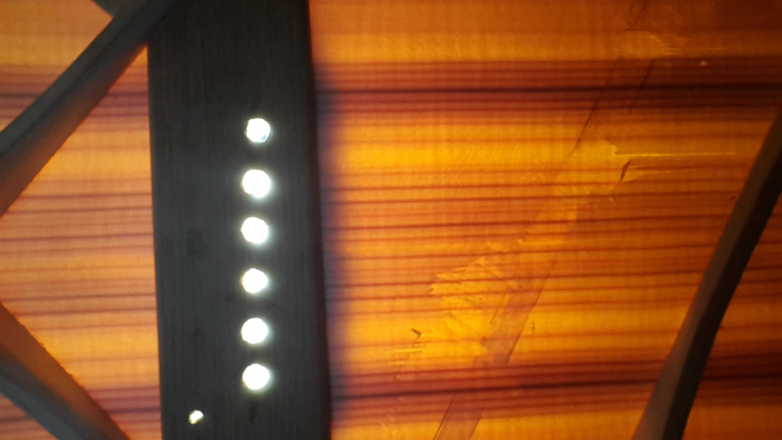

And here is a photo of the bridge plate:
I definitely think it needs to be bigger.

You're going to do a brace replacement job with the top on? Good luck with that :)
Have you considered how you're going to clamp up the new braces without damaging the finish on the top? All your clamps are going to have go in via the sound hole and there's only so many clamps you can jam through same.
How are you going to ensure the top curvature is maintained while gluing up the braces? Just a few things to consider.
Good luck

I am using small cedar go bars to clamp the bracing inside. As for the curvature it seems to have retained it quite well. I'm only planning on replacing the tone bars and bridge plate, I'll see how it is after that, if it's still playing up I'll do a re-top but I thought I'd take my chances.

I do not think changing the tone bars will do anything for you. The belly is from the nut side of the bridge rotating in. One fix I might try if I did not want to remove the top would be to sister taller braces on the over carved x-braces from the X to the finger braces on each side.
