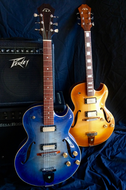

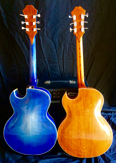

Her's my two archtops. They are both the same dimensions (16 1/4" body, 25" scale) but different woods and pickups;
The sunburst one is spruce top on sheoak back & sides, maple/sheoak/maple neck with flame jarrah fretboard, Seymour Duncan pickups.
The blue one is all maple, with flame jarrah fretboard, Gibson mini humbuckers.
I have a smaller body under construction but won't get back to it for a while having just moved into a very run-down home which I'm working on frenetically while 'social isolating'.
Cheers.
Yes, happy to meet up post corona. I'm in Swan View.
Cheers.
