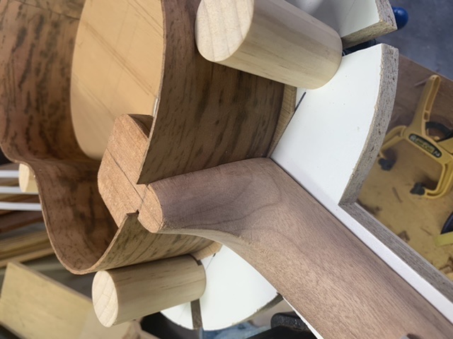

With the neck block fitted and the sound board in place, it is clear that the sides are a couple of mm too deep for the neck. I could taper the sides, reduce the overall depth or build up the neck block. Suggestions or advice received gratefully :)

You could put a nice contrasting Heel Cap in that space ... That's what I would do, just for the hell of it ...

You could do both, put a heel cap on and then taper from the waist to meet it.

If your sides are the same depth at tall block and neck then your uke is going to look pretty strange. They should taper in body depth from deepest at tail block to the neck. I use 10mm between the two on all sizes of my ukes.
Pretty easy to achieve this by using a small plane and pare away excess from waist to neck and then use a piece of plywood or mdf with 80 grit sandpaper to level / even out the transition.....or a radius dish if you are going with that type of back.
I have a radius dish mounted to an old repurposed potters wheel and this job would take me 30 seconds to a minute.

Thanks all. I think a taper and heal cap sound like a plan. I’m not using an arched back and haven’t put together a radius dish at this time, so plane and sand.

This all looks normal to me. Agree with taper the sides, the block and the heel cap until all is in plane.
