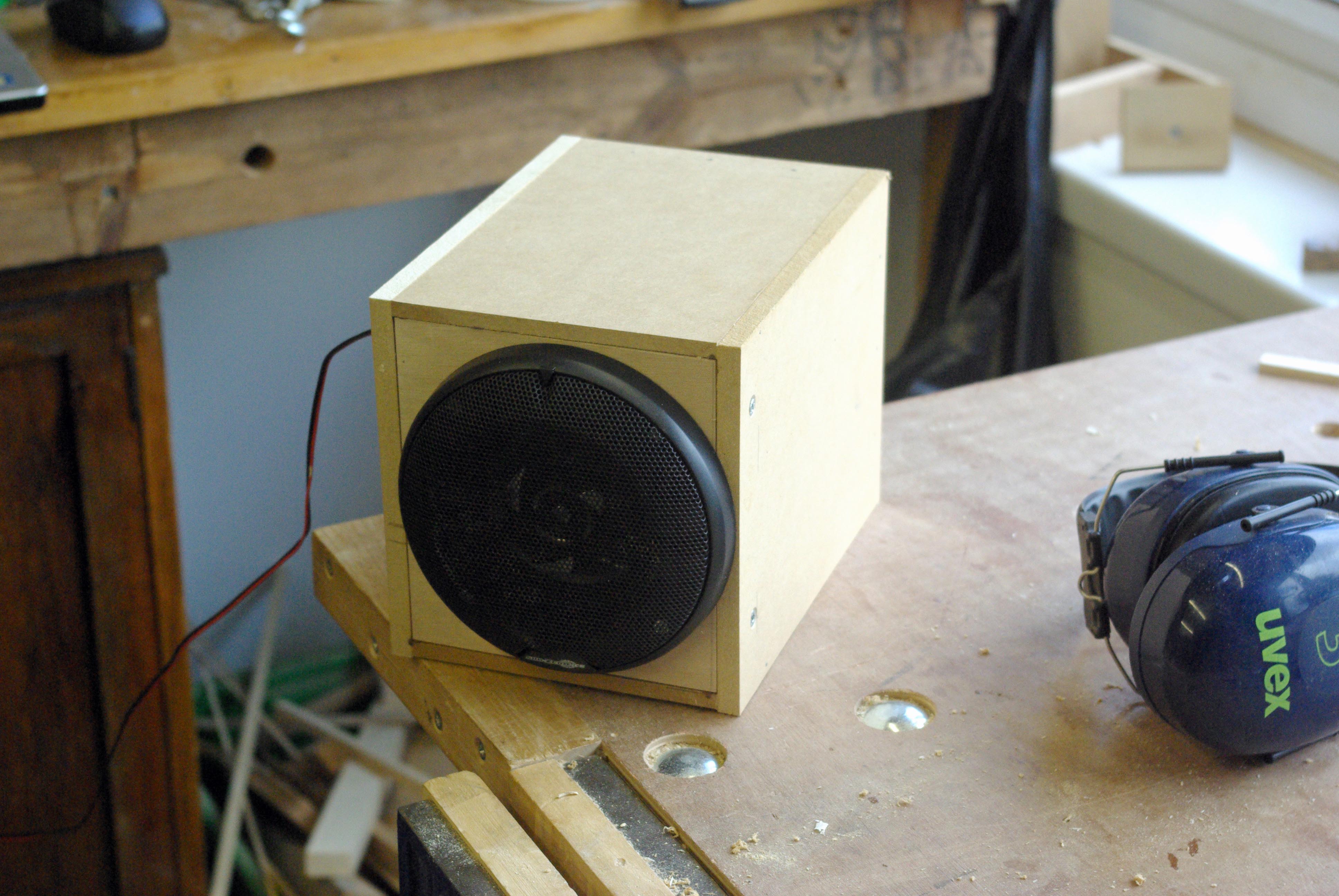

I thought I would flesh out Ross's note about Chladni patterns which are indeed very useful, particularly once past the first three main resonances I bought a pair of cheap car speakers and drive one through an old domestic stereo amp that like so many people I was reluctant to chuck out! I use Visual Analyser to generate a signal but there are plenty of other bits of free software around. So the whole thing has cost very little money, and the 'dancing tea leaves' have given friends some great amusement!
