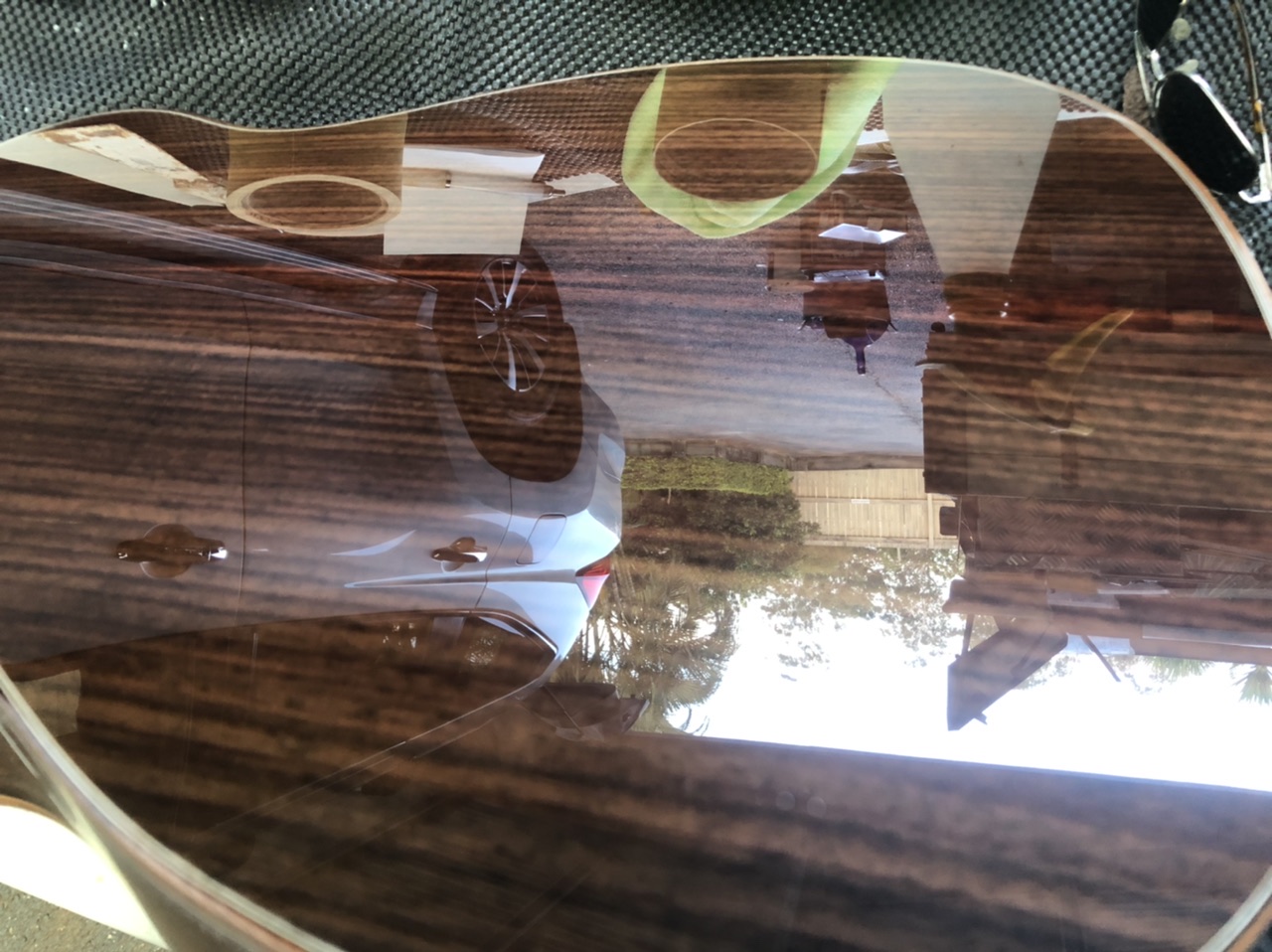

Hi to all, long time follower but first time poster.
I have fairly recently started “building” guitars after seeing a few impressive specimens that my neighbour built. My plan has been to build something halfway decent as a birthday gift for my brother, my first prototype (with low cost timber) was a disaster that has taught me a lot.
One of the tasks that I hated was pore filling with Bote Cote (I also broke out in a rash from use) so I tried several other methods without much luck.
On my second guitar I went back and persevered with the Bote Cote for the neck but dreaded the thought of doing the back and sides of the body, after pore filling the neck I proceded to spraying it with Mirotone 3220...I was in love!
I found the Mirotone so easy to work with that I tried an experiment, I applied two brush coats of straight Mirotone on the back of the guitar, allowed them to dry for 48 hours then lightly sanded with 320 grit ....PERFECT pore filling!
I then applied about 10 light coats of 60/40 thinned Mirotone, left to dry for a fortnight, went over the whole back with a card scraper then 320 grit, 500 grit, 800 grit, 1000 and 3000 wet and dry.
This afternoon I hit it with my orbital buffer and the finish is more than I could possibly have hoped for, I can’t wait to buff with the fine compound.
Many, Many thanks to all on this forum (And my neighbour) for the ideas and inspiration...so far so good!

That looks OK......just kidding that looks amazing.
FWIW the Mirotone guy told me it can be used as a seal coat and no more than 4 coats total - but whatever you did keep doing it.

Thanks Richard, I would be interested in the thinning ratio recommended to you, that could be the difference?
I followed the ratio of 60/40 with 10 total coats as recommended by Allen R. McFarlen in the tutorials.

In deep pores using this method you are going to experience some serious sink back down the road as the lacquer continues to dry. And that process of drying / shrinking never stops with a solvent based lacquer.
That's why when builders are serious about dead flat and high gloss finishes that last they go with pore fillers that pack those pores with a product that isn't going to move or shrink.

Re: My pore filling
Hi Allen,
I have given your reply considerable thought and carried out some tests and observations, you are correct about the sink back but I think you need to take into account the time taken for the solvent to evaporate.
The amount of gassing off? Decreases exponentially over time, you mentioned in a post on use of Mirotone that you left the finish for approx two weeks until you could no longer smell the solvent, therefore leaving the pore filling for some time (two weeks?) before sanding/spraying should mean that the sink back is negligible...which is exactly what I have found so far.
Kev
