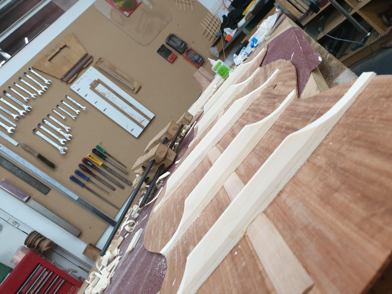

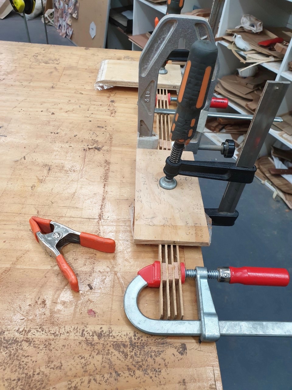

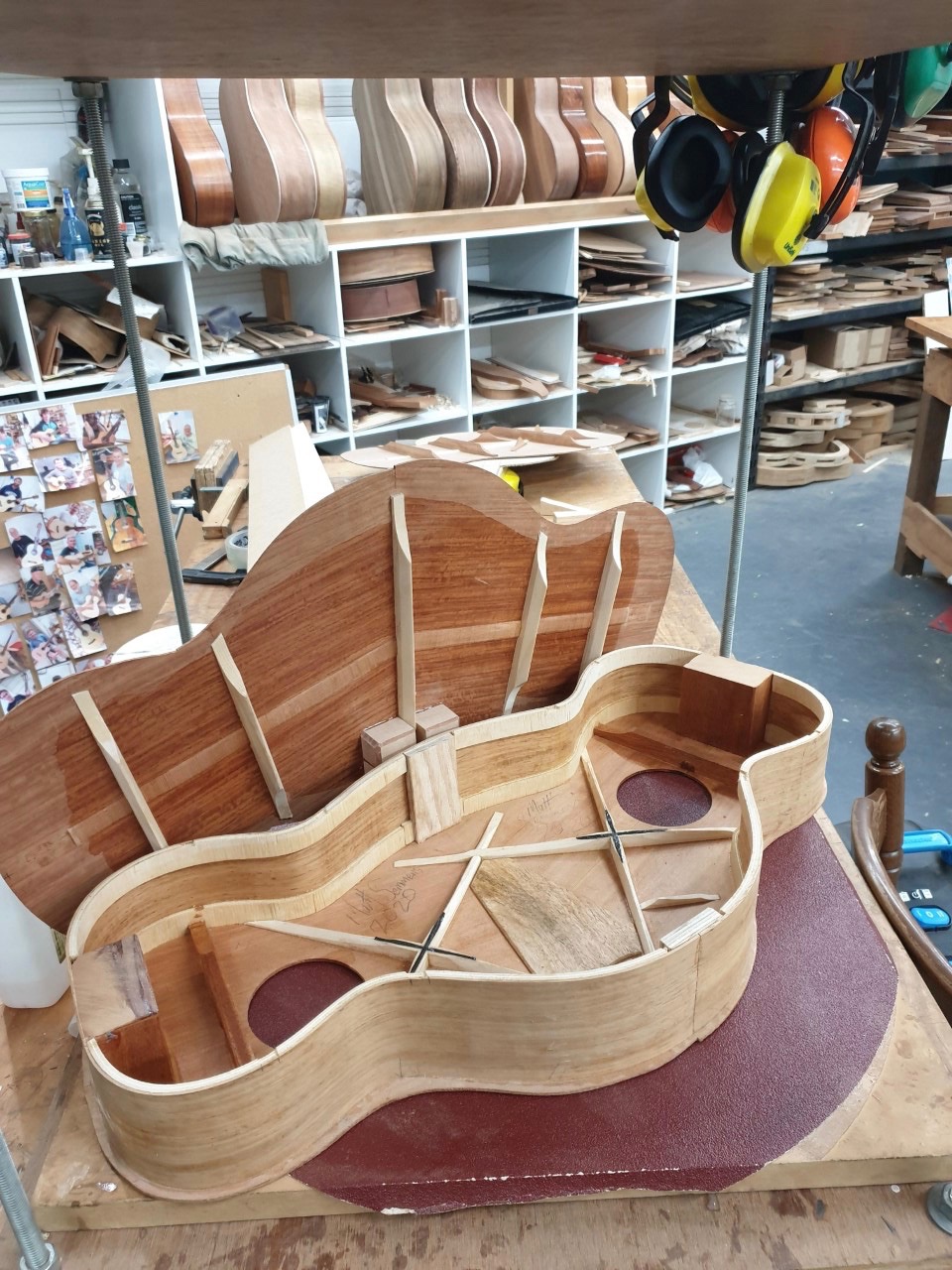

well things have moved forward on this crazy build here are some pics for your viewing pleasure!!
back braces carved
Ready for glue up
Gluing some black veneer to the side offcuts for bindings
Boxed Up

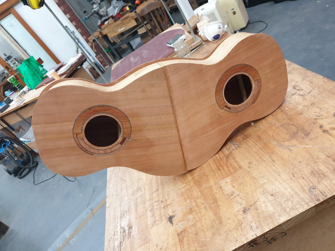

I can’t wait to hear a review of how it sounds. I’m a little puzzled by the joining of the two soundboards along that straight line and how they might vibrate as a single plate.

I completely agree. I explained to the customer that this would be an experimental guitar and normally I would guarantee an amazing sounding guitar but wth this baby....it will be able to be played right and left handed. The sound will be yet to be determined!!! It's more show I think. Both guitars will get a pickup in them for stage work.

The Necks and bindings are now on!!!

How the guitar will sound will be interesting but looking at that massive bridge plate and the low area of unbraced or lightly braced lower bout I wouldn't expect a lot of volume. Main top frequency may also be off optimal value(s).
Lets see how she sounds once she's finished.

The Air frequency is sitting a little higher than normal due to the 2 sound holes but the top and back are Ok relative to the top. It actually has a very loud tap tone giving it a whack with the thumb technique :D.

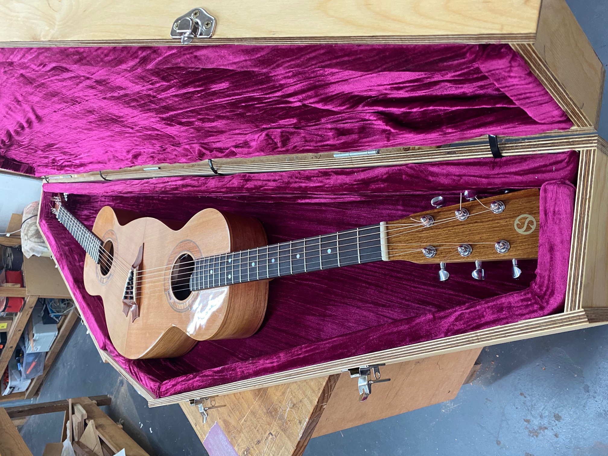

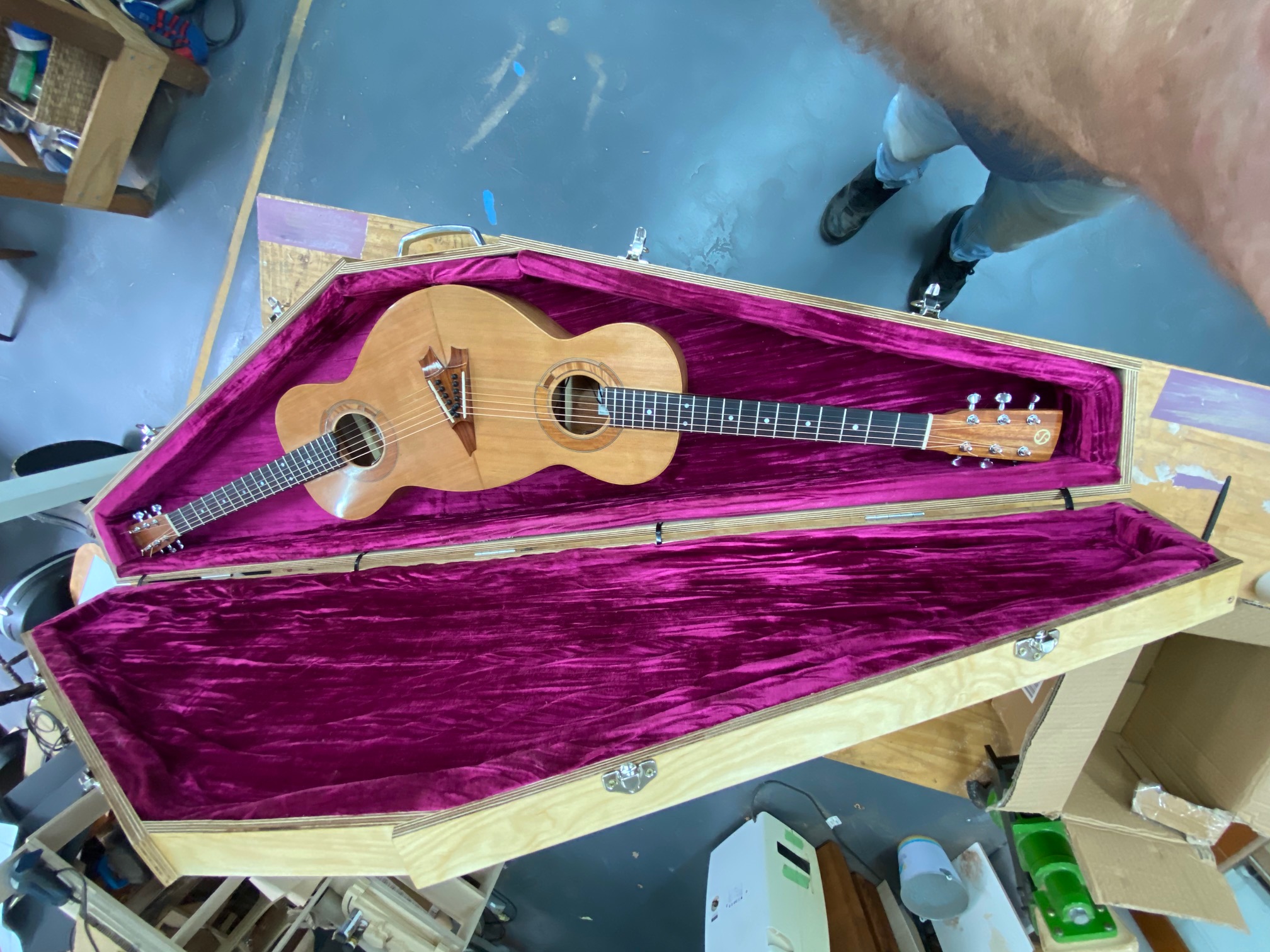

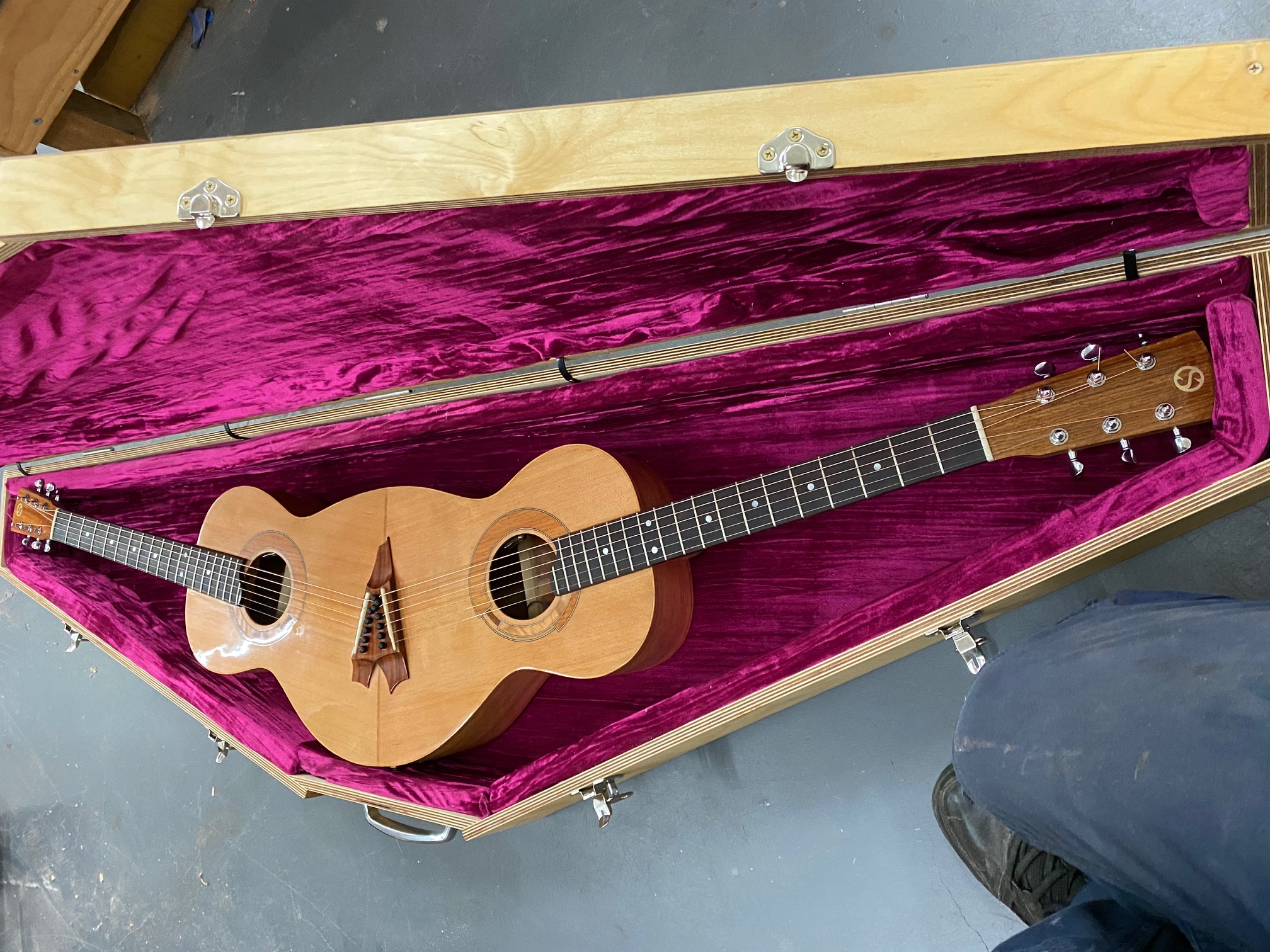

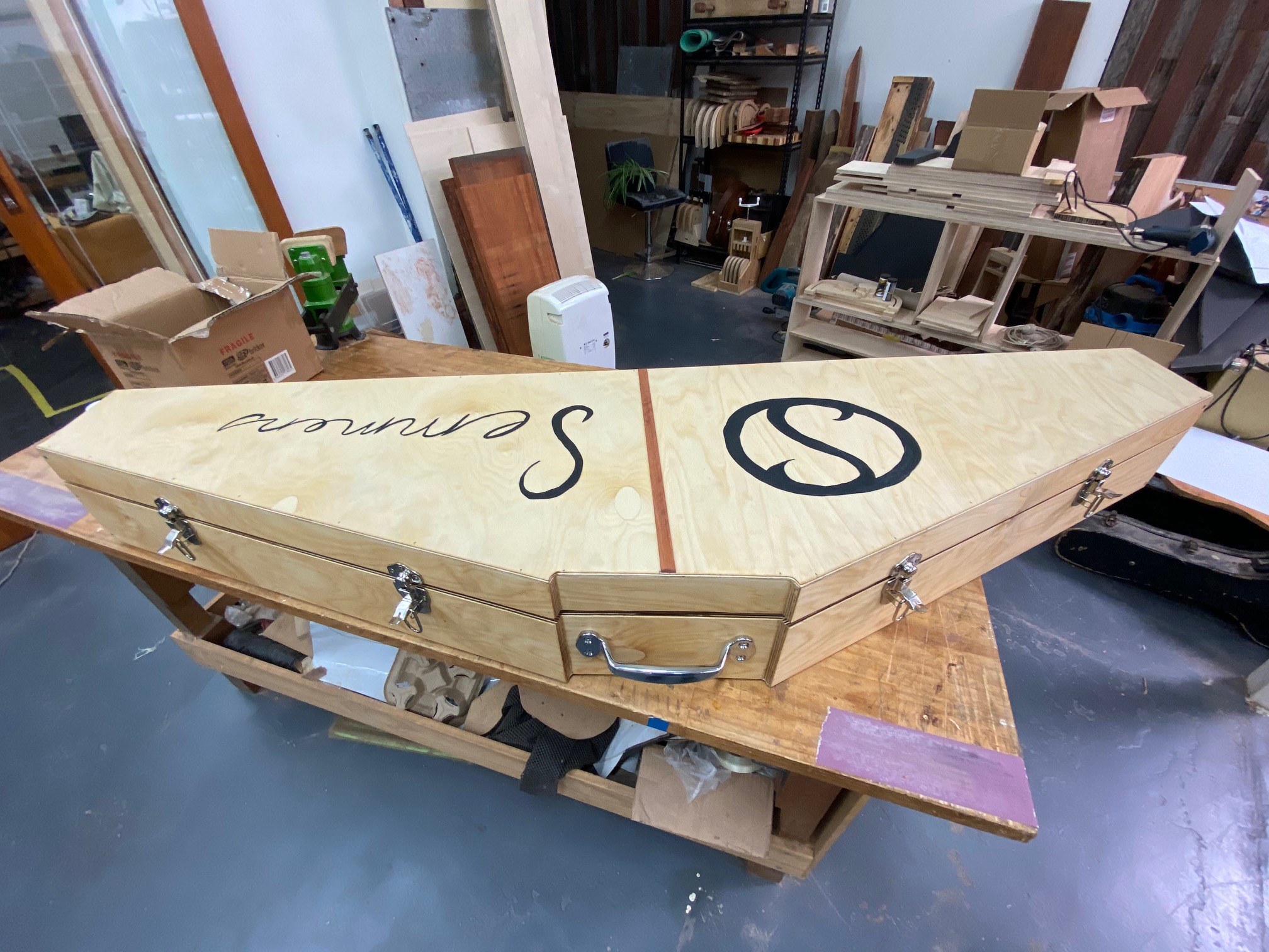

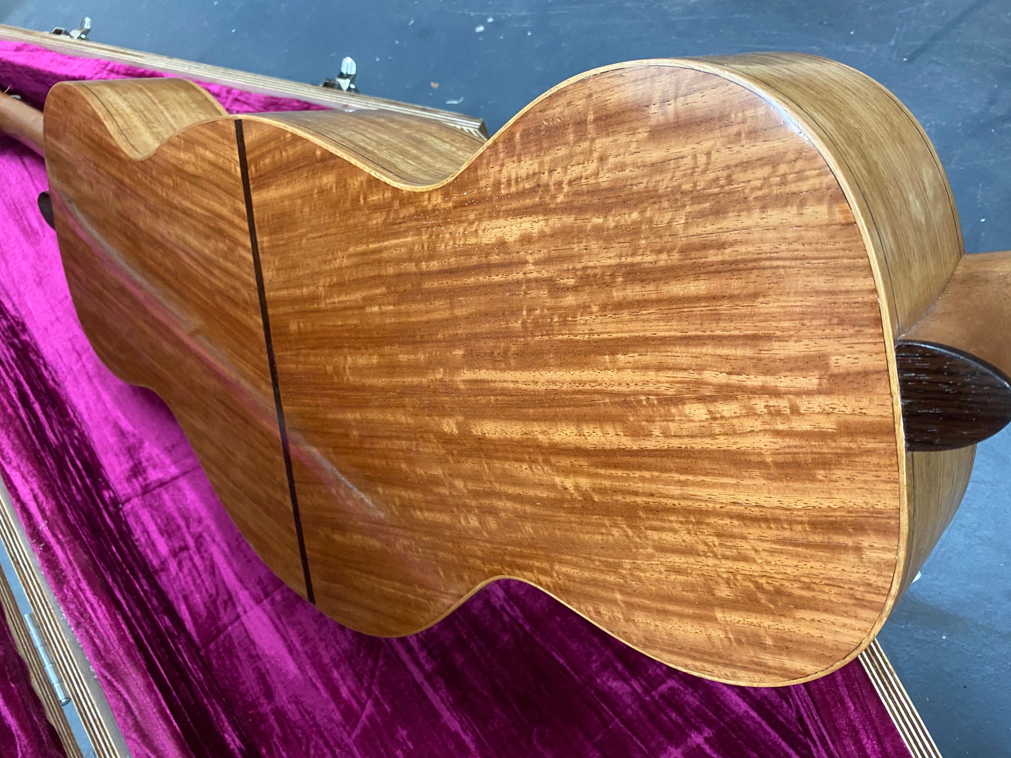

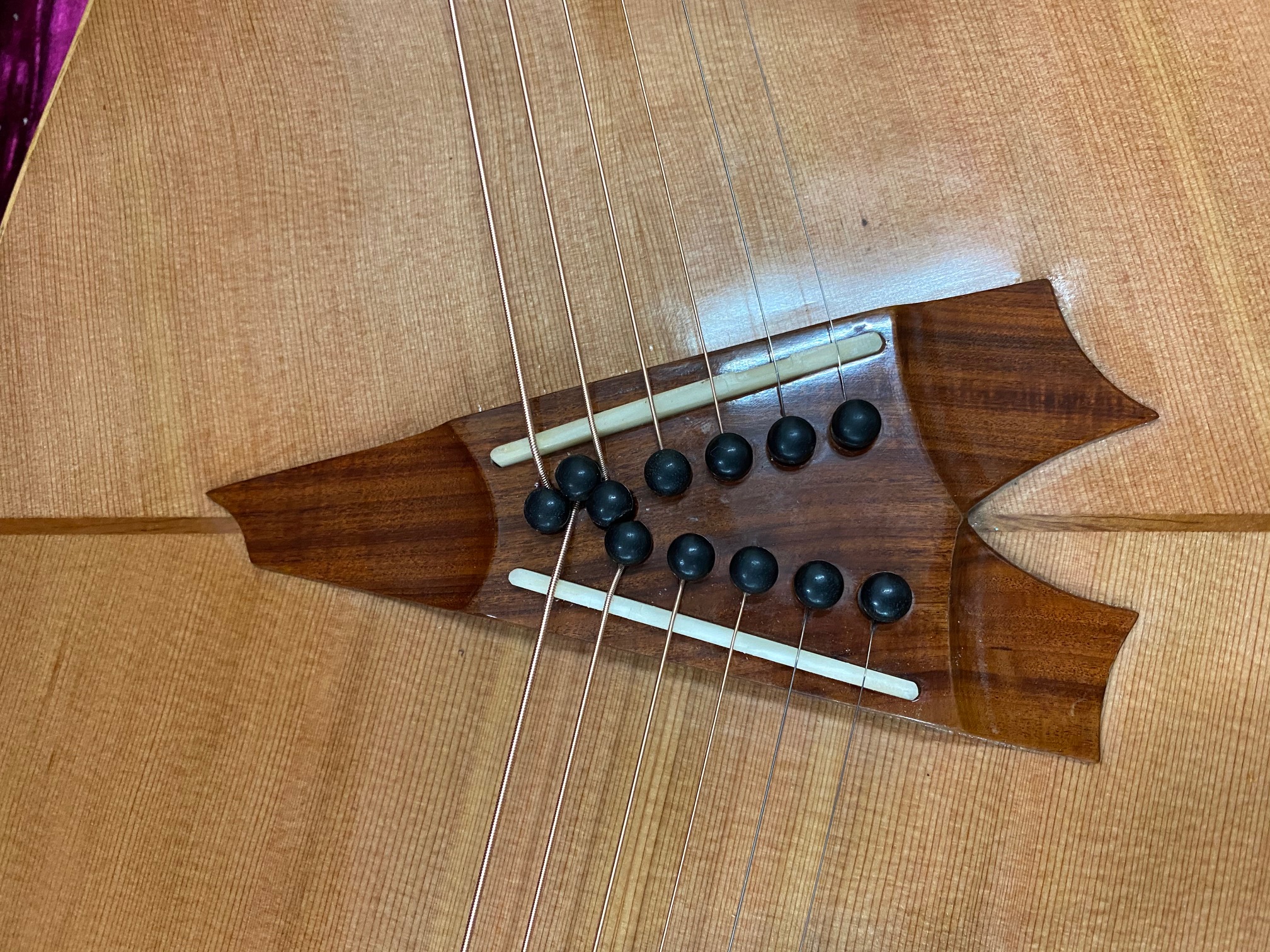

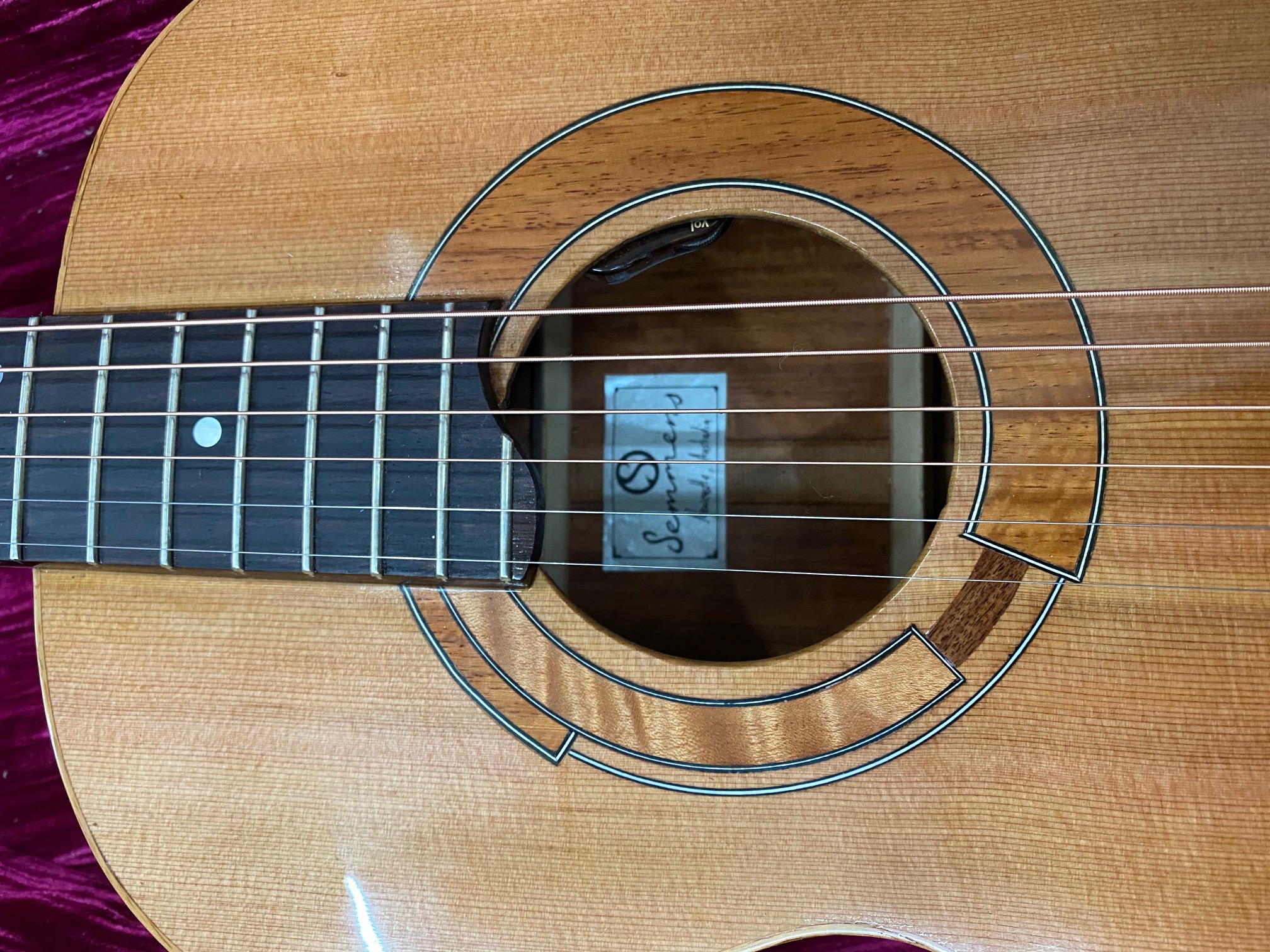

Post by Semmens Guitars » Sat Oct 31, 2020 8:37 pm
The "Double Yolker" as it has been lovingly called at the school is off to its owner tomorrow morning. Here are some pics. It sounds really good with a big full sound. I will take some video tomorrow before I send it to its home and post a link so you can have a listen if your interested. It was a wild ride!!!

Wow, amazing that you built it and really good work in the construction. It seems like it would be a bit awkwards to play, unless there was a right and left hand couple playing it together.

Wowzer!!! Great job on an unconventional build. Glad it works well too.

Well done Matt! What a crazy project. Can't wait to hear it :cl :cl

Yes, that is an interesting (crazy?) idea - really well executed. The case is very impressive too.
