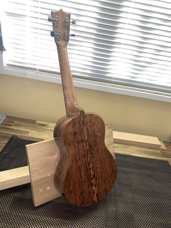

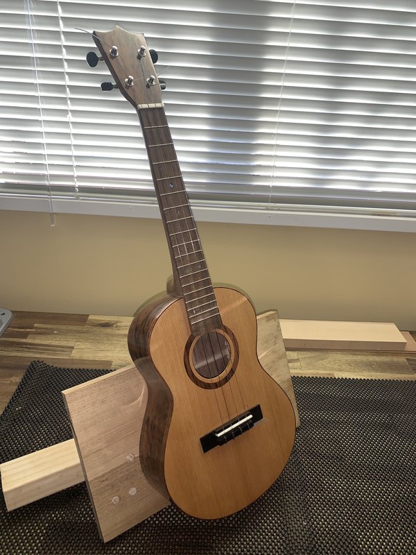

My second uke - a 14 Fret Fan Tenor ukulele based on Hana Lima'ia plans. King Billy soundboard, Tiger Myrtle back and sides and bindings, minneritchi (acacia) fretboard, Queensland maple neck. Tru Oil finish.
Keeping on learning. I mucked up one fretboard (chipped while resizing marker holes) and one set of bindings (cut the initial channels much too shallow - nearly sanded through the bindings while levelling them with the sides). Also, my first attempt at French Polishing was a flop and had to be stripped off - went for something a bit simpler to apply in order to finish this build. Will be looking to get back on the FP horse again soon.
Hopefully my last kit build - next one is planned is a concert size ukulele where I will attempt my own joining and thicknessing of top and back, and side bending, cutting rosette channels, making a bridge and making the neck from scratch. Trying to pick up a couple of new techniques with each build.

That looks great. I started on kits too. If you are on your own i think its a good way to begin. Building from scratch isn't that much more difficult but you generally end up buying a lot more tools. Gives you much more freedom to experiment and opportunities for your personal creativity..imho.
There's a great pdf file tutorial on FP which i followed. I find FP way simpler easier and cheaper than anything else I've tried. Ill send it you if you're interested.
Thanks - I agree on the question of tools! Side bending, routing, fretting are all great examples. I would appreciate the pdf on FP if you have it to hand

Nice, well done Bob. FB is a steep learning curve. Although once I understood you can quickly build a heavily and simply sand it flat, it became much easier.

Looks great Bob, love the Tiger Myrtle!
