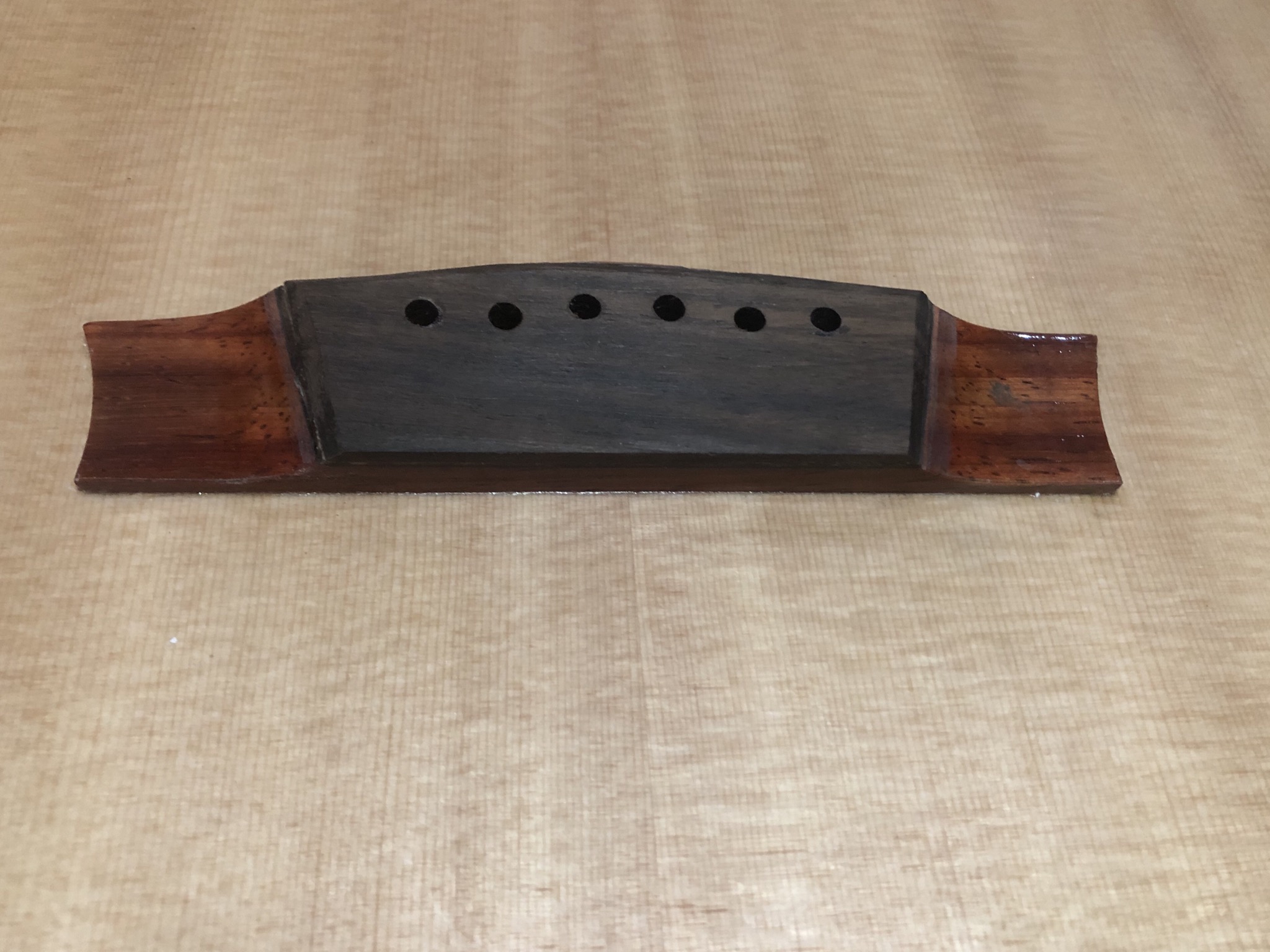

Thanks all for helping a newbie, I ended up shaving a couple of mm off the top of the bridge, plugged holes 1 and 6, put a thicker piece of Rosewood on top of bridge then redrilled holes with 1 and 6 aligning with 2 and 5 respectively. A little tidying up still to do, very happy so far.

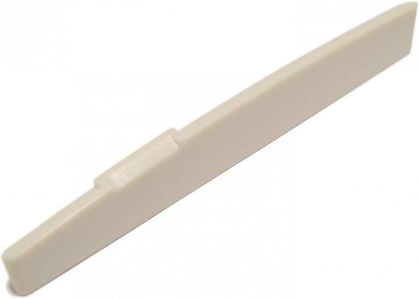

Remember that this is the front edge of the saddle slot. The next question is how wide to make the slot. Most steel string guitars have saddles of 1/8 inch or 3mm - but this is totally arbitrary. Some people use wider saddles, even up to 1/4 inch (6.25mm) and shape it from a bone blank. You can buy pre-shaped saddles in tusq or bone or plastic, like this sort of thing, which have compensation built in to account for the difference between the top two plain strings and the other four wound strings. These things are usually 3mm or 1/4” wide. You mentioned using a 5mm saddle. That is OK, but is wider than you need. A wider saddle is useful if you are anticipating tricky compensation adjustment - like you might have with a multiscale guitar or unusual gauge strings. But you probably don’t need that. Your simplest option is to route a 3mm or 1/4 inch slot and use one of those prefab saddles. Be aware that a 1/4 inch router bit tends to make a slot a tad wider than 1/4 inch and you can then find your saddle is a bit loose in the slot. It is better to have it slightly too tight. It is easy to rub your saddle on some sandpaper laid flat on the bench and make it a bit thinner to fit a tight slot.
