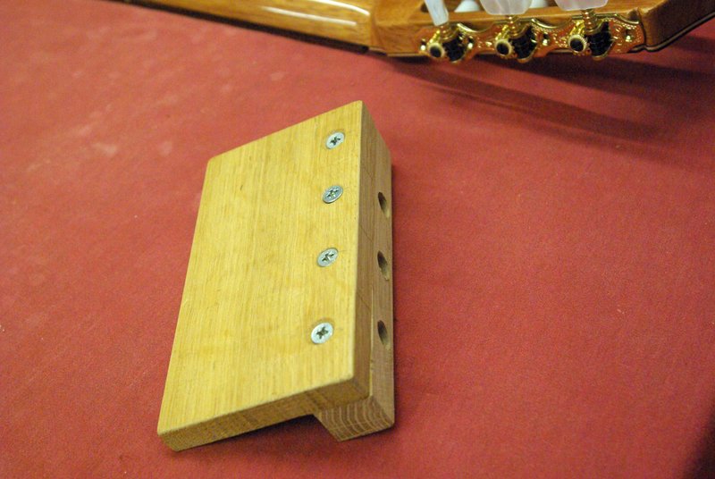

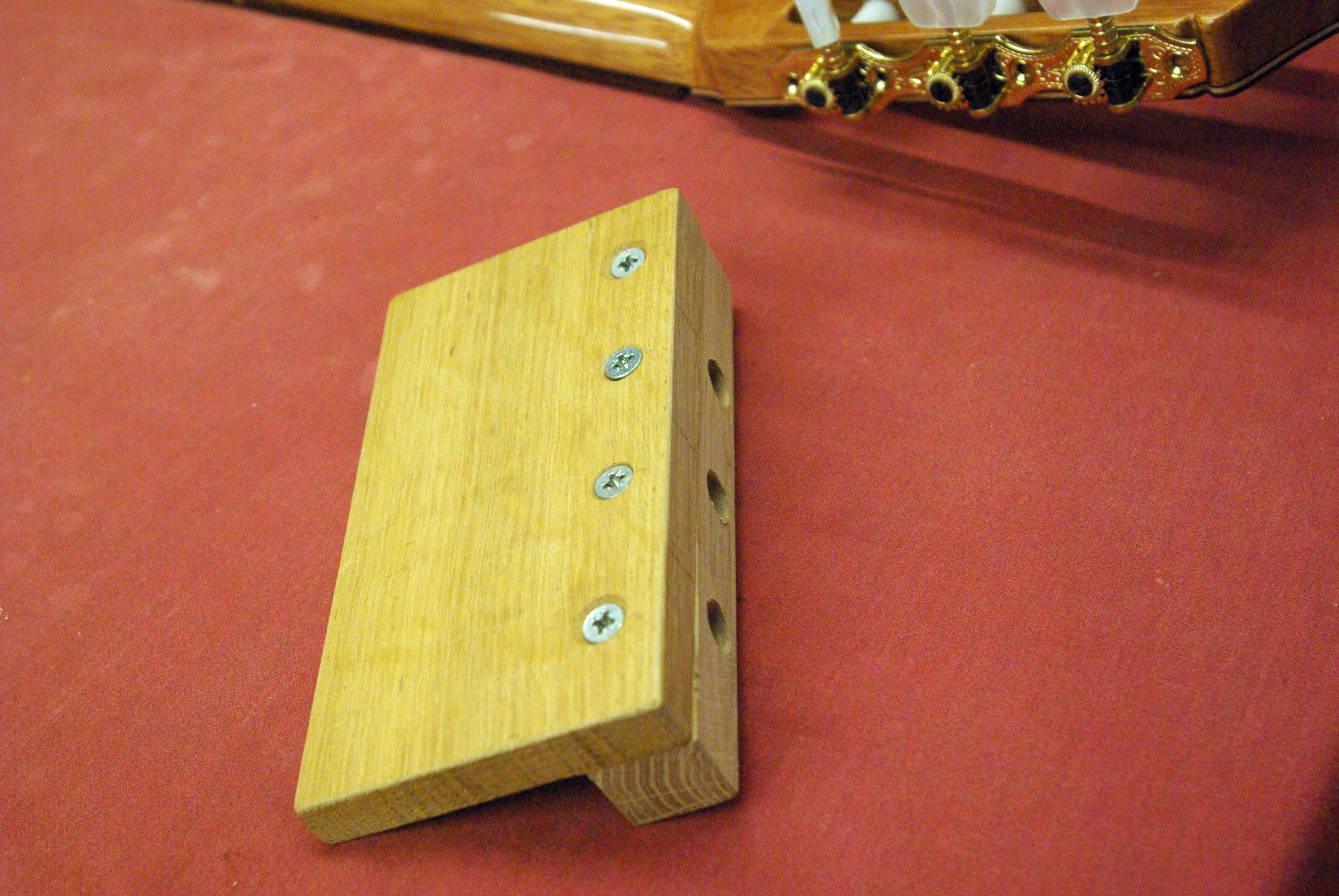

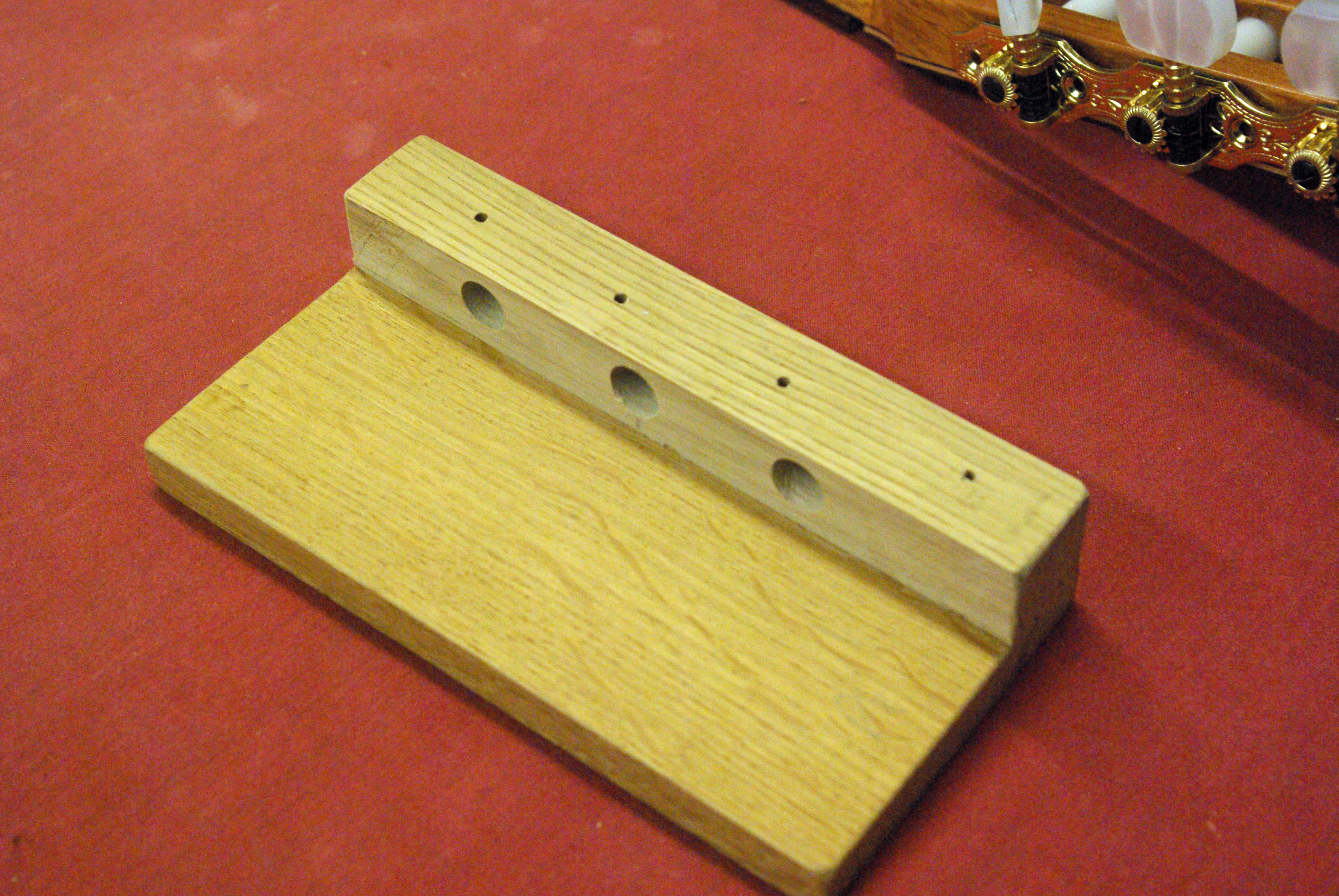

Since I was fitting some tuners today I thought I might continue this a little.
When I was making furniture I used to make my own dowel jigs (a la Krenov) and making them in a suitable hardwood such as oak seemed good enough. Exact spacing was not important since one simply reversed the jig to drill the holes in the other piece, maintaining register.
Well I have done the same for a tuner hole drilling jig. Based on G&G though it is a fairly obvious way to go.
However! It is extremely difficult to drill at the correct spacing. The usual techniques of measuring, marking and centre punching just don't work. (I really tried!)
So this evening I finally did what I should have known was the only way to go. That is to have a fence on the drill platform that sets the distance from the clamping plate, AND carefully measured spacers to give the distance between centres. These two control surfaces mean that the dam'd drill simply can't wander.
I finally got the thing right. And by the way I happen to have a 10.3 mm bit which looks just right for the 10 mm rollers on my particular tuners.
Centering is achieved with packers between the clamping piece and the head.
PS there is a quite long discussion on this on the OLF with particular reference to the LMI and StewMac jigs.
Cheers Dave M
Cheers Dave M
