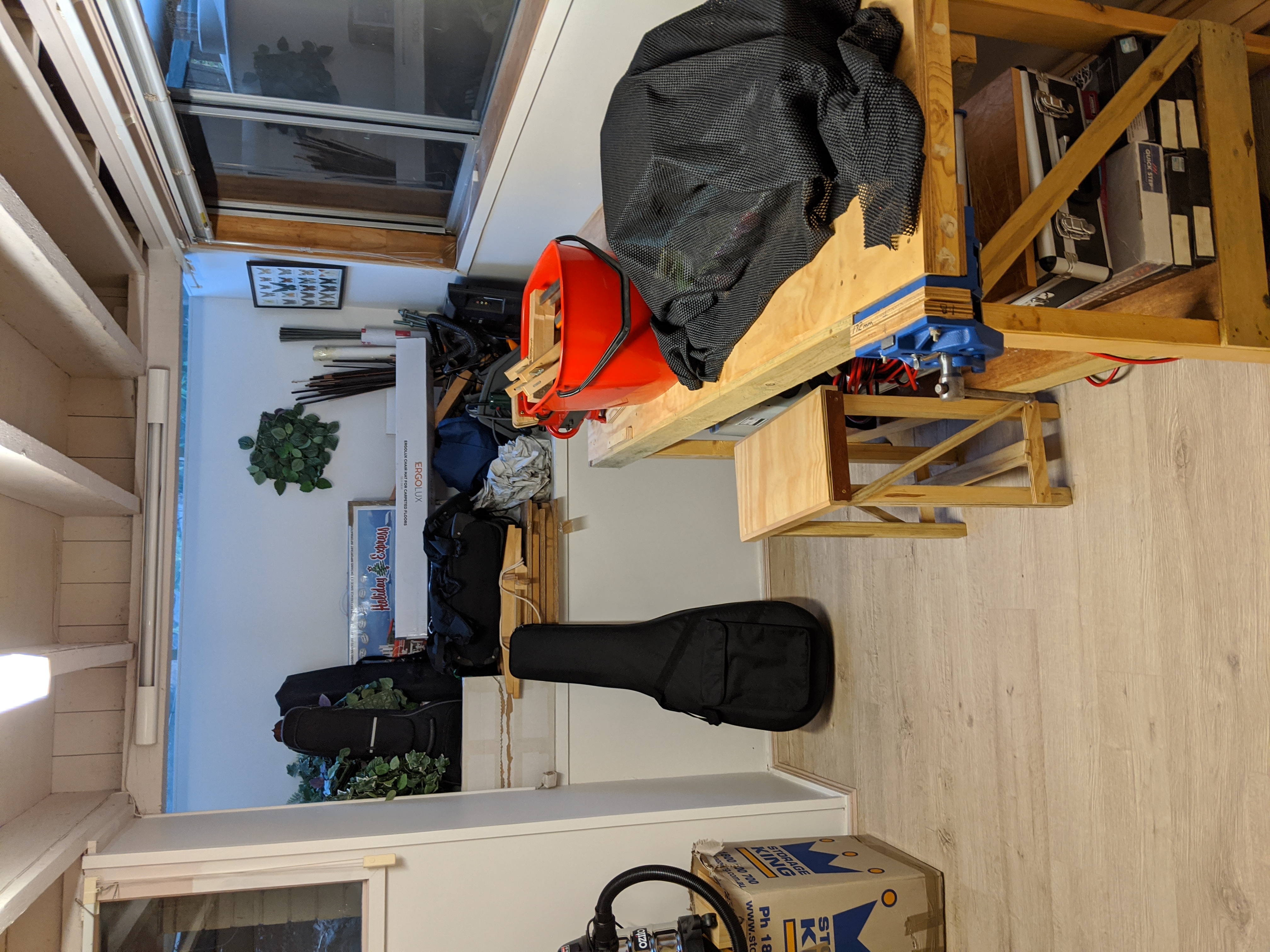

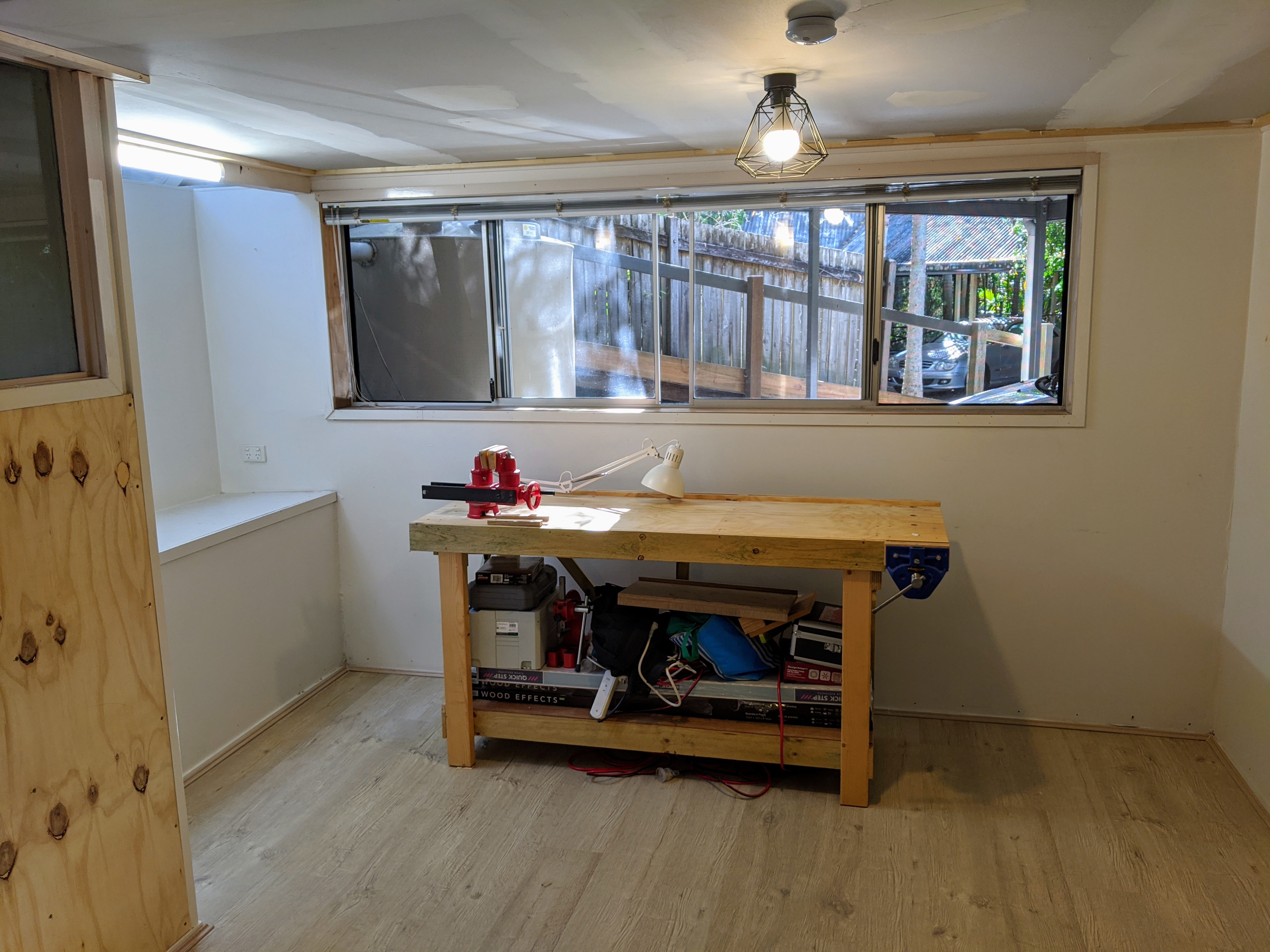

If U can imagine it without the clutter..... Here's the workspace
Re: Brisbane humidity
13 m squared for a workshop is ample, same as my place. It leads you wanting more for sure but only for things like spray rooms wood sheds.

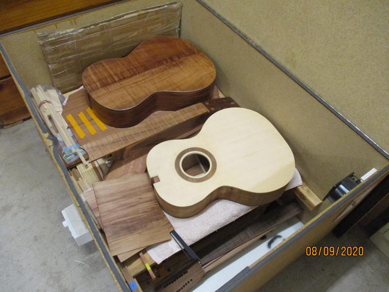

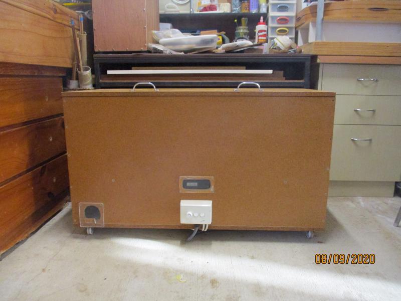

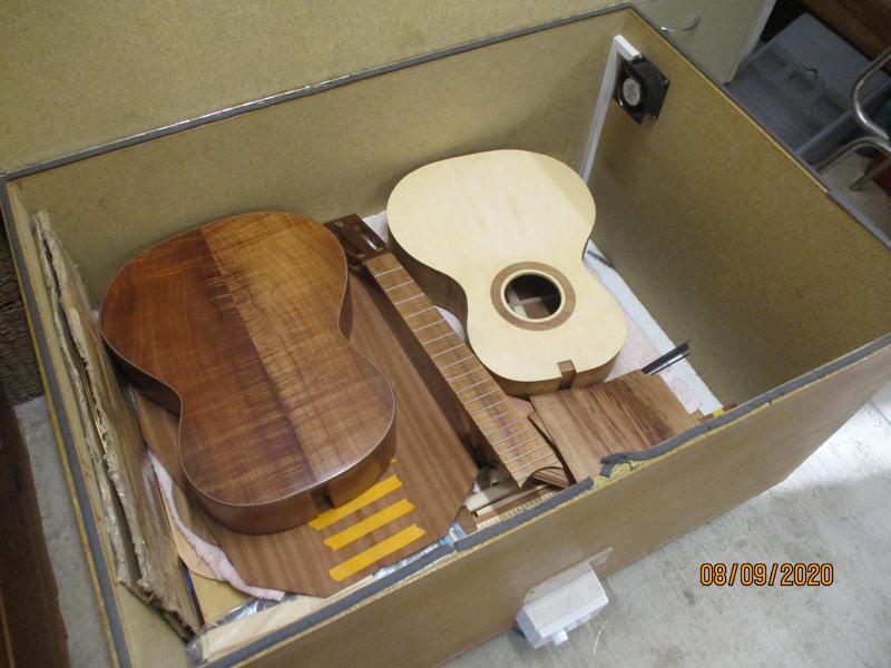

Townsville has an average of 60% humidity. I use a dry box big enough to fit a solera with guitar builds at different stages fitted to it and guitar bodies in moulds with necks attached. The box uses a 100 watt globe located at the bottom of the box with an intake hole at the bottom and an exhaust at the top of the box with a computer fan attached to suck out hot air. I think that is unnecessary but it sound good when I fitted it. There needs to be a natural shift of air through the box. I have a shelf about 20cm from the bottom of the box and the guitar parts, moulds and solera sit there. The globe has a fader fitted so I can decrease or increase the heat inside the box. My shop is the size of a single car garage and I have a large old style aircon fitted in the wall. It works fine I take the humidity level down with the aircon, take out my projects to work on and then replace back in the box. An old fridge or a single old style wardrobe works good with a globe mounted down the bottom. Just trial and error with the globe wattage to get it right. The only problem up here is in the dry season I have to bring the room down to 16 degrees sometimes to achieve the right humidity level and 16 degrees is bloody freezing for us.
Good luck

Here you go. Simple and easy.

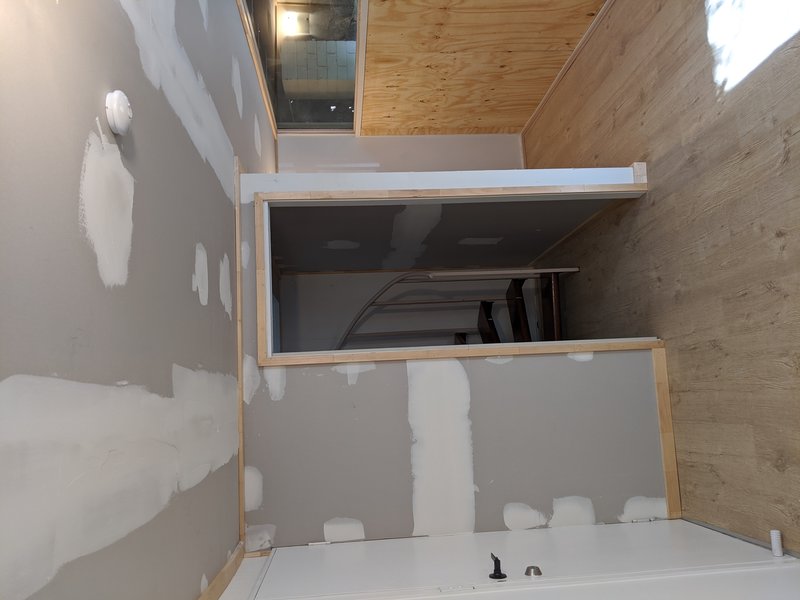

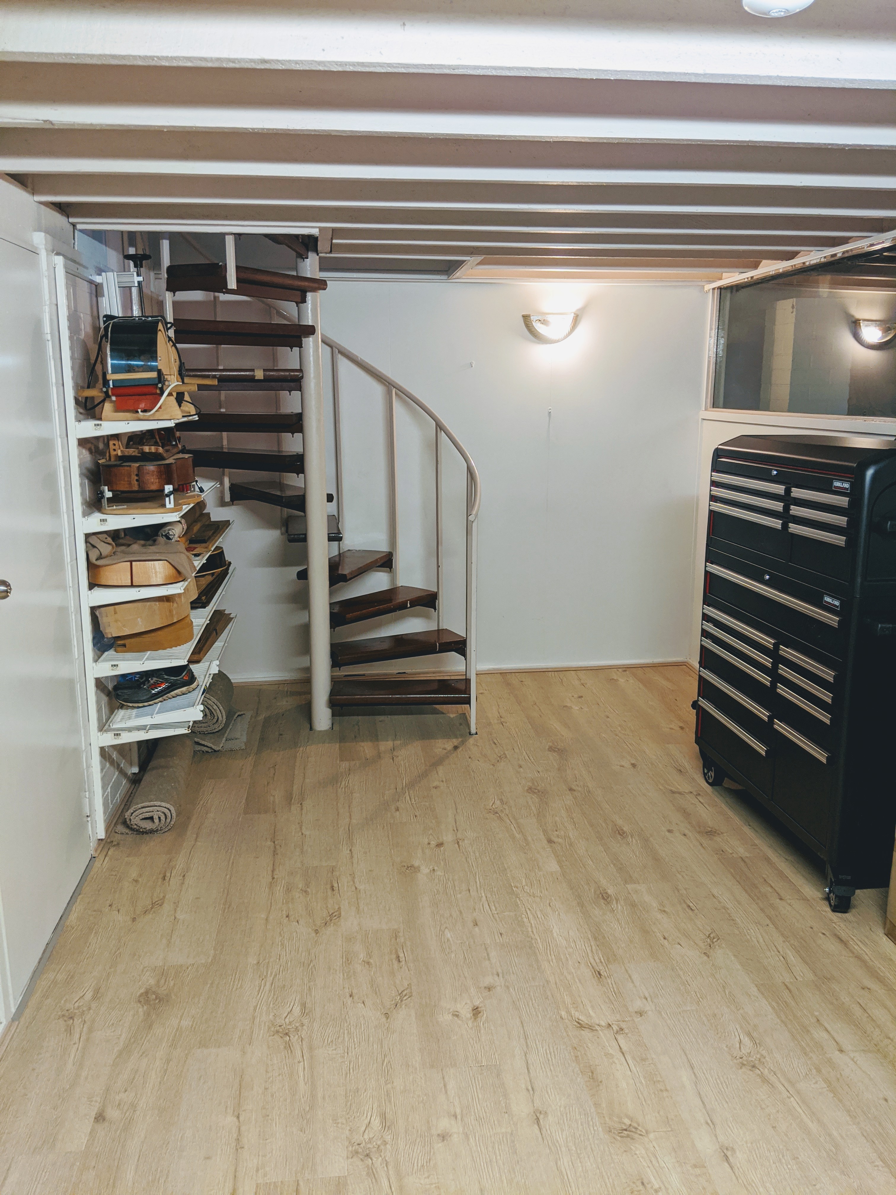

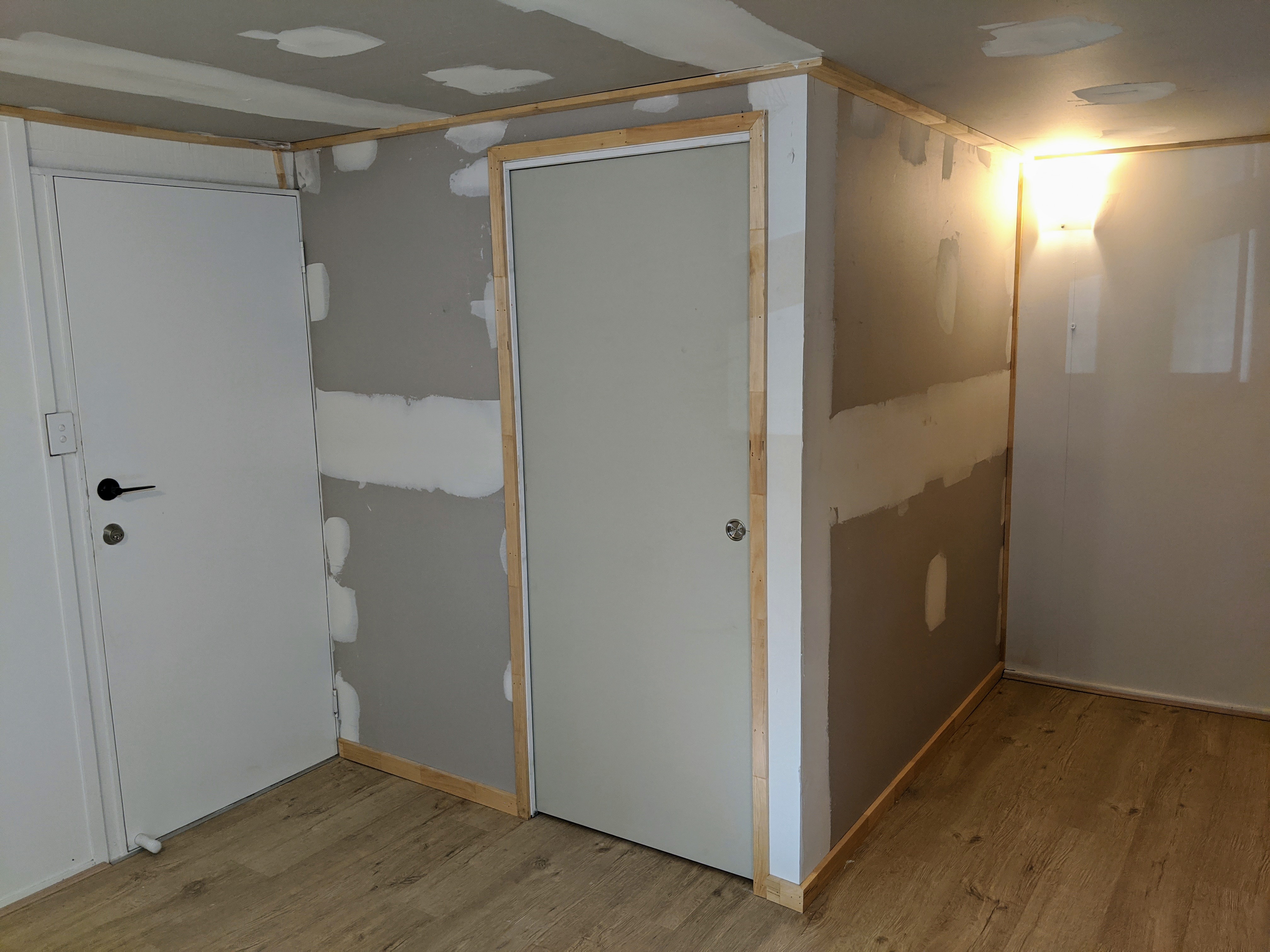

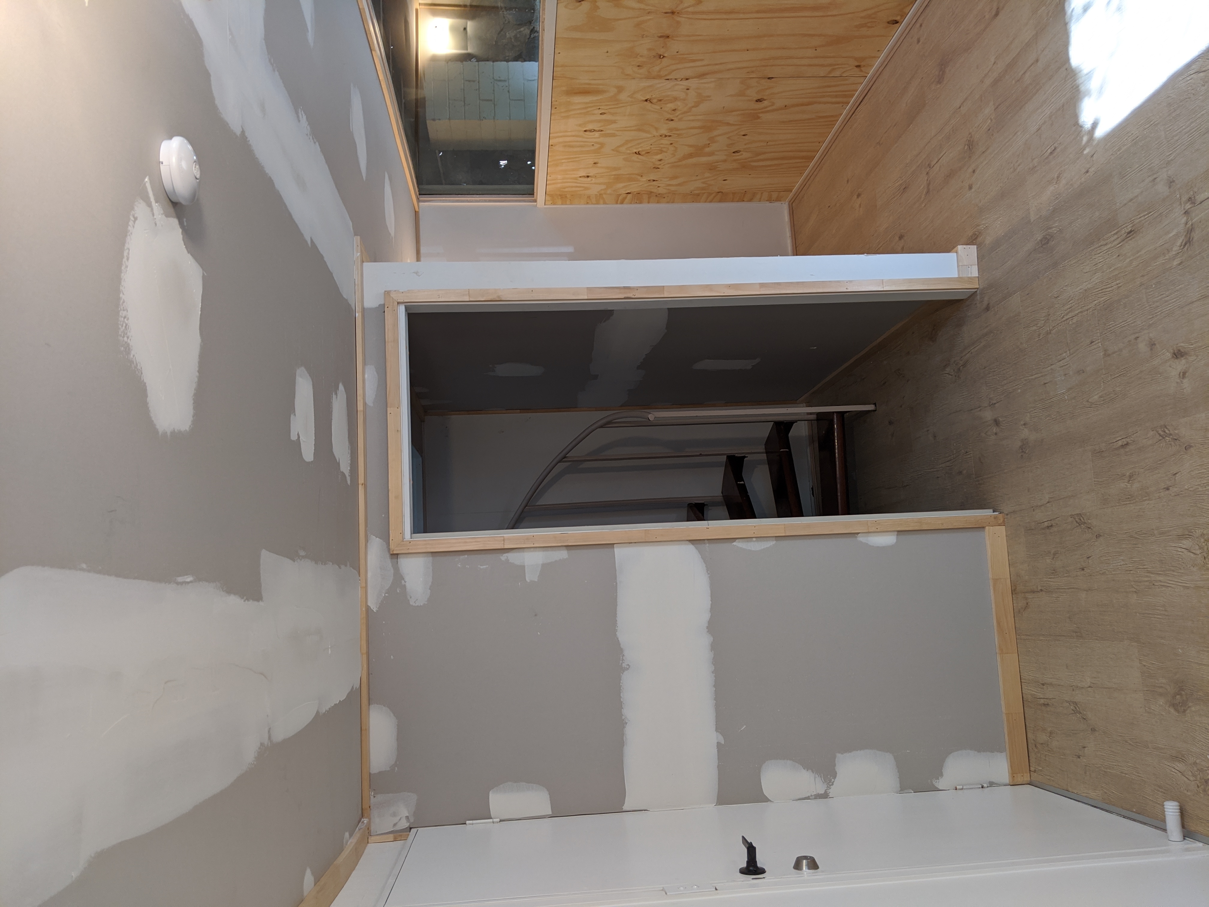

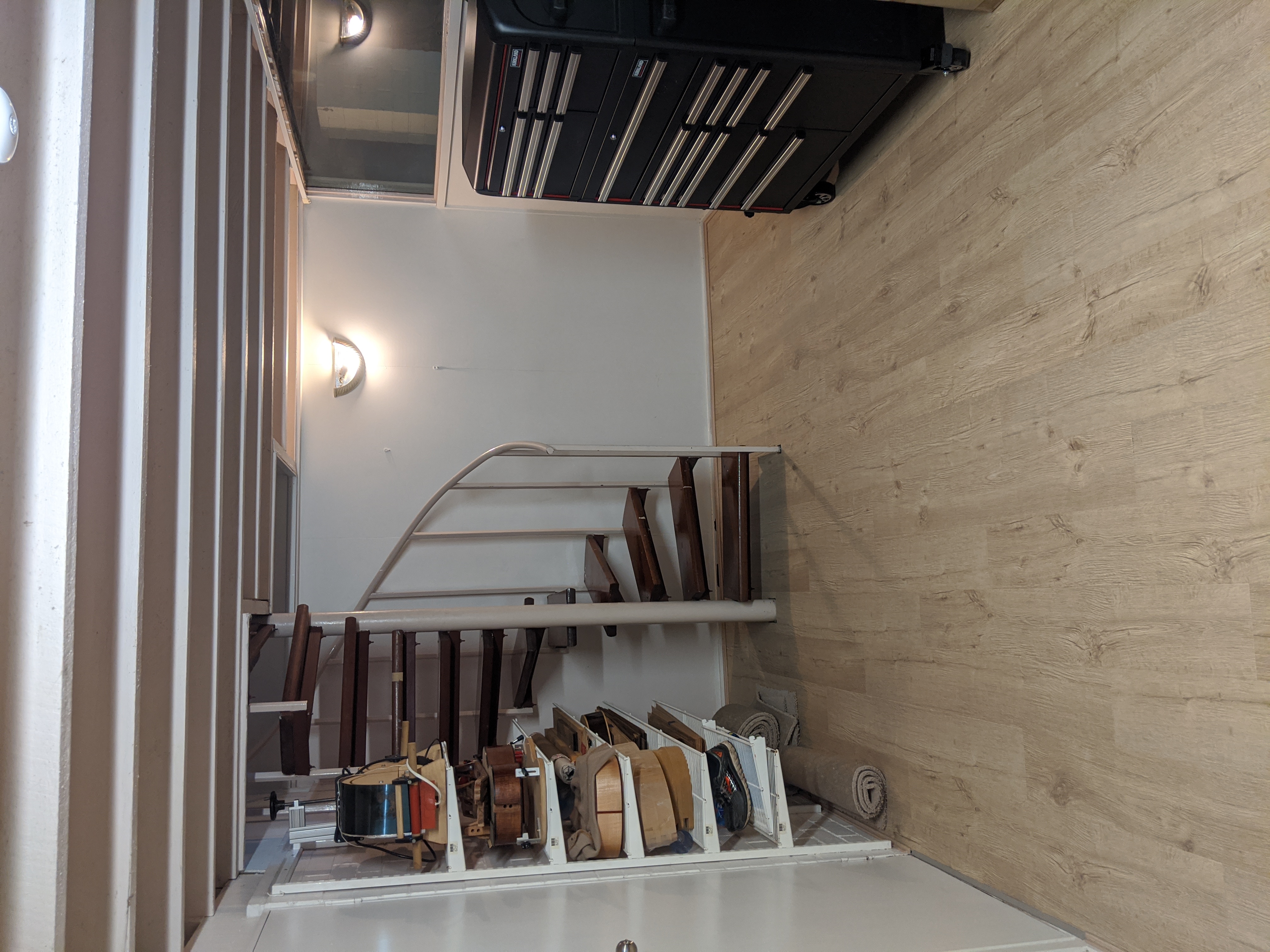

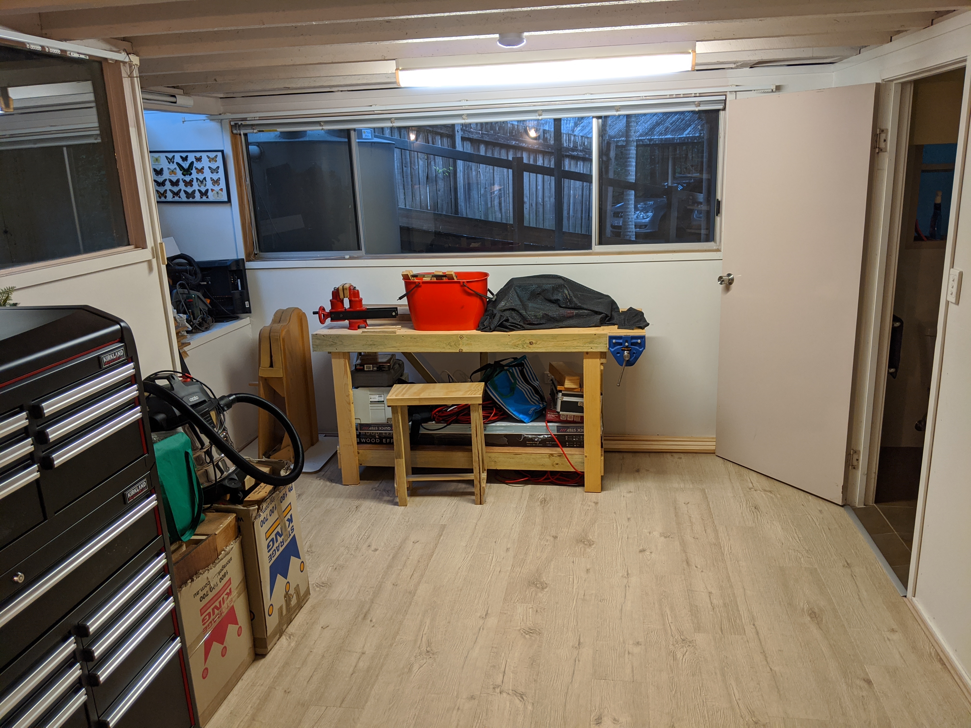

Getting there. Stud wall with a sliding door to stop the draughts and dust + noise reducing insulation between rafters. Now to choose a colour for the workshop... Have also purchased a portable dehumidifier. Posting now before plugging in the dehumid just in case it doesn't work as planned! On track for humidity control so far...
