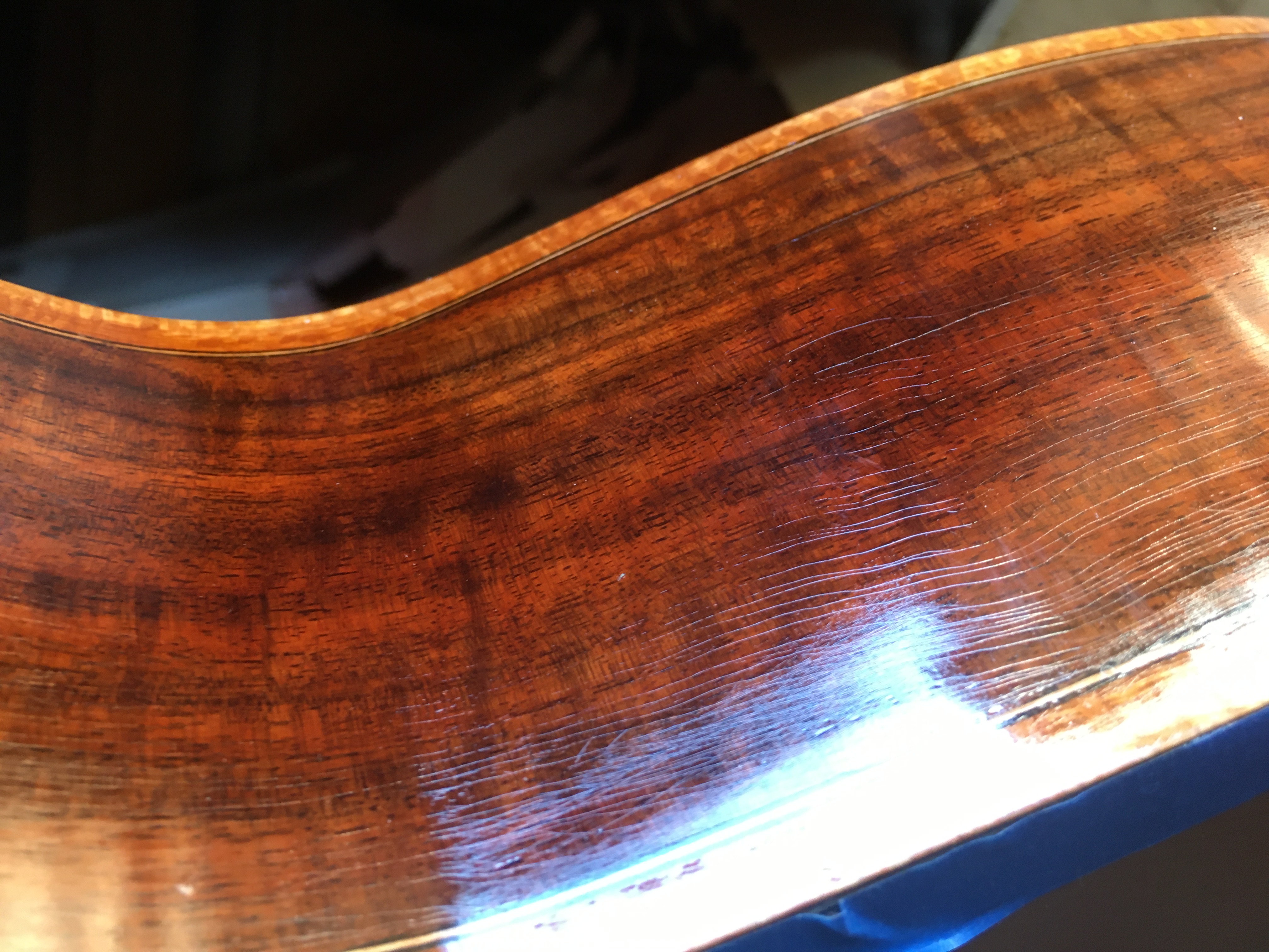

I have a problem with respraying a guitar I sprayed a year ago. This build has dragged on and seems jinxed!!! There is a lot of crazing of the old finish, I sanded it back, perhaps not enough, applied a highly diluted flash coat then resprayed with my usual lacquer mix . I use Nitrocellulose. Opinions and advice most welcome! Cheers Ross

Once nitro has cracked and split you really need to remove it back to bare wood to get a smooth finish again

Thanks for the replies gents! I suspected that there would be a chemical solution to this problem, the article re the thinners was great. However, elbow grease seems to be the best option here. Does anybody have any theories as to why this occurred in the first place? The Claro Walnut was dried to 40% RH during the entire process from body assembly to sprayed finish, including some time afterwards in the dehumidifier prior to storage in the case inside my house at what I would estimate averaged 60% RH. The Walnut had been in dehumidified storage for a number of years prior to using it, and I've I've never seen nitro craze so rapidly, having used it for other builds that have not had a problem....same batch of wood. Maybe the crazing was caused by how I mixed the different coats of lacquer as I applied them? It's a mystery! Cheers! Ross

I have seen many guitars and headstocks that have been repaired with cellusolve or equivelant and sorry not impressed at all, there are always witness marks, bubbles, crazing left on the surface, to franks website and photo, a photo simply shows a smooth reflective finish it does not in relality show you what the surface looks like.
Sometimes crazing just happens, i suspect its been exposed to an extreme cold situation, if i want a vintage nitro look, i can paint it today put it in the freezer tonight and when i take it out tomorrow the finish is cracked everywhere.

Put a face mask on, well ventilated area and just keep wiping it down with a fresh rag and paint thinners, it will eventutally just wipe away back to the sealer coat
Many a time I have sat there and removed a nitro finish with thinners and a face mask

The job has nearly been done on this repair...I found that using a scraper was faster then followed by the thinners to strip...that way less fumes and health issues along with saving a LOT of expensive thinners....nitro thinners are extremely volatile as well...cheers! Ross

I have been wondering if gunwash thinners would affect the respray down the line....a hand build that I don't want to compromise, but if you have experienced a stable end result let me know....a much cheaper option but still lots of fumes, so I'll go with a scraper first then the thinners then sanding before respray...lots of work I didn't expect to have to do on this one that for sure. Cheers! Ross

What worked for me most efficiently. A light wipe with gunwash to soften the nitro then a Caruthers scraper followed by a sanding. Cheers! Ross
