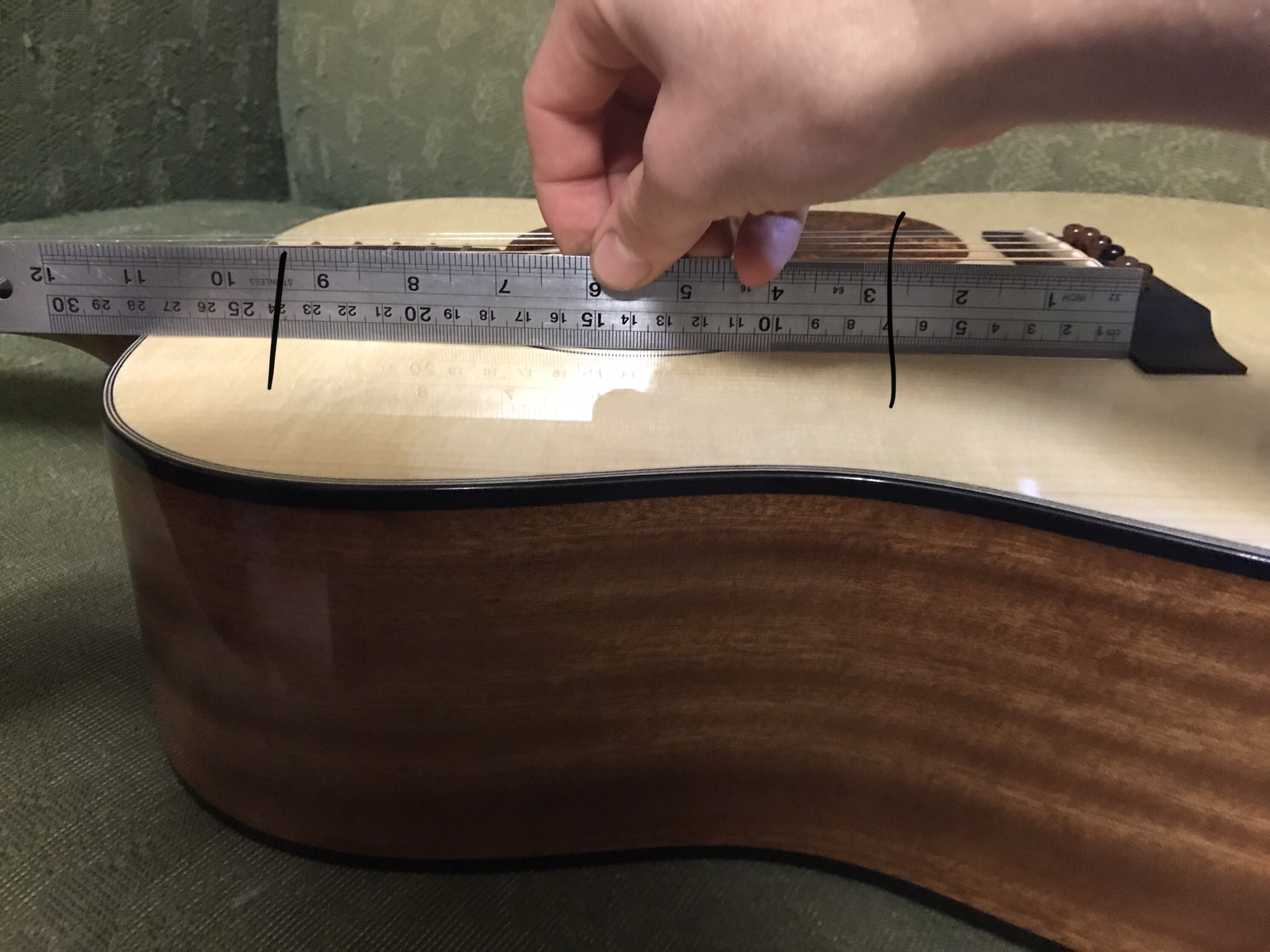

Ok so just finished this beast, super stoked with the sound!
I have nearly perfected all of my bracing weak spots. Nearly... There is still one which I hope to fix on future guitars. It is just between the X brace and the structural brace under the fretboard, as you can see from the markings in the picture below it has dipped in about 0.5mm after about 2 weeks with strings on it,
should I be worried about this? Or is it survivable. Anyway please let me know what you think!
Laurence.

The bracing looks fine to me. Under tension the neck is going to pull forward a bit. I even allow a millimeter at the saddle when I do calculation for string height from the top at the saddle when setting the neck angle. That normal movement under tension will reflect itself in the top as the neck block rotates a bit. I am curious if the top has a radius? Having a radius on the top will not prevent it but will make it less visible than a flat top. I am not sure how visible it is on your guitar if you are not looking with a straight edge.

Check your bridge rotation. 2degrees is ideal. Cap the X join if you haven't. I would be inclined to think about the X braces between the bridge and the soundhole, and if the top is too thin..... do you deflection test? The assembled, braced soundboard is the measurement to take. The calcs are out there or buy the Gore/Gilet books. There may be something in an ANZLF thread re the books that you could fish around for.

No sound hole patch, just those two small braces. And yeah I should've used more robust braces either side of the soundhole. The top is just under 3mm.
yes there is some radius! not sure how much though considering I mostly eyeballed the radius dish... I guess I should expect some movement, no belly no tone right? :)
Ok yes I haven't been capping the X I probably should. I didn't do a deflection test but the guitar hasn't moved much since so I'm reasonably confident that it is structurally sound. Goes to show I shouldn't stress until I have let the guitar settle for a month.
Thanks for the advice!
