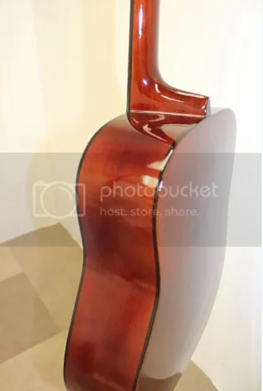

An old photo which i screen shot from another location,
This is gloss of the gun on final coat, hvlp, viscosity, air pressure, technique, gun type all come into play when painting.
We assume that we can paint as part of the trade, but a painter spends 3 yrs learning their trade, dont be hard on yourself if it doesnt turn out right.
My dad was a spray painter, i painted a few cars before i ever painted a guitar.

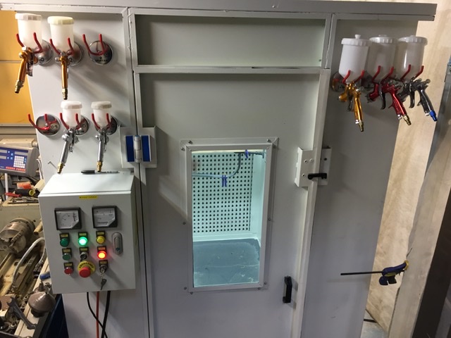

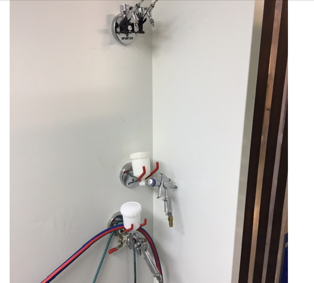

I paint every day of the week, so my setup is way over the top, nothing worse than dust or having to paint something more than once
There are days, where I am spraying uv, nitro, two pack, acrylics, so its not unsual for me to have 4 or 5 spray guns with different paints at any one time.

Steve, what a wonderful space to be able to show off. It must make you smile still every time you walk in.

Yep, I am in my 50s and love going to work everyday.
