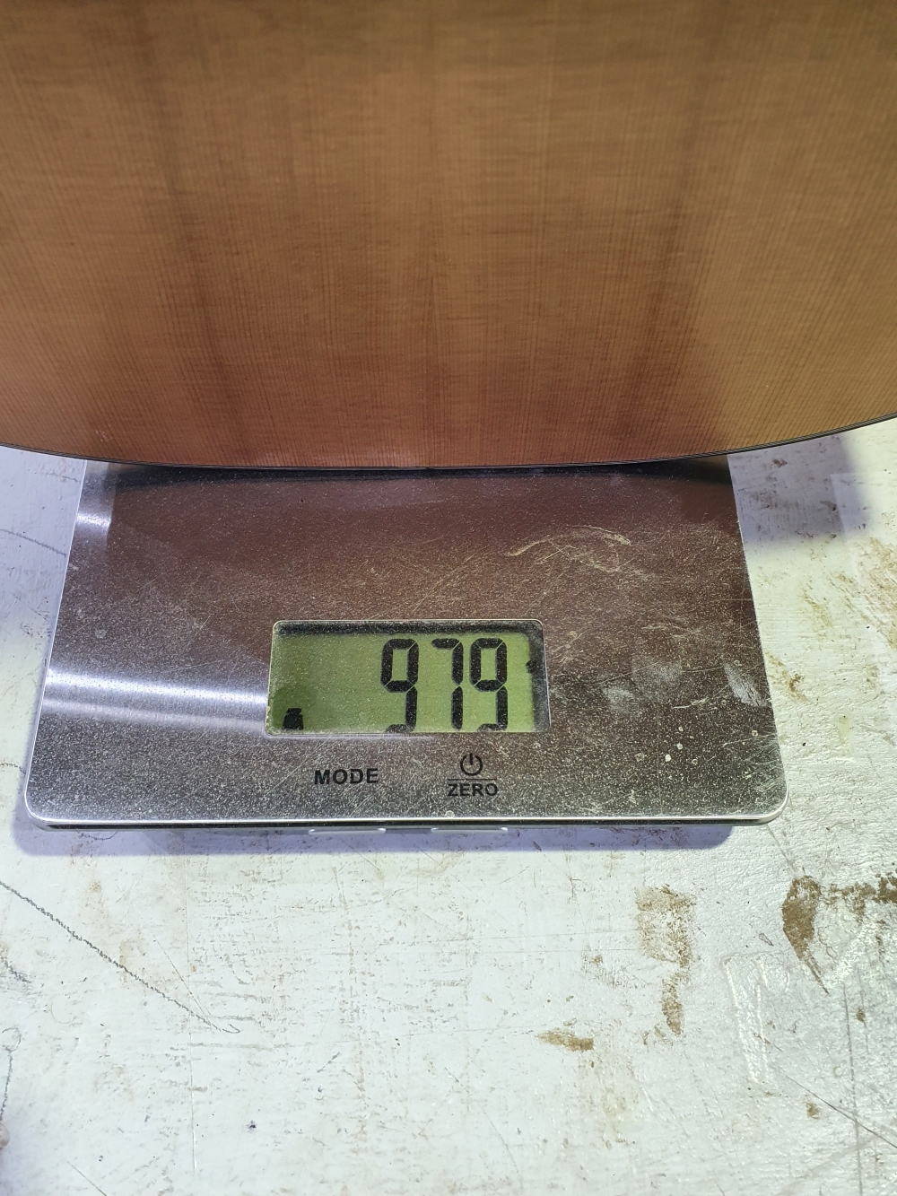

My only consideration for weight in Classical or Acoustics is that they are balanced and certainly not neck heavy - which going by feedback from players is often a downside/complaint to BOBO construction.
However when it comes to flamenco the weight of the instrument in my opinion is the single most important factor for getting that flamenco sound.
Here's my latest flamenco blanca (ceder top):
Re: Instrument weight
Wow Steve!
That's really shaving it right to the "edge of failure". I'll bet it sounds really "barky" and in your face - as it should.
Don't you just hate it when you've slaved to get the weight down, then you've got to increase it again by adding those heavy pieces of golpeadores (thin plastic tap plates that you now have to glue onto the soundboard so that the player doesn't go bashing his fingers through the super-thin top!)?
Nothing lasts for ever - least of all well made, well played flamenco guitars.
Frank.
