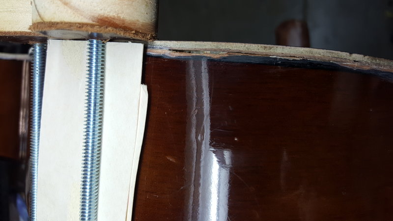

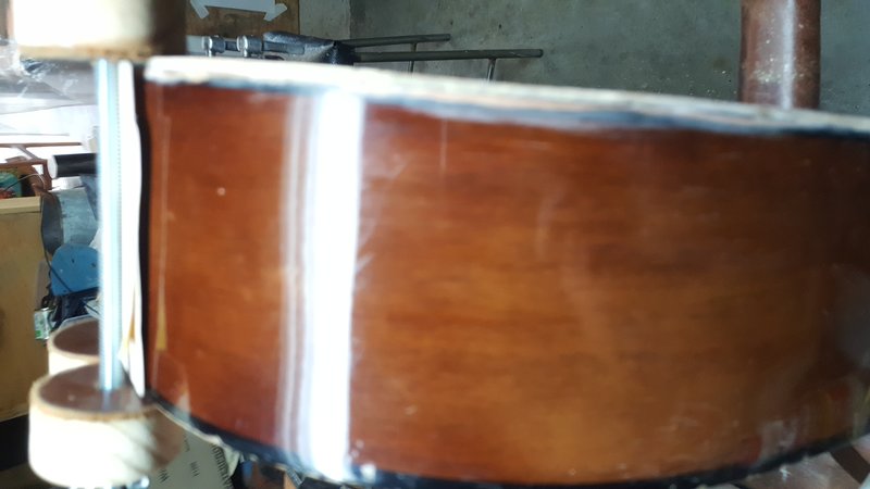

Image After putting back on I'm left with a mess. Edge was painted not binding but could someone suggest filler and best paint to clean it up a bit. Could use black leather stain but not sure it would take to filler. This is an entry level guitar and I am an entry level fixer upper.

Easy, if it was a customers guitar I was going to say pull the back off and profile sand the sides and refit the back, use rubber bands rather than clamps.
Being a cheapie and you pulled the back for access, mix some epoxy up and fill the gaps all the way around, scuff sand the sides and back and get some supercheap autos acrylic satin black, its 12 dollars a can, spray the edge black, the overspray will give a light burst look to the job, it is the cheapest and easiest fix with a decent end result

Thanks Steve. I have some matt black auto spray. Was thinking about trying to use paintbrush but wasnt optimistic. Will try spray but some serious masking to be done. Thnks and rgds Davimkd
