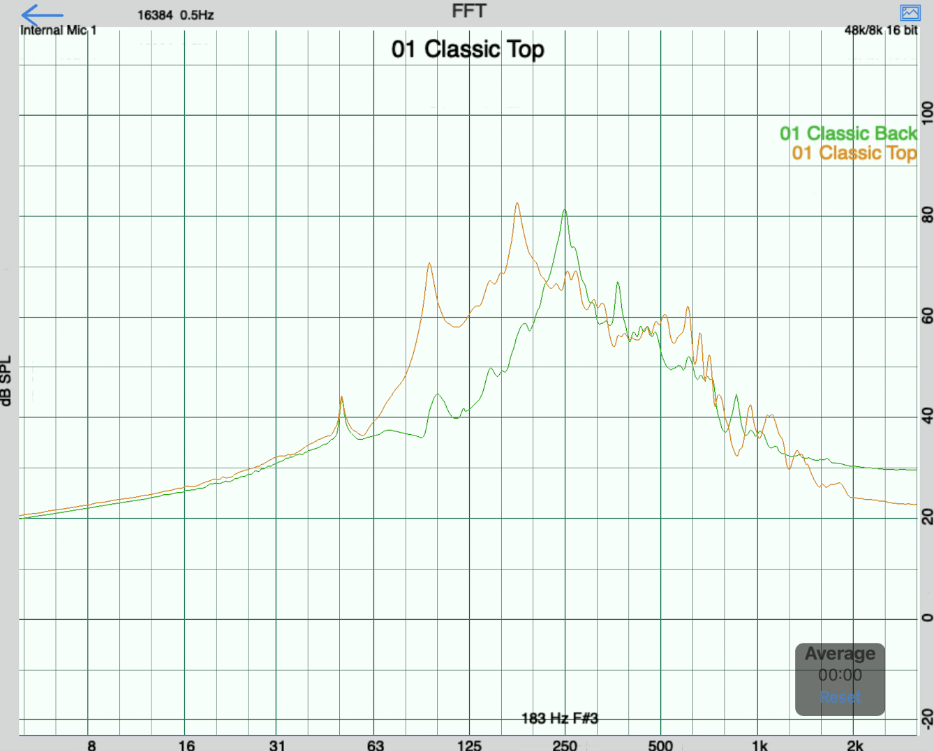

Have you tried using the FFT Tools by Studio Six?
They have an iOS app which is great for recording taps on your instrument. The Mac based equivalent will also display your data. Attached is a screenshot of two testing results, green is of a dozen taps across the back of a guitar, averaged, orange is from a dozen taps on the bridge.
Shows me quite clearly the structural frequencies of this guitar.
