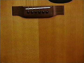

Runout is not thought to have bad effects on sound quality of instruments. If you book match a two piece soundboard with runout you get a different appearance of the colour of the timber under finish in each half.
This is a cosmetic problem rather than a structural one, but some people would not buy a guitar with such a top because they don’t like the way that it looks. Extreme runout could make the soundboard weaker or make a glued bridge more likely to detach.
