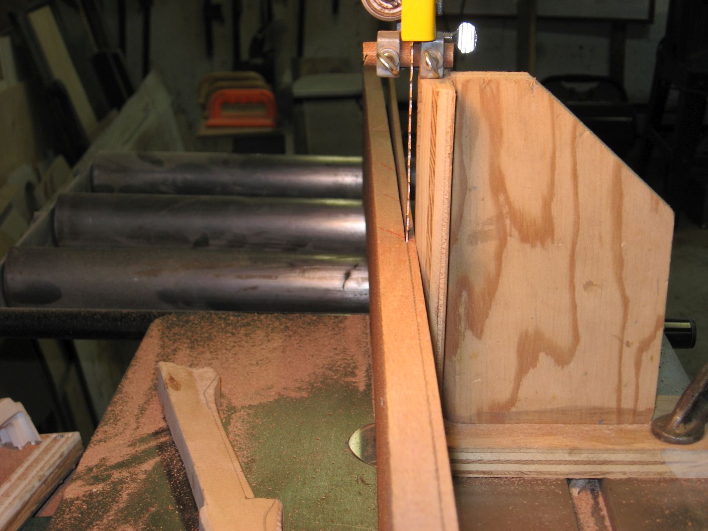

This is what I use for a re-saw fence. A short rounded square. You can adjust the piece if the cut want to drift.
