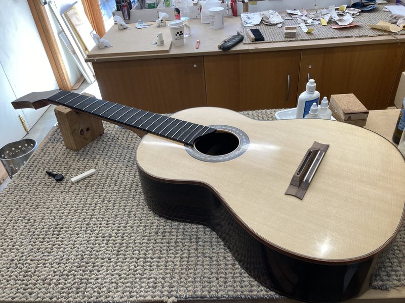

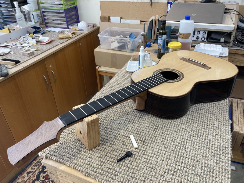

Domestic chores of late have kept me away from the workshop. During the odd hours Ive managed to assign to my building Ive managed to get the french polishing finished on the the neo classical. Once the hard shellac has fully cured the bridge will go on and planetary pegs will get installed. The headstock looks a bit rough....a few pores still showing so have had to do a bit more pore filling on same.

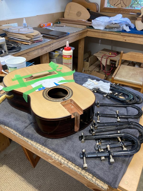

Bridge finally glued on. The original bridge failed on this guitar and I ended up having to replace the top. I manage to jam 9 clamps through the soundhole. After the photos were taken I managed to squeeze one more clamp in to make it an even 10 :mrgreen:

That's a lot of clamps Martin. Should be a full life time bridge glue job. Great work!

Well, if that bridge fails it won’t be for lack of clamps.

Looking good. Might be time to invest in a vacuum clamp Martin :D

There's actually a full vacuum kit sitting in a box under my bench.....was part of a group buy years ago. I havent yet got around to setting it up.
