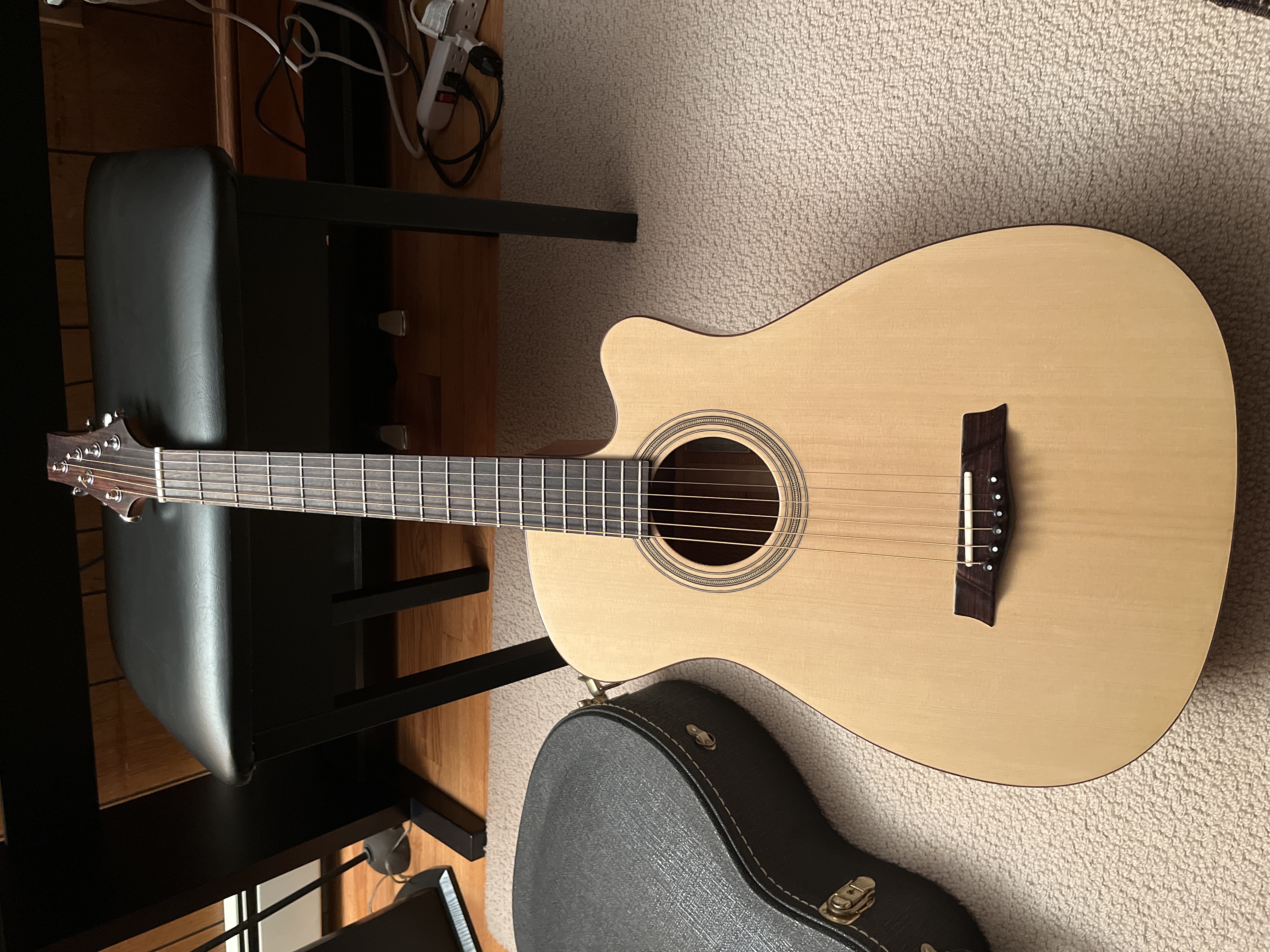

Hi, I have just finished my 6th Gore falcate style SS guitar - 12 frets to the body. All the previous ones have sounded excellent - as does #6. However it has several notes fretted on the 13th fret that are very muted: C, G#, D#, A#. Other notes above the 12th fret sound fine as do those same notes played elsewhere on the fingerboard. Any ideas for what might be going on???

Stanley the guitar looks very smart. I suppose it would be a bit cheap to talk about wolf notes!
